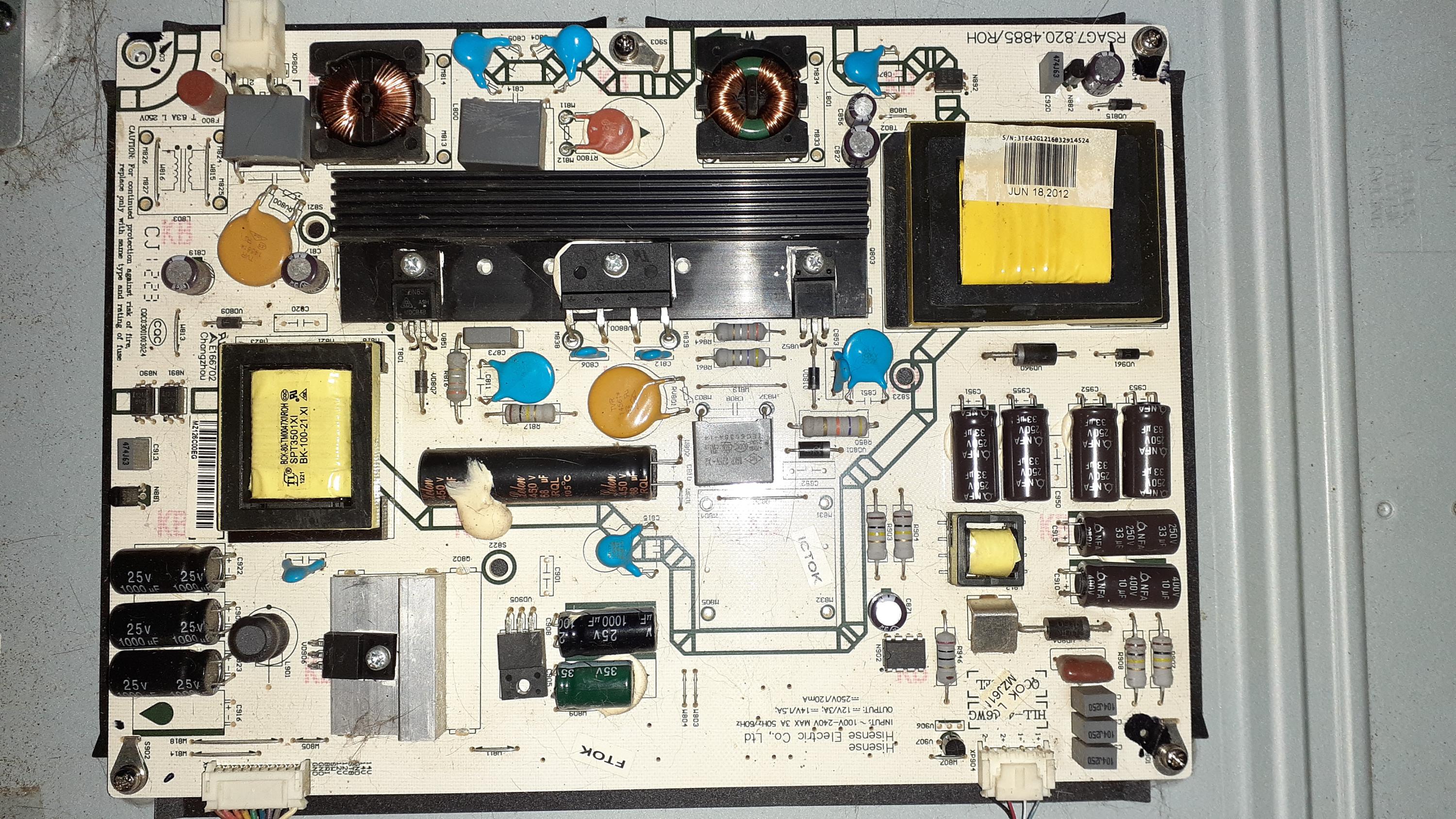

    Hisense 42K20E Backlights fade to off - Had image
    So the backlights light up on power on, then fade to off. I can see an image on the screen (No Signal). I've checked voltages of the LED connector and nearly all of the caps. None of the capacitors have any where near the rating including the main. The LED strings don't even have the same voltages. I've attached a pic of the power supply.
    Here are the voltages:
    C810 = 155v
    All of the following are 128v-130v
    C910
    C915
    C953
    C952
    C955
    C951
    The following are at 11.8v
    C922
    C907
    C923
    C908 = 14.66v
    C905 = 14.7v
    The LED connector has
    1+ = 130v
    2+ = 3.8v

    Re: Hisense 42K20E Backlights fade to off - Had image
    bad backlight leds in the second string.
      Looking at the board, it looks like The LED strings are connected in series so the 1+ (Anode) will not be same as the 2+ (Anode).
      1+ (Anode) is fed by the LED V boost converter, the 1 - (Cathode) should be connected to the 2 + (Anode), the 2 - (Cathode) goes to ground via PWM controlled MOSFET and current sensing resistor.
      Please upload good clear pictures of the whole backside of the board.
        I forgot that I posted this same issue over 2 years ago and hadn't continued with diagnostics. Please refer to the following link, especially the last few posts about the BRI voltage. I never continued because I didn't have a 1k resistor, and I still don't. Is there an alternative to doing this without the resistor, or is it absolutely necessary?
        https://www.badcaps.net/forum/showthread.php?t=63913
          You should cancel this thread then and go back to the original thread.
