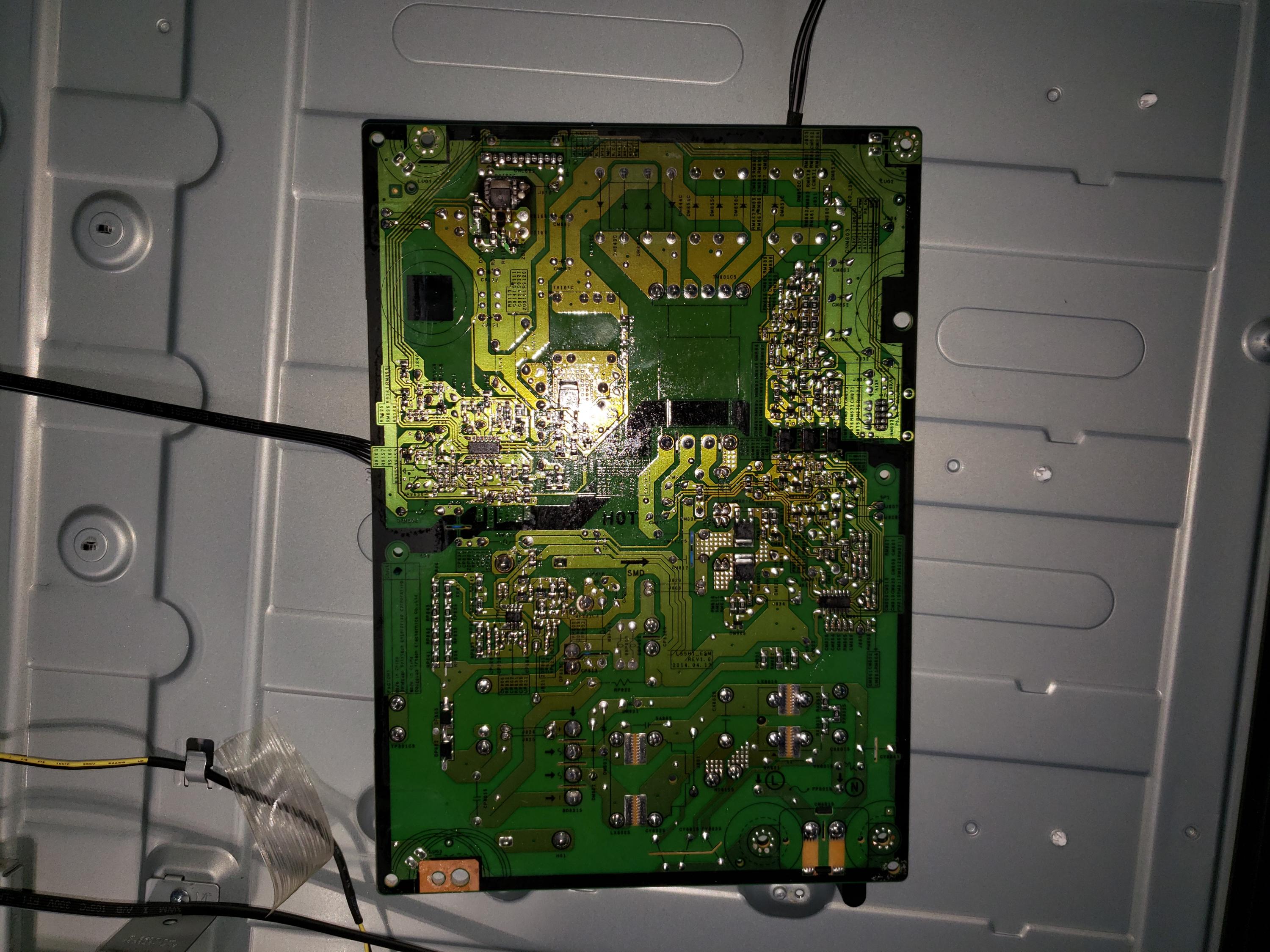

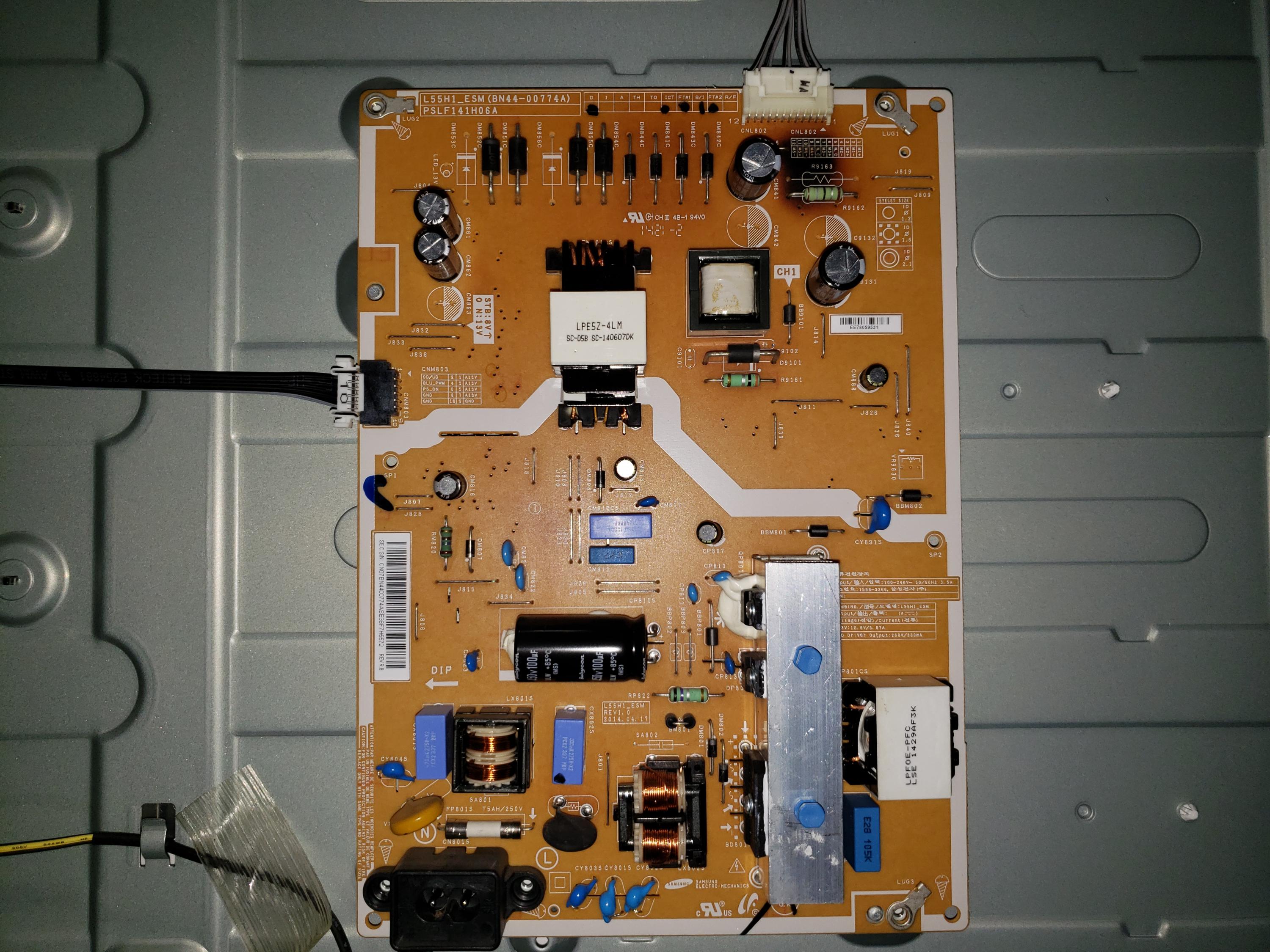

    Hi guys, I picked up this tv today and the owner said the tv had sound but no picture. Upon getting home I immediately proceeded to open up the back without plugging the tv in to see what it does and I found the PS has a pretty big part that is scorched and underneath (bottom of PS) is what I wanna say is a voltage regulator? Don't really know... but anyway what do you guys think happened to it and can I take another one of those from another PS and pop it in or do I buy a replacement from digikey?
  • ztu165
    • Jan 2013
    • 87
    Re: Samsung UN55H6203AFXZA scorched part on PS board.
    Also wanna mention that the PS has a bunch of questionable/ suspect solder joints...
      That is PWM Controlled power MOSFET and the LED backlights return line for the LED string. You may have some shorted out LEDs so the MOSFET runs hot.

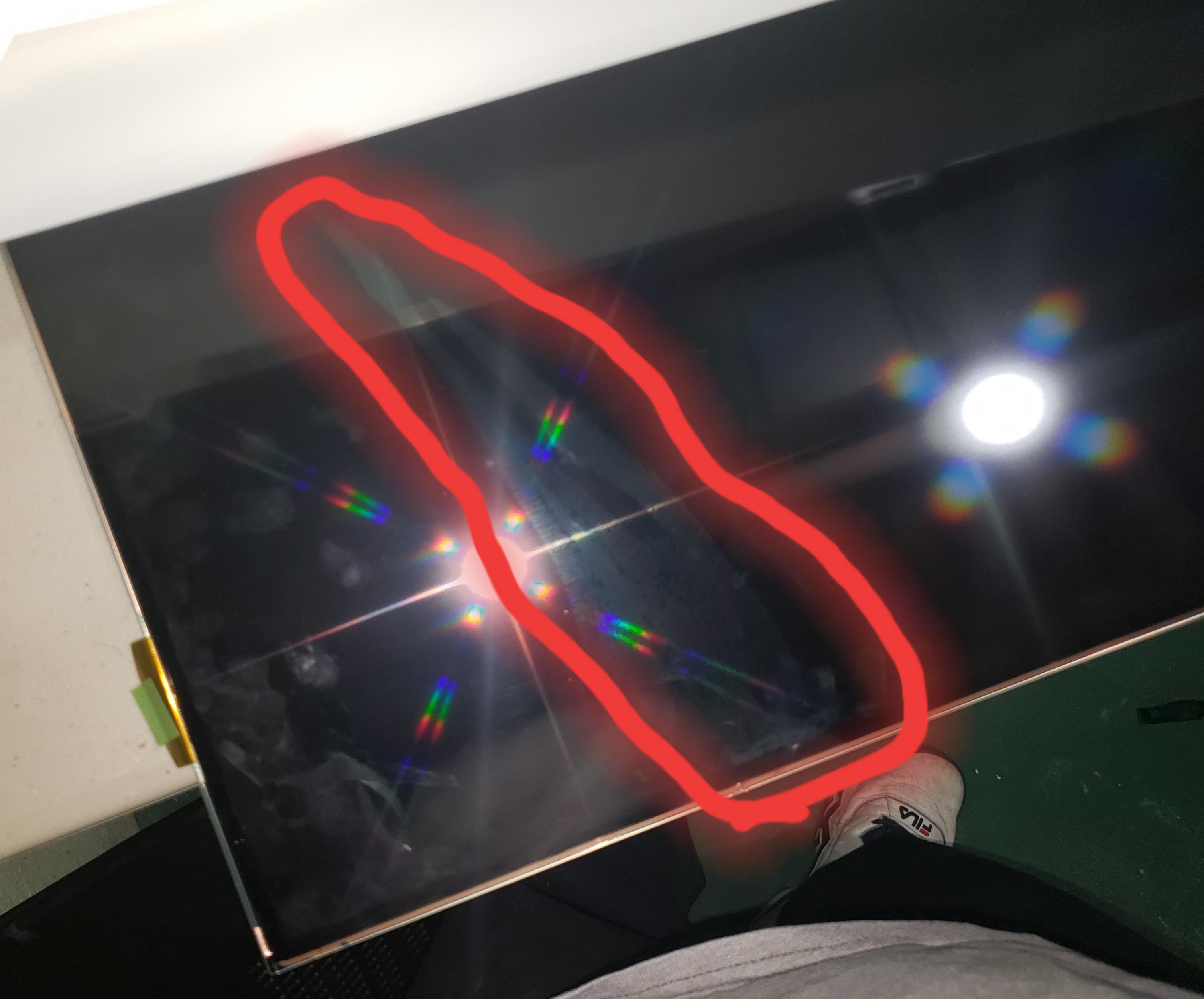

                  Hey Budm... So I finally got the LED tester and I gave it a shot! Turns out the very top strip was shorted and on my weak ass attempt on getting down to the LED strips so that I could get a part number and order them I accidently cracked the damn panel on one of the bottom corners! I felt so damn bad... still do. Dammit!

                    Here's a picture so you can see my stupidity!
