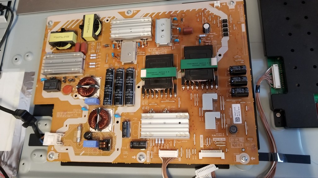

        Re: Panasonic TX 58-AXW804 will not turn on
        Can we see good clear pictures of the whole backside of the TV showing all the boards?

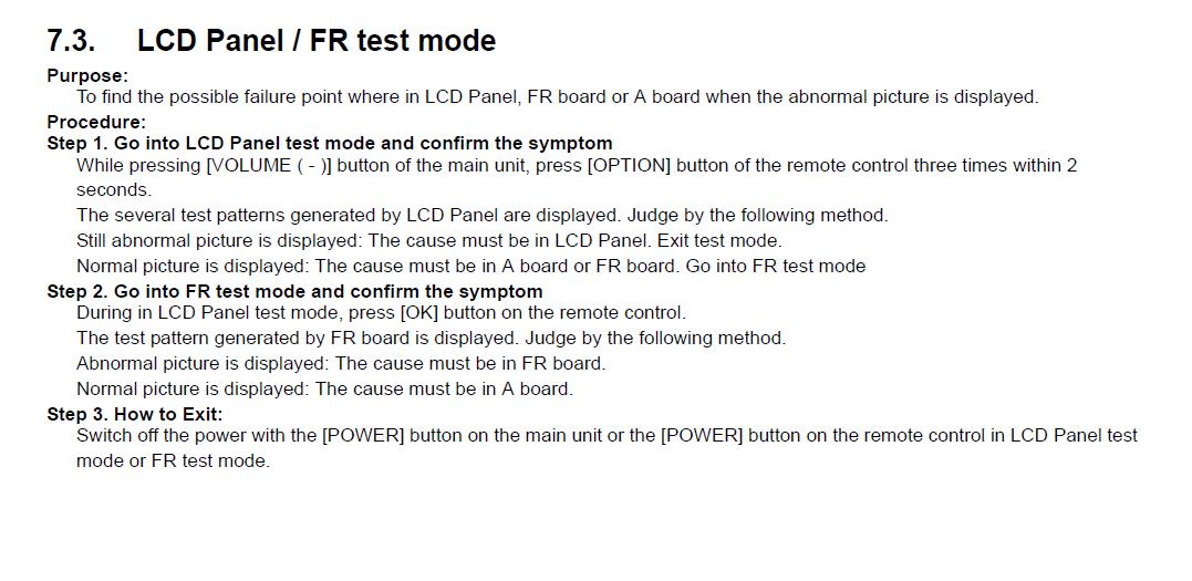

          Does this work? it is from the service manual
            It was the first thing i tried. It doesn't work,
            because of the fast switching off /on cycle of the relais.

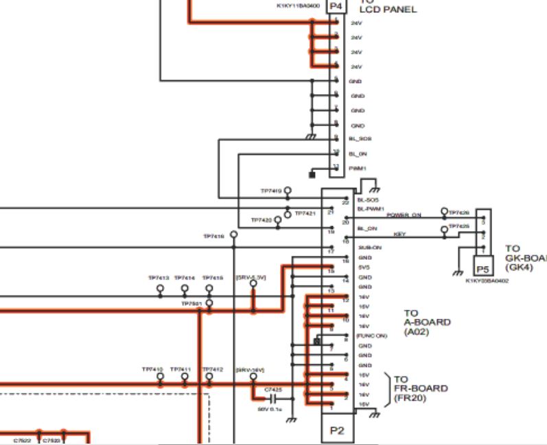

              Unhook cable from powerboard to mainboard, check for steady voltage at standby pin of powerboard.

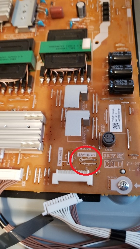

                I did what you said. Attached the part from the circuit drawing of the PSU output, the total view of the PSU board and the meassure point for - in my opinion - the standby voltage.
                With the A-Board unplugged, i meassured 5.2V constantly and no any clicking of the relais.
                  Maybe check the voltage regulators on the maibboard.
