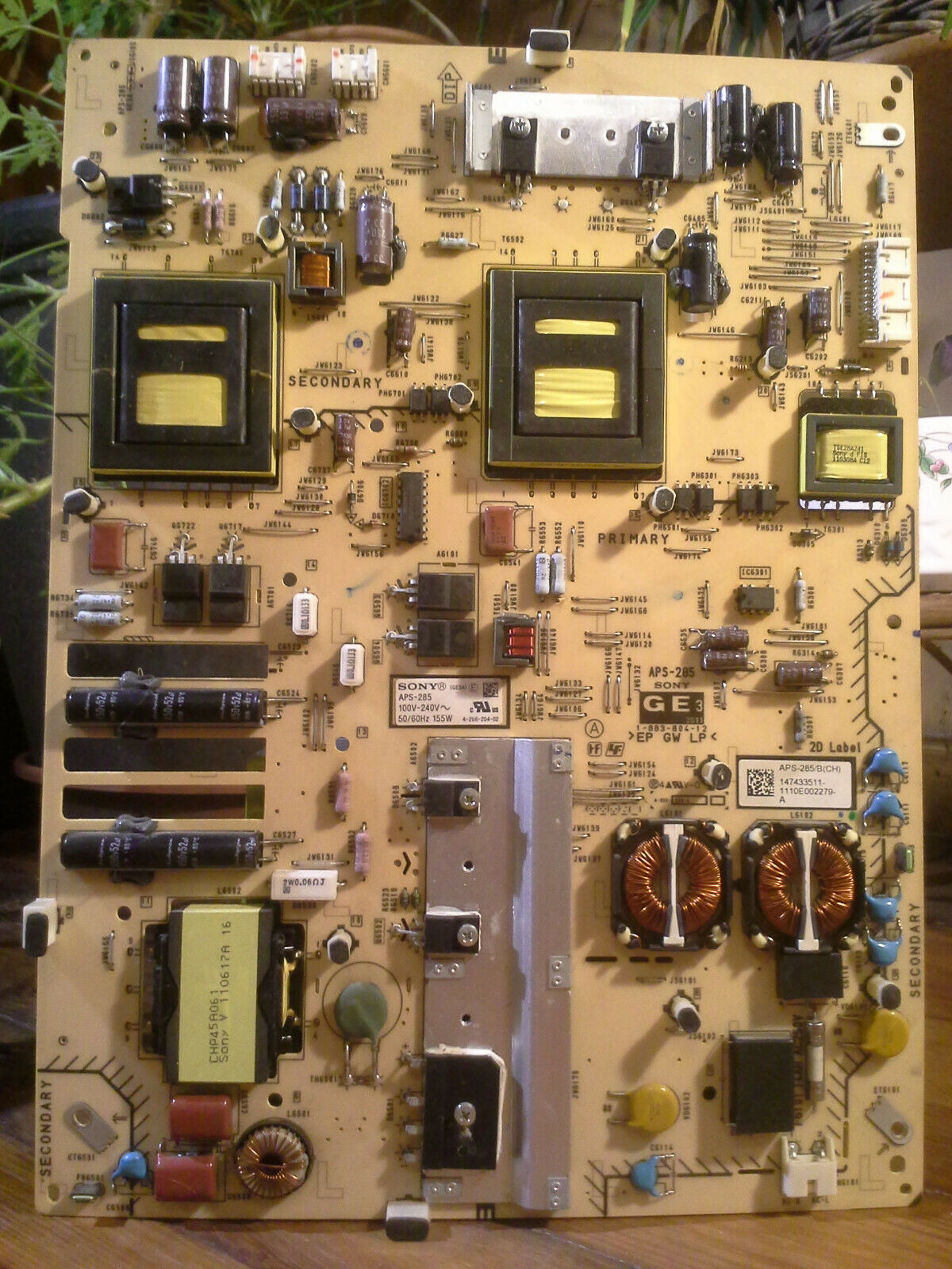

    Woke up and started more troubleshooting on the Sony Bravia.
    In a totally different post, I mentioned no power.Tested fuse soldered onto power supply board at the bottom right of
    the picture and now its reading bad.Not sure how I missed it,but this is what I found.Are these pretty straightforward to
    replace? Are these sold with the wire soldered on both ends?

    Re: KDL-46EX523 Power Supply Board
    Digikey has them, https://www.digikey.com/products/en/...=1&pageSize=25
    But what caused it to blow?

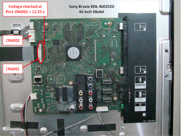

          So did you replace the fuse or what?
          https://www.badcaps.net/forum/attach...0&d=1578169542
          Are you showing that now you have 12vDC at CN601?
            Good morning,
            Troubleshooting has been put on hold for now.Family matters to attend to.
            Thanks for asking!
