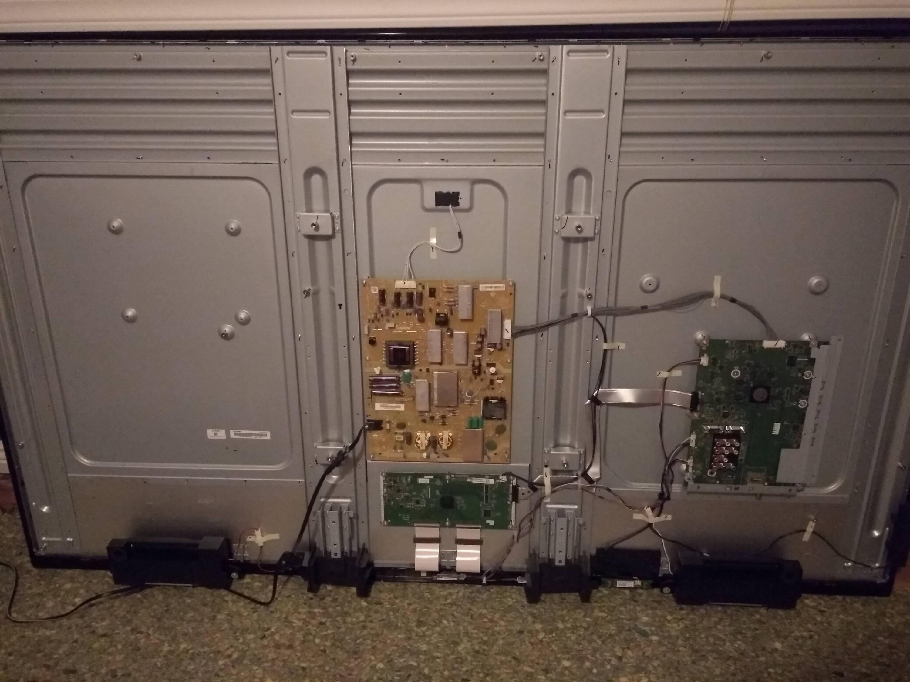

    Did you open up the TV and actually listen closely to hear where the noise is coming from? If you lightly press on the boards, does the noise change?
    Pleas upload the pictures of the whole backside of the TV showing all the boards.

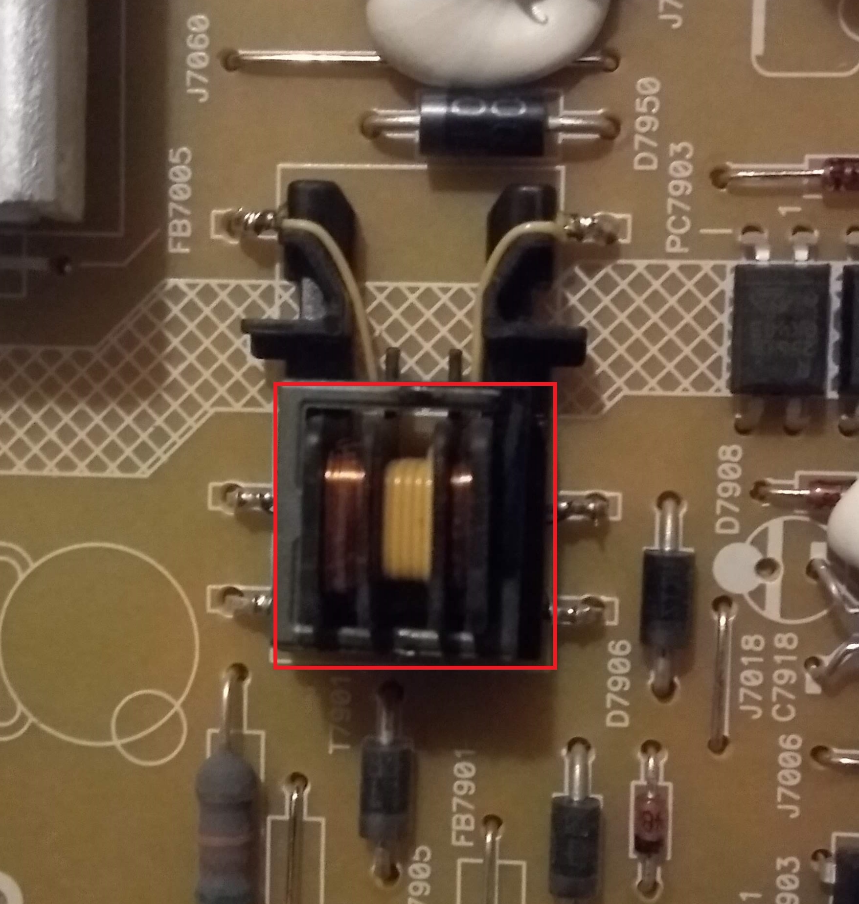

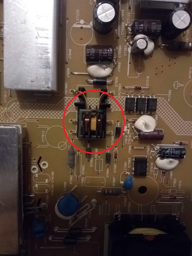

        Thanks for the response! Attached is an image of the full backside of the TV, the main board, and the component that I think is making the noise. Is this a coil? It's a little hard to isolate the noise and tell which component is making it, even when holding a cardboard tube up to my ear, but I'm pretty sure it's that little guy. Tapping on/pressing on the component doesn't seem to change the noise, though sometimes it will have a clicky noise that sounds a little bit like a hard drive.

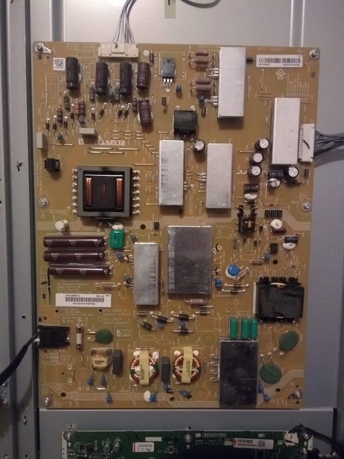

          That is not what it is usually called mainboard, that is power supply, the item is a standby supply transformer, it is useful to check for high ripple in the electrolytic capacitors in the area, using an oscilloscope or maybe a frequency meter, or check their esr.
            Re: Sharp Aquos lc-70le650u - Hissing sound from main board
            That transfomer has ferrite core with two half are jointed together, so look real close at the two joints to see if they have a gap or the core is loose.
            The TV functions fine, correct? and nothing change on the screen when it makes clicking sound either, right?

              I don't see any gap between the joints, and the core looks good to me. I tried tapping it because I read somewhere that can sometimes help, but it didn't. I'm not sure what you mean by checking for ripple in the capacitors. I borrowed a friend's multimeter and tested some of the components, but I don't really know what I'm doing. Is there something I could safely put on the noisy component to quiet it down? Is the component something I could replace fairly easily by soldering on a new one? Or would it be best/easiest to just replace the whole board?

                you will not find the right part on sale, this is a custom part, those gaps are usually covered by glue, i suggest you to get a hot glue gun and glue the ferrite around against the pcb.

                  Thanks for the info! If I am understanding correctly, I should try putting glue around the base of the component - where the red line is?

                      I put a good amount of glue around the base of the component, but it didn't resolve the issue. Is it ok to put glue on top of it, too?

                        Start by replacing the two small electrolytics C7907 and C7918. It could be the noise is caused by the standby ic not operating properly and the waveform is a bit erratic.
                        You could also replace C7303, C7950A & B, the standby output voltage caps

                          Don't waste money/time, if you press a piece of sponge on it when it is working and it makes no changes the the glue is not right, you can take a plier and press very gently the two ferrite halves one against to other, if it doesn't change i guess there's another part that makes the noise.
