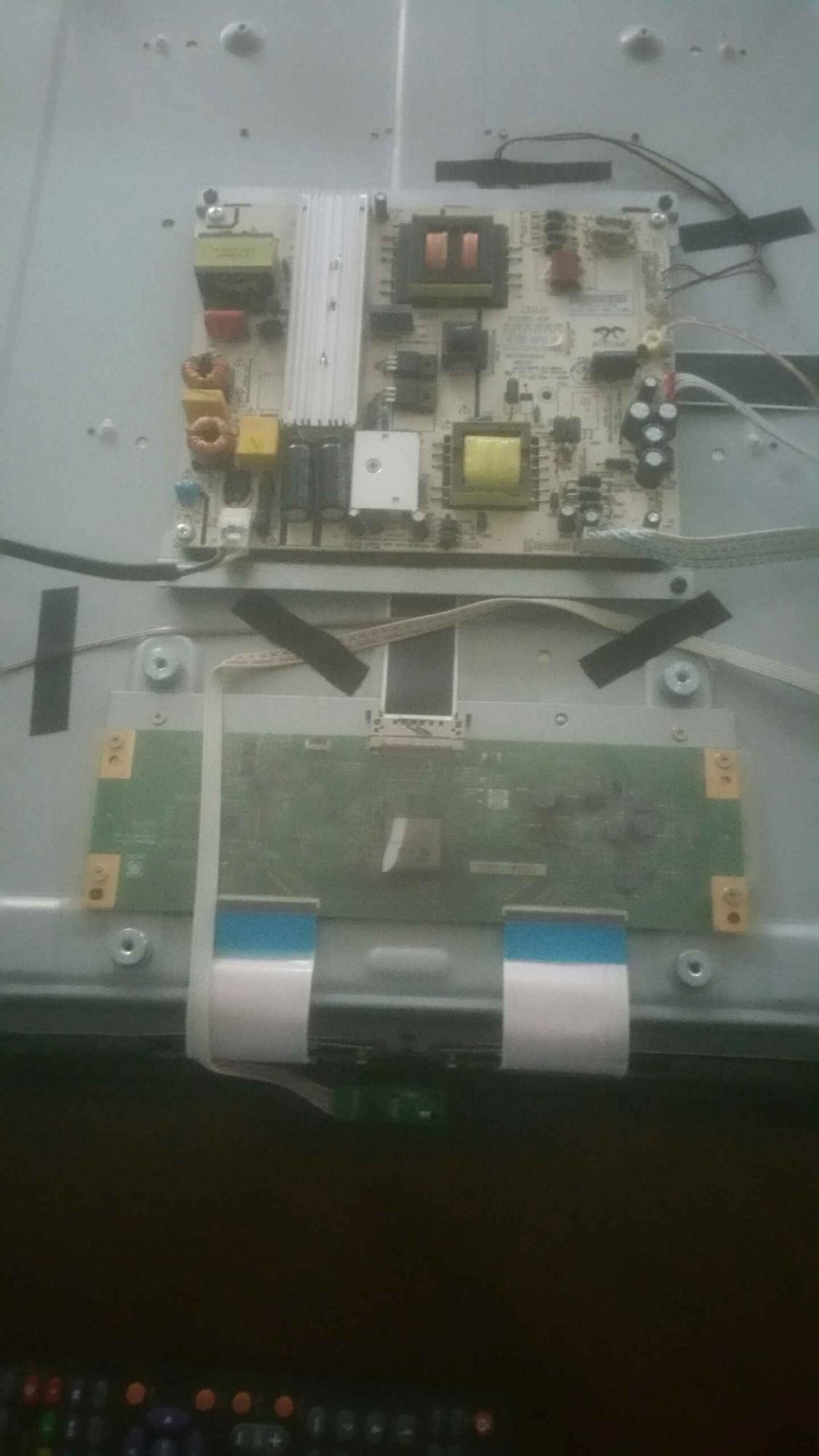

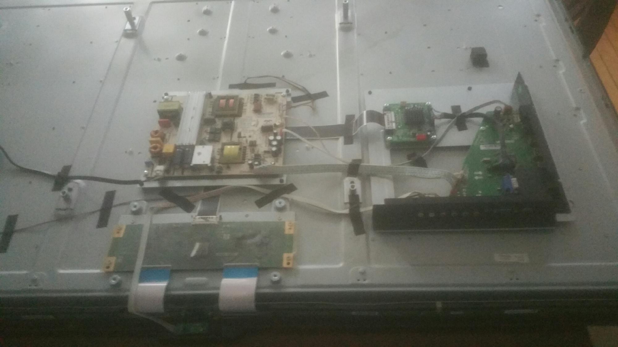

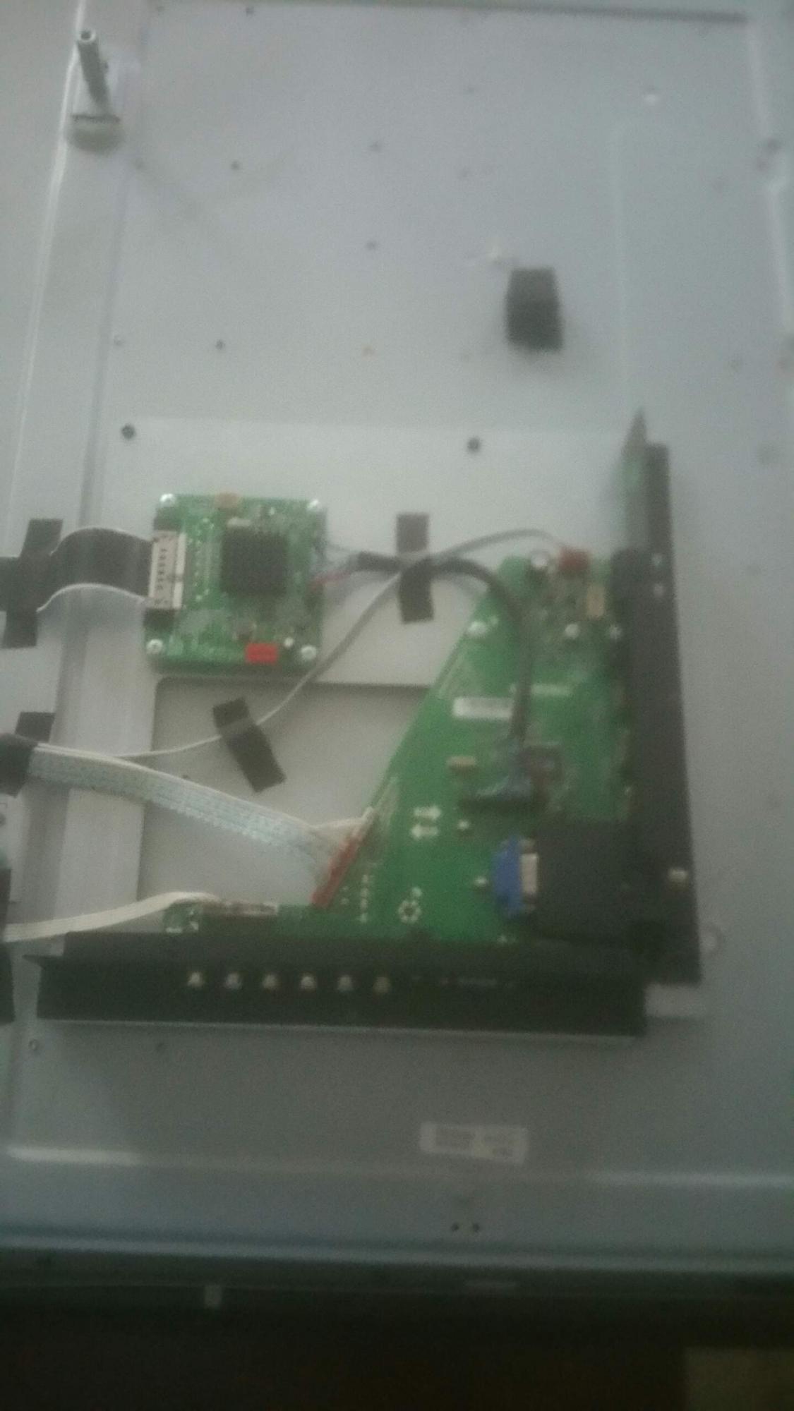

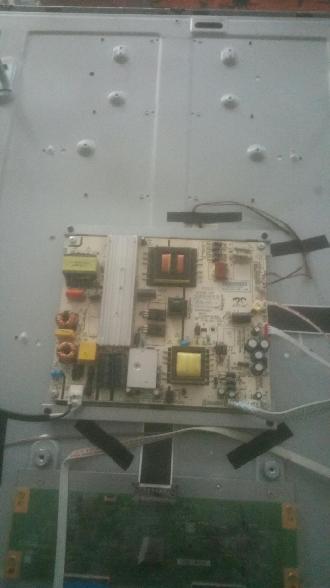

    Hi All'
    I'm new to the site and not very good at electronics. I have this 50" Sceptre Model E55 .I have no picture but have audio . I want to confirm the audio as I was not there when the TV was taken out of service.(My son said there was Audio)I did try a flashlight test and found screen black with no Menu image. I have Red power light that turns blue when turned on .I removed the back cover and can't see anything Burnt or puffy Caps.Well that's all I have for now. Hoping someone can help steer me to a fix.I bought a new TV so I have time to tinker with this.Here's some Pics to get started.

    Seems like bad Backlights at first reading. Measure the voltages wrt chassis GND. If the Backlights are bad you would get a +ve reading on the +ve LED wire and 0V on the -ve wire.

      Check if you have about 12 volts on each side of the t-con fuse, multimeter if you have one, set at 20 vdc, black probe on metal chassis back red probe on each side, as always BE VERY CAREFUL working aroud powerboard, there are DEADLY voltages on the HOT side, this test is on tcon of course not powerboard.

              So do you get the backlights or not?
              Your TV has the FRC board (the board between T-CON board and the Main board).
              I need better and clearer pictures of the boards, the pictures are not clear enough for me to read anything on the boards.

                Well the wife had me move it for Thanksgiving. She didn't like me using the dining room table for a work bench. I'll probably hold off until after the Holidays. I will have my son take better pictures when I get back to this as my outer lens is smashed on my phone and doesn't focus well. Also no back lights.
