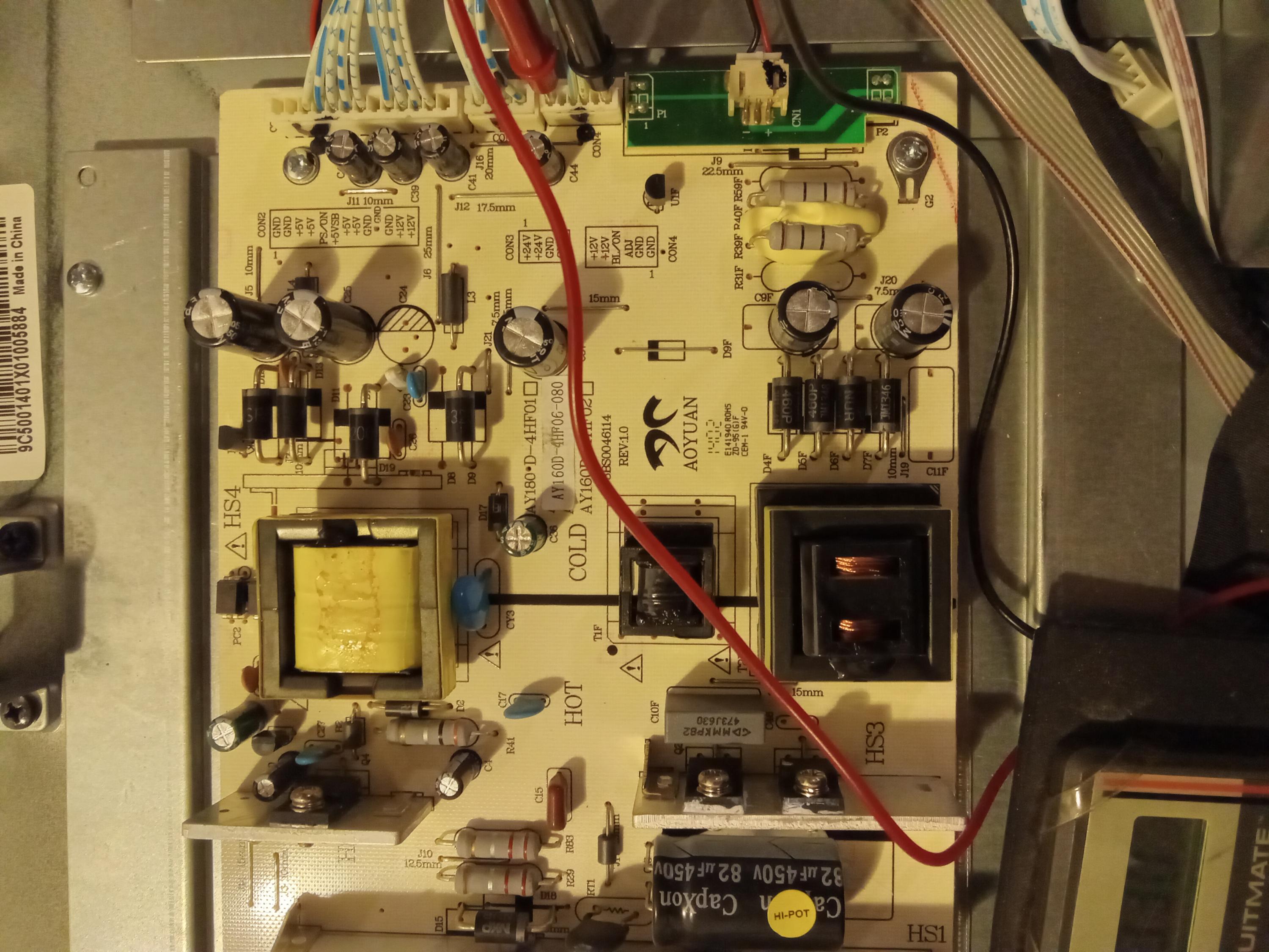

    Hello all,
    I have a Sceptre X505BV-FMDR8HJ1PE8 tv that had been gradually over time taking longer
    and longer to come on, now it will no longer display any image. Original symptoms
    are the red standby LED would turn to blue immediately when pressing the power on
    button, but there would be a delay for the "SCEPTRE" image to appear on the screen
    and backlight to come on. The delay kept getting longer, then it would go from blue
    LED back to red. Then when I pressed the power on button again it would bring the
    display up and work fine. The delay kept getting longer and longer, now the image
    and backlight will not come up at all, just the blue LED remains on. I cannot see
    an image with a flashlight either. The gradual delay made me think I was having a
    capacitor going bad, but inspection of the power supply board shows no bulging caps
    or hot spots on either side. Voltage readings below seem normal except for the 12V
    which varies between 13.48 and 13.53, which after it is on a while, will eventually
    drop down a little and toggle between 13.28 and 13.32 (highly suspicious I suppose).

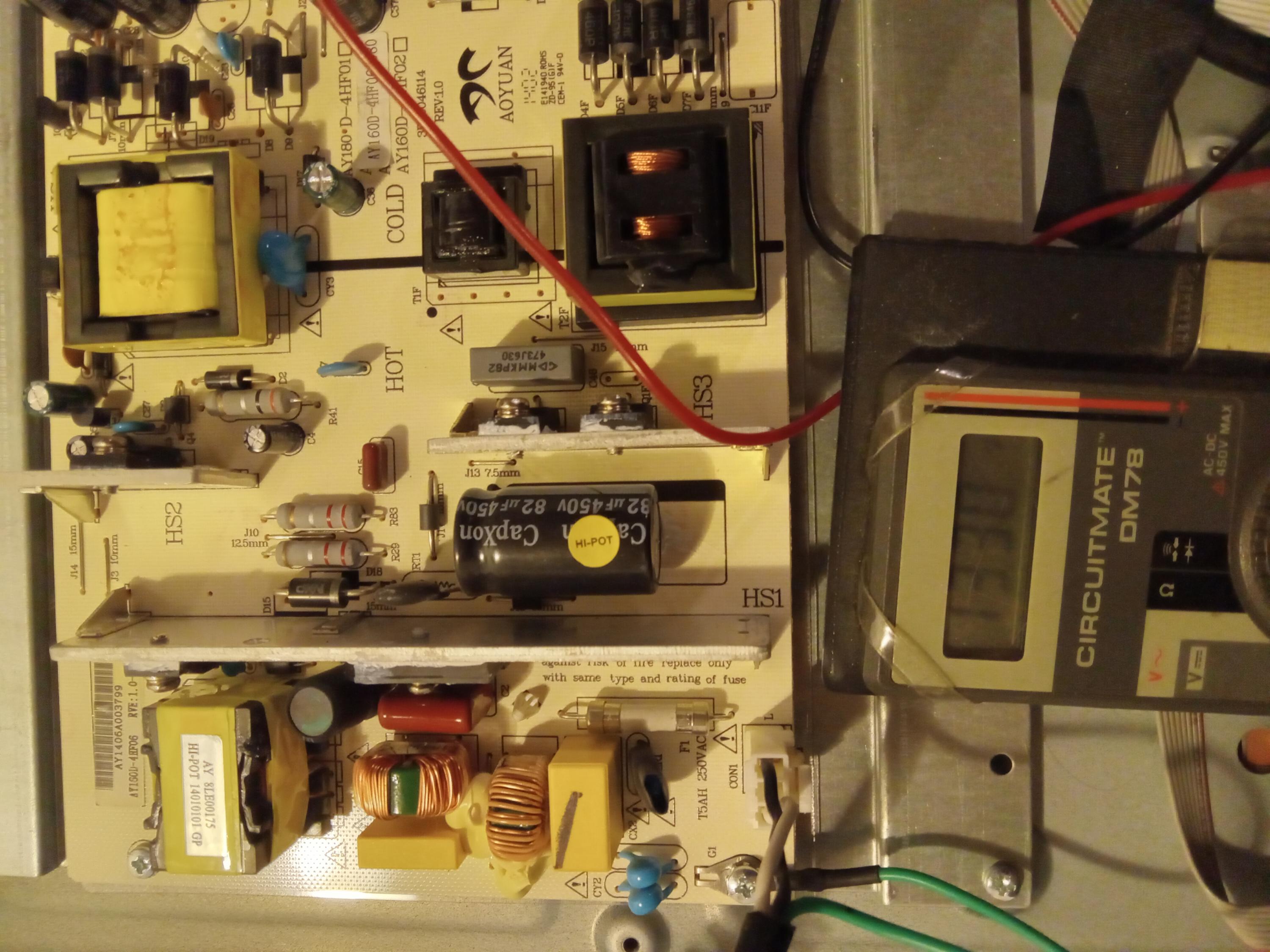

    This tv has the AY160D-4HF06-080 power supply board. Can anyone give me any clues
    on which component on the board controls the 12v line or what to try next? I am
    going to try to post a picture of the board. I've got old eyes, so trying to follow
    traces on the board is a bit of a challenge. :-)
    5V = 5.12v
    24V = 24.7v
    5VSB = 5.12v
    PS/ON = 4.53v
    BL/ON = 59mv
    ADJ = 5.05v
    12v = 13.50v
    backlight plug = -.691v
    Tom H.

    Bulging caps isn't the only indication a capacitor is bad. You have to test them. Voltage should no be dropping like that and I would suspect the power board in this.
    The real way to test the caps would be to remove them from board and test them (I think, sort of new here) or use a dscr meter.
    What do the main caps read when the TV is on? Does the voltage drop or stay same?
    But 12v lines shouldn't be 13.5 either that's too high.
    Are you trying to fix this on a component level or just replace the board

      Thanks for the response. I am trying to figure out if I can bring that 12v line to the correct level if I can determine which caps/regulators are involved. ShopJimmy does have the power board but not the mainboard available. I'm concerned that the mainboard may have been compromised due to the fact that I see no image with a flashlight, so I didn't want to buy just the power board and have that not help. Plus, I don't have a backlight tester and am unsure if I can jumper it safely in some manner to get power to the BL plug/jack to see if there are any issues with the LED's in the backlight on top of the 12v power issue. I realize that often caps don't bulge when failing, that's why I was wondering if there were specific caps to replace since this seems to be a common power board in these flatscreens.

        Heat the electroltic caps on the powerboard with a hairdryer for a couple minutes, then try the tv, don't wait til it cools off to try it, see if there's any change if only for a bit.

              I tried heating up the caps on the cold side of the board. The only voltage that changed was the 24.7v went up to 25.2v, then once the board cooled down it went back to 24.7v. The 5v remained at 5.13 and the 12v remained at 13.5v.
              After this, I unplugged the cables from the mainboard to take it out of the picture, jumpered the PS/ON to the 5VSB with a 1k resistor and measured again:
              24v = 22v
              12v = 12.2v
              5v = still holding at 5.13v
              After that I also added another jumper with another 1k resistor from the 5vsb to the BL/ON and measured again:
              24v = 23.85v
              12v = 11.97v
              5v = 5.13v
              Also, the backlight came on after a 2 second delay at 233v. I checked the front of the panel and there appears to be no dark spots, so I believe the backlight has no problems. So, the 24v came up a little when I also jumpered on the backlight, yet the 12v went down a little bit. 5v still holding at 5.13v no matter what is jumpered or if the mainboard is in-circuit. I'm not sure at this point why these voltages would go up with the mainboard/cables attached to the powerboard. Seems strange to me. The 24 volt cable connects to a 4pin plug labeled as "Amplifier" on the mainboard, so I'm wondering if the 24v is only used for powering the audio section - leaving it disconnected from the mainboard with the other cables plugged in had no affect on the voltages. I don't know if the voltages are higher with the mainboard is in-circuit due to a higher current draw or if I still have a potential capacitor issue. Either way the mainboard is not telling the backlight to turn on and I see no image using a flashlight - not sure if it is safe to jumper the backlight to "on" with the 1k resistor to confirm there is definitely no image with everything connected. It remains with the symptom of the power switch will change the standby LED indicator from red to blue, bring up the voltages, but will not turn on the backlight or show an image from what I can see using a flashlight.
