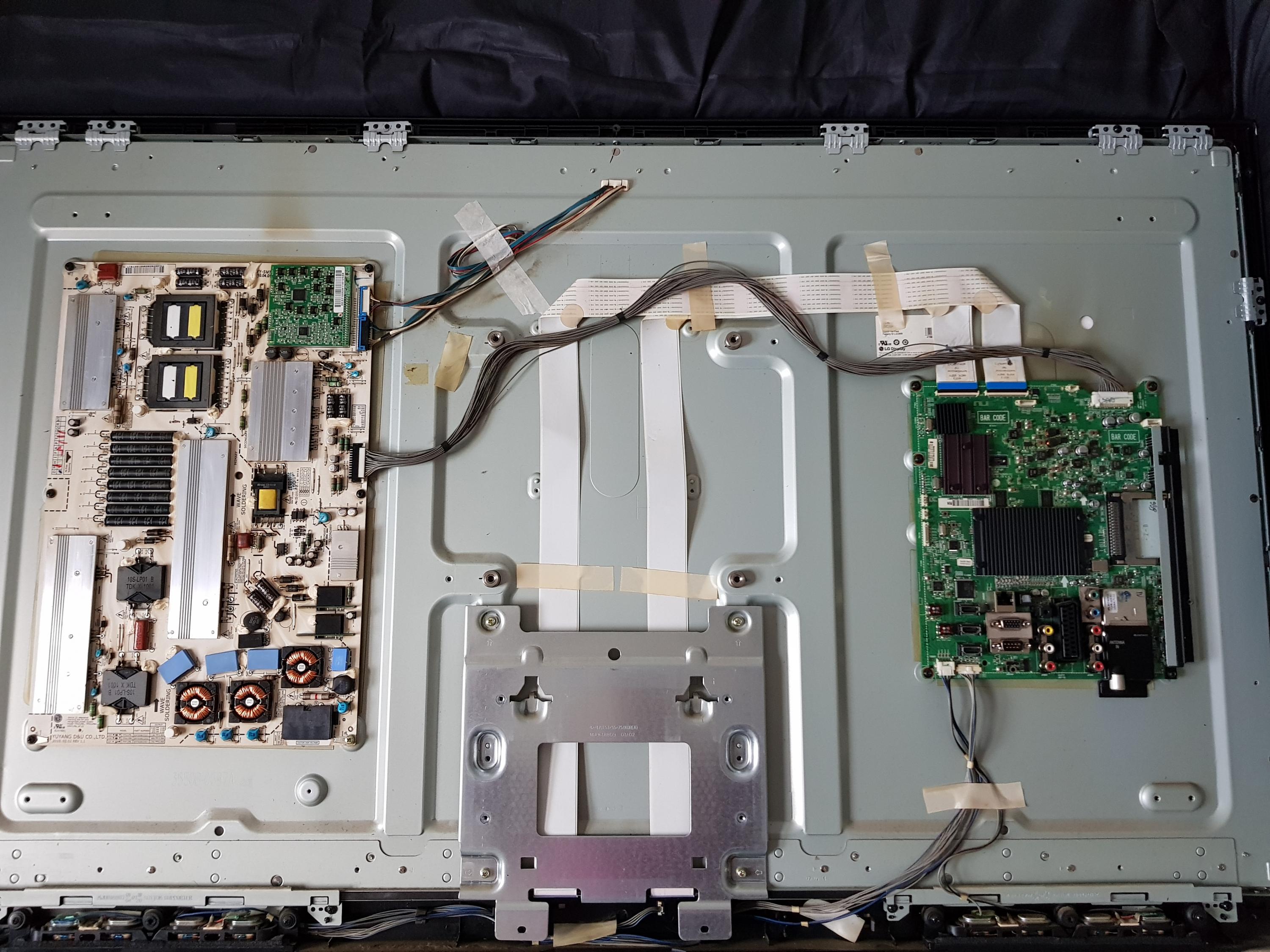

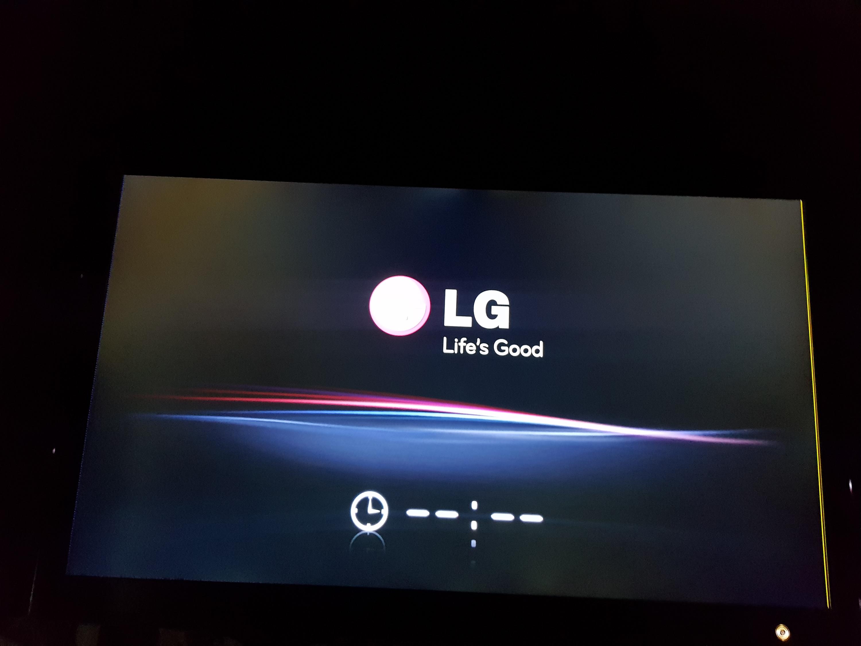

    Hi, I have an lg 47le5900, when you turn on the TV, it starts up fine, LG logo screen comes on as normal, but then nothing, just a blank screen, but a blue line down left side and yellow line down right side, backlights are on
    Have cleaned all plugs n ribbon cables to no avail.
    Any help greatly appreciated

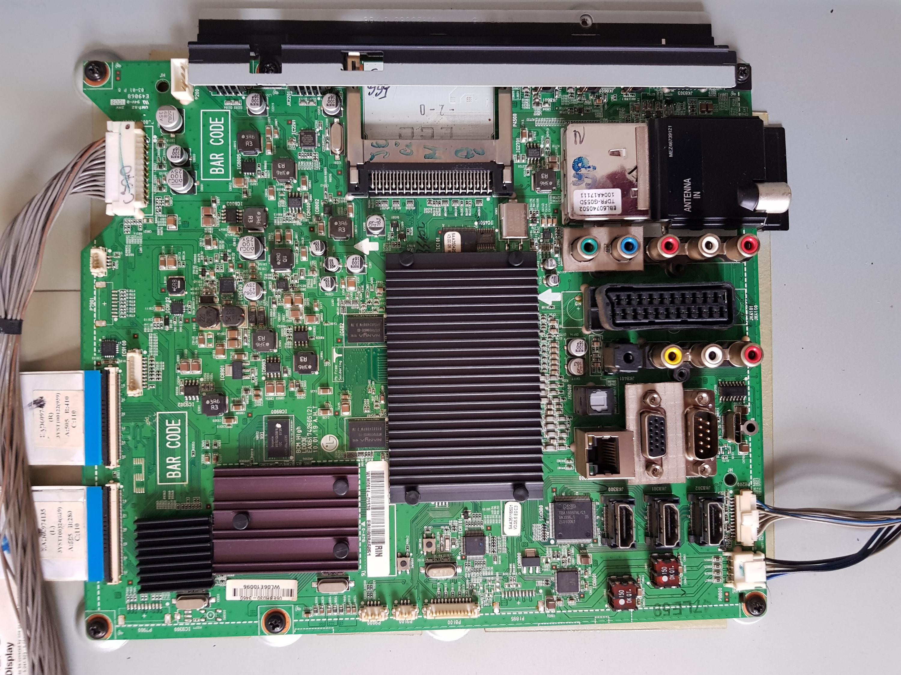

    Re: LG 47LE5900 no picture
    Bad solder on the main processor under the large heat sink in the middle. It needs to be either reflowed (not a reliable, long lasting option) or reballed (much better option but way more difficult).

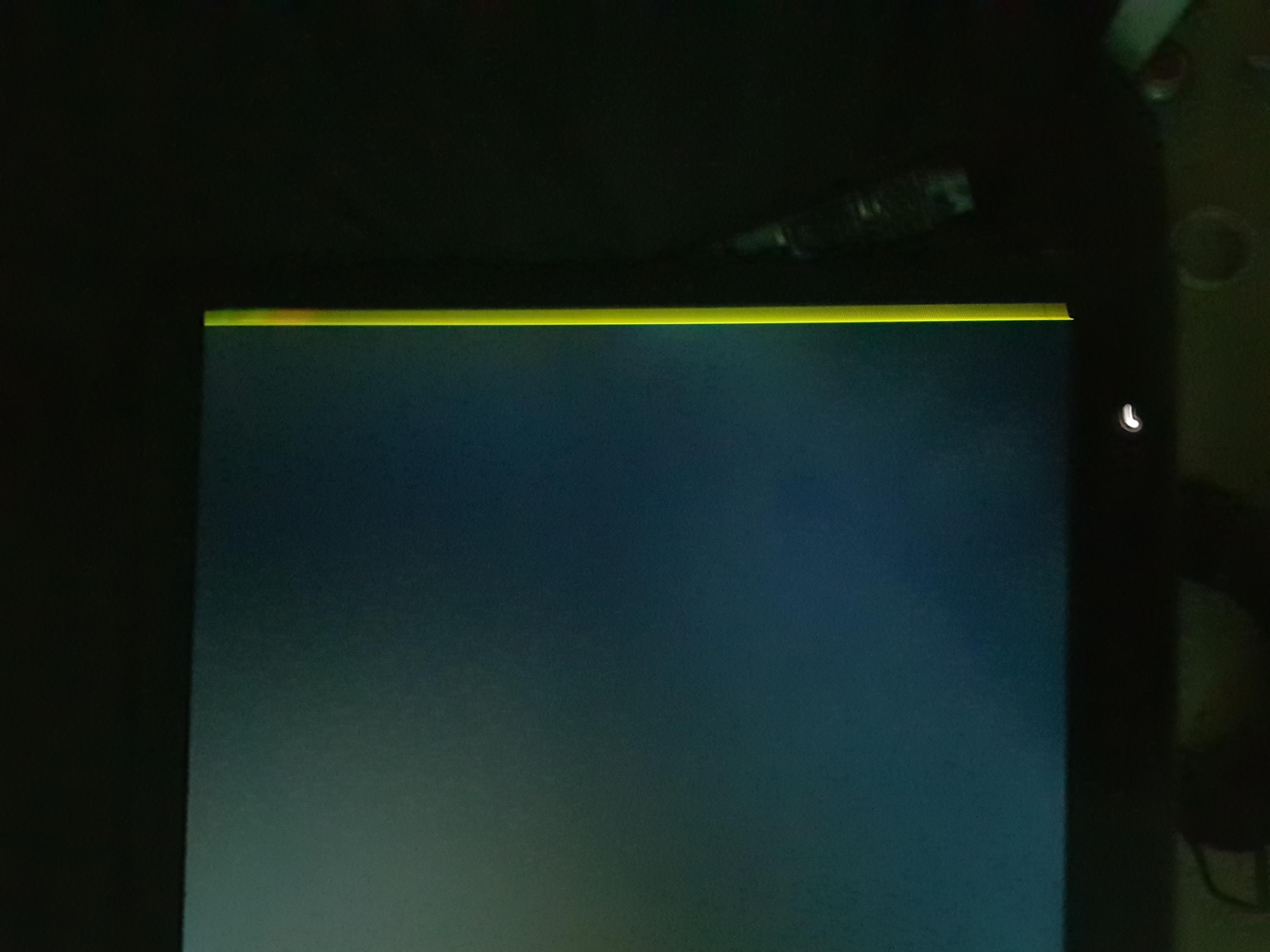

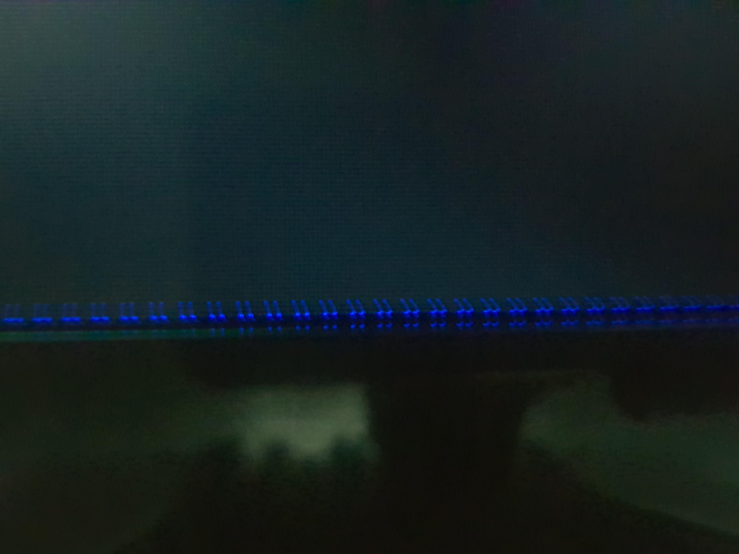

        Reflowed with heatgun, now have picture, but still have the blue and yellow lines on edges, any ideas please?

          Couldnt get lines to go off, so removed bezel and metal frame from around LCD panel, ran a thin line of black insulation tape down each side, reassembled, now cant see lines and tape is barely visable.
