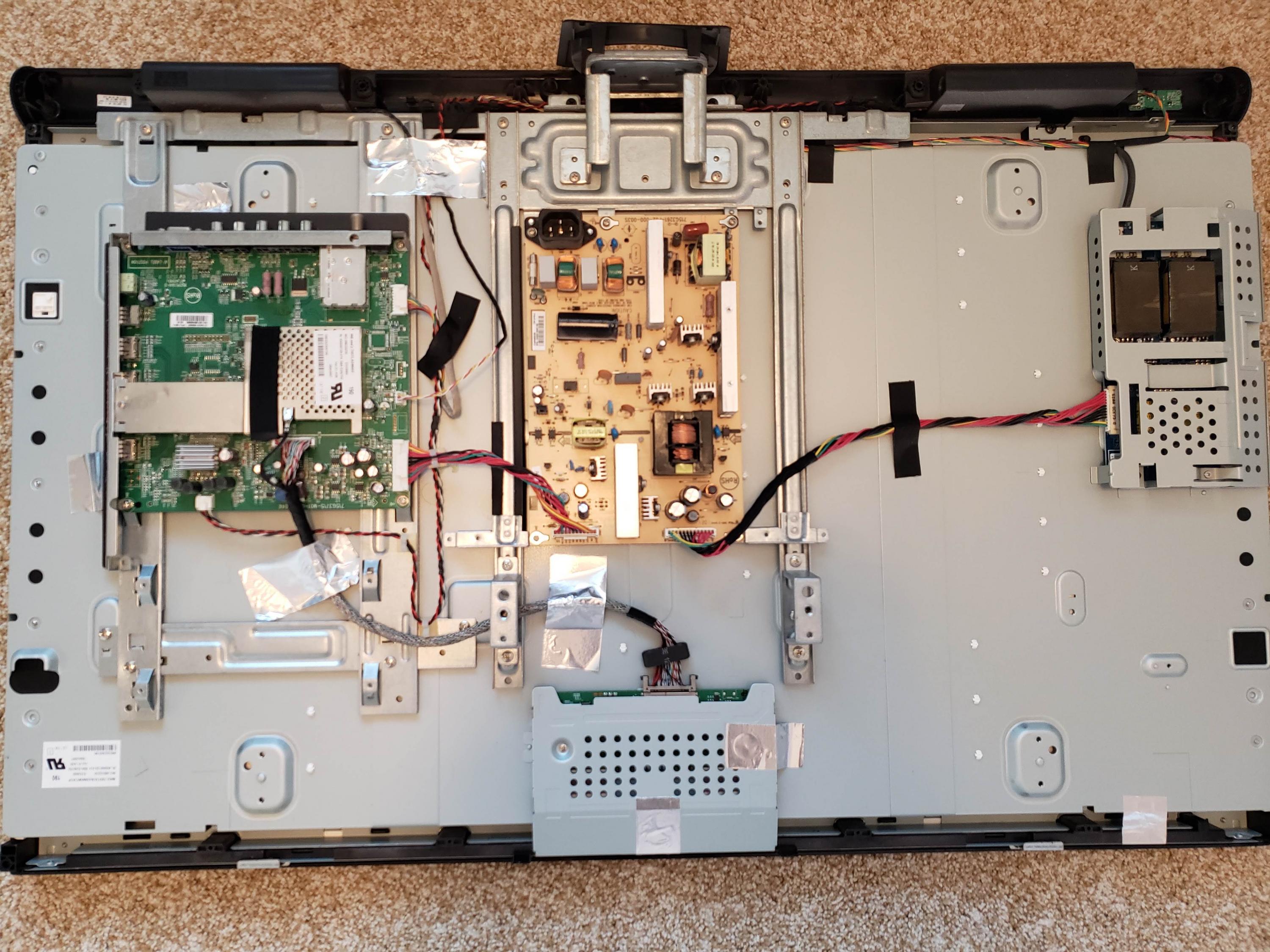

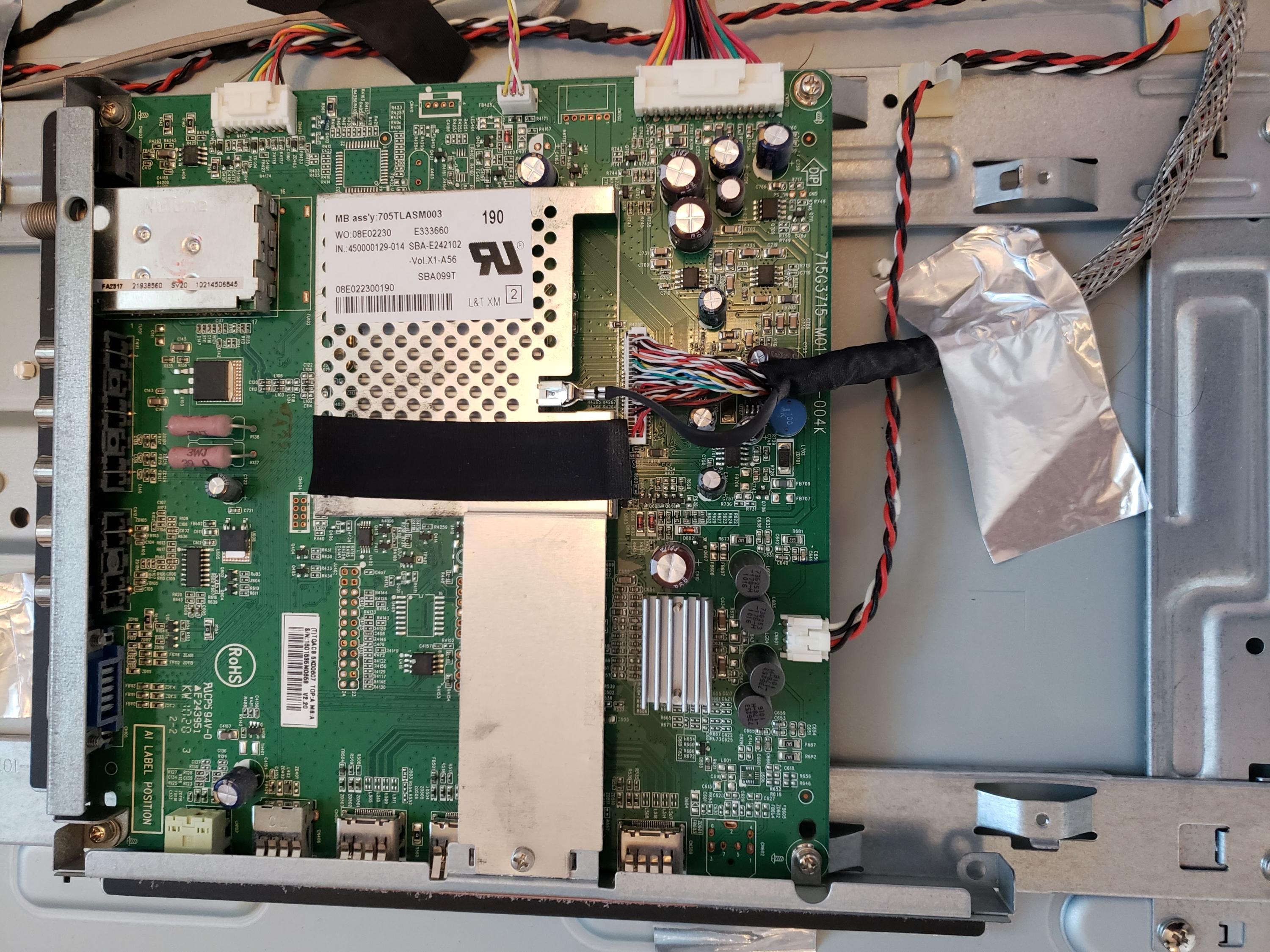

        Post some pictures of the complete rear of the tv so we can see what we are dealing with. You may have a backlight issue. Try shining a flashlight at the screen and press the menu button to see if you can see anything on the screen. You could also try connecting a HDMI source and see if the tv goues to that input and gives you sound etc.

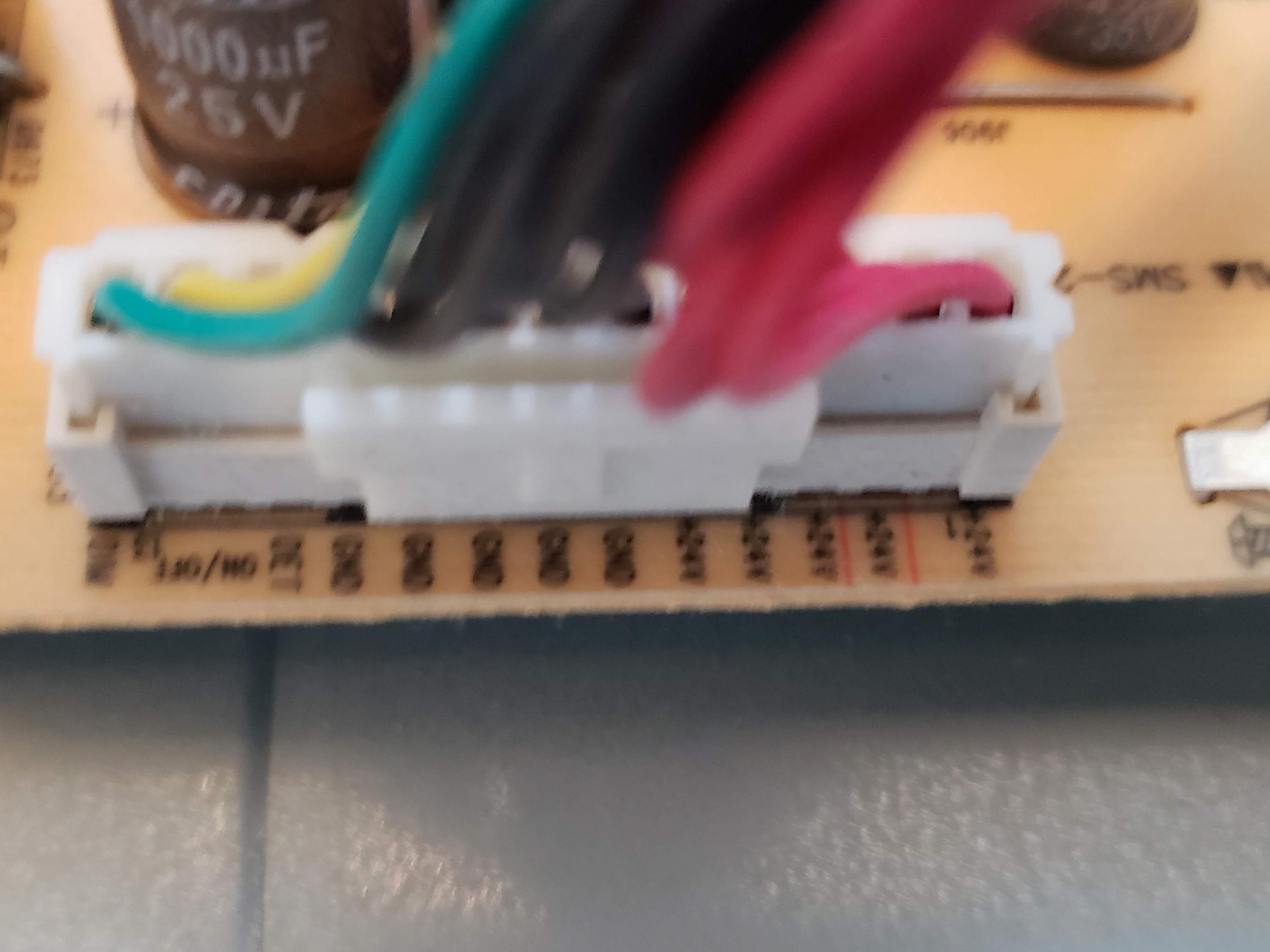

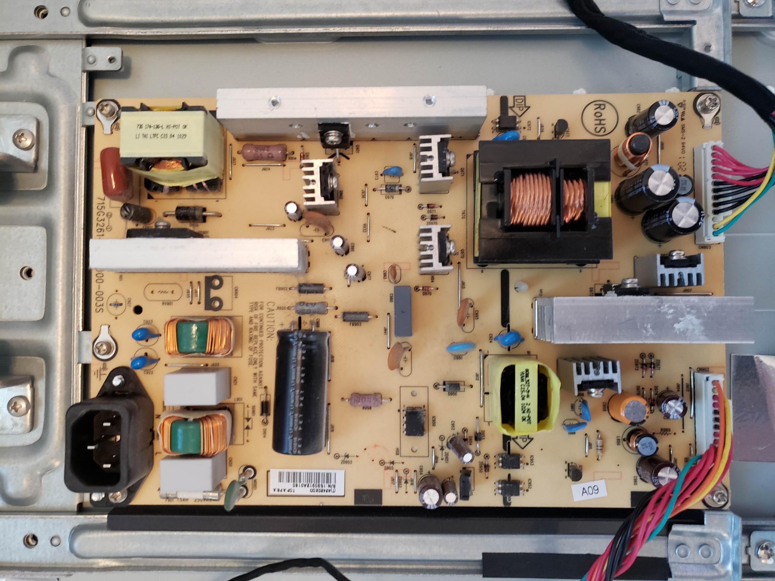

          Several pictures are attached.

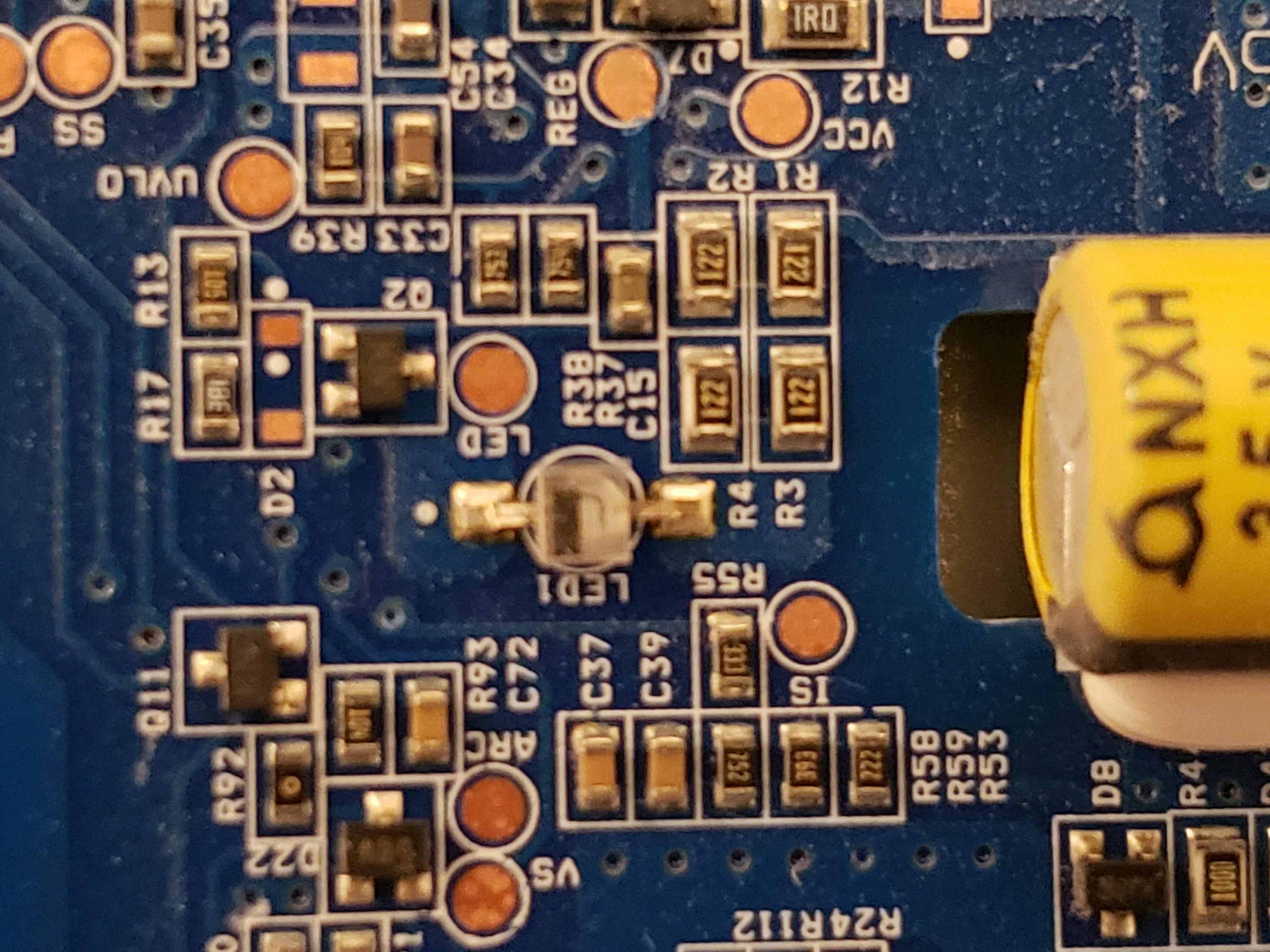

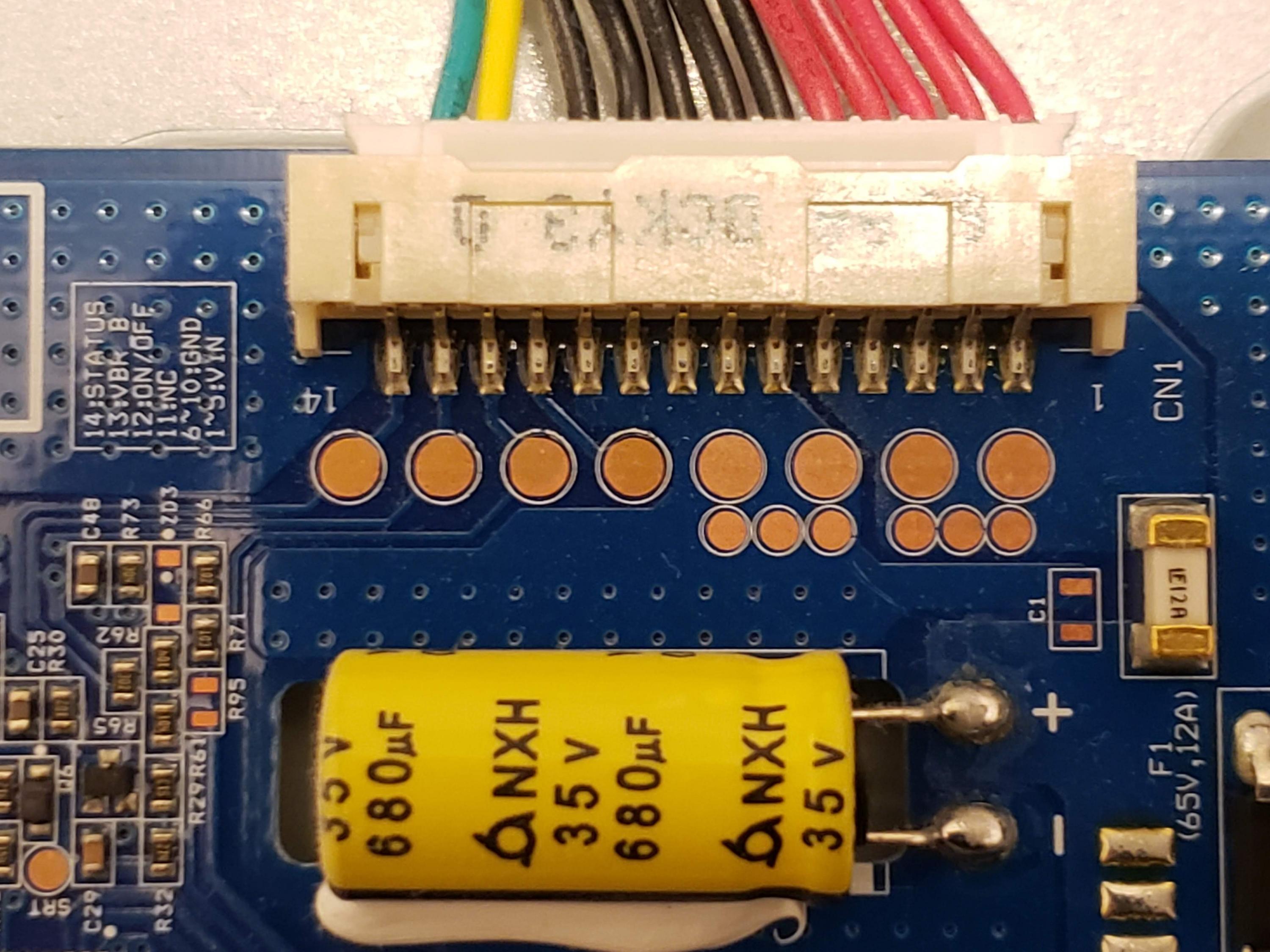

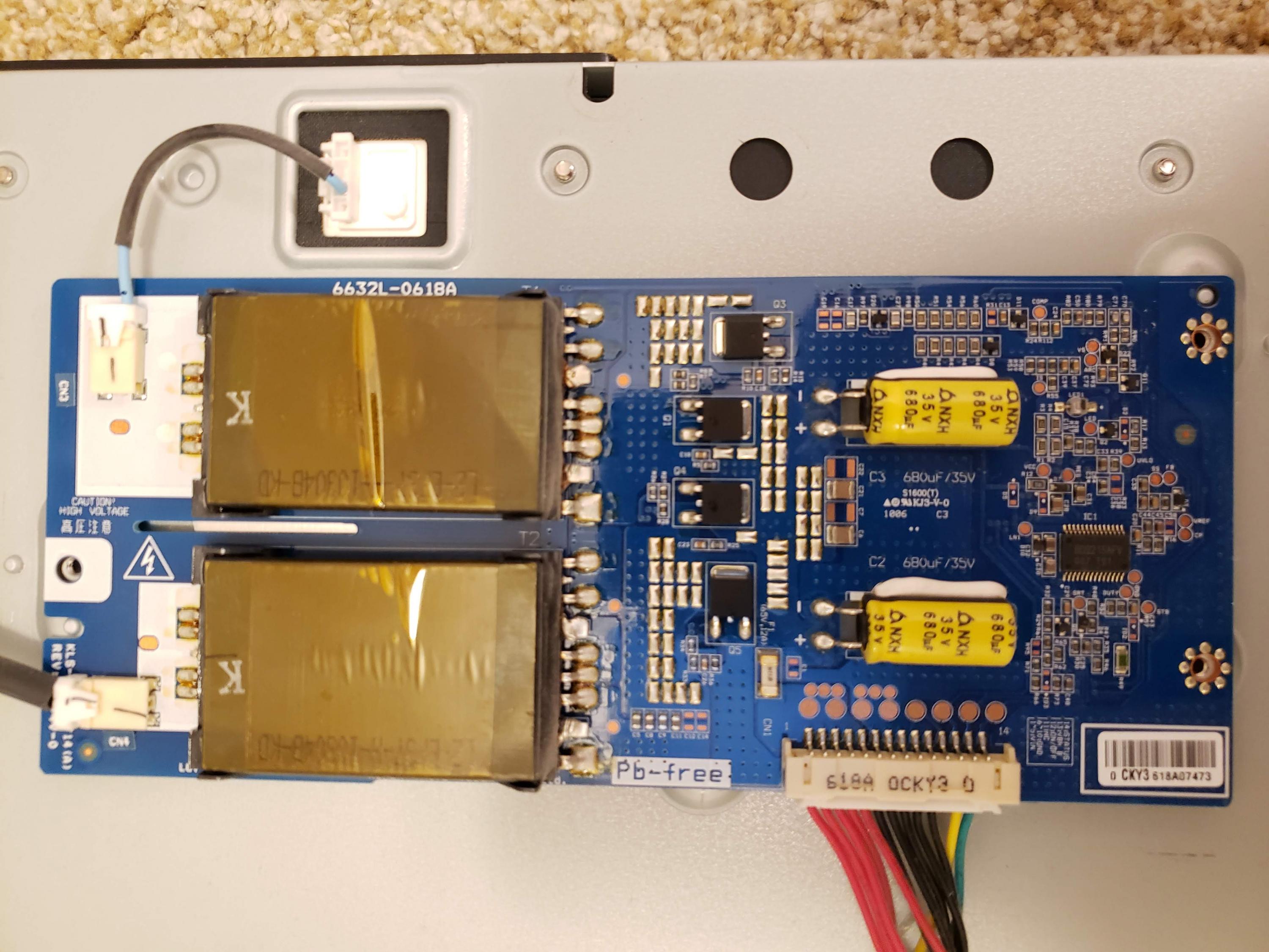

                If you look at the inverter board (small board on the right in pic#1) , there is a small led (LED1)that should light for a few seconds then fade out when the tv is first turned on. If this does not happen, When there is +24 volts at the inverter, check the voltage on both sies of the fuse (F1) and also check the voltages on pins 14,13 & 12.
                Pin 12 is the inverter on/off
                  Re: Vizio E370VA wont turn on

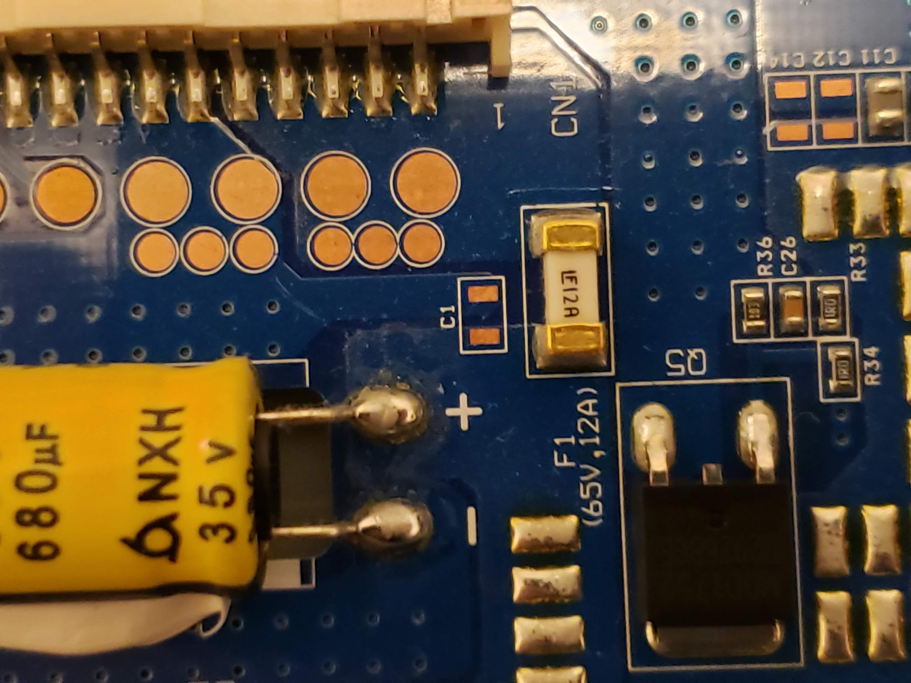

                  The LED1 does not light up at all. When I have 24.6 volts on PIN 1 of the inverter, the F1 fuse measured 24.7 volts on both sides of the fuse. Pin 14 was 0.28V, pin 13 was 2.46V, pin 12 was 0.09V, and pin 11 was 0.10V.
                  I attached some pictures of the inverter board with the cover off.
                    https://www.badcaps.net/forum/attach...0&d=1573102972
                    pin 13 (Dimmer control) was 2.46V,
                    pin 12 (BL-ON) was 0.09V
                    You do not have BL-ON to turn on backlights circuits.

                        PS-ON, BL-ON, DIM signals are from the main board.
                        You can try forcing on the inverter board by disconnecting the BL-ON wire from the inverter board connector then use 1K resistor between the BL-ON pin of the Inverter board and the Standby 5V pin to force on the inverter board.
                        You should read Basic LCD TV and monitor troubleshooting guide.
                          BTW, I do not know which main board you have, but shopjiimy is EEPROM for this TV model, see the description of what the EEPROM will fix.

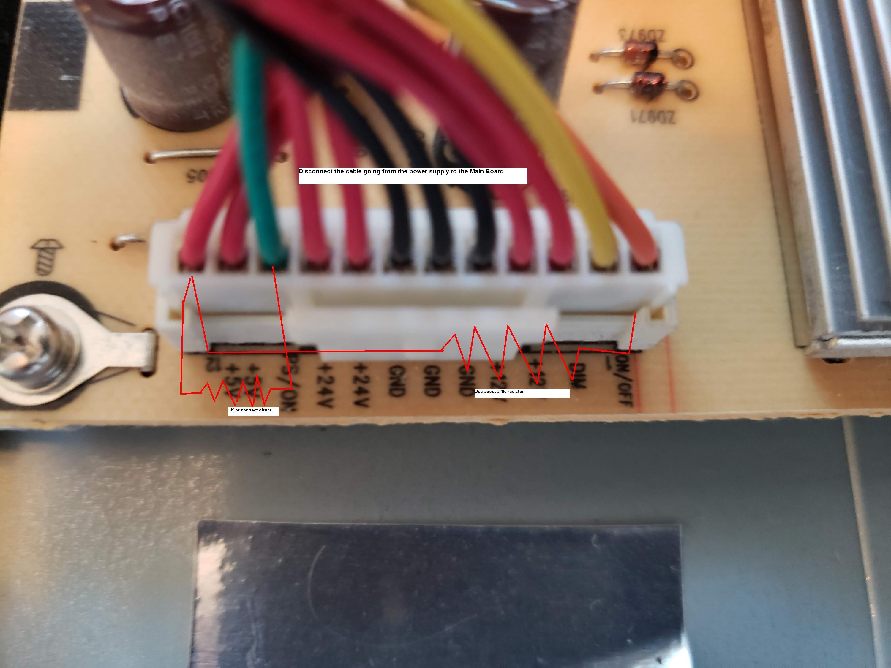

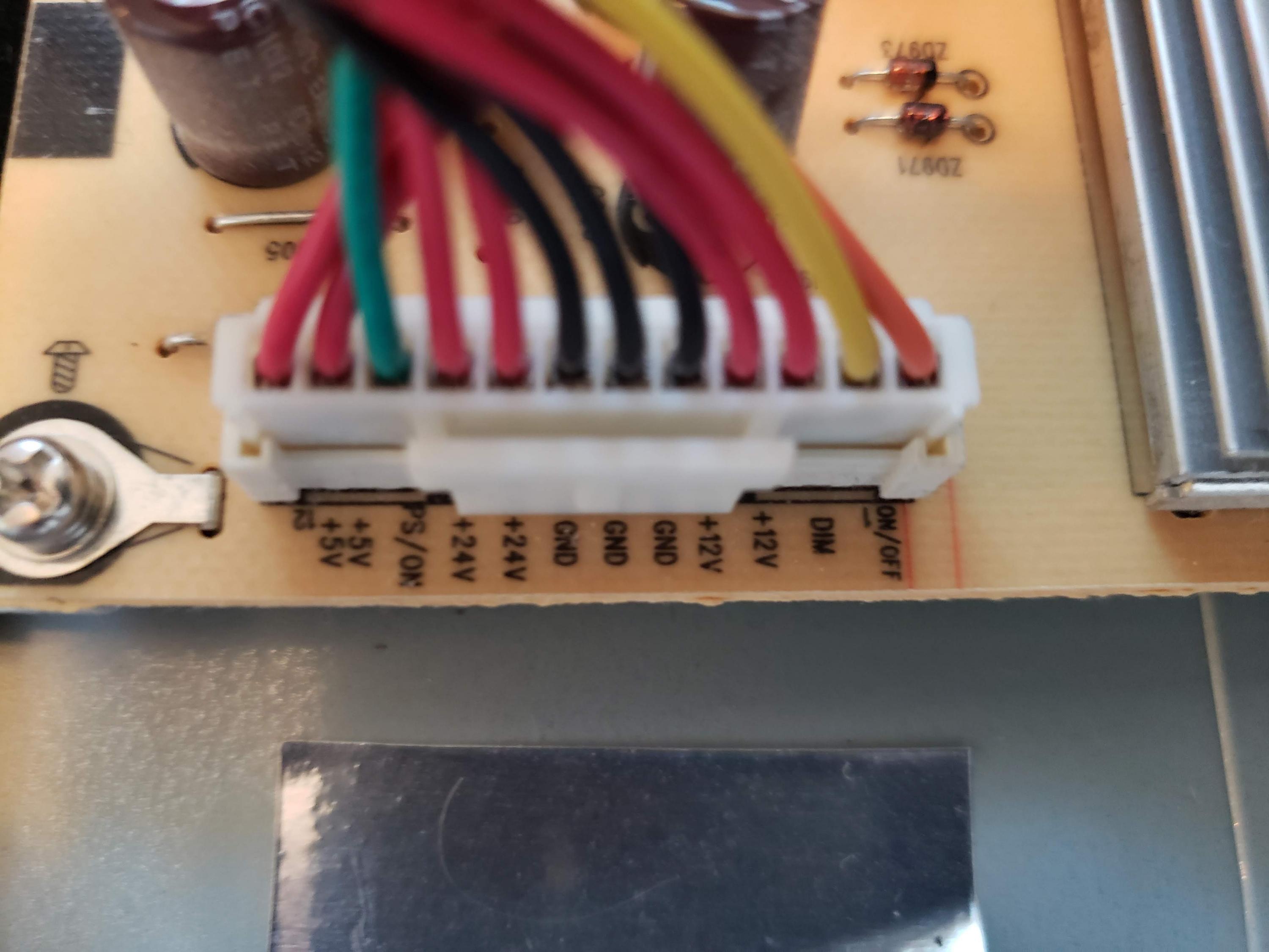

                              If ypou want to check the power supply and inverter/backlights. disconnect the cable from the power supply going to the main board. Then connect about a 1K resistor between the +5V (pin 12 or 11) and pin1 (ON/OFF) then place another 1K resistor between +5V and pin10 (or you can short between pins 10&11) Then plug in the tv. this should turn on the power supply and the backlight (there will not be a picture)
                              You may also need a third 1K resistor between +5 and pin2 (DIM) if the backlights don't turn on
                                If I do this, and the backlight turns on, does it indicate that the power supply and inverter/backlights are good and that the problem is with the main board? Or, could the problem still be with the power supply?
                                  Yes, that test would turn on the power supply, the inverter and the backlights. That would indicate the main board is at fault and could point to a corrupt eeprom.
                                  If you have a can of freeze spray or an inverted can of canned air, you can try this to see if the eeprom may or may not be the issue:
                                  Unplug the tv, freeze the eeprom ic, wait 10~15 seconds, plug in the tv and see if turns on.
                                  If this test does work the fault is with the eeprom ic and the rest of the main board is likely ok. If this does'nt work you could still have a faulty eeprom
                                  Being a Vizio and this model I would highly suspect a corrupt eeprom ic
