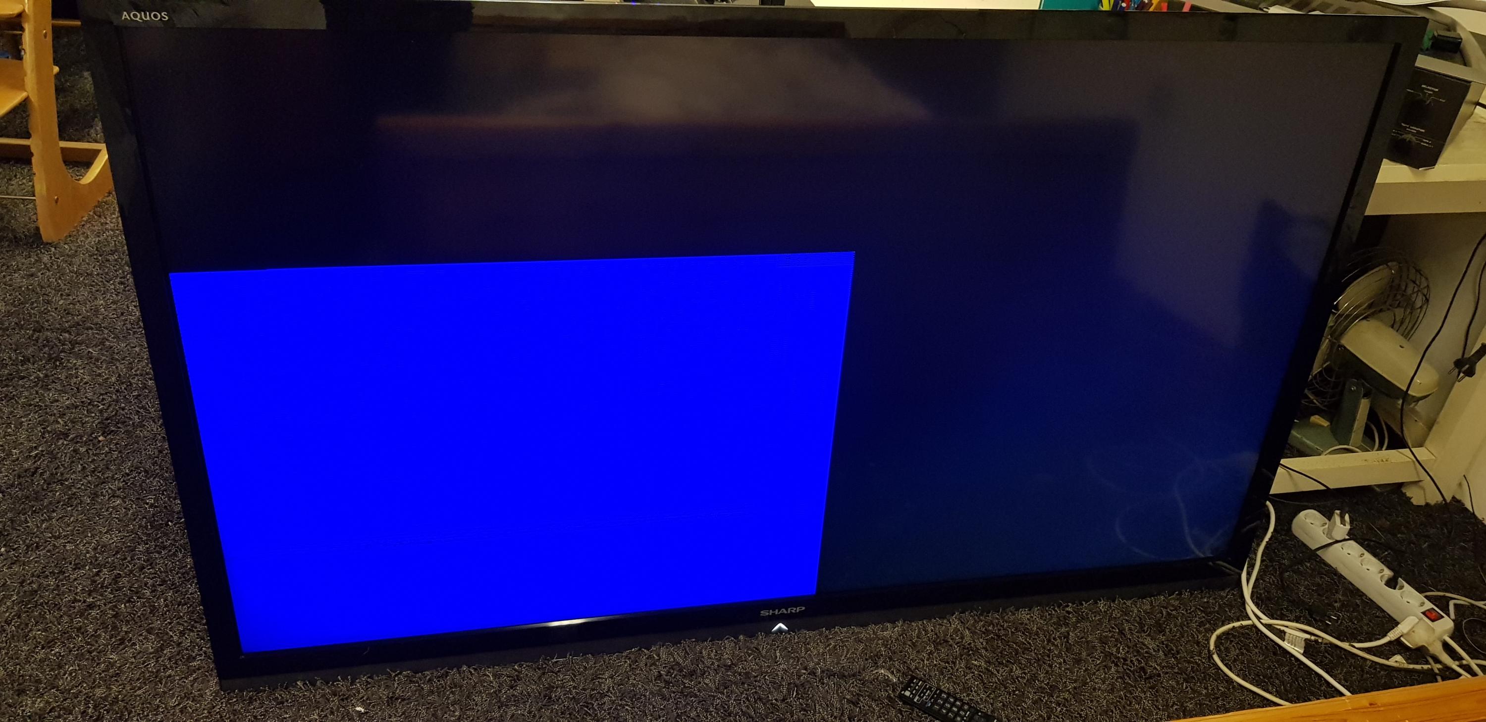

    So I recently fixed my first main board, I should say diagnosed and replaced, to get a 50" Sharp up and running again.
    I've got my eye on another one that's acting up. I haven't gotten my hands on it yet. It's a gamble. But for a 5 year old tv that has seen little use at 70 inches I'm intrigued. I'm pretty sure these things divide the screen up into four sections on the LED driver side, is that right? I had 4 24v out's on the 50" and it's a similar model. Just a wild guess
    It powers up fine, so for now that rules out power board issues, but only gives about a quarter of the screen and it's blue. Nothing else.
    Could this be a driver issue? Happened one day to the next. No falls or anything like that, just boom: it's like this, see attachment.
    It's not a lot to go on but any ideas? input? what to look for?
    I can pull the back off and get relatively far with my DMM but untill then I'm looking to get as much info as possible on probable problems. A lot of p's there...

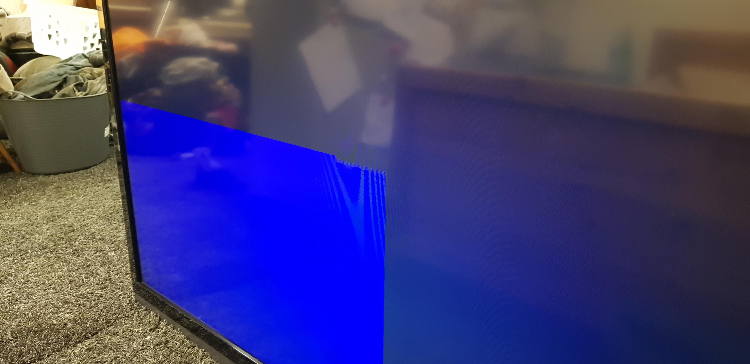

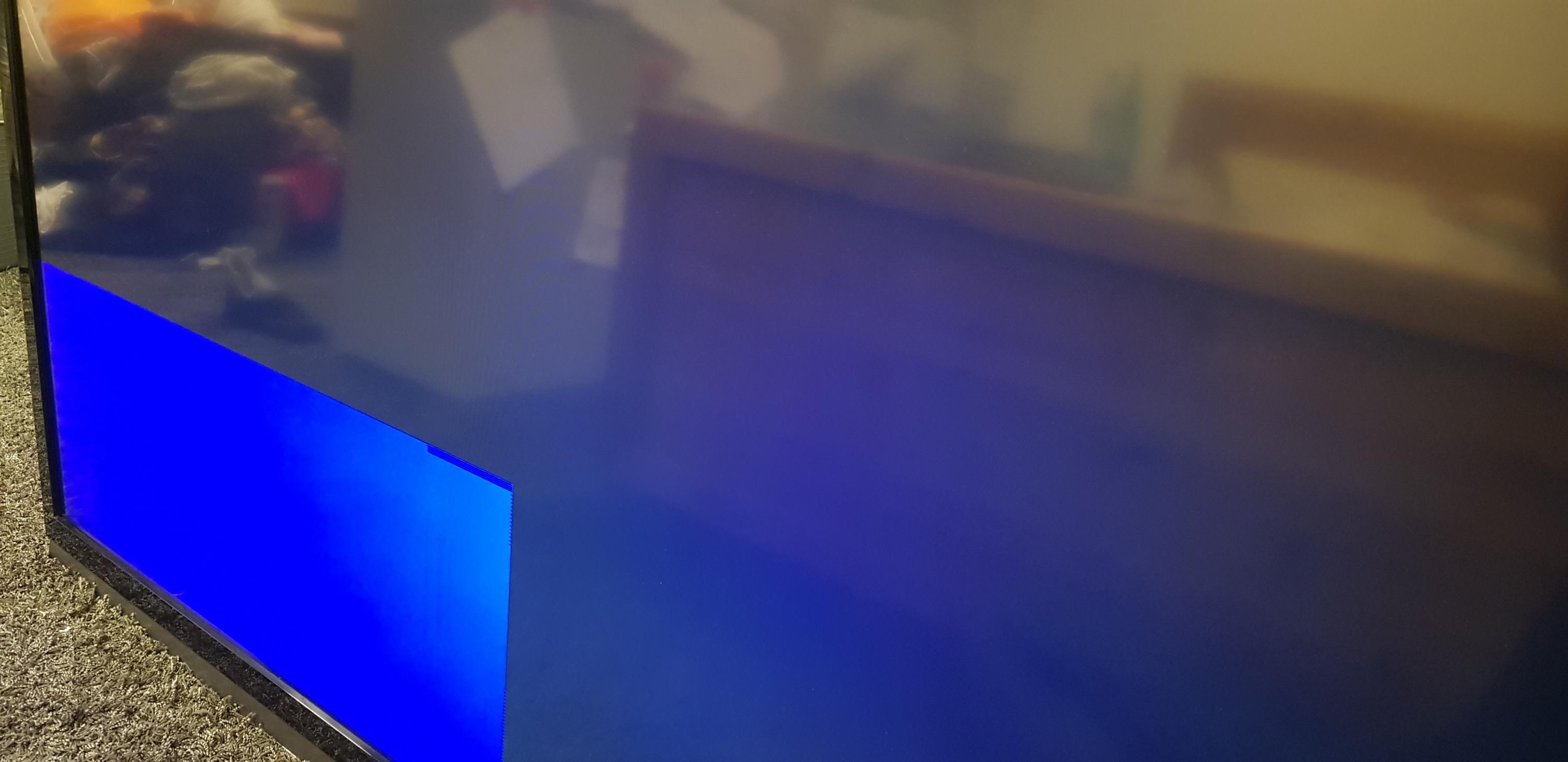

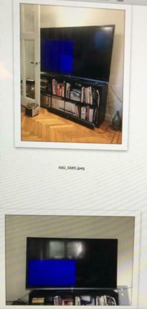

    at this point I have this TV
    The backlight lights up. It has sound. it shows no image whatsoever.
    The first few minutes it gave the blue screen as shown in the pictures above. Though it did stay on the left side size and shape changed a little per power cycle. Once it filled the screen with a purplish hue, the entire screen, giving me some confidence that the LCD panel itself is ok.
    After a few cycles the screen remains blank. The backlight working and sound as well.
    Am I to suspect a faulty T-con board? or could it be the main board graphics processor?
    I suppose both. Neither have any visible issues with capacitors etc.
    A recent fix of a 50" Sharp LCD LED was the replacement of the main board. I was told a common error: that TV refused to boot up though.
    This one starts up. Just no picture.
    The European model designation is: LC-70LE835E
    The US model designation is: LC-70E735U

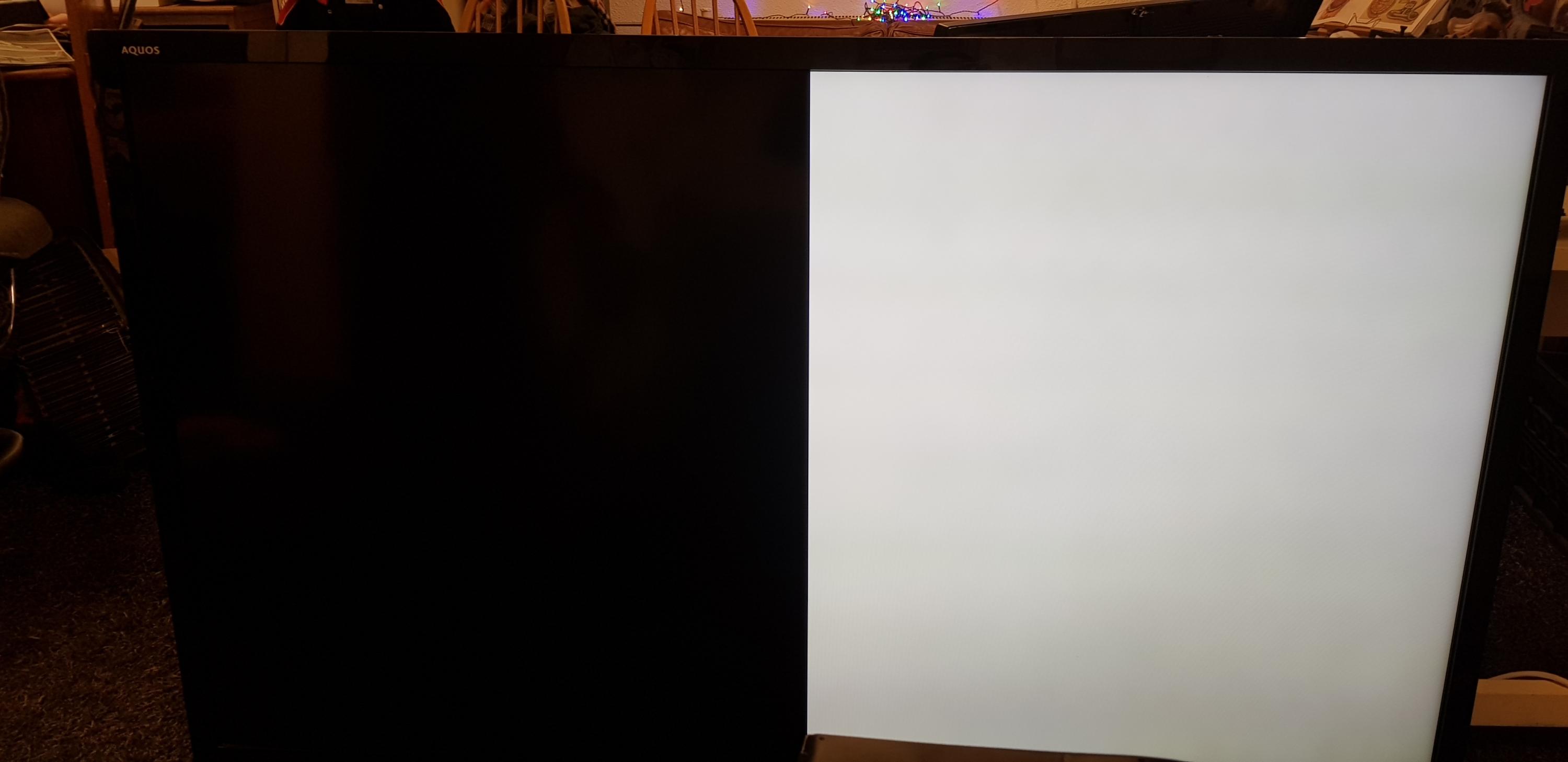

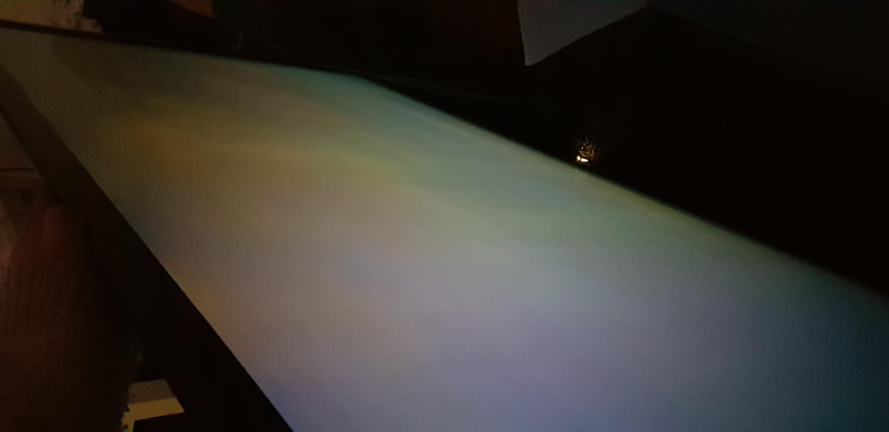

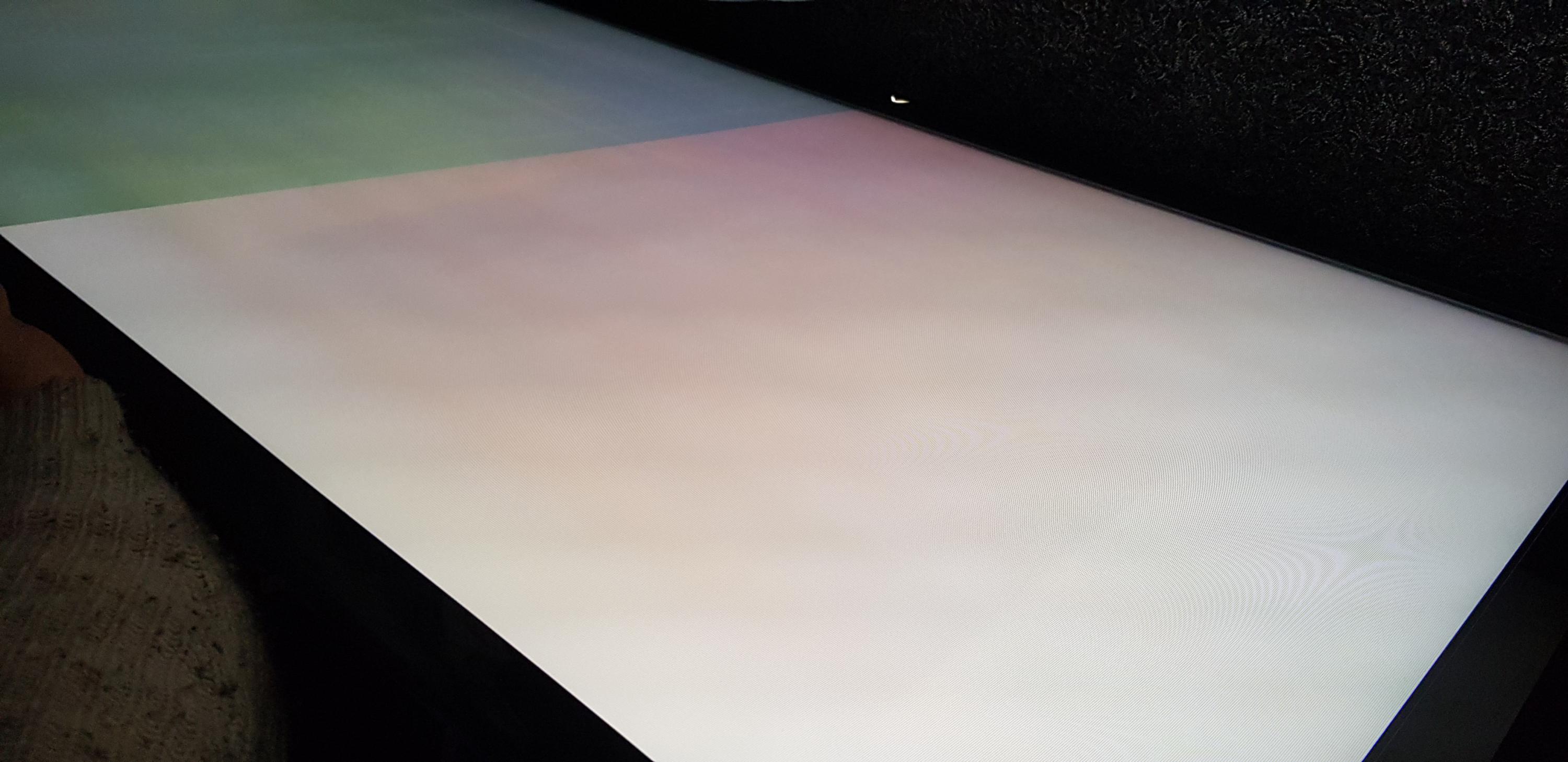

      I just disconnected the Tcon ribbons carefully and I was able to get a full white clear screen on each half. The first time the left half was fully white and right half looked like it had been smashed! all kinds of lines and colours. Put it all back, fired the tv up: blank screen again.
      Pulled the ribbons again. This time the right half was fully white and the left half mostly grey.
      Is it safe to conclude the panel itself is ok?

        Here are some pics.

          Can try cleaning your tcon ribbon cable ends, some use a pencil eraser, also make sure you have a good and clean connection at the lvds cable going from mainboard to tcon, could be a faulty tcon.

              did you got the white screen when you disconnected the ribbon with signal or with out ? you need with signal to see if half screen come out with picture... if you did it with signal then you have much likely issue on main boards

                I disconnected them wihtout signal and with the power off.
                I should do this test with the set on and a signal playing?
                What am I looking for?

                                you should still try doing the "cable removal test" again and feed in an input signal. Depending on the outcome, it will readily point you in a direction.

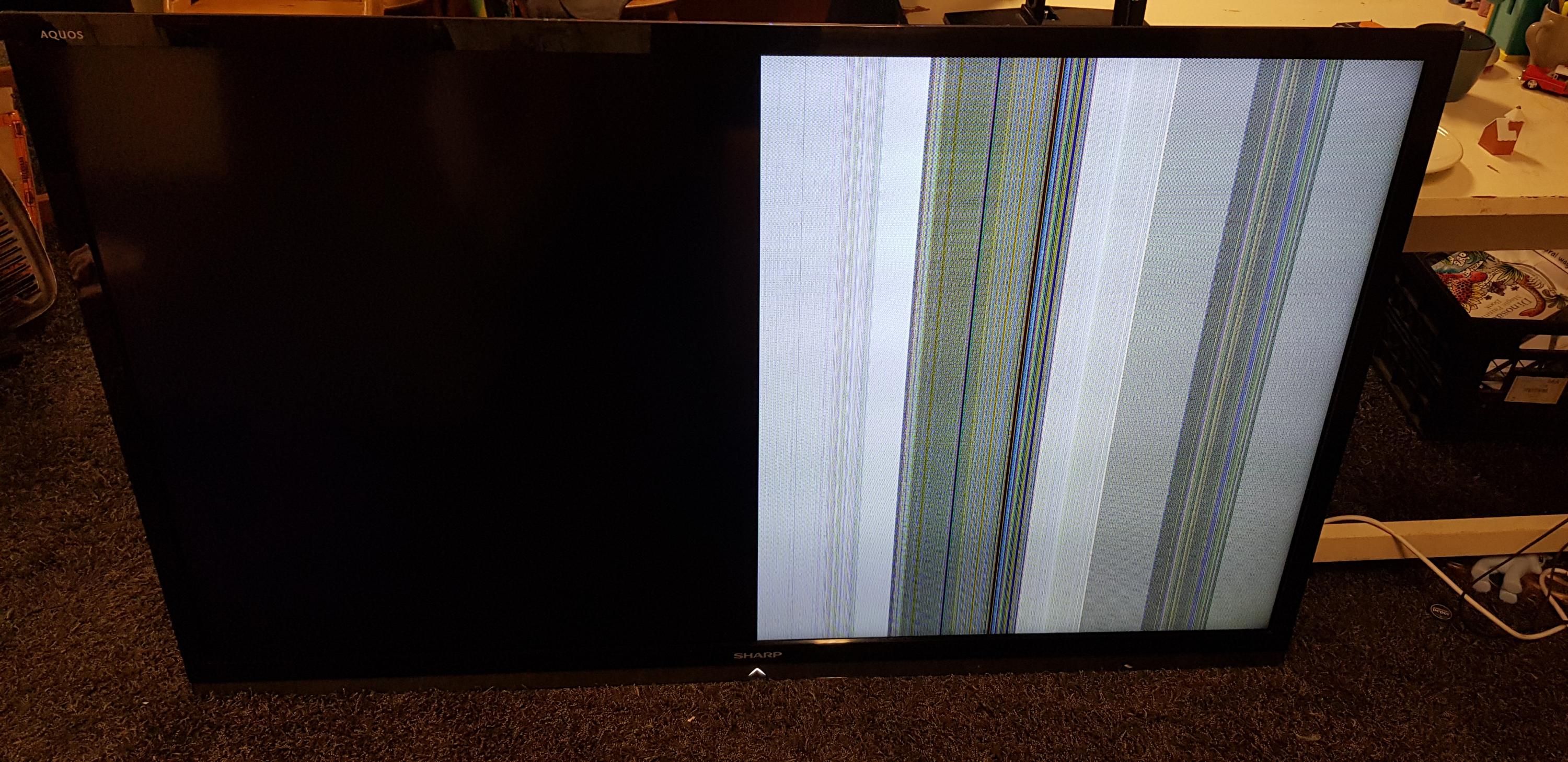

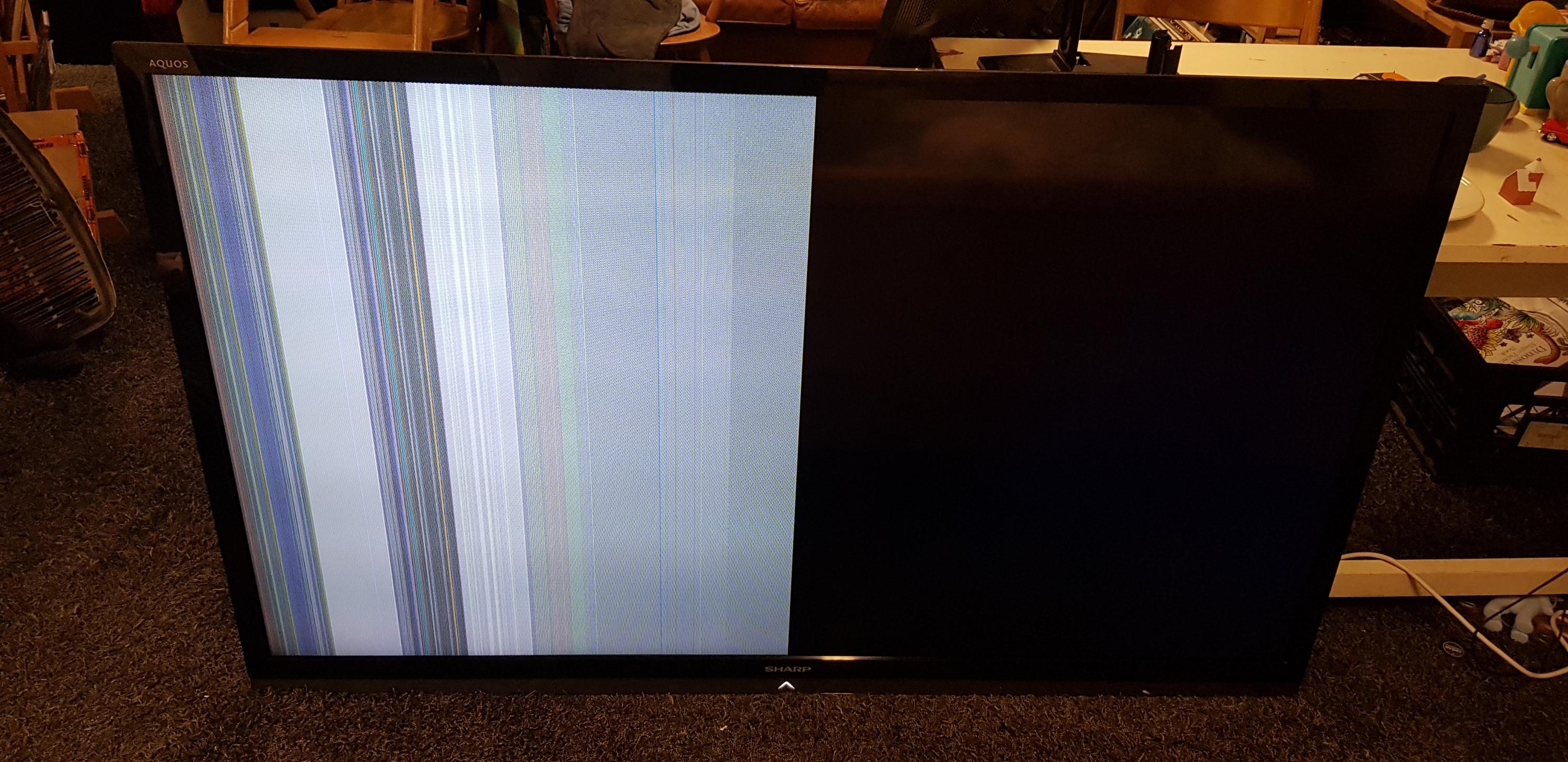

                                    allright: here's wat I've done:
                                    I have 4 cable/ribbons running from the Tcon to the panel. My backlights always come on every time I power up the set. I have no codes flashing at any time.
                                    I have a source playing verified by it's audio.
                                    Unplug the right most cable/ribbon: corresponding half of screen lights up mostly white/grey but lot's of colored lines. See Pic 1
                                    Unplug the second cable from right: corresponding half of screen goes completely white. See Pic 3
                                    Same is true of the left. 1 cable results in a more colorful lighting up of the screen. Disconnect both it's all white. See pic 2, it goes fully white like pic 3 on the other side too.
                                    Disconnect all four and the set switches off.
                                    What can we conclude from this?

                                        I followed this procedure to reset the set (even though I have no codes).
                                        Unplug set. Hold down Vol - & Input while plugging set back in, release. TV powers up and shows variations of the following image (see attachments). A partial blue screen. Which can hold, flash off for a second and back on. I can't get any menu or other image to show.
                                        After the reset I cannot see a "K" as suggested by some posts.
                                        Hope this helps narrow things down. I can get a Tcon locally quickly relatively cheaply. Is it worth it? Or has this panel suddenly and dramatically died? Astounding how many Sharp Tv's have issues out there!
                                        Please ignore the mess. I'm in the middle of a divorce and living in my office. The TV working would be a good thing come the holiday's lol
                                        thanks again.
                                        PS: with one side disconnected from the Tcon the white side will dimm after a few seconds as if saving power. Hitting the menu button or volume will trigger the screen to illuminate fully again. It seems to respond that much at least. It also does this when displaying the blue screen which varies in size when turned off and on again but is always on the same side.
                                        Hoping for input. Cheers
