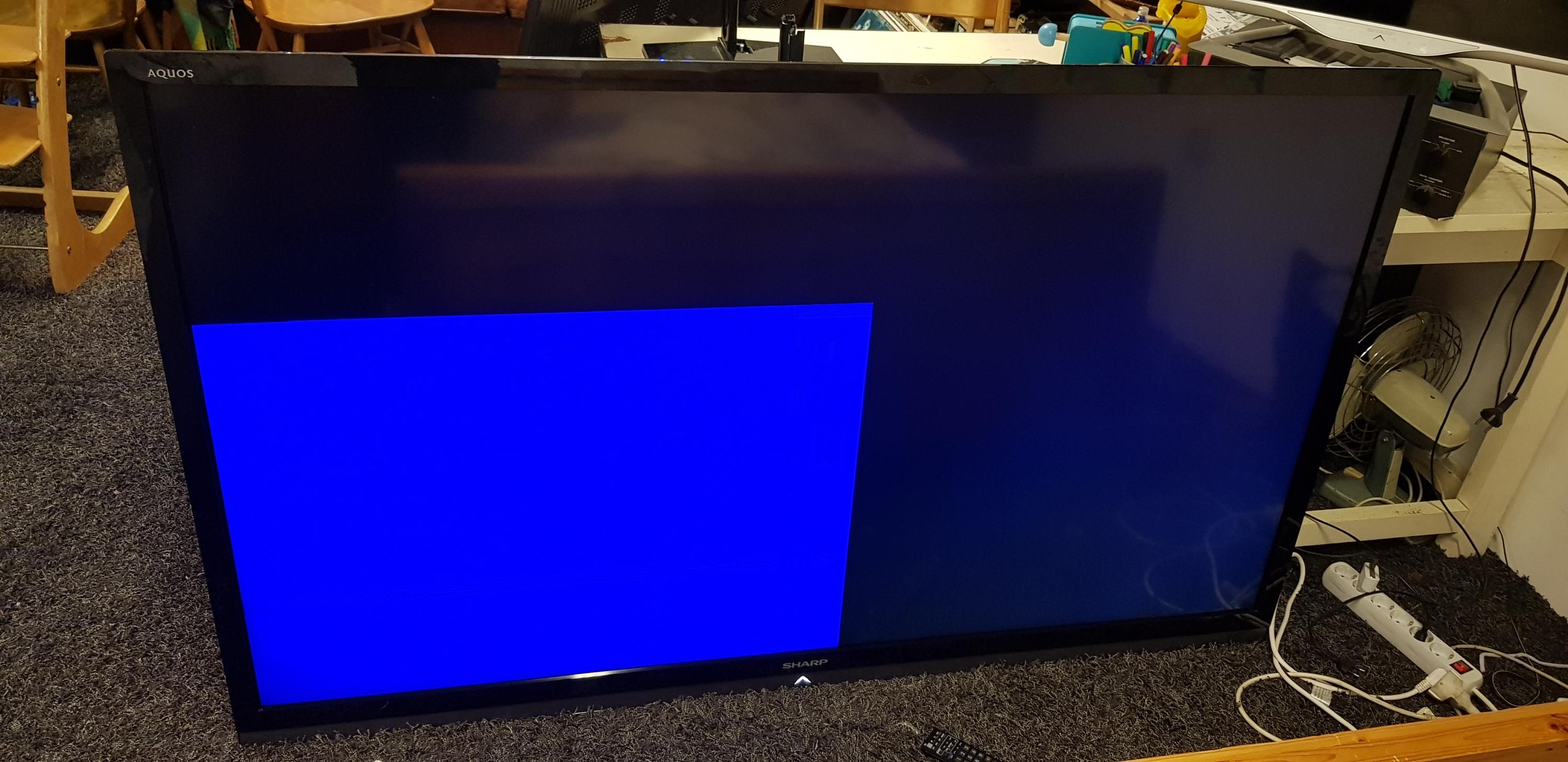

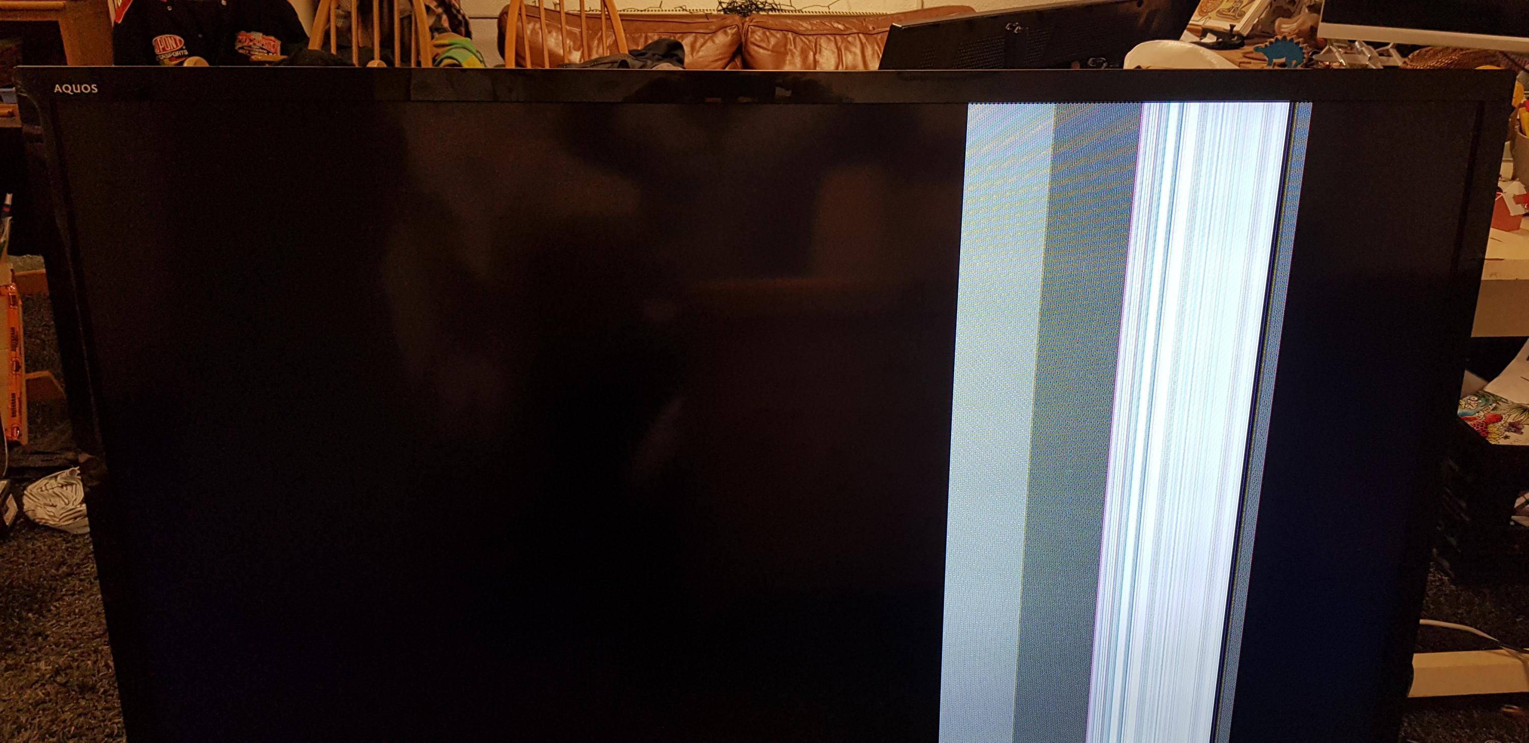

    So I threw a new Tcon board at it. Certified good used and working.
    Photo 1 shows the "best" result with the original Tcon board.
    Photo 2 shows the result with the "new" Tcon board.
    It's not consistent. If the Tcon was malfunctioning I'd expect replacing it either to remedy the TV by replacing it. If it's not the Tcon i wouldn't expect it to change anything as it does. If it isn't the Tcon I'd expect the "same" malfunction.
    To re-iterate: when disconnecting 2 ribbons from either side of the Tcon the TV shows a half white screen.
    Reset doesn't get service mode. There is no visible menu. All video signal is missing. Audio is present.

          So a couple of things... first when you have all cabling plugged in, does the set display anything and stay displaying... no flash codes?
          Next... have you looked at the side tabs of the set if visually you can see any sign of heating / "abnormal" when compared to others?
          Next, beside the tcon to panel cabling, there are a couple of "points" where "flex cabling / ribbons" can be disconnected / unclamped? These provide ways of isolate the panel "sections" so that if there is a panel issue, potentially, it can be isolated away while the rest of the panel still work "almost". At the bottom corner, on each side there is a small ribbon cable which connects the bottom edge boards to side boards. You can unclamp one end of this cable and power up the set to see what the result is. You can do the same with the opposite side. This test allows the tcon to still fully drive the panel because all of its cabling is intact but "isolates" the side drivers IF they are bad and causing issues. Depending on the results, there are some other points that also help isolate things. Post any results and go from there. I am leaning towards a problem with bottom edge boards (some smd component) but have seen issues / posts where a side driver did some "bad stuff" to the overall display.
          One other point... this.... "PS: with one side disconnected from the Tcon the white side will dimm after a few seconds as if saving power. Hitting the menu button or volume will trigger the screen to illuminate fully again. It seems to respond that much at least. It also does this when displaying the blue screen which varies in size when turned off and on again but is always on the same side." which you mention previously. The "dimming" is usually a result of the set detecting NO valid input and hence the dimming / power saving kicks in. Are you ever able to bring up any type of menu?

            allright: here's wat I've done:
            I have 4 cable/ribbons running from the Tcon to the panel. My backlights always come on every time I power up the set. I have no codes flashing at any time.
            I have a source playing verified by it's audio.
            Unplug the right most cable/ribbon: corresponding half of screen lights up mostly white/grey but lot's of colored lines. See Pic 1
            Unplug the second cable from right: corresponding half of screen goes completely white. See Pic 3
            Same is true of the left. 1 cable results in a more colorful lighting up of the screen. Disconnect both it's all white. See pic 2, it goes fully white like pic 3 on the other side too.
            Disconnect all four and the set switches off.
            What can we conclude from this?
            sorry I missed this post... :-(
            That is the right kind of test with the tcon but it gets you nothing? That usually points to a problem with getting some signal into the panel as the black side should see something.
            That could either mean it isn't being sent or it can't make thru to the panel.
            You are likely going to have to check some voltage points which should be printed / labelled on the tcon and / or the bottom edge boards... things like "V..." (eg. VCOM and such). These might highlight the issue. Since you have tried two cards, then if there is a voltage problem, it is likely at the panel / edge boards. IF things look OK, then I would say, the main board is an issue. More likely since you never see any flash codes.

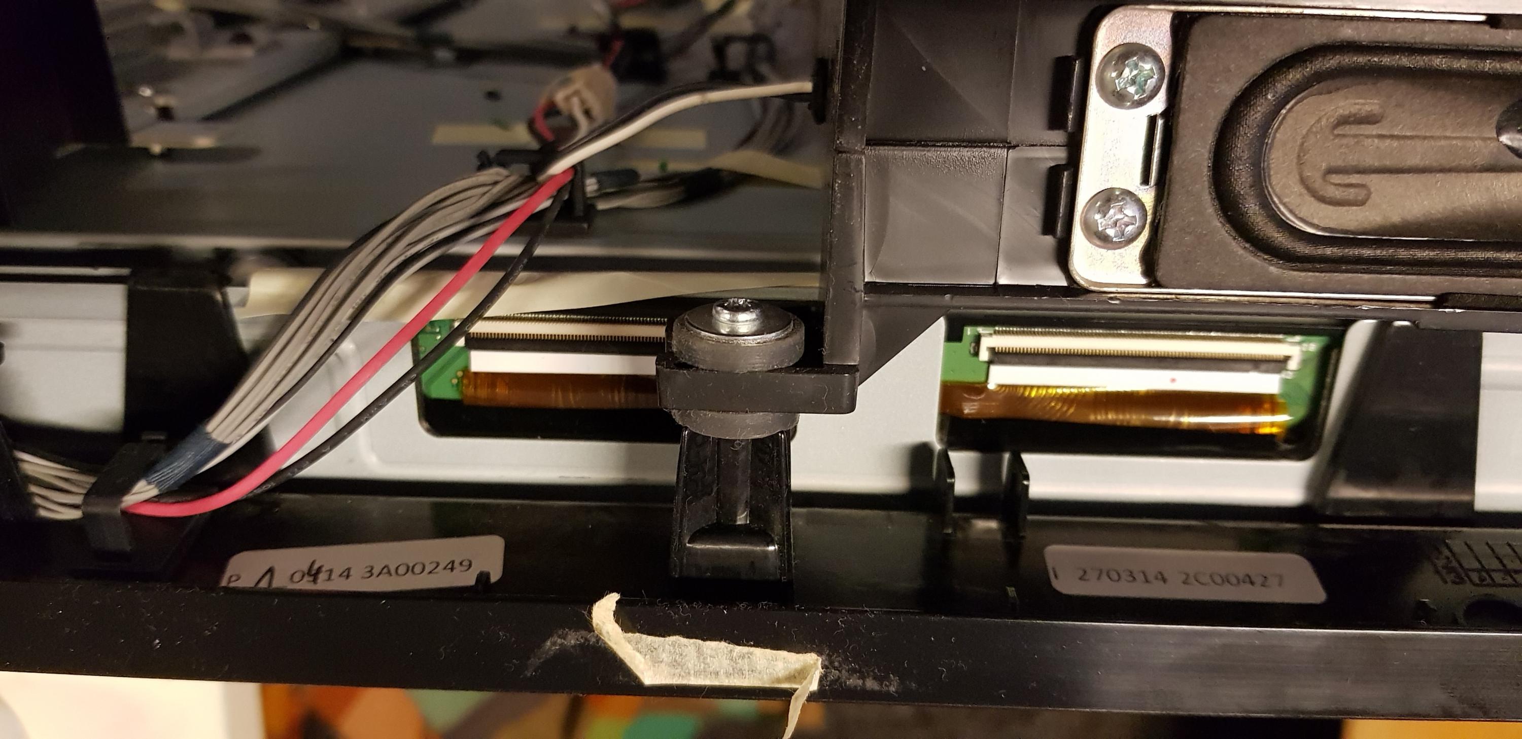

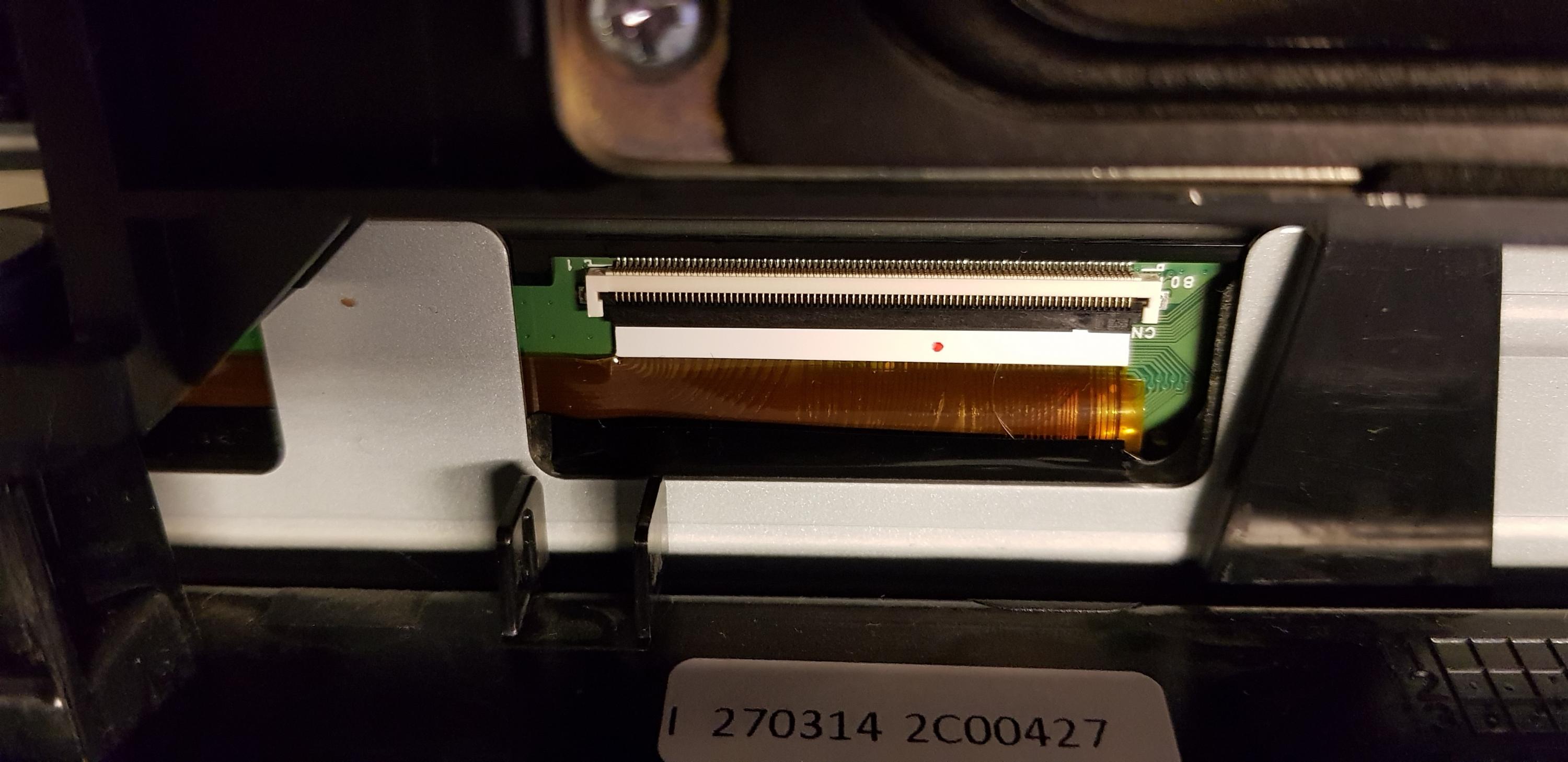

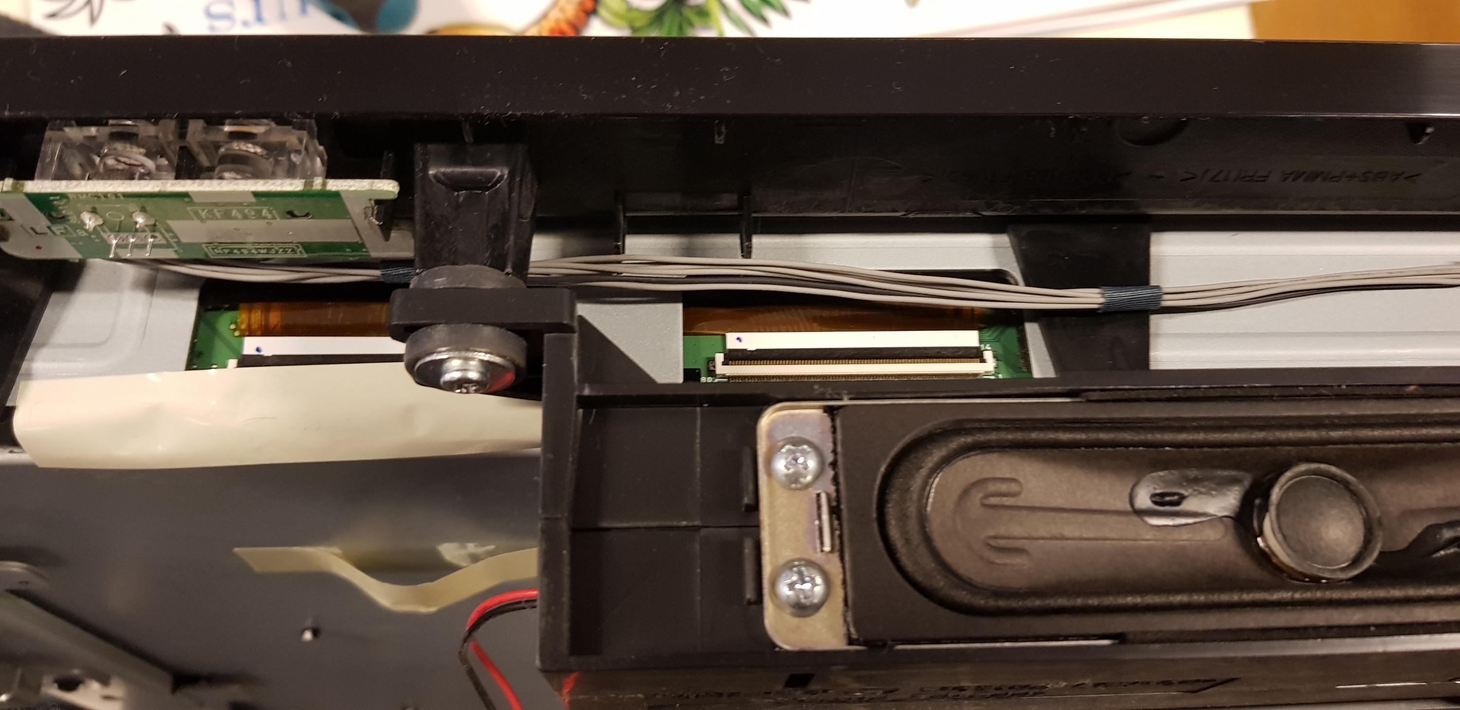

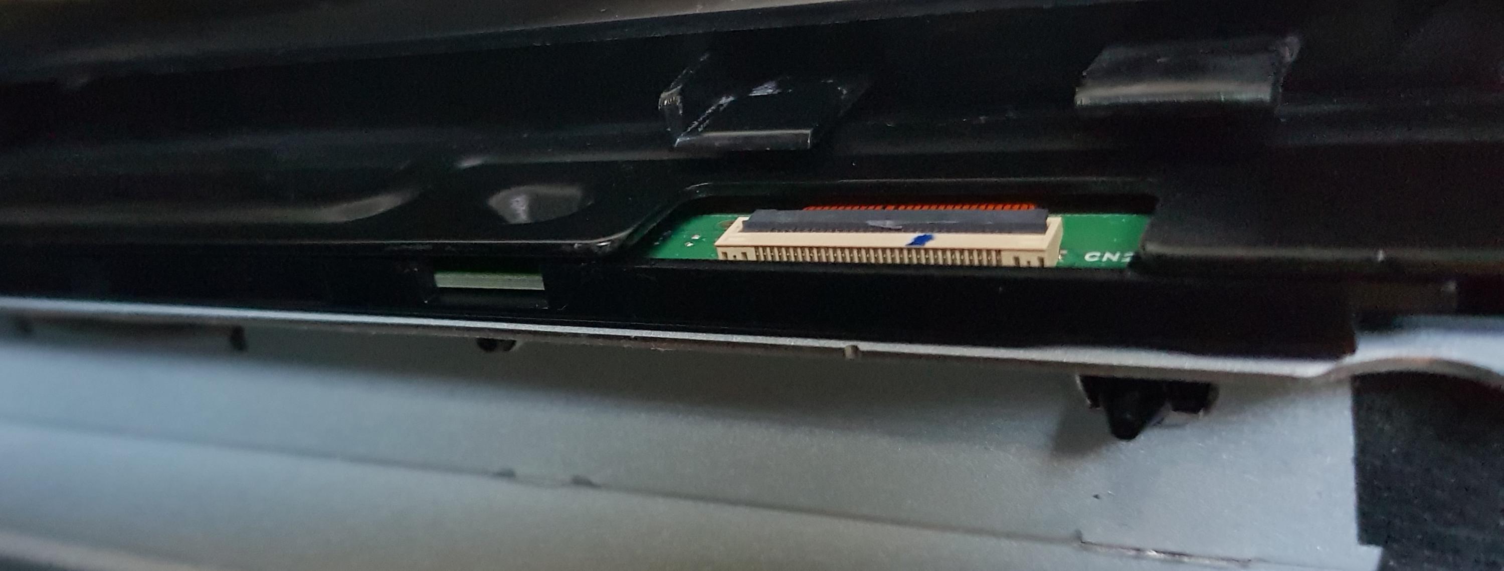

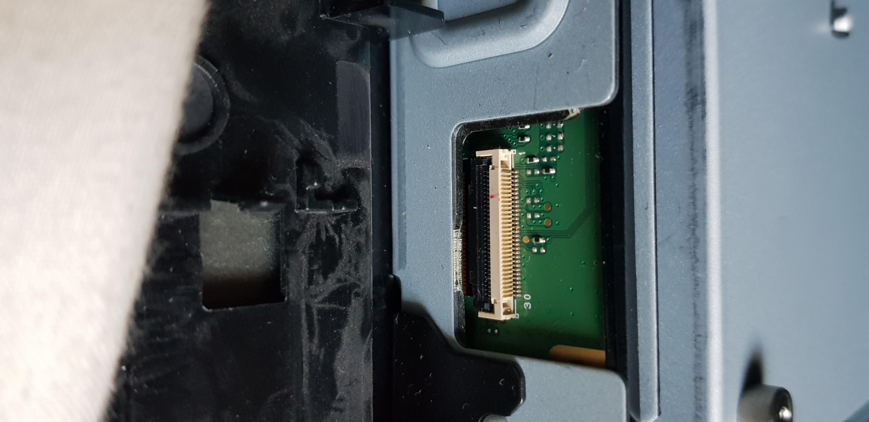

                  All of the following tests were done with signal input as verified by the audio playing. Not once did any image display.
                  Along the bottom edge of the TV there are 4 larger white ribbon connectors. Disconnecting the left side connectors result in 1/4th of the screen displaying fully white from top to bottom. Disconnecting the right side the same.
                  Along the bottom left and right side and in the far left bottom and right corner there are smaller ribbon connectors. The best I could do without fear of damaging something was to unclip them. Removing them seems like damage is inevitable.
                  Unclipping them had no effect on anything.
                  On the topic of "dimming" I noticed, as I was streaming youtube clips, that: in between clips when the video signal goes black on a working tv that the LED backlights also respond to this, much the same as the aforementioned darkening if there is no input.
                  So the LED's are getting some information about video signal at least.
                  The connectors all look healthy btw, no heat or anything of note to be seen.
                  Please see attached pictures for reference.

                    so you are saying there is not "labelling" on the tcon anywhere? don't expect to see "12v" or things like that... more in terms of "names" that "suggest" an important "pin/location/testpoint". The same applies to the bottom edge boards. :-(
                    Your views appear to be limited exposure to the edge boards... I do believe some of the framing / bracing / members can be removed a bit to get easier access to things. Not sure it would help.
                    Further your other post about dimming and signals and button pushes is interesting.... potentially indicating a main board problem BUT I think some of the dimming is associated with tcon as opposed to the main board.
                    Further back to labelling, there is also likely some on the main board, perhaps there are some of interest there that can be checked.

                      If I understand your reference to the "four white connectors" and the disconnecting... it appears to give a "1/4" screen white... this indicates a totally isolated quarter "panel" which only relies on "common voltages / grounds" to cause the LCD pixels to "transmit" backlight while the rest of the panel should be doing its "normal job". This allow the tcon to fully drive the panel and "usually" takes out a portion of the "duplicate side drivers" (depending on which side) along with some of the bottom drivers.
                      It still has not fully pointed the finger yet because it is possible that the tcon signal is not getting into the edge board because of a missing component voltage either not in the tcon (likely not because you have tried 2 boards) or because a component at the edge board is fubarred.
                      You are getting closer... I think to ascertaining things.

                        I am thinking your problem is up from the tcon. In post 20, the one picture with the blue "quarter screen" appears to show "part" of a display "icon"... that potentially being maybe something like "no signal check cabling" box that appears on some sets in the middle of the screen... look at your picture... you can see a small corner of the "box" in the "middle / center portion".
                        Perhaps you might take a closer look at the lvds cable and connectors at both ends visually. If possible, you might see if you can do a continuity test on the cable ... tough but doable with some small pins on the probes or otherwise.
                        One other point... have you checked any other input types?

                                            by scubacamper
                                            I found another post on this site the other day which has been very helpful in troubleshooting this issue I am having with my tv. The left half of the screen is dark, and the other half is VERY slow to generate it's image - and it only generates part of its image at that.
                                            Based on this yt video, I have narrowed it down to an issue (short?) on the left side of the display, somewhere in the system of ribbon cables.
                                            when I remove the bezel and the rear cover, I can get the image to display correctly by manipulating the ribbon cables on the left side which connects the left lower display...

                                            Well, I opened the back cover and as you can see in the picture, I unplugged 2 L (left) ribbon, TV turned ON, but half of screen (Right) is normal, and the other side (Left) is white. I continued to test...
                                            Result:
                                            I swapped the ribbons L<-->R = Blinking 2x power light, 5x timer light
                                            Unplugged 2 R Plug 2 L = Blinking 2x power light, 5x timer light
                                            Unplugged 2 L Plug 2 R = Blinking 2x power light, 5x timer light
                                            Only in the first test, where I did not
