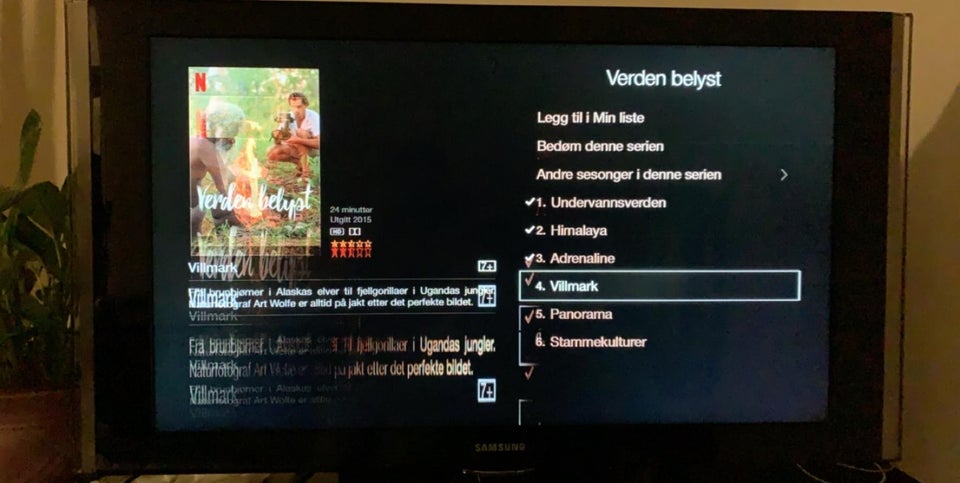

    Hello
    I just finished replacing power supply capacitors on my TV, but when I turned it on the screen looks like this.
    Does this look like a bad T-con board to you?
    Thanks!
    Last edited by 23andreas; 10-21-2019, 02:36 PM. Reason: attached the image as well incase the link goes down

    Re: Samsung LE40F86BD - Bad t-con board?
    i think MAX9590ETU chip can be your problem
      Panel Gate drive issue causing doubling images. Taped off method may solve the issue.
        I agree with Budm, there are video's on youtube that address this issue.
          Yep, I third the motion: https://www.youtube.com/watch?v=j7vl7-vZEL8
            Thanks for the video link, it was very helpful! You guys were correct. I opened the tv and managed to locate the panel gate drive. No need for any tape, just unplugged it and plugged it back in and now the tv image is perfect!
            Thanks a lot!
              Ok, thinking you just had a bad/dirty connection if you just had to re-seated the ribbon cable.
