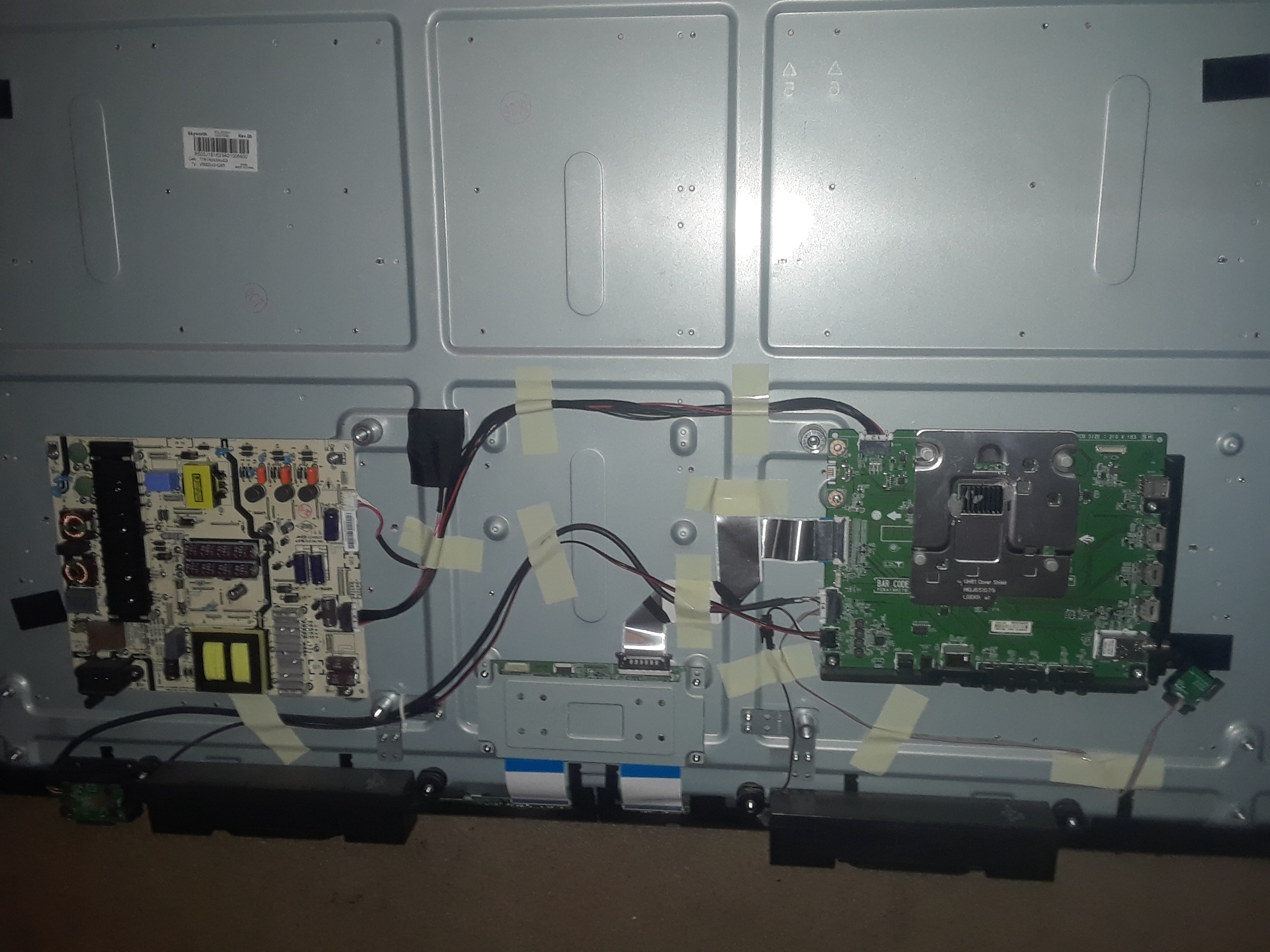

    Post some good clear pictures of each board and one of the whole back to see how they are connected, check number 2 and 3 in my signature for testing procedure if needed.

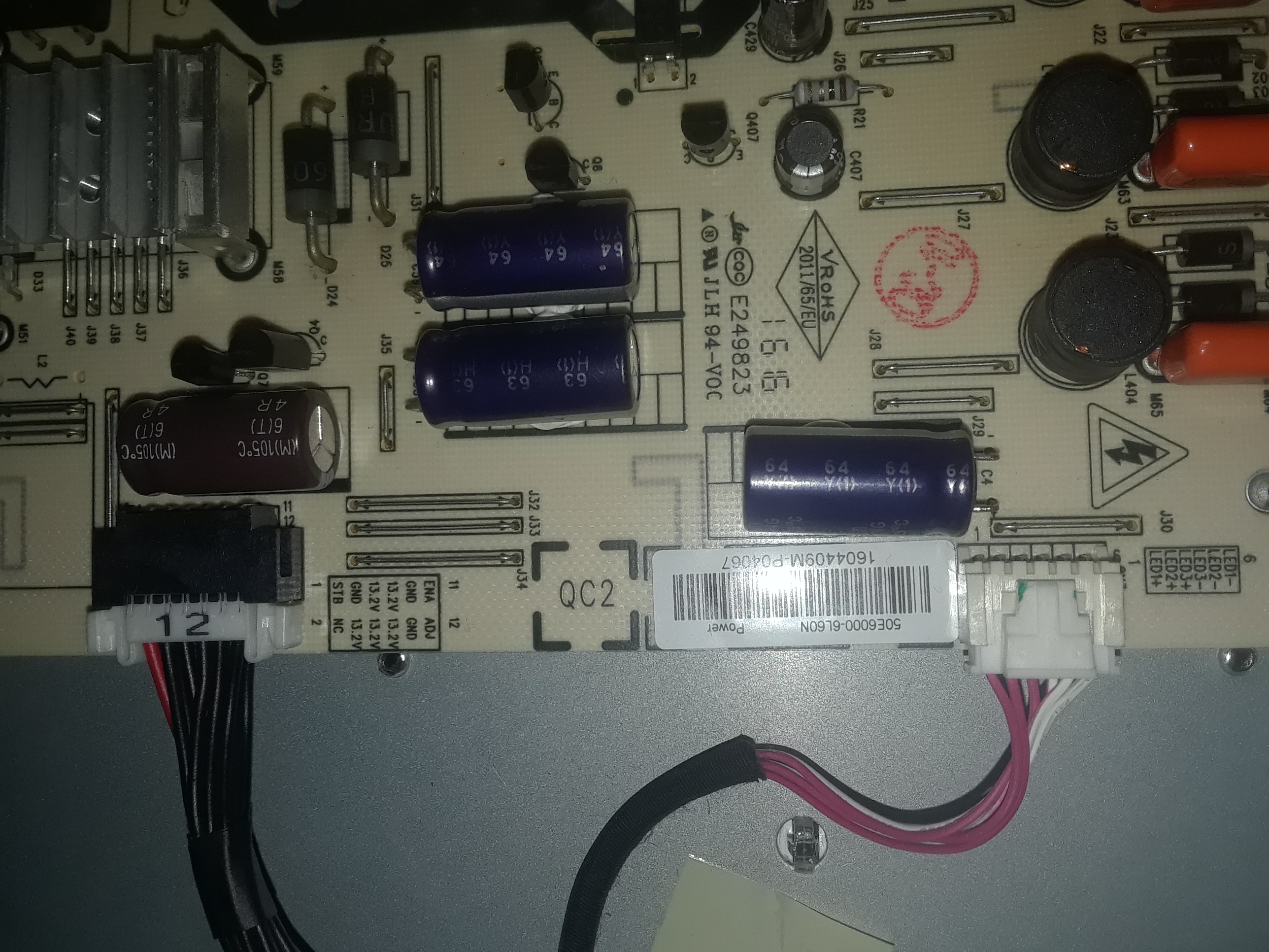

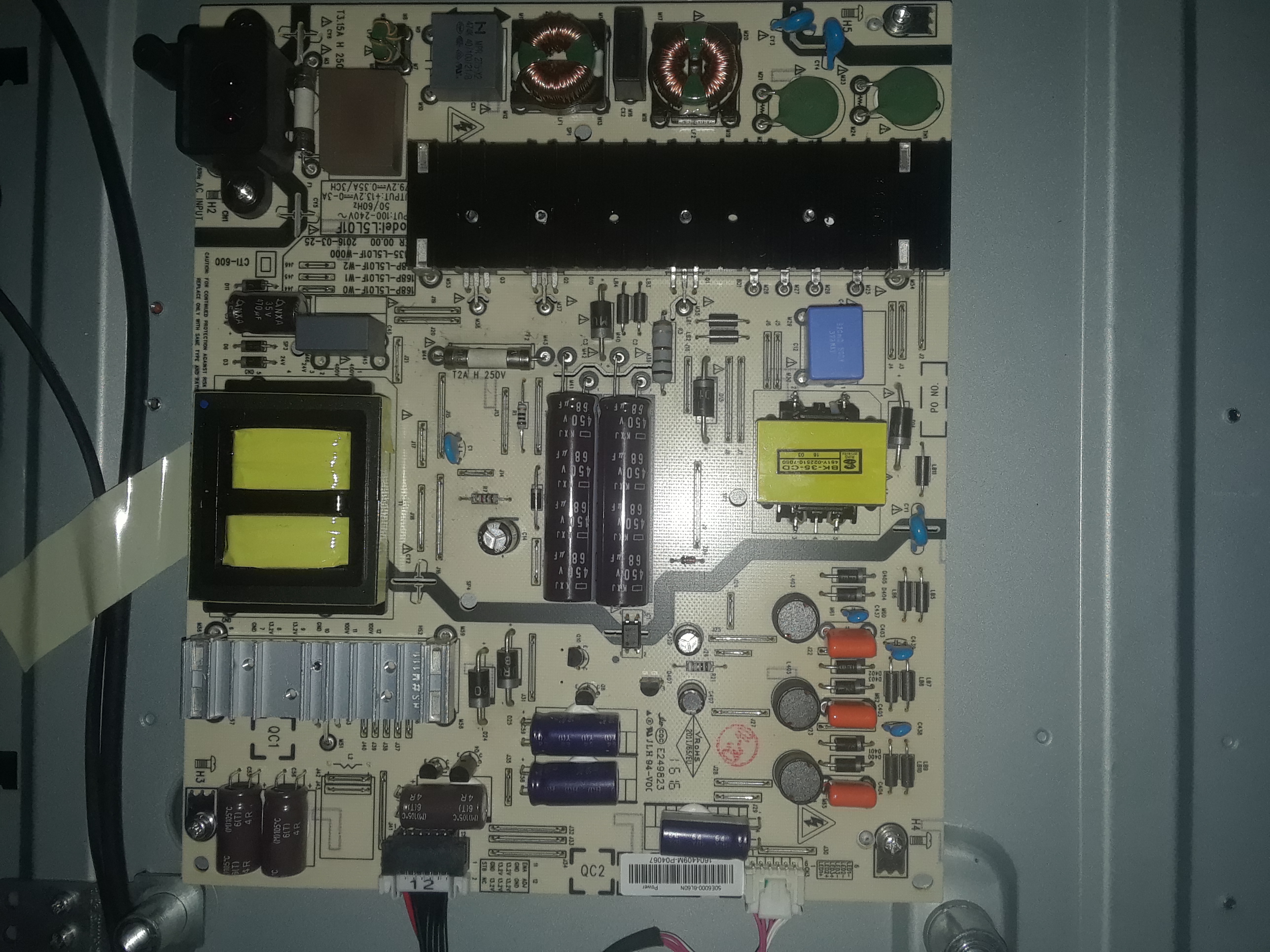

      Re: LG 50UH5500 need fix
      here is the psu
        Picture is too blur to read anything on the board. How about the pictures of the whole top and bottom side of YOUR power board and the whole backside of the TV showing all the boards?

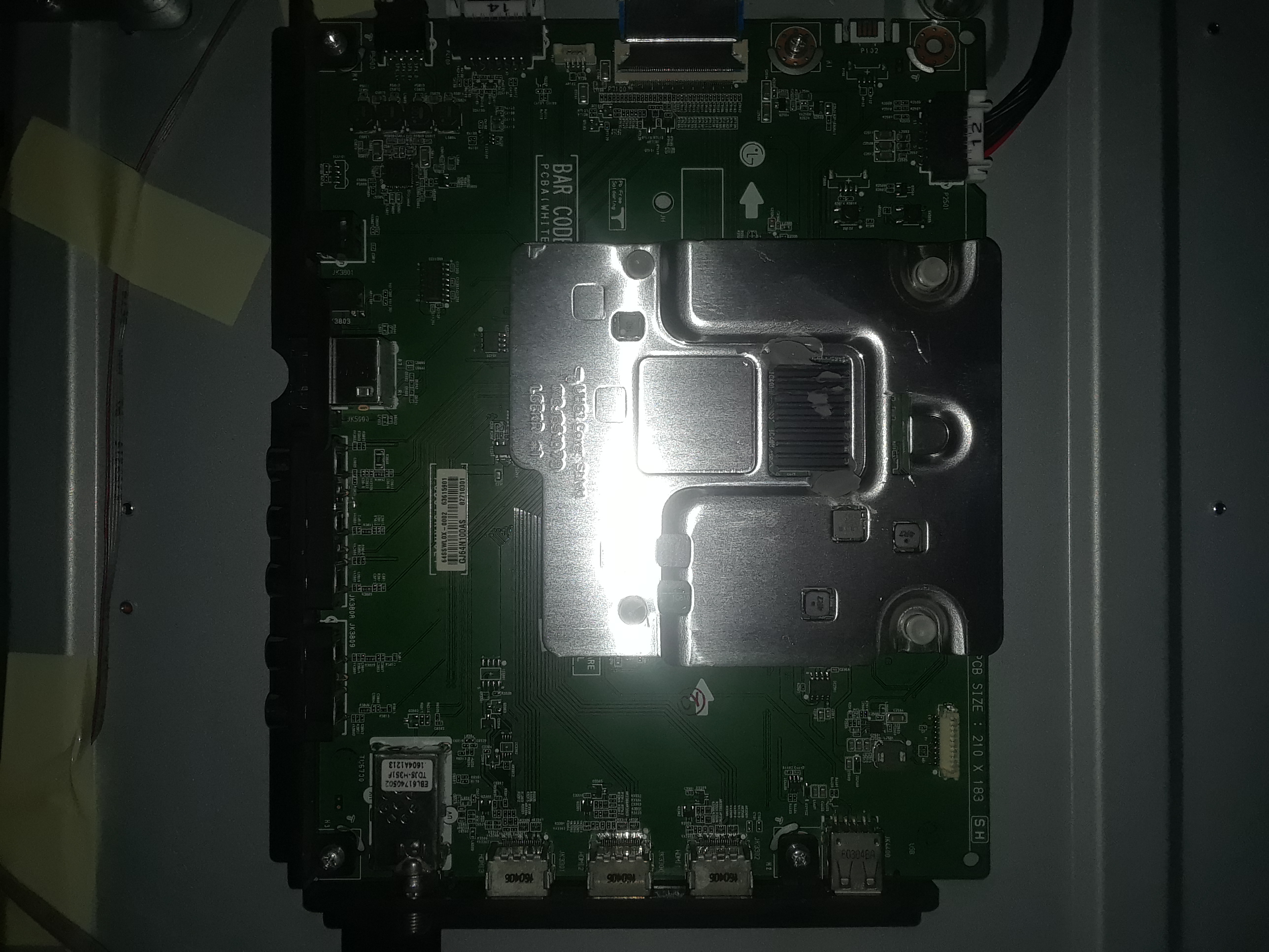

            Sorry for the delay. Kids got home from school so I had to put this on hold. Here's the photos of my board

              Please let me know if the photos I posted today are good enough. If not, I'll take more. Thanks for helping.
