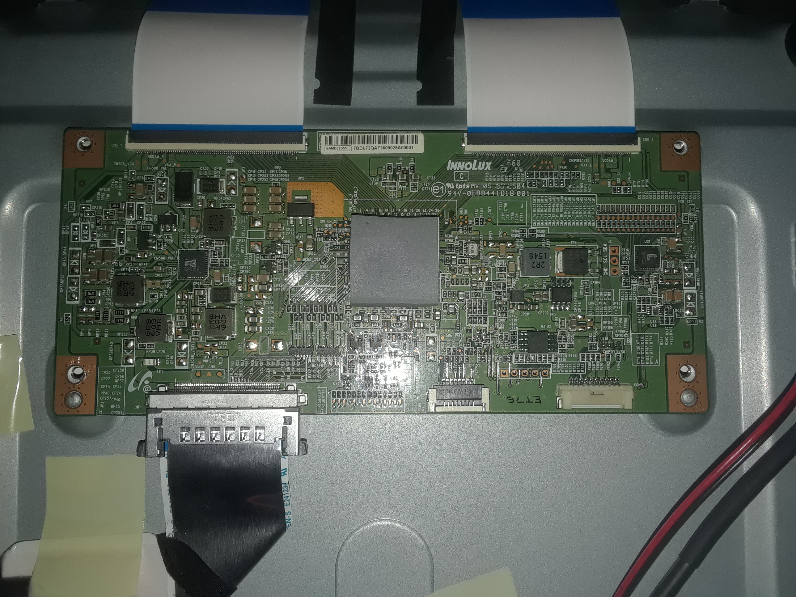

              Probably need to take the shield off the tcon, there should be a fuse that looks like one of the little ceramic capacitors labeled starting with Fxxx, set your meter to 20 vdc, put negative probe on metal chassis of tv and positive on each end of fuse probably looking for around 12 volts on each side.
                Re: LG 50UH5500 need fix
                I think this is my tcon board but I don't know the part you're referring to.
                  White, has a T on it, labeled FP1, right by the connector there.
                    I only get 13v on one side

                      Ok, now put meter in diode mode put a probe on each side of fuse, will beep or read near 000 if good, appears to be a blown fuse, this is diode mode so test with tv OFF and UNPLUGGED from power.

                        For testing you can use a pico fuse soldered on top of the fuse with roughly the same amperage.

                          Sorry for misreading but I got a reading of 1 on one side and it was blank on the other side so I rechecked the voltage and it did read 13v on both sides. I must've had it in a bad spot during the first reading. Sorry, I know your trying to help. I'm not trying to over complicate this. Thank you for taking the time to help me!
