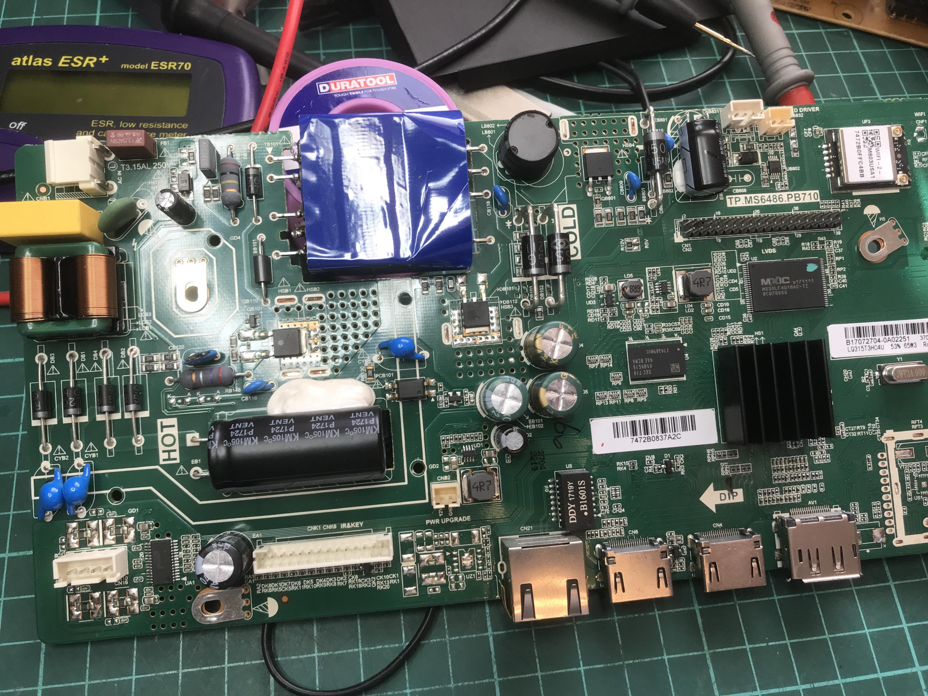

    Hi, I have a Sharp 32HG5141K which uses a TP.MS6486.PB710 board.
    The problem was a blown fuse plus 2 shorted bridge rectifier diodes, plus I also noticed the ceramic cap CB120 is blown. Can anyone tell me what value this is?
    Alsi are there likely to be any more damage?
    Many thanks
  • CapLeaker
    Leaking Member
    • Dec 2014
    • 8213
    Re: Sharp 32HG5141K (TP.MS6486.PB710) Component ID
    probably something around a 102k, 1kV snubber cap.
