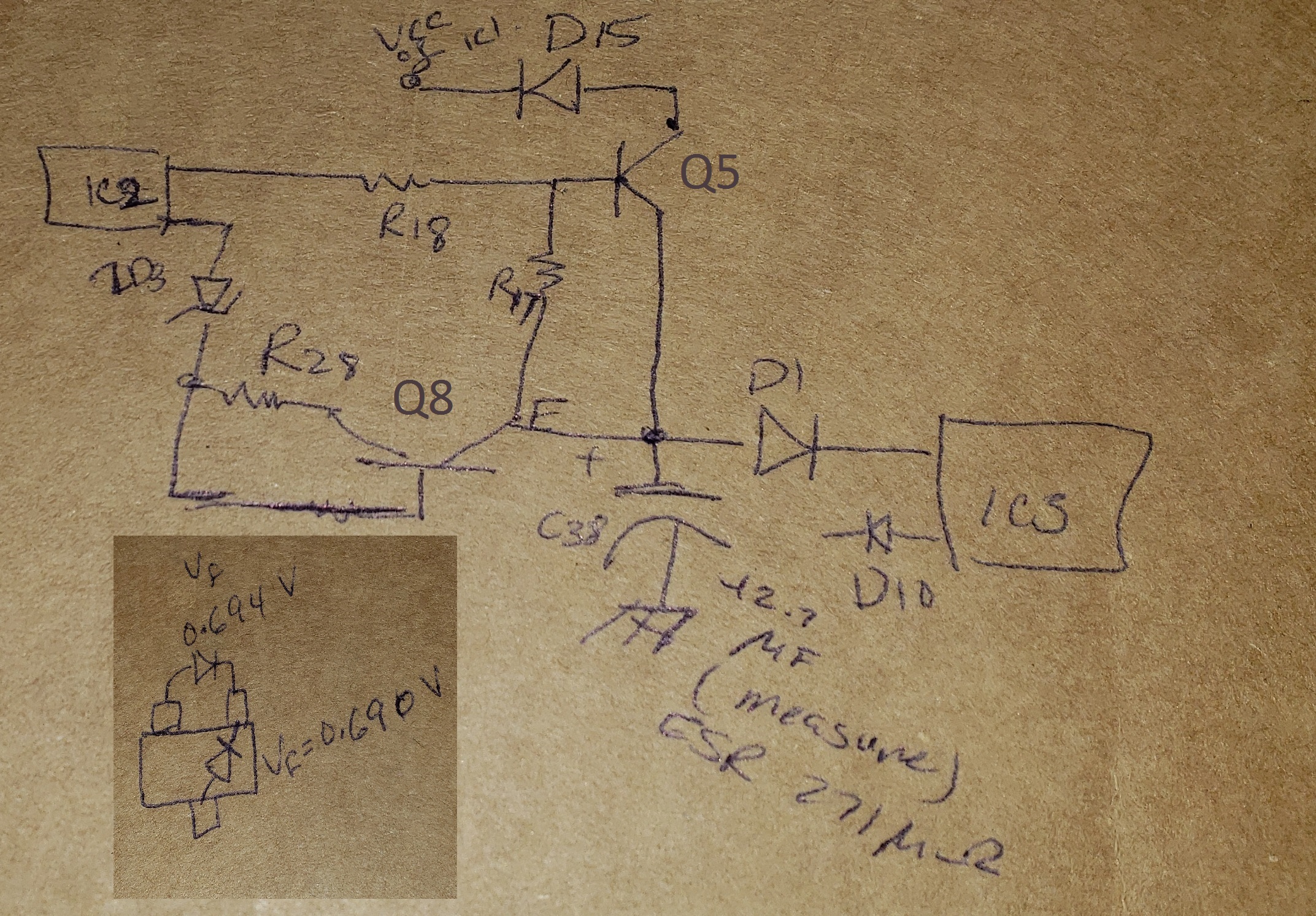

                    #49
                    Re: XVT3D554SV - Blinking Amber / White - PS Damage
                    R18 reads 2.991 kOhm
                    R17 reads 13.2 kOhm
                    R31 reads 3.4 Ohm
                    Voltage across E and B is between 0.48 and 0.53 V but not steady (fluctuating)
                    Resistance between hot pins of IC2 is 190k and keeps climbing up
                    Q5 seems to check out in and out of circuit - See drawing
                    also, this is what the circuit looks like (I think)

                      #50
                      Any further guidance.. or should I just trash the board??
                        #51
                        Wit D15 still removed, short the two pins of the OPTO IC2 in the hot side, that should force switched Q5 to stay on and you should get steady Voltage on C and E pins of Q5 with ref to hot side circuit GND.

                            #53
                            The result you are seeing does not make sense. I cannot see how the Emitter and the Collector Voltage of Q8 to drop when Q5 is installed and D15 removed.
                            Is the standby Voltage steady?
                            Check the dc Voltage betweeen the 2 legs of c23.
                            Check D12.
                            Check C23, C35 capacitance and ESR off the board or just replace them.
                            https://www.badcaps.net/forum/attach...8&d=1569504979
