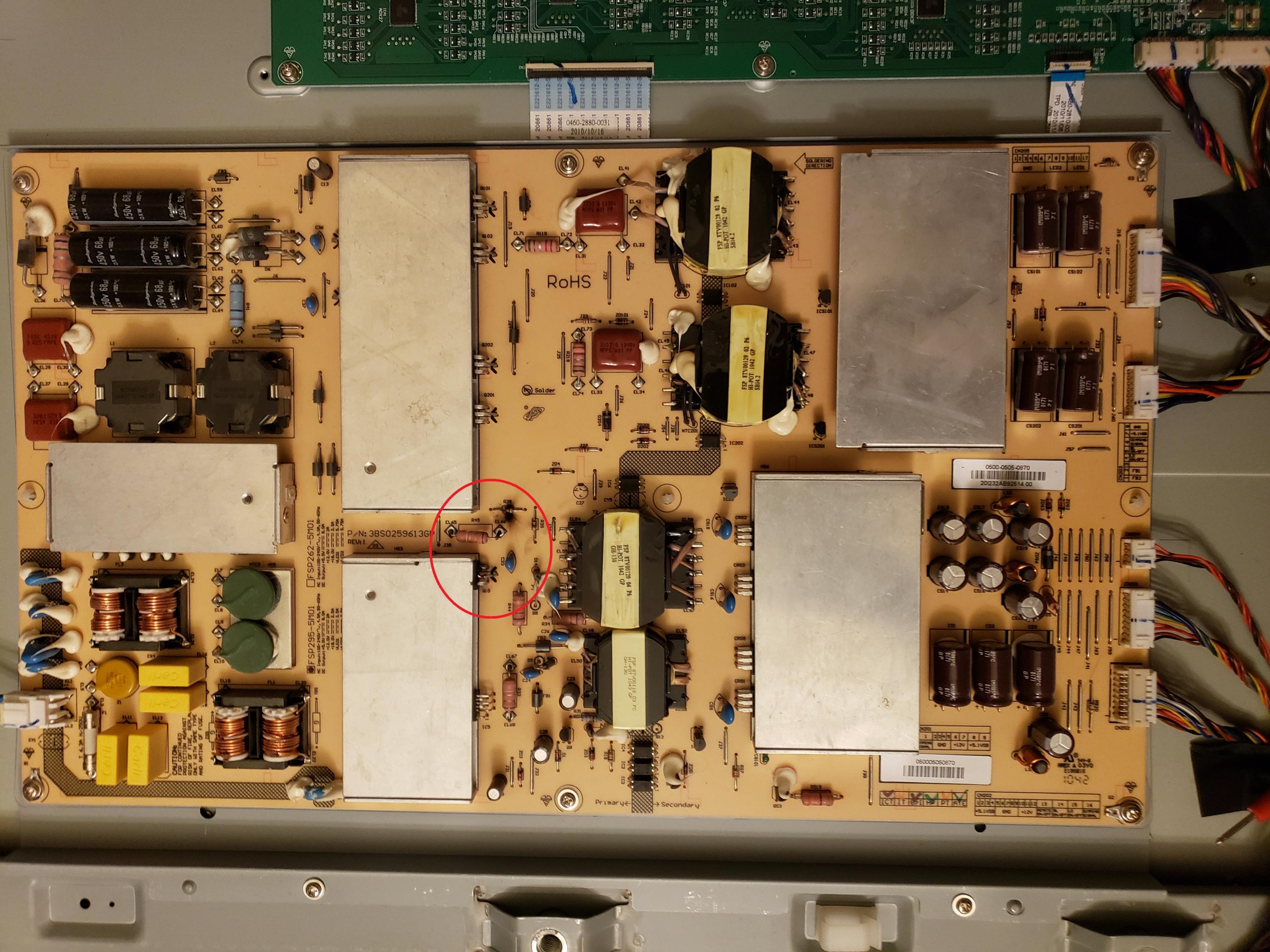

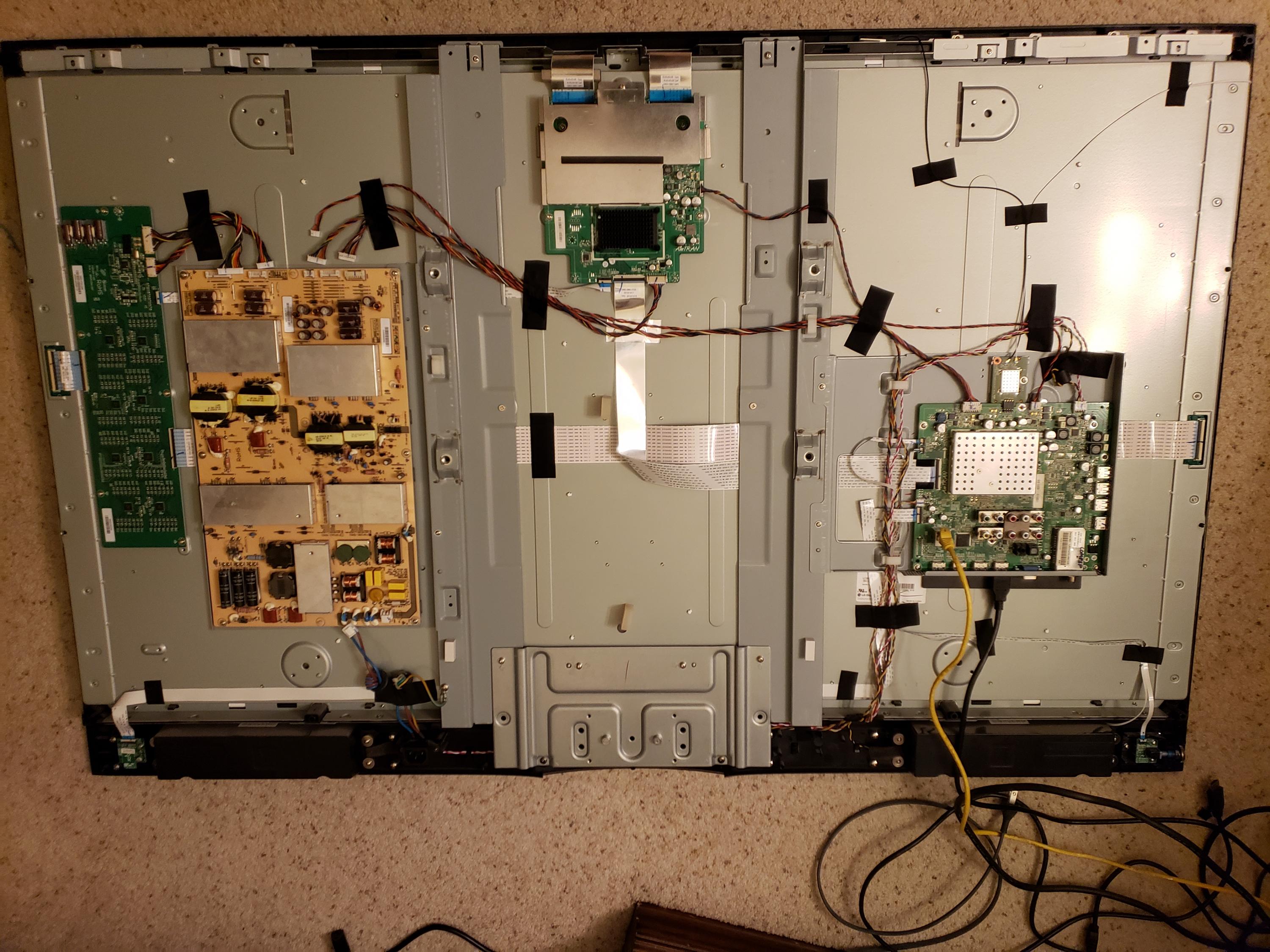

    Hi folks
    Picked up this TV that had cycling Amber / White. Sent the board to Nick's TVs for repair.. after 4 attempts, I got the main board back with Proof of operation video.
    It's doing exactly the same thing in my set. Amber / White flashing - then white, then repeat (Ethernet port shows activity now) I don't get any picture, backlight, or any other sign of life

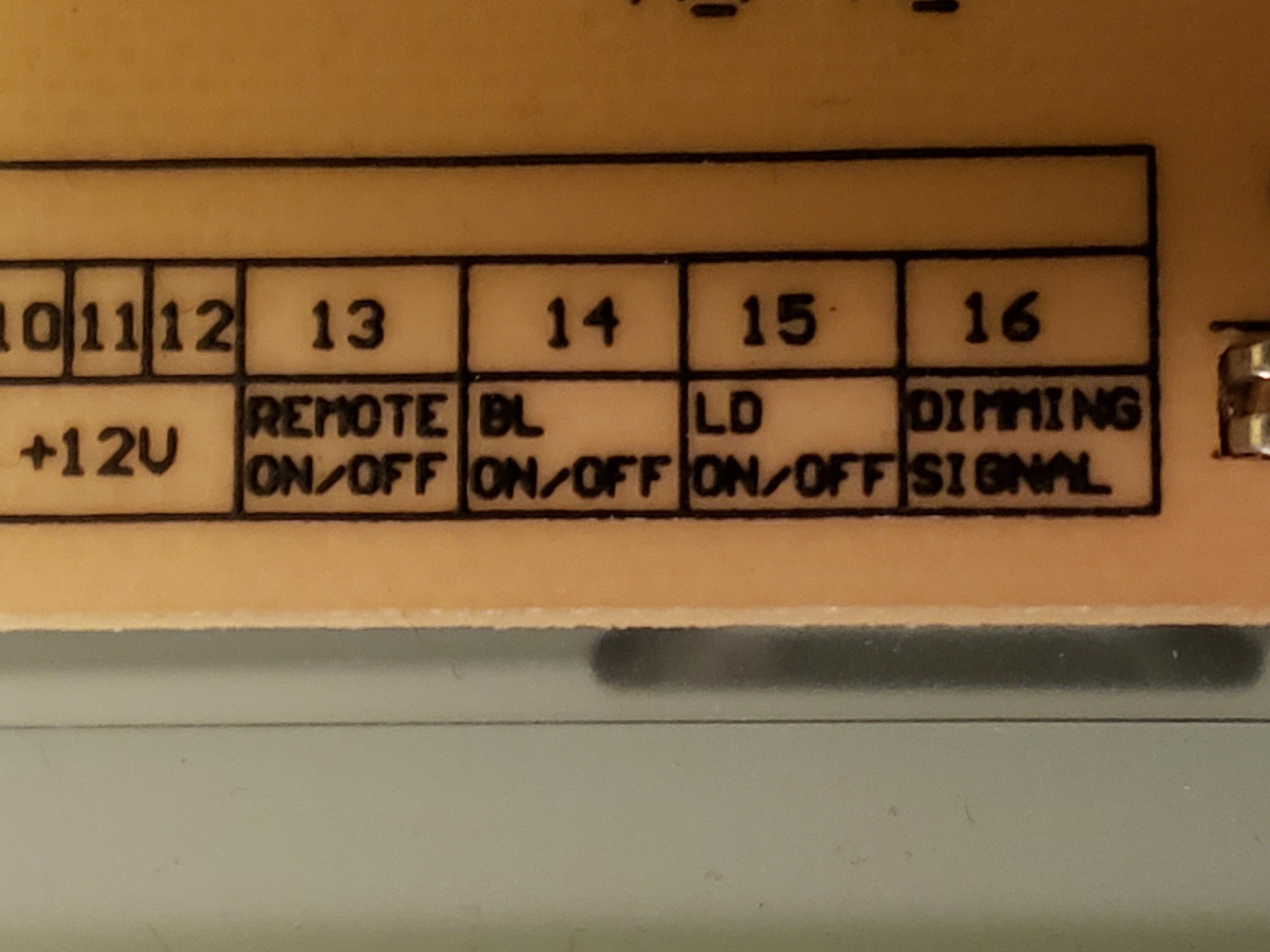

    All fuses on Main, and Tcon are ok. 12V is not coming on - and I can't really tell if the Main is issuing the ON signal - However in the process of removing the PS card (I was going to solder wires to force set on), I noticed a black charring around R38 and some on the leads of Q10 (See photos) - might explain why the 12V is not coming on.
    Any thoughts on how to repair this? Anyone with a schematic that can help me troubleshoot this board? Replacing the Transistor would fix it? I don't know the value of the R38, but it's reading 635 kOhm

    Re: XVT3D554SV - Blinking Amber / White - PS Damage

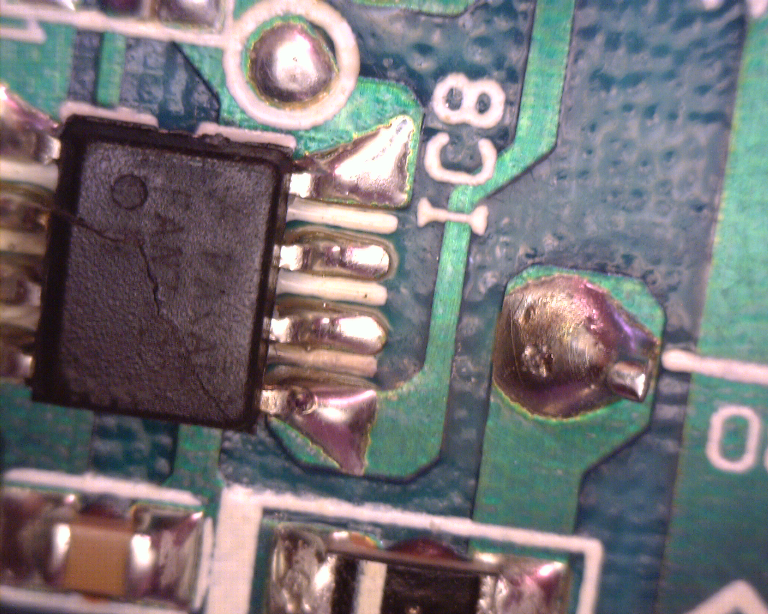

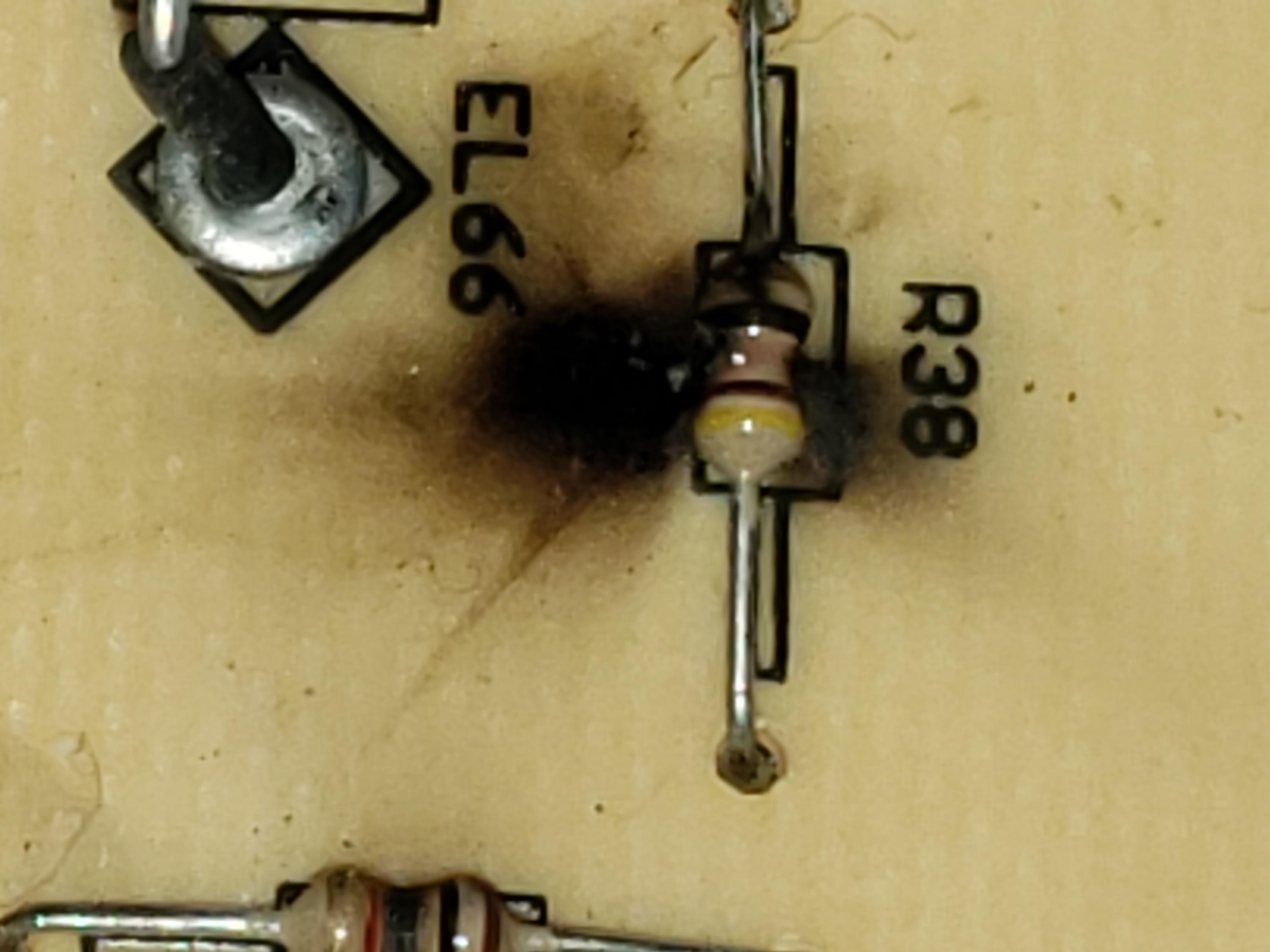

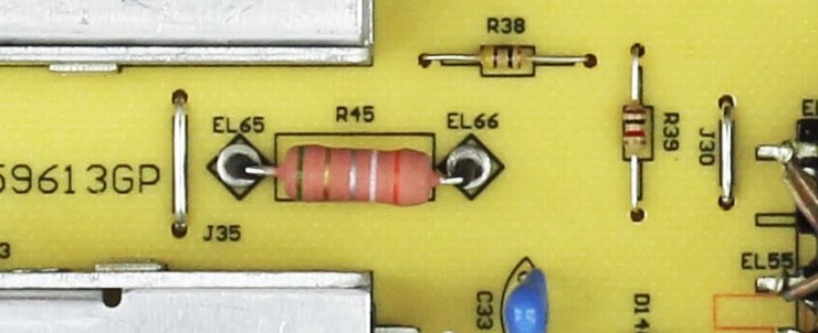

    Replacing Q10 will not fix the problem, you will also need ic8, R40,D13. also R38 is in the gate circuit it could be around 10~30Ω Also R39 (could be a 1k)
    I suspect R45 is open also
    Remove the baord and inspect the parts on the other side where ic8 is located.
    There may also be more wrong with this board.
    This was likely your problem all along not the main board

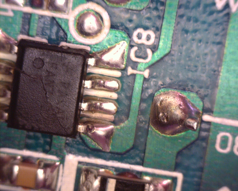

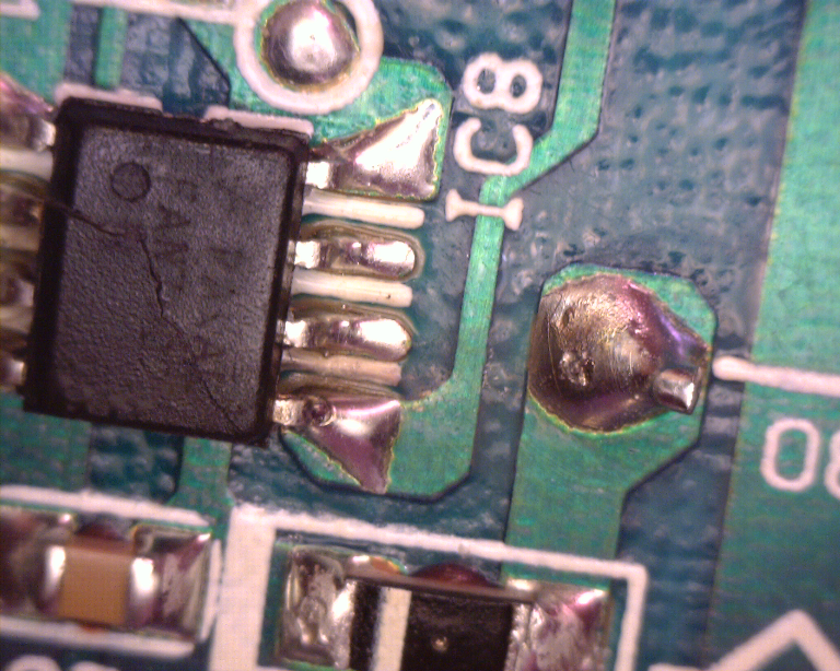

            R39, and R45 are open

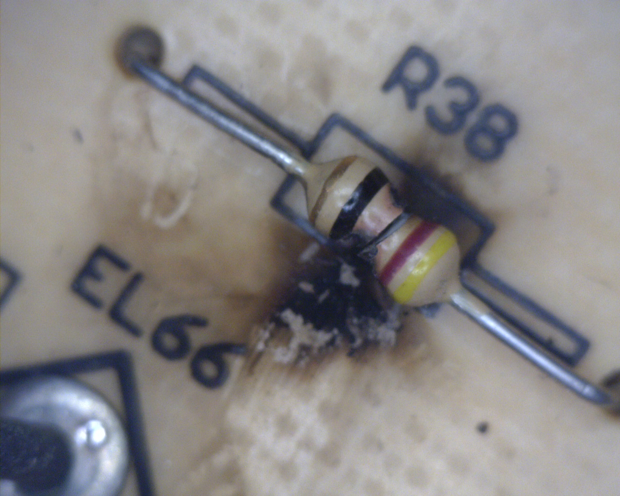

            R38 is cracked in half
            R40 is open
            D13 shorted
            D18 shorted

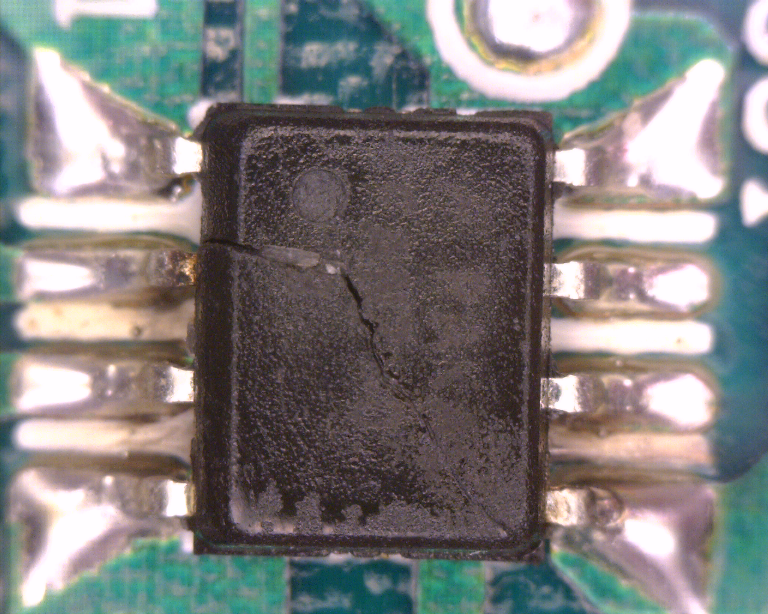

            IC8 is cracked (Can't make out part number)
            Do you know of a repair kit? you seem to know exactly what's bad on this board.

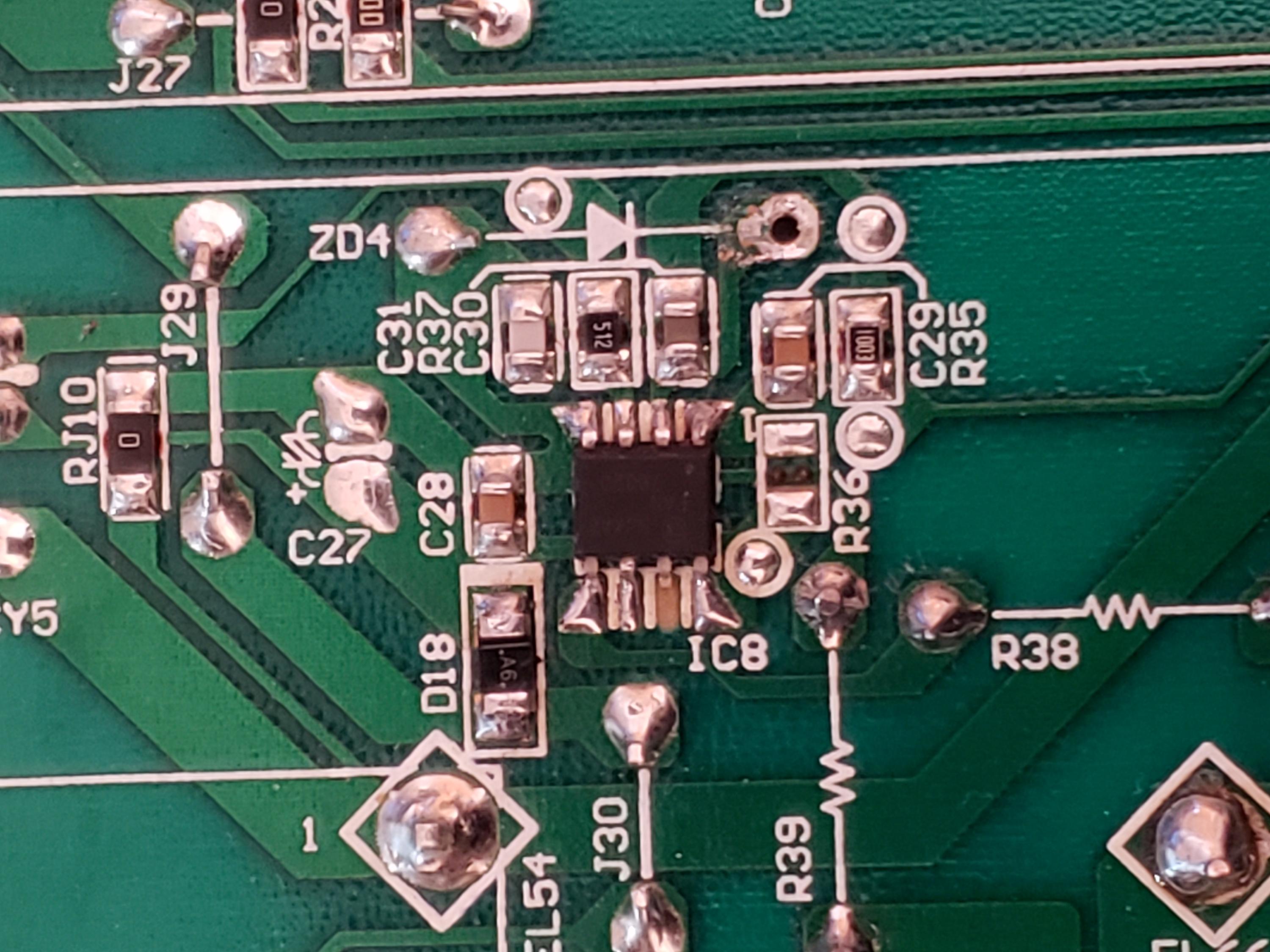

              FAN7602 IC8??
              Circuit looks different than the datasheet for that fairchild part. Trying to identify type of Diodes and resistor values.. any help is much appreciated.

                Trying to identify some of the busted components and help is much appreciated.

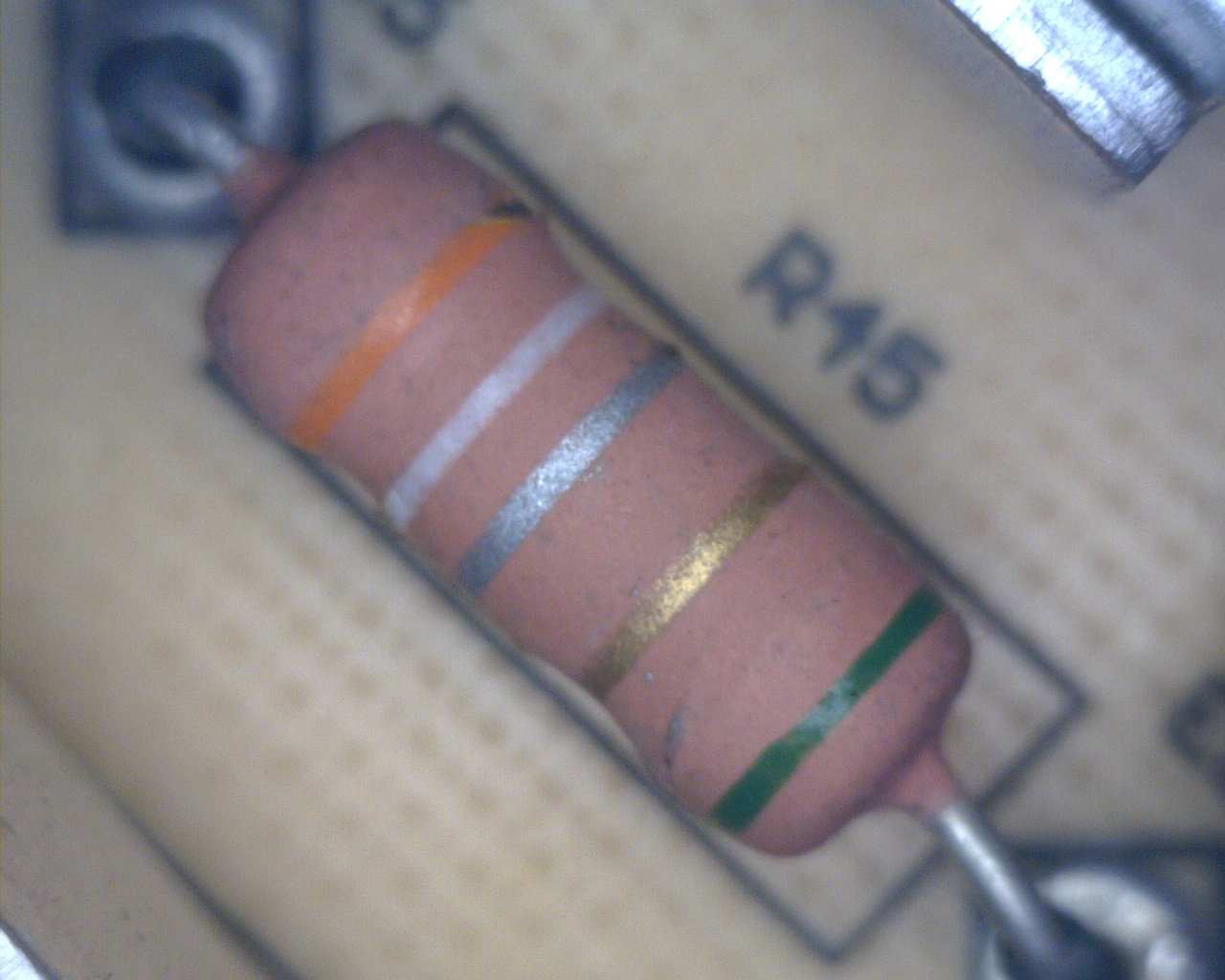

                R45: Band 1 Orange, Band 2: White, Band 3 (silver must be gray) and Band 4 is gold and band 5 is green: 39.8 Ohm 0.5% Tol?

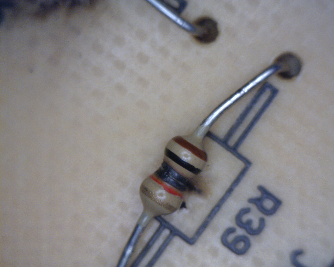

                R39: Brown, Black, Unknown, Orange and Gold: 10x kOhm 5%
                R38: Yellow, Red, Unknown, Black, Gold: 42x Ohm 5%
                Anyone had a board that can measure those for me? Also, on the back several diodes are shorted, any idea what type / spec diode these are?
                  R45 is 0.39 Ohms, what do get on your Ohm meter?

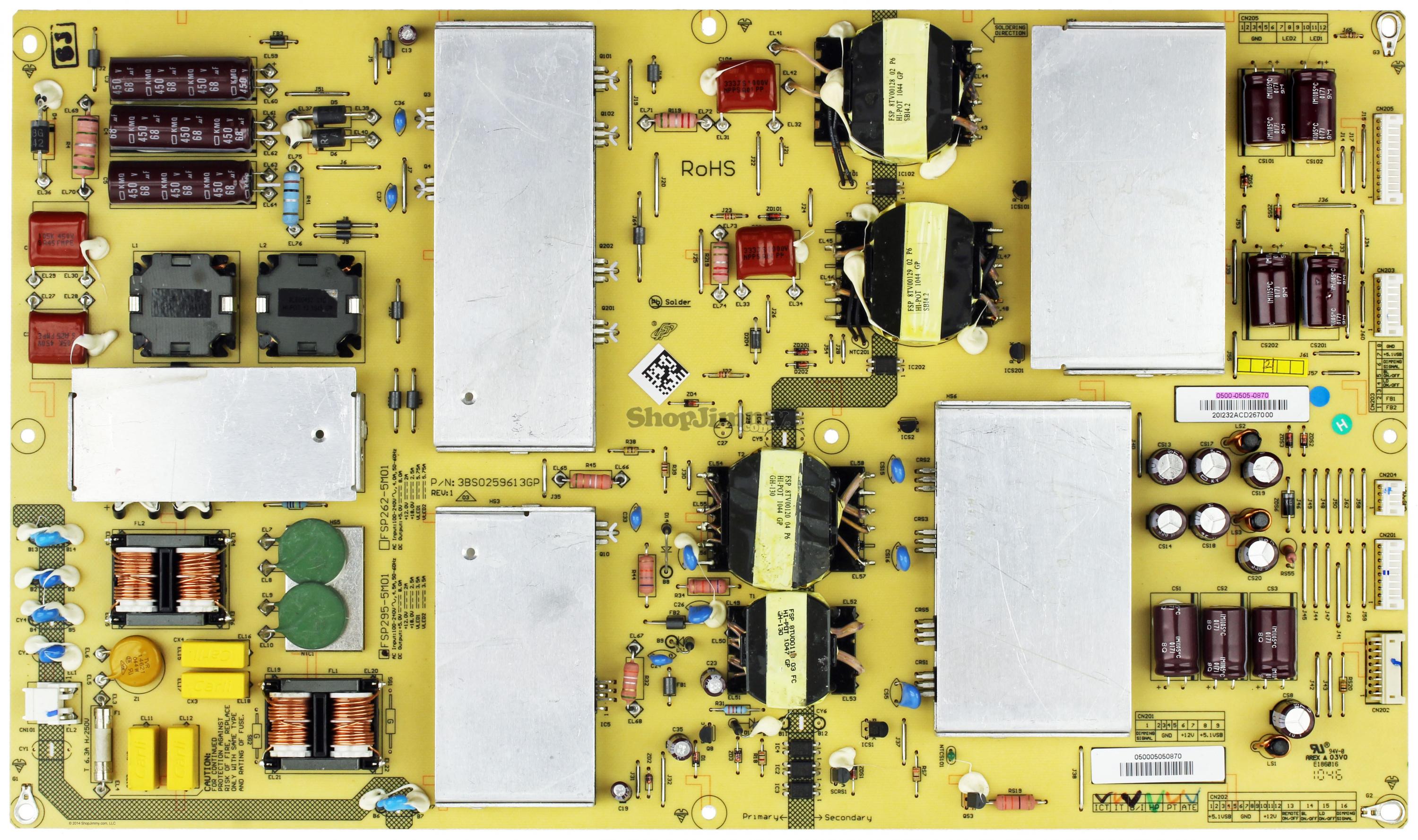

                  The other 2 you can go to Shopjiimy to see if they have good clear pictures of your board.

                    IC8 cracked in half
                    Tried shopjimmy... not much luck.. good picture, but difficult to make out colors

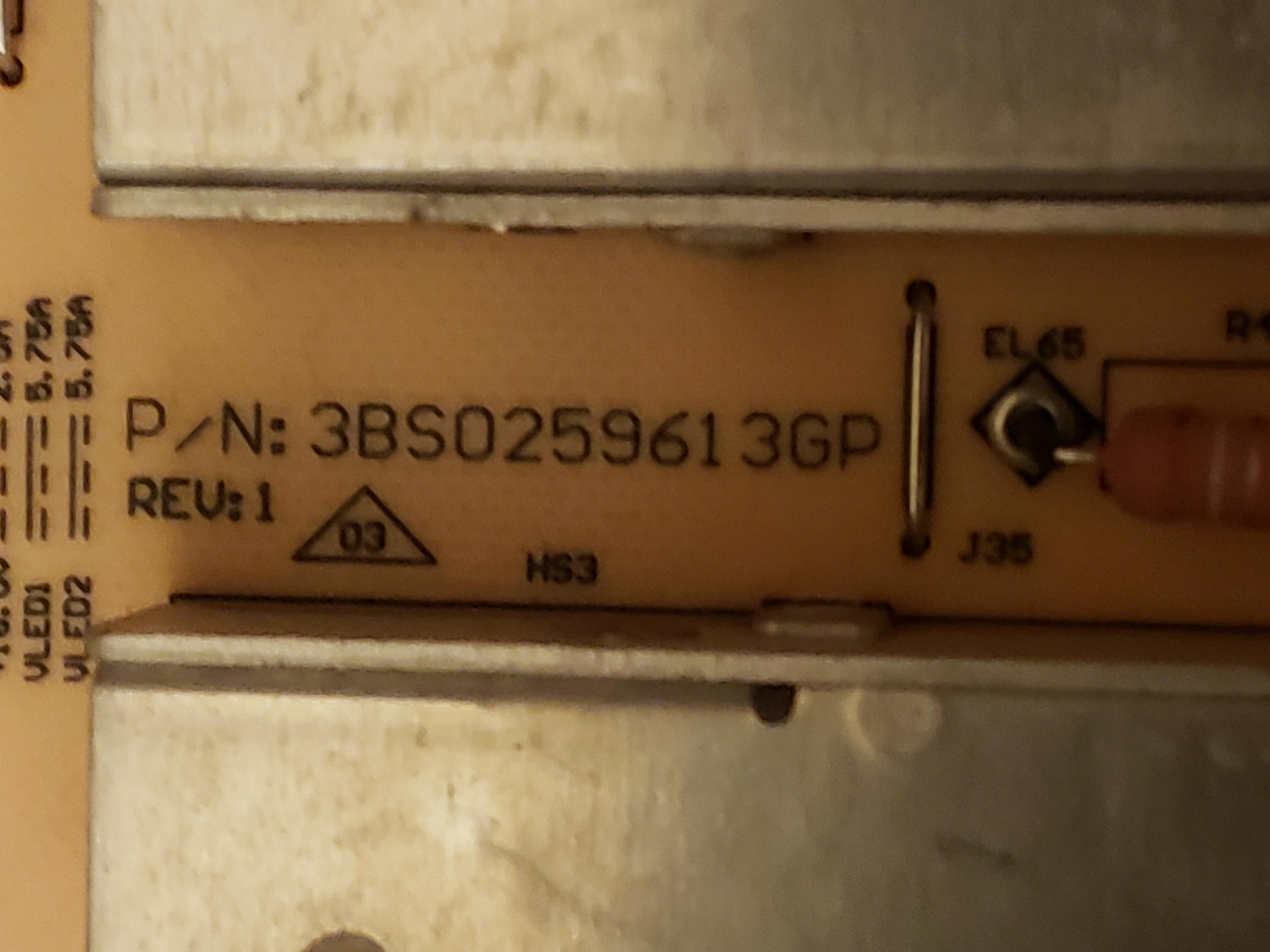

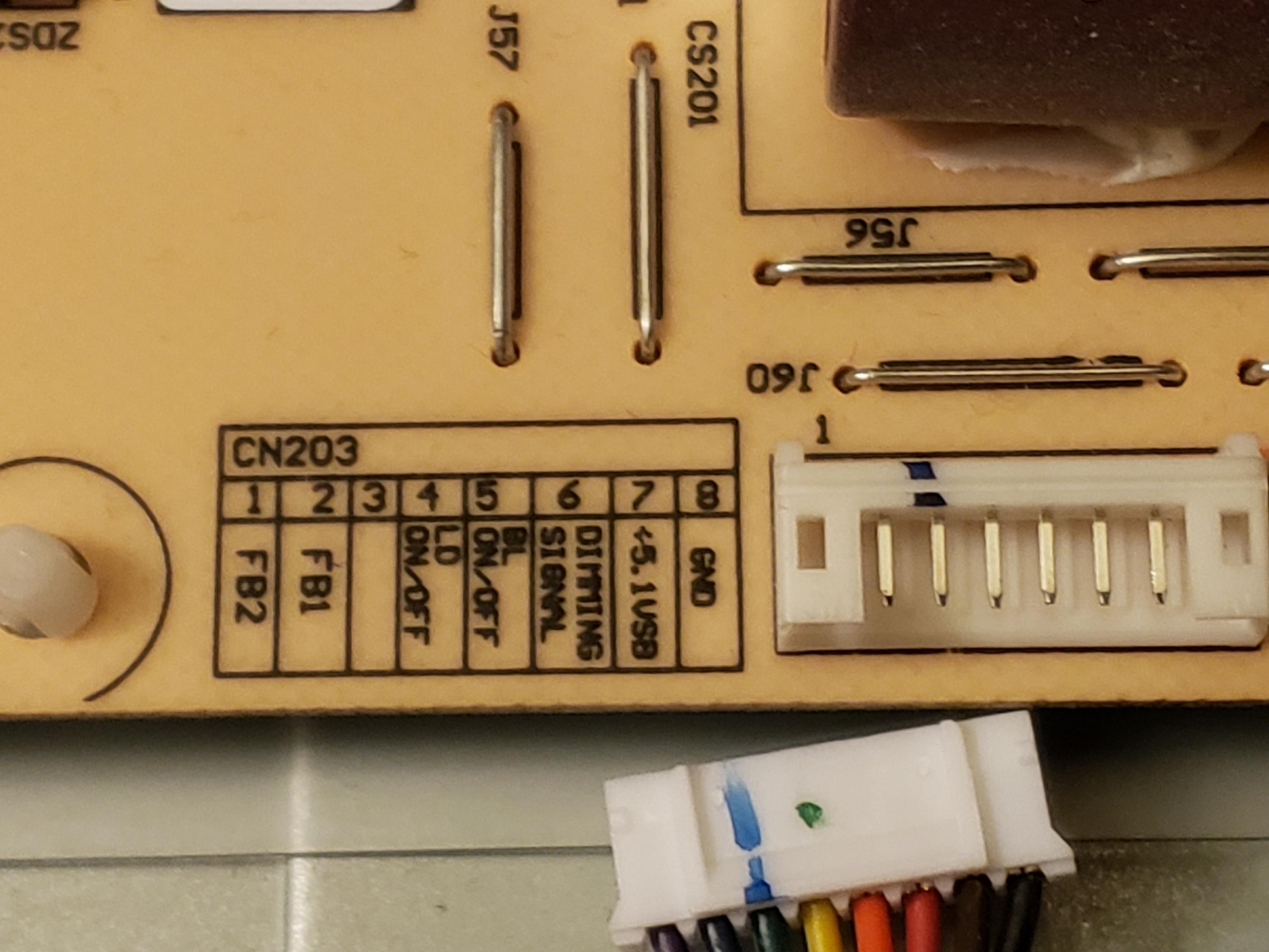

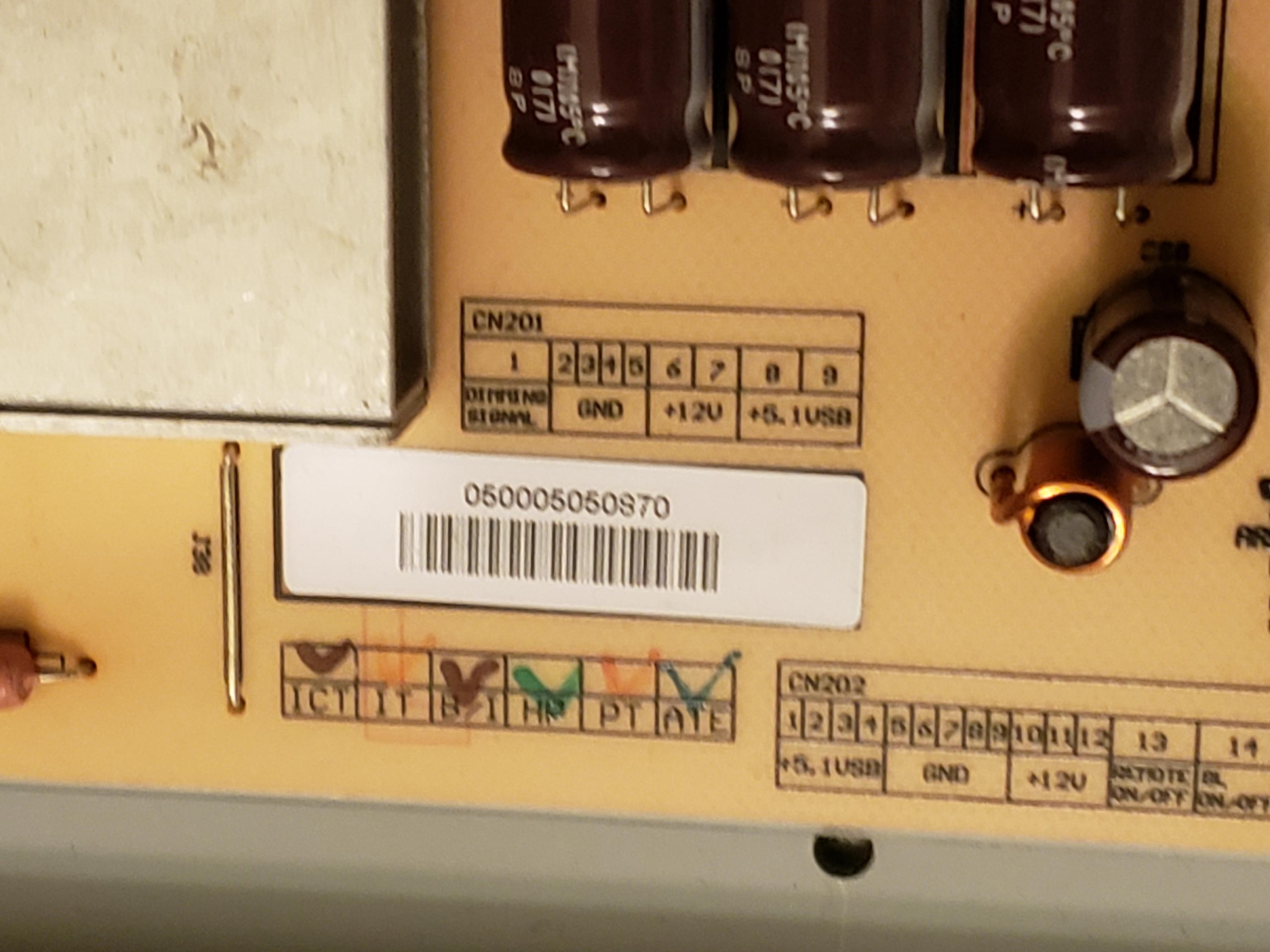

                      Just bought a new PS board -
                      R45 measures 0.41 Ohm
                      R38 measures 46 Ohm
                      R39 362.9 Ohm
                      R40 5.1 Ohm
                      IC8 FAN7602
                        R38 measures 46.4 Ohm out of circuit
                        R39 .999k (1 KOhm) Ohm out of circuit

                              So the TV is now working after installing the new power supply board, and now you want to fix the old power supply board, correct?

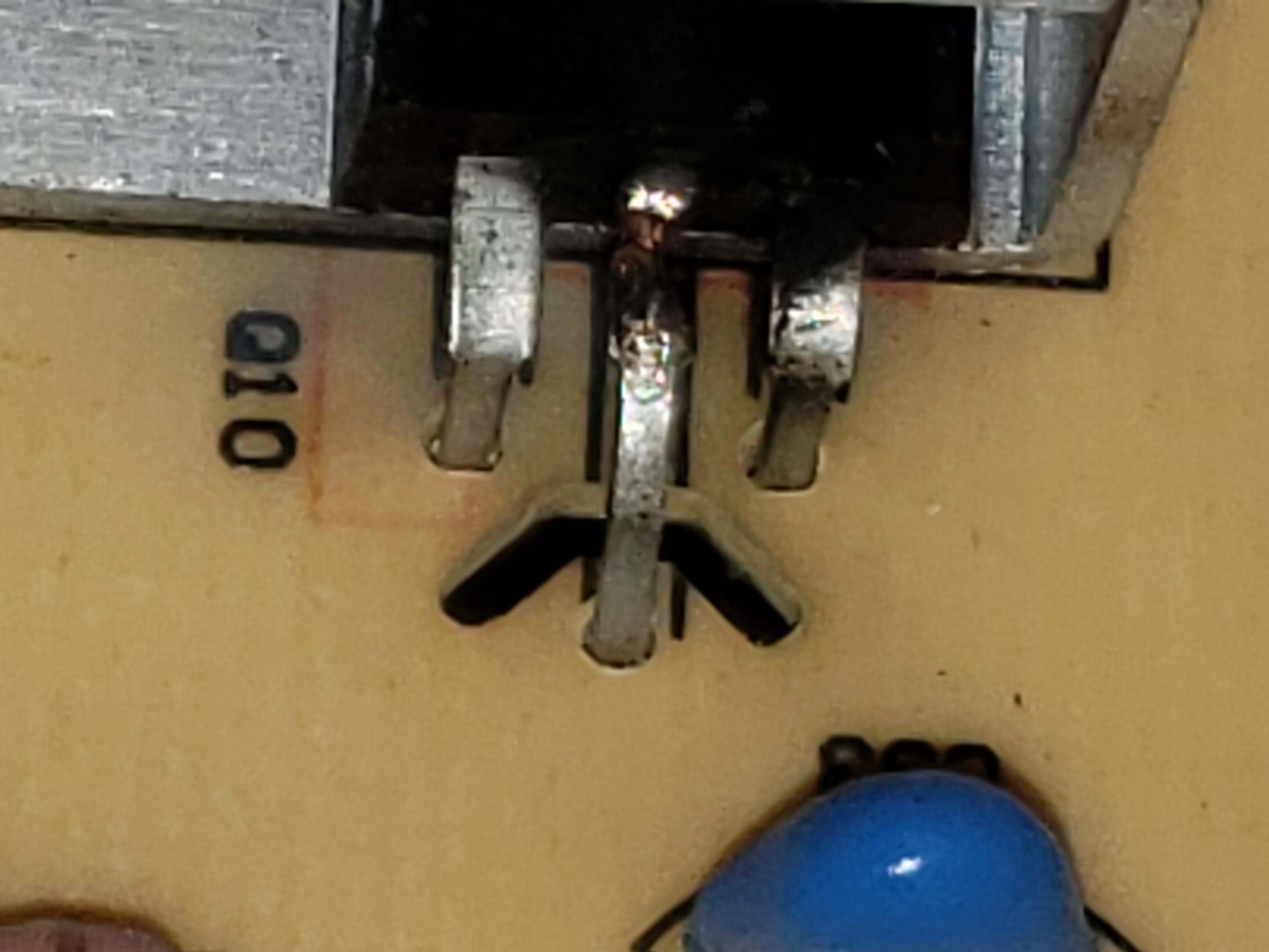

                                  Did you replace MOSFET Q10 too?
                                  R39 is replaced with 1K, correct?
                                  ZD4 tested OK?
                                  • jason123
                                    • Oct 2015
                                    • 1069
                                    Yes, Q10 is replaced
                                    R39 is 1k Ohm 1/4 watt

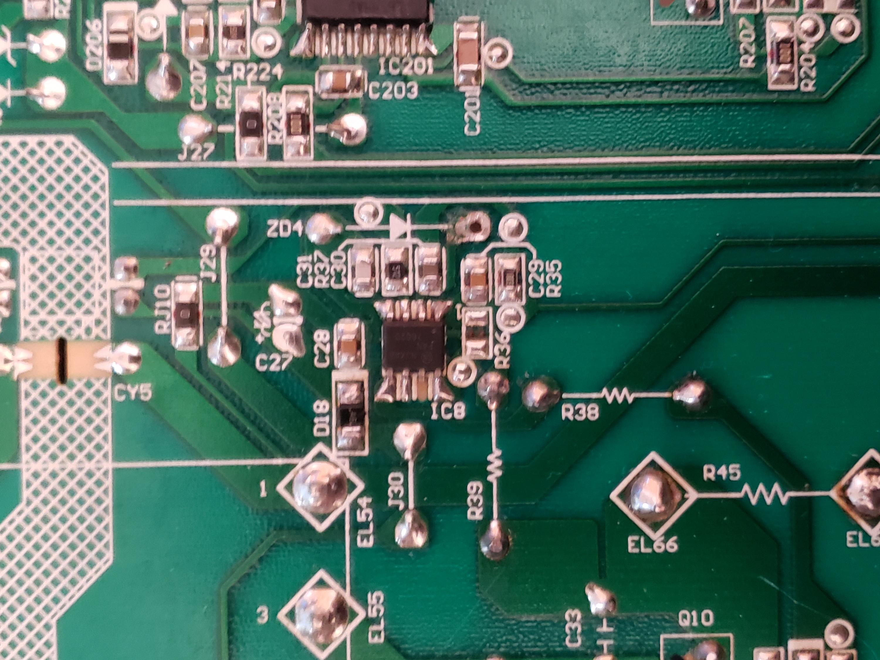

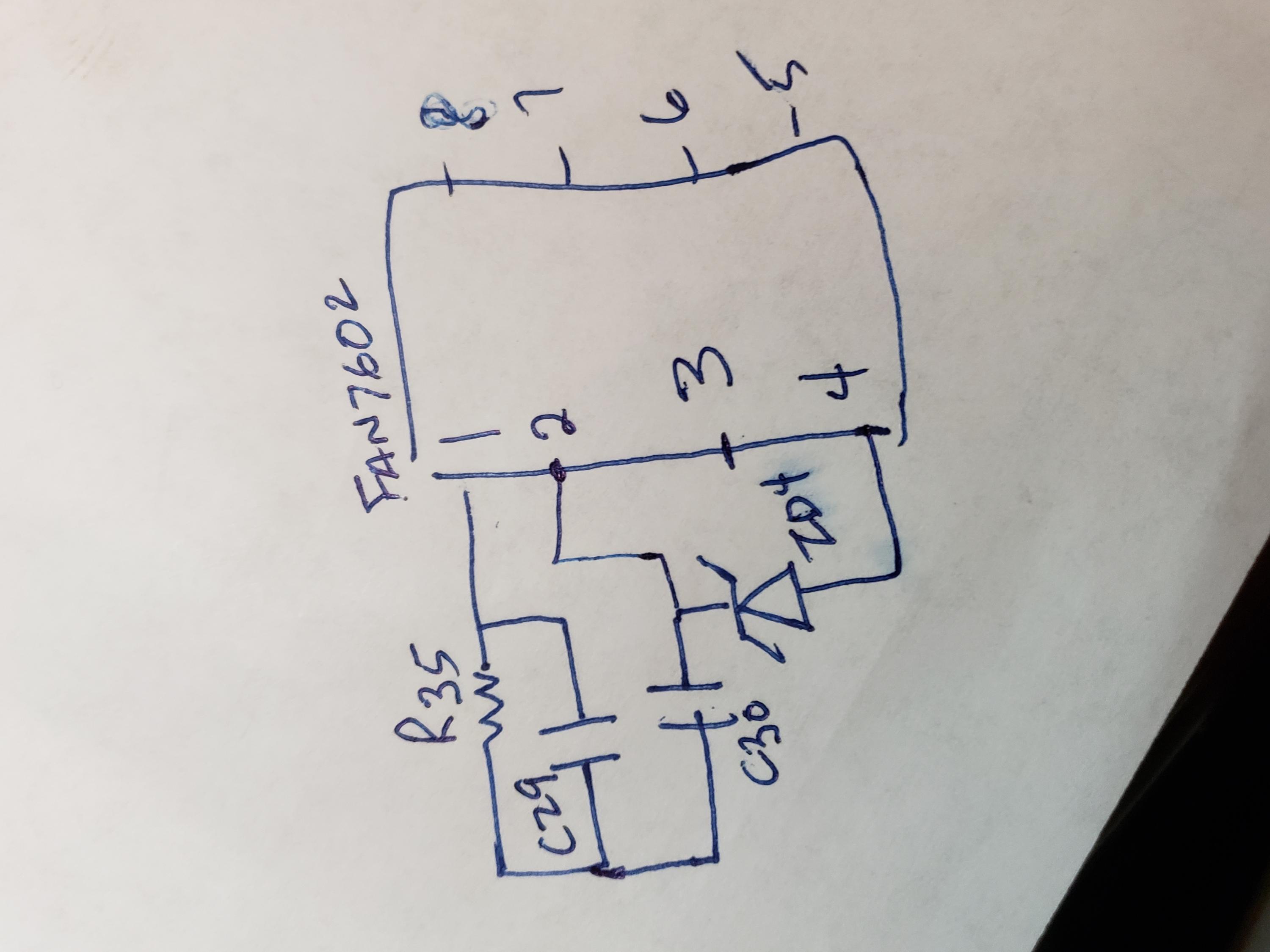

                                    ZD4 is shorted (in and out of circuit) - Any idea what replacement I should get?
                                      Trace out to see how that ZD4 is connected in the circuit.
                                      https://www.shopjimmy.com/vizio-fsp2...nit-board.htm#
                                      FAN7602
                                      It is may be connected like as shown in the application circuit page 12.
                                        Could this be right? It doesn't match app notes or datasheet connections. It's missing that Pin 1 of IC also goes to other parts on the board.
