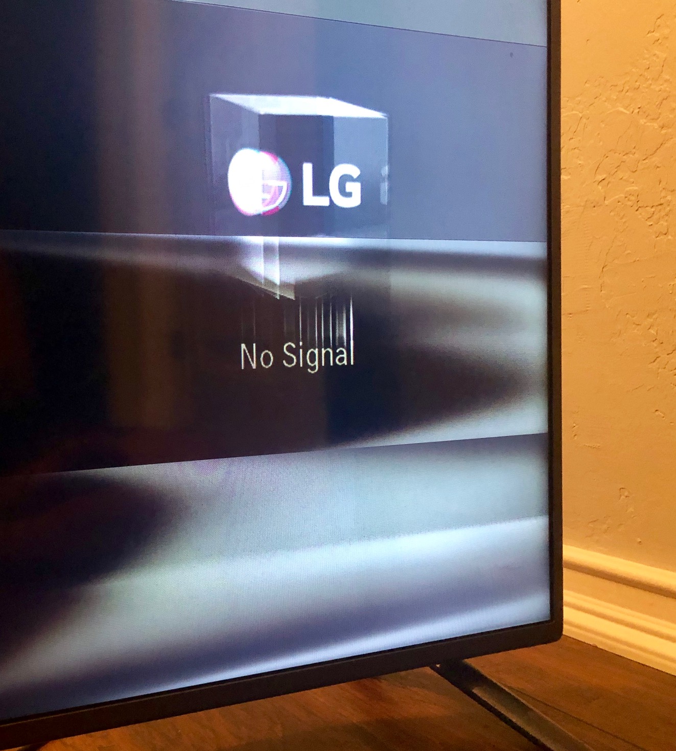

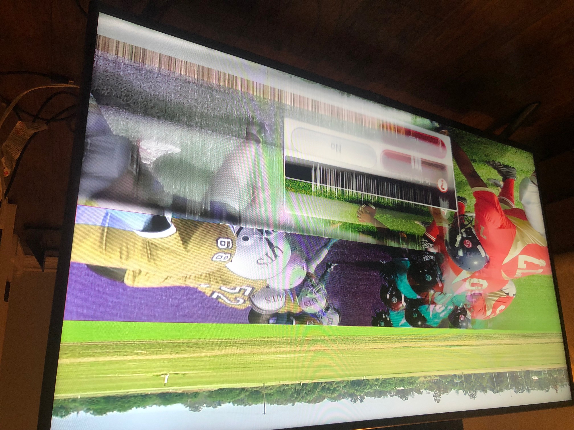

    This TV will have a glitchy, flickering, double picture. It does not effect the splash screen at all. The picture will flicker (doesn't appear to be backlights, I checked them all and they are all good) and eventually the entire screen will flash white and then black...the TV will stay on, but there will be no picture.
    Unplugging each half of the TCON seems to produce a normal half-picture. Only when they are both plugged in does it have issues.
    Any ideas on where I should start?

    Can you post a picture of the "double picture" you mentioned?
    • philtvman
      • Jun 2016
      • 94
      • America
      Re: LG 50LF6100 Glitchy Picture
      Maybe "double picture" isn't the best way to describe it. I attached a closer up picture of what it is doing. The image that passes through the particular section will become 'stretched'. The picture will flicker and eventually the screen will quickly wash white (from one side to another) and then black...backlights all stay on, just no picture.
      Again, this only happens with both sides of the TCON plugged in. Unplugging in will result on a perfectly fine half screen.

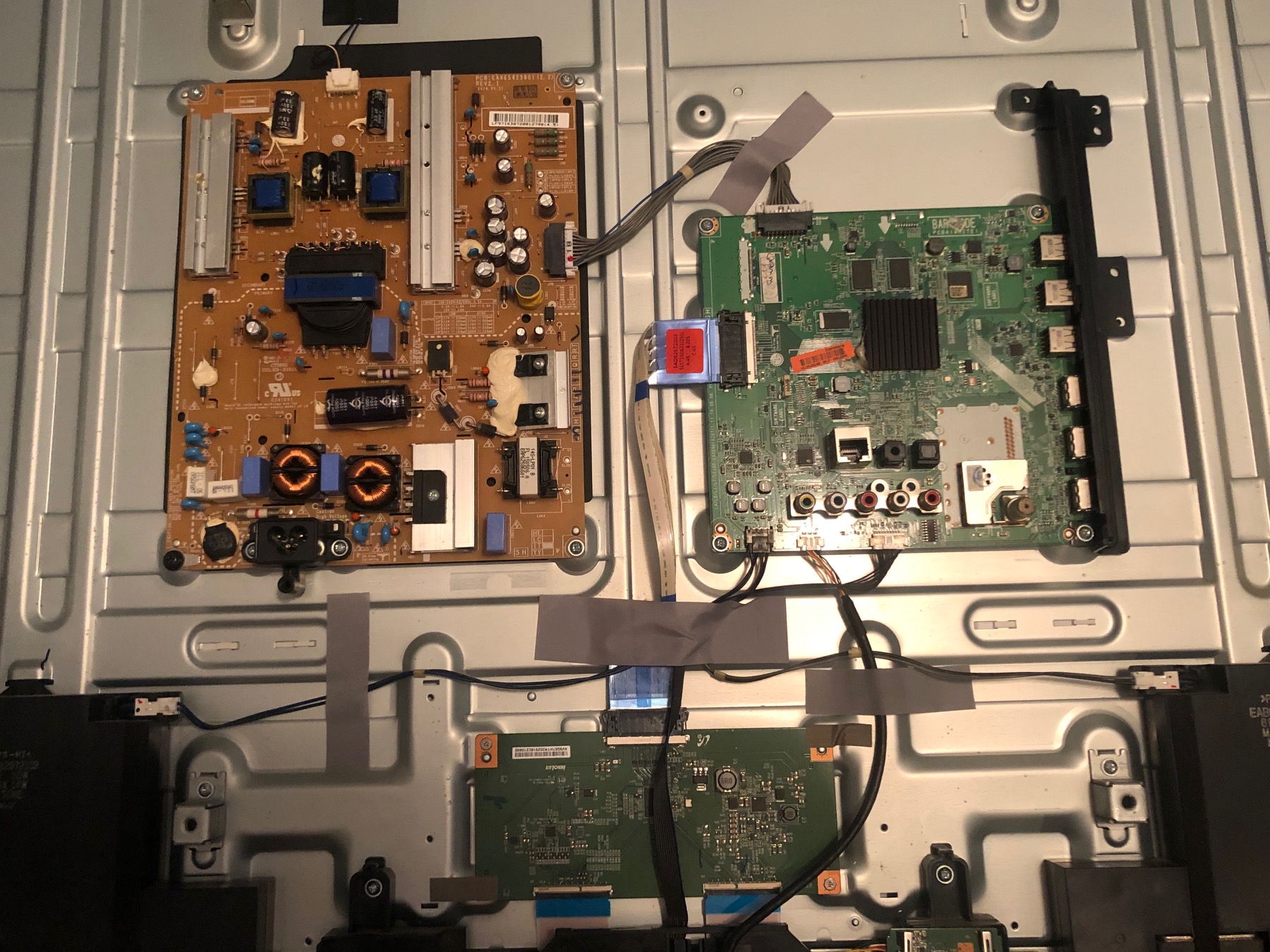

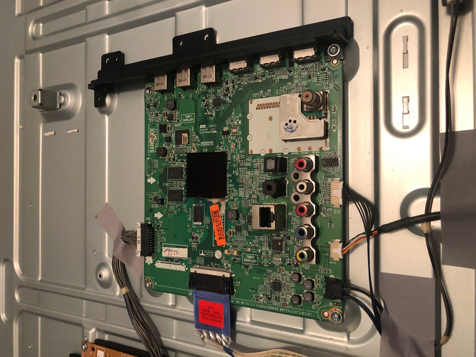

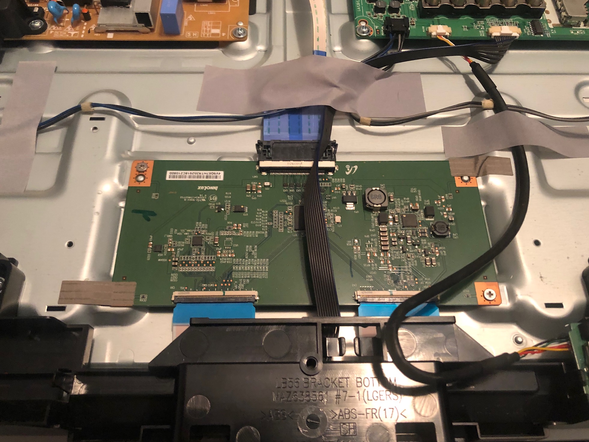

          Can you post some good clear pictures of each board and one of the whole back and how they are connected?
          • philtvman
            • Jun 2016
            • 94
            • America
            No change with the hair dryer. Attached are pics of the entire back, each board, and of a test image on the TV.

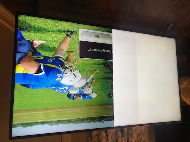

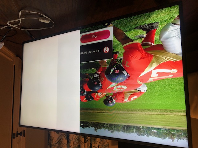

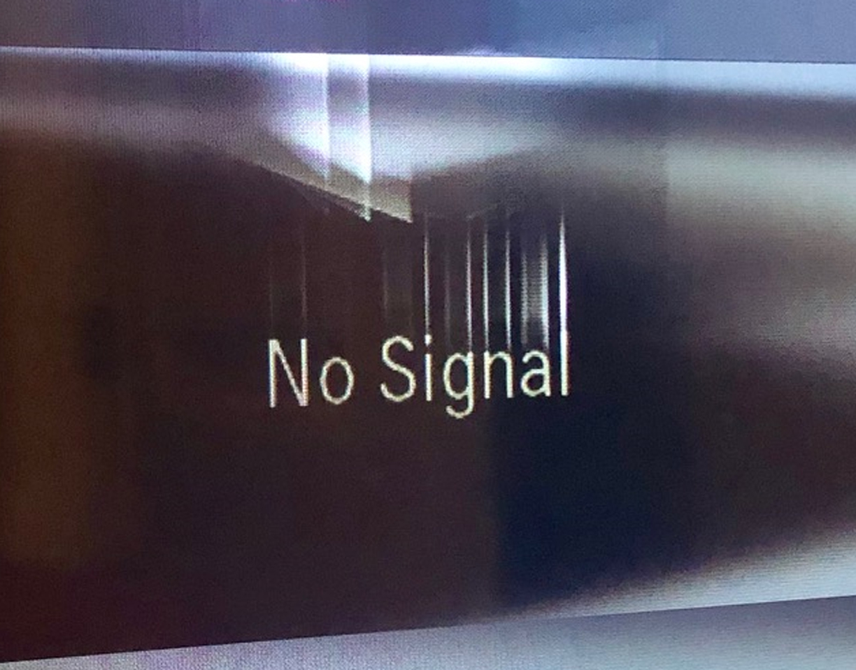

                No luck with that, Attached are pictures with each half of the TCON unplugged.
                (no idea why the attachment tool flips them, they're oriented correctly)

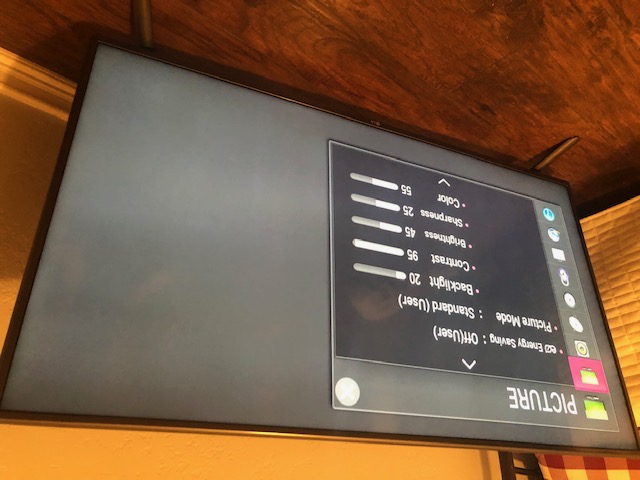

                  what do you see if you have just OSD user menu up without video source?
                  https://www.badcaps.net/forum/attach...1&d=1567169442
                  What does the picture look like without having the user OSD showing?

                    Just went to check. TV turned on fine, menu opened fine, but after about three minutes the picture went black. Backlights stay on, but no picture.
                    This is a GIF of the TV turning on after it lost picture juts now
