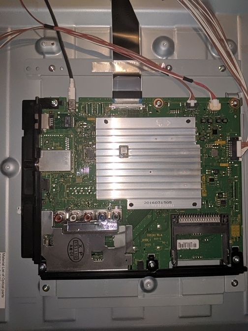

    Re: Panasonic TX55DX600b Continuous red lights 3 seconds apart
    With tv unplugged from power, unhook cable from powerboard to mainboard, plug tv into power, see if backlight comes on and stays on.

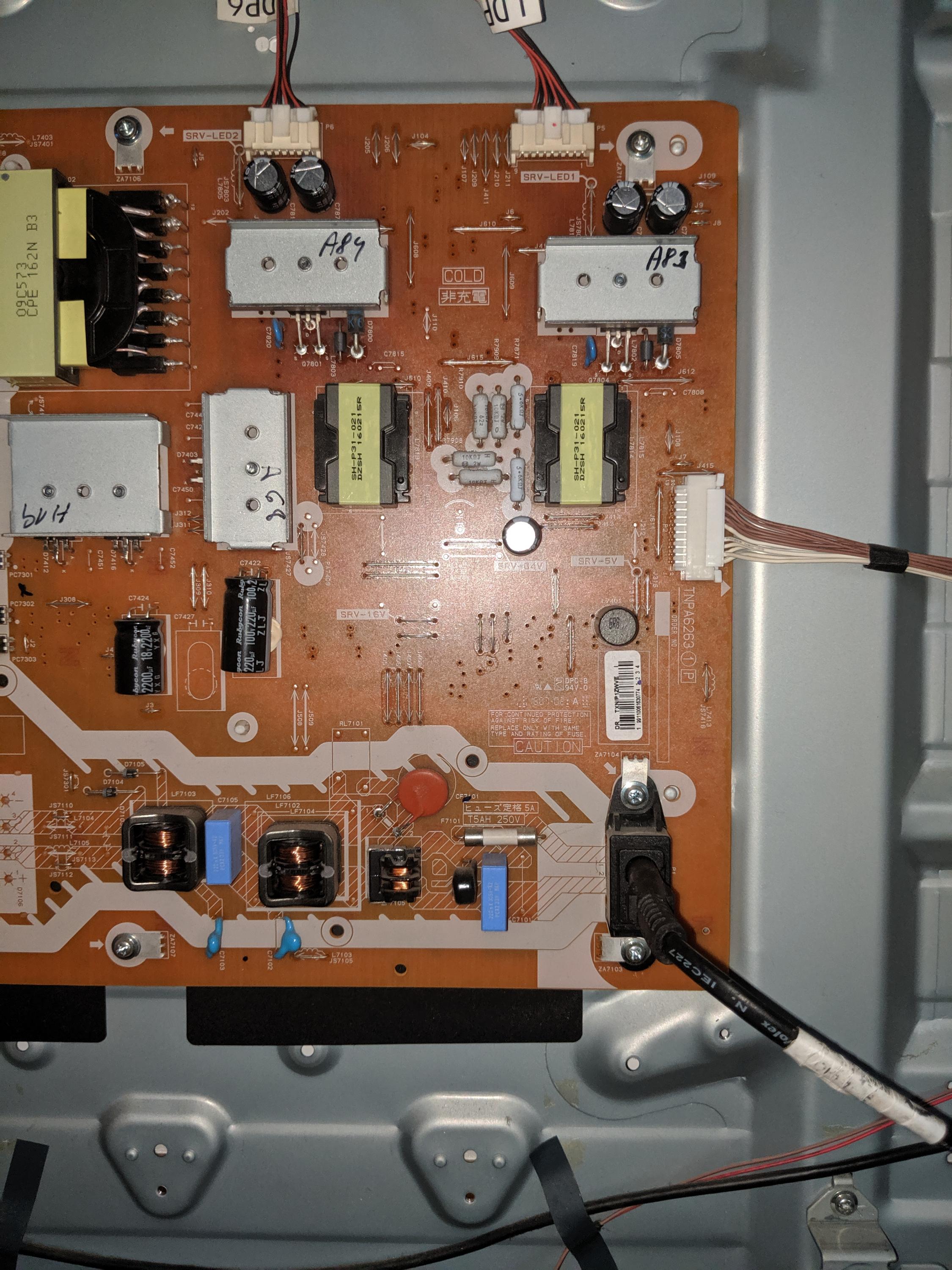

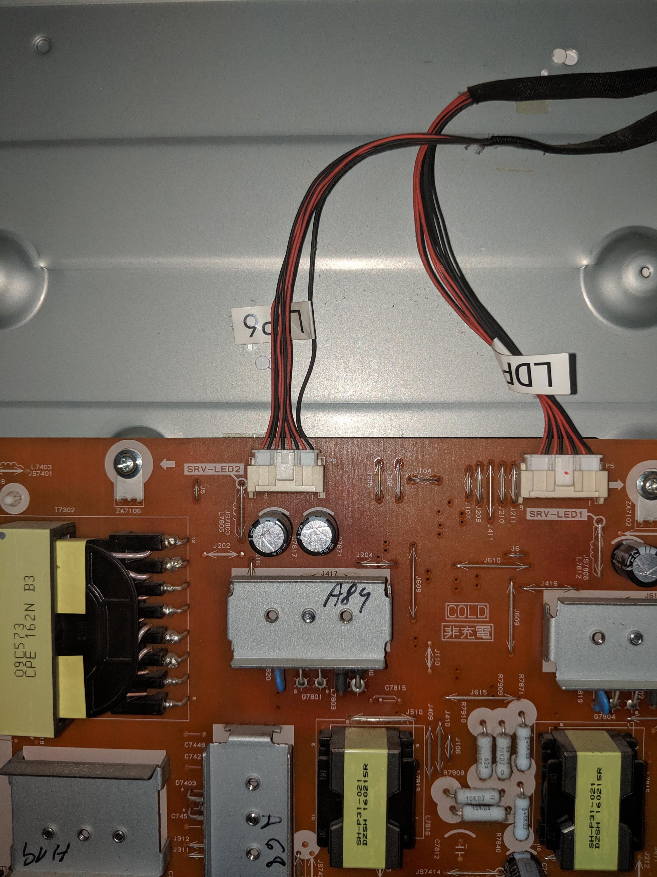

        Check the voltage going to the two led strings on the power supply, test points SRV-led1 & SRV-led2, monitor the point and turn on the tv and note the voltage.
        How many wires are on each plug going to the leds? You may need to test the voltage on each wire going to the backlights to get a better idea of the problem.
        Post pictures of the board and the plug going to the led's

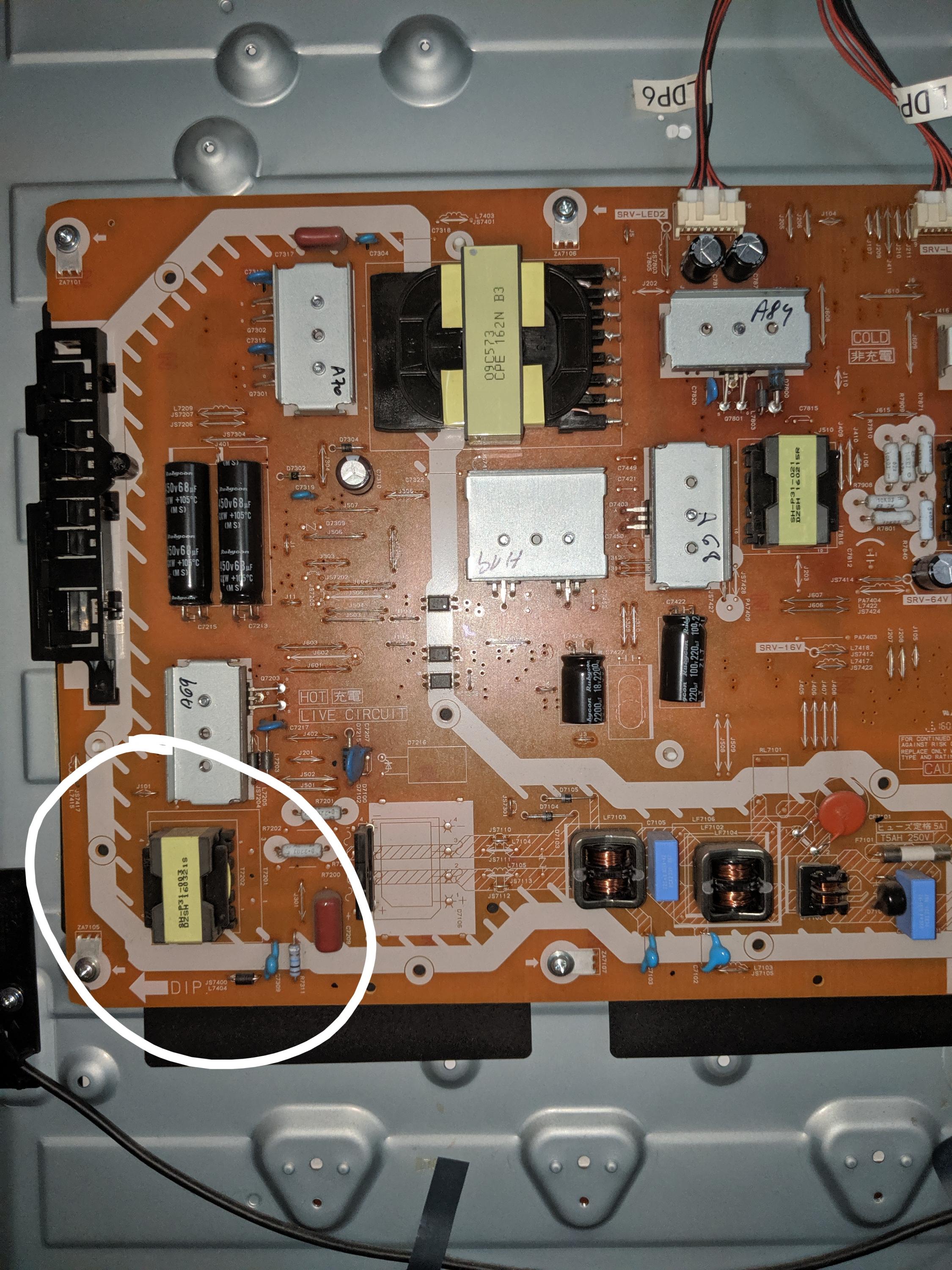

          Quite a few I think 1 or two on each report 1.000v the rest below 1.000v between 0.700 0.012
          Also I hear a clicking coming from approximately the area circled hard to tell exactly.
          Also whether I press power on or off it dosn't change Noether does the clicking
            It looks like you have 8 strings of LED, 4 strings per LED drivers, there are two LED drivers.
            The SRV_LED 1 and 2 are for feeding the Voltages to the Anodes of the LED strings.
            With black probe on chassis and red probe on The SRV_LED 1, what do you see on the meter when you turn on the TV? Same for SRV_LED 2.

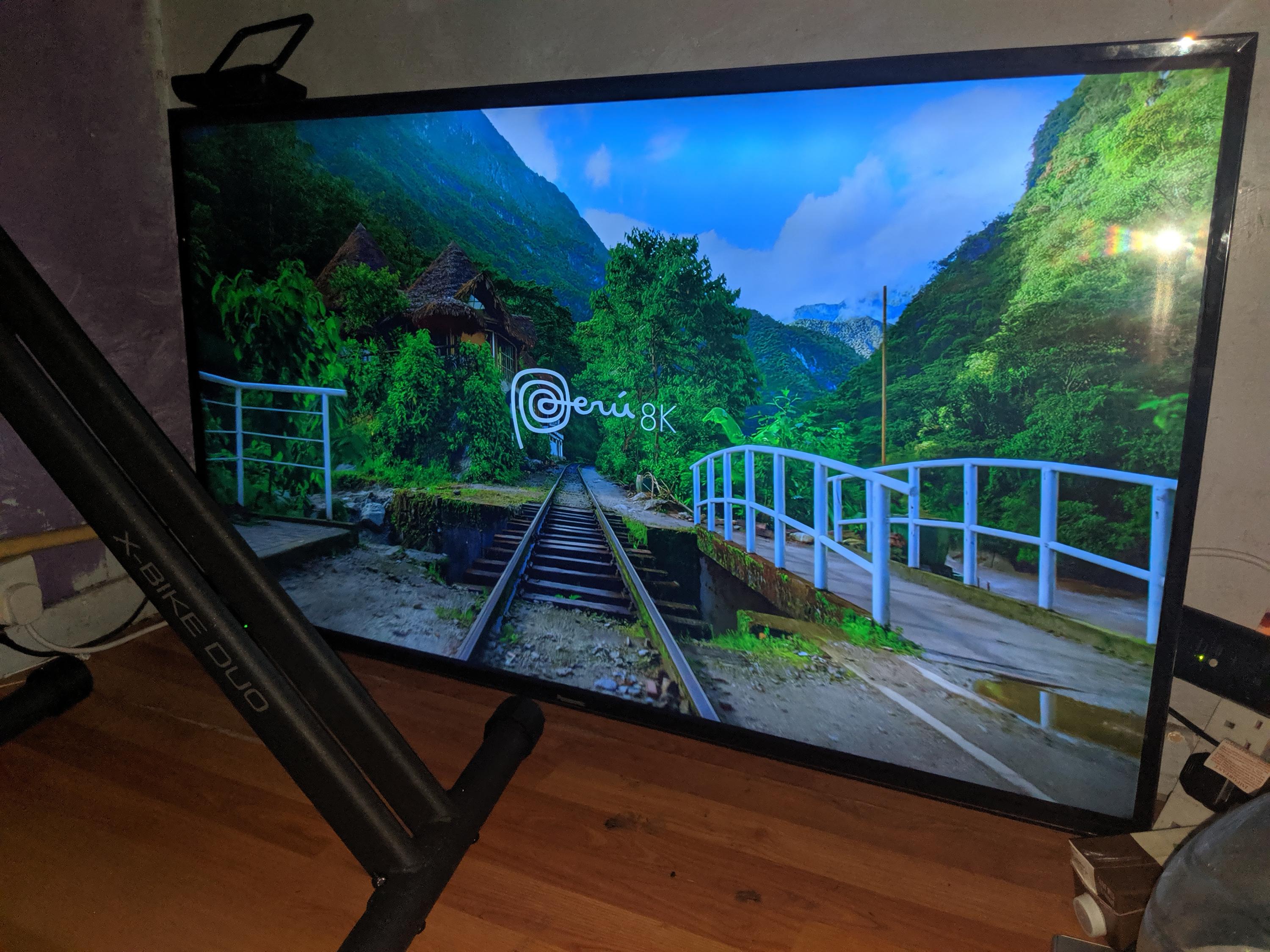

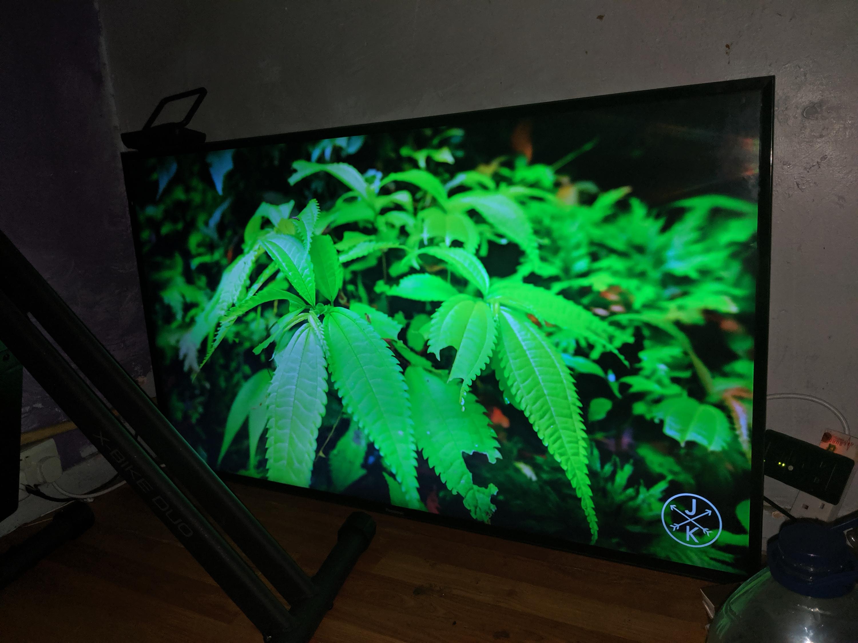

                            Finally came it was the fix thankfully and low backlight looks good on this TV.
