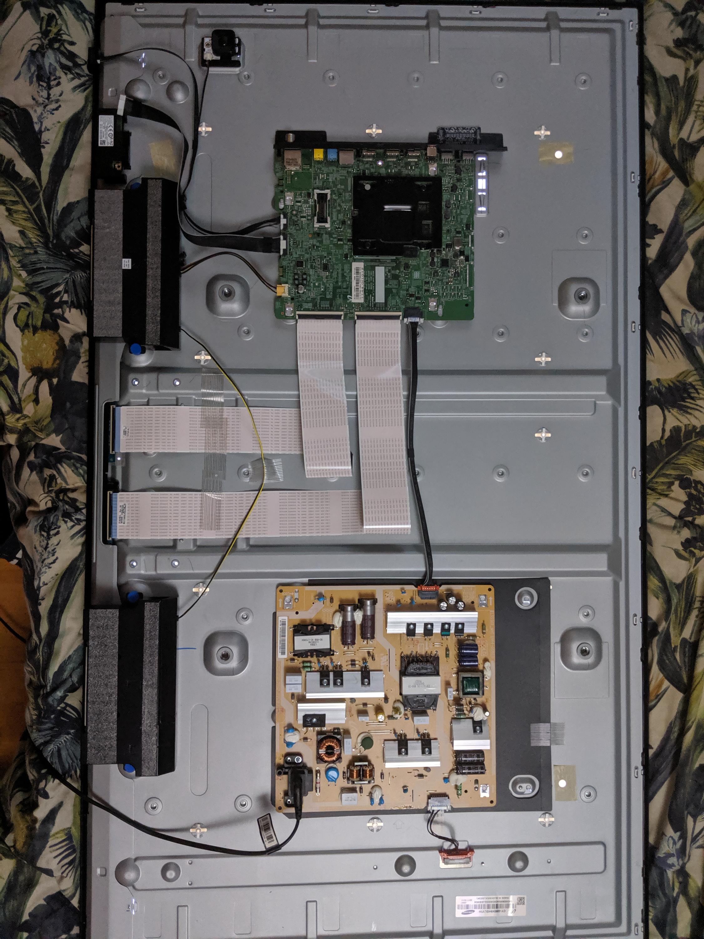

    Samsung UE49MU6120K works then off/lines/flickers

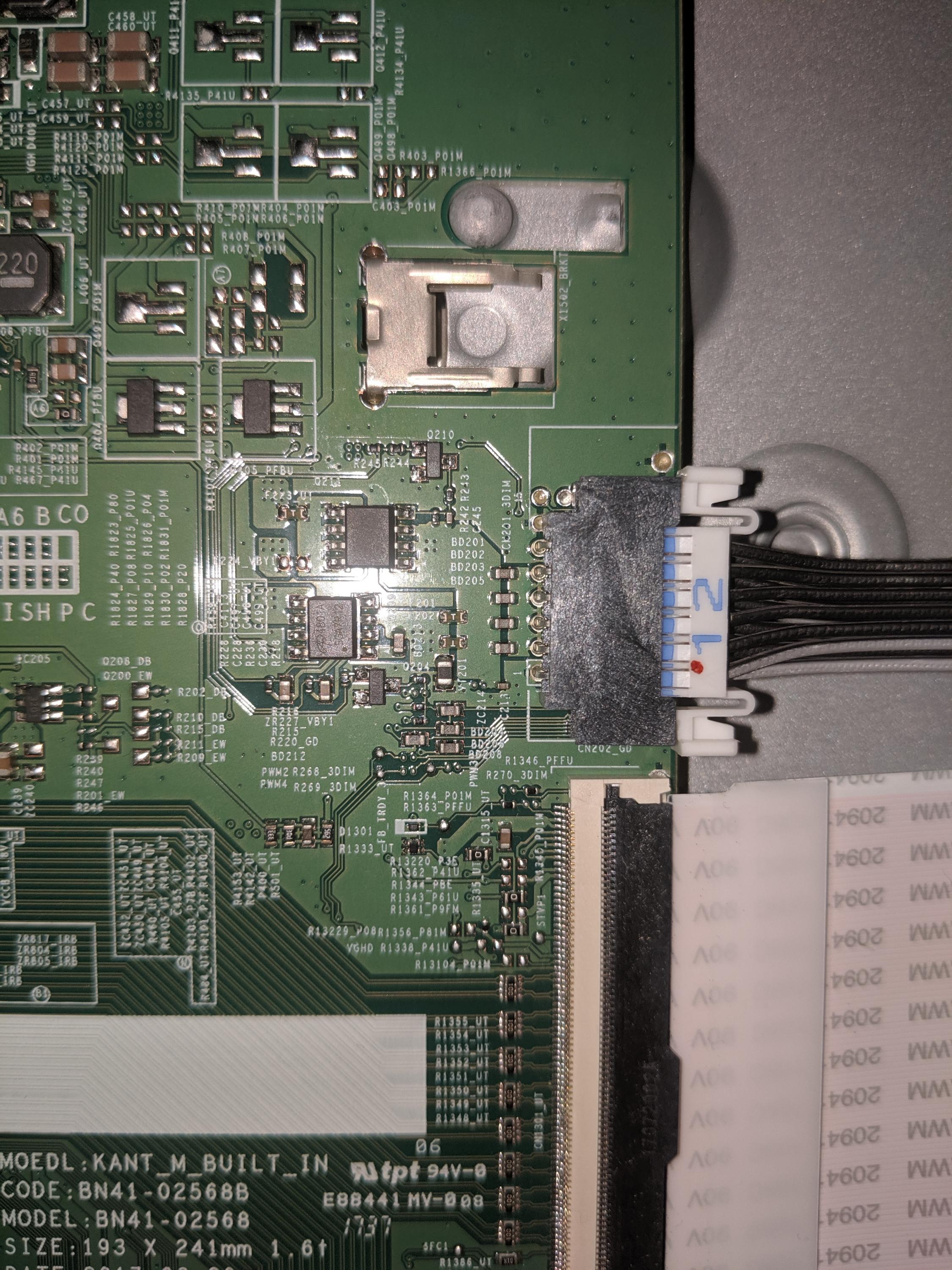

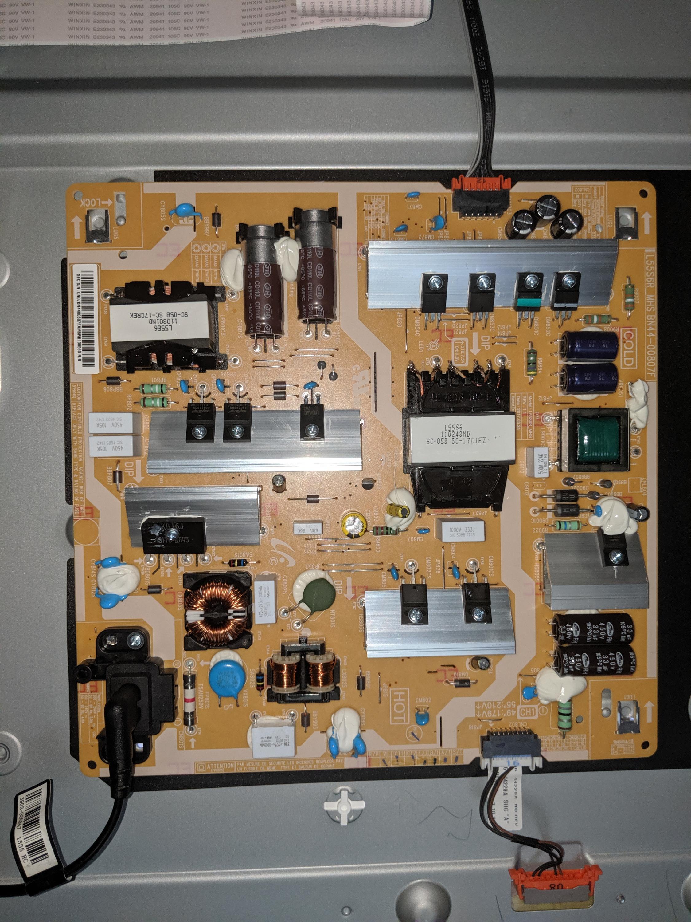

    This is strange it worked almost everytime the last 6 times for around 4 hours then it fades slightly and powered off and then quite quickly powers on and off while there is flickering and horizontal or vertical lines.
    Today I went to watch it and it didn't even give me the 4 hours then I take a break for 30 min and it works it went straight to dim backlight then lines on TV then off and on etc.
    Any ideas main board or powerboard or possibly something else?

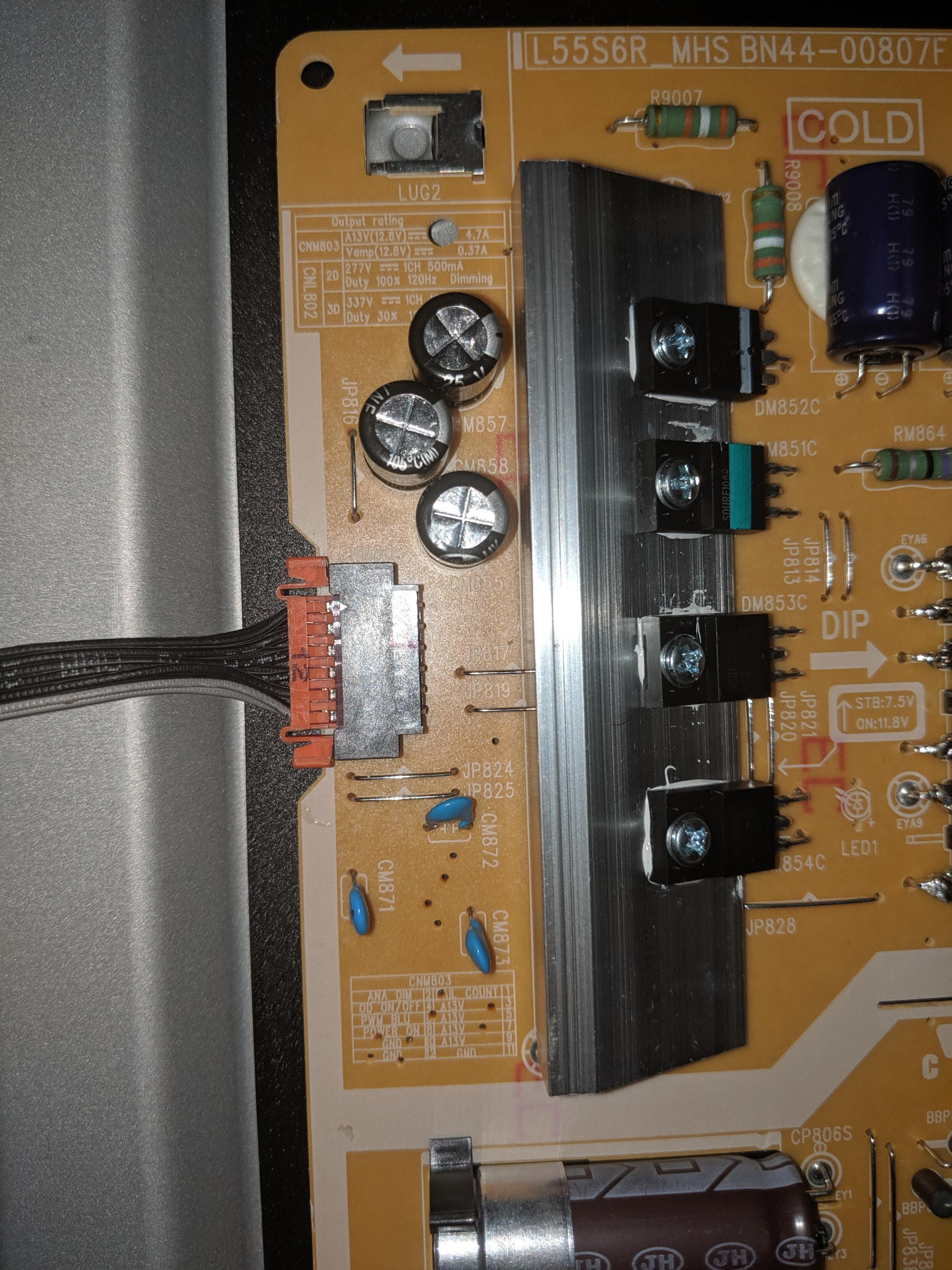

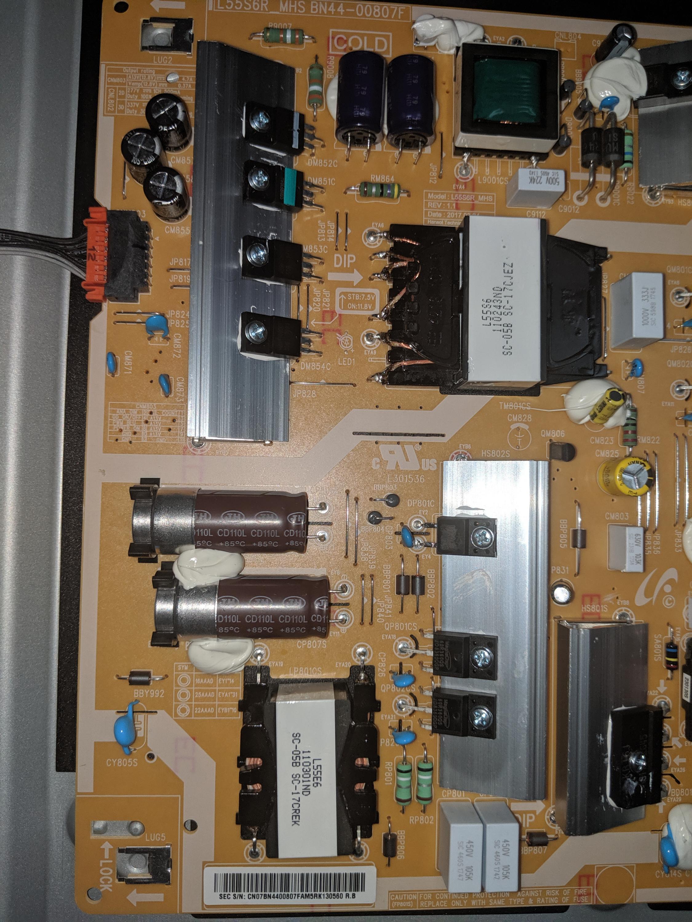

    I took voltages on powerboard to the main board that were meant to be 13v I think we're 12.7

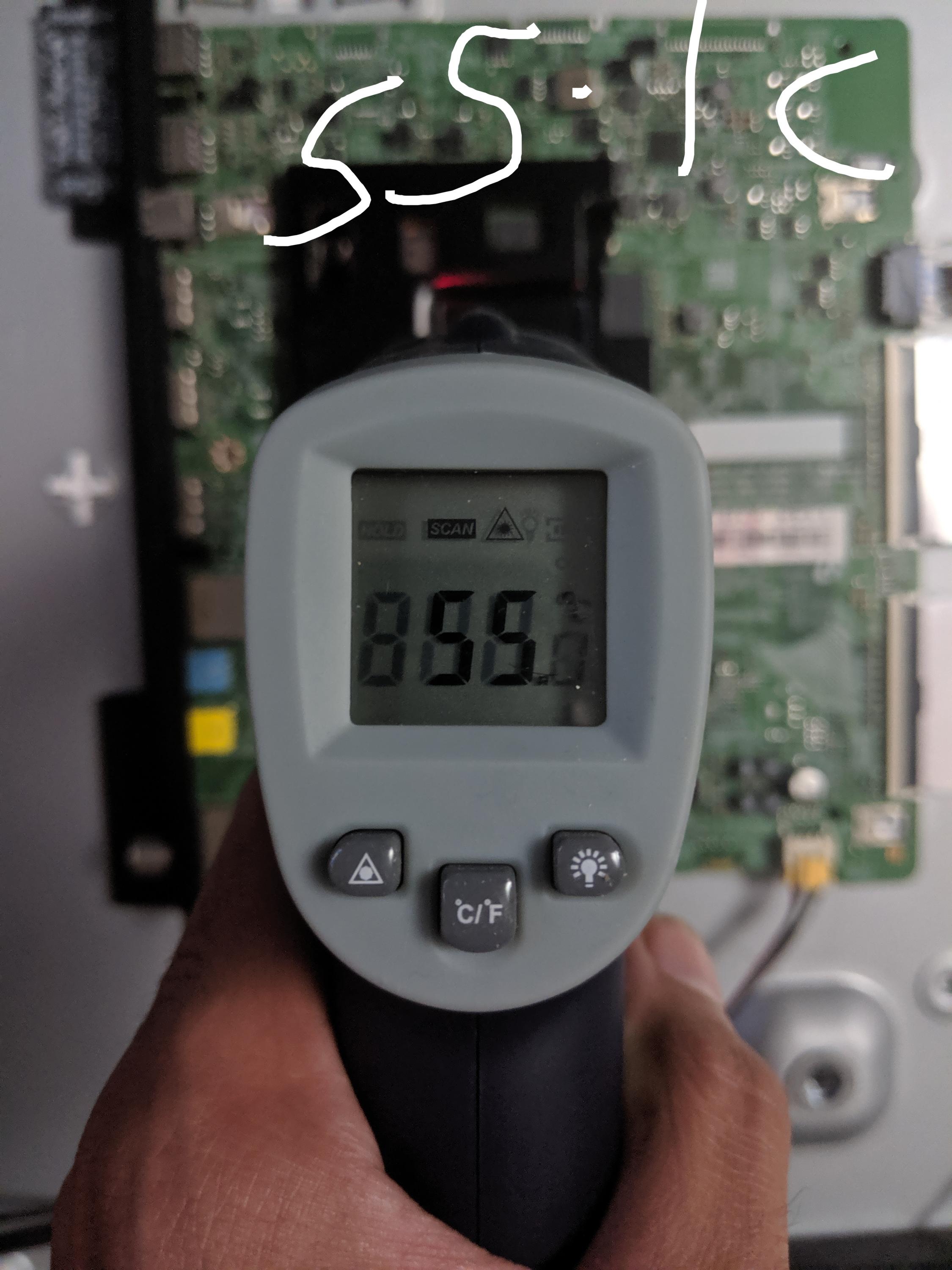

    To add I did feel heat and smell something I can't remember what it smelled like while it was on. Now I opened it the heat I'm sure was from the powerboard area. Maybe normal but don't feel that in my Sony set.

    Re: Samsung UE49MU6120K works then off/lines/flickers
    First guess would be mainboard fault, here's how you test those voltages at the connector going from powerboard to mainboard: Test connector from mainboard to powerboard on powerboard side with all boards hooked up, test with tv plugged in but off then hit power, report both conditions here, give pin number, pin description/name and condition both off and when you hit power on. So we can see all the voltages and what they are doing. Try to do test just as instructed, example in second link below if needed.
    • Fixing222
      • May 2017
      • 67

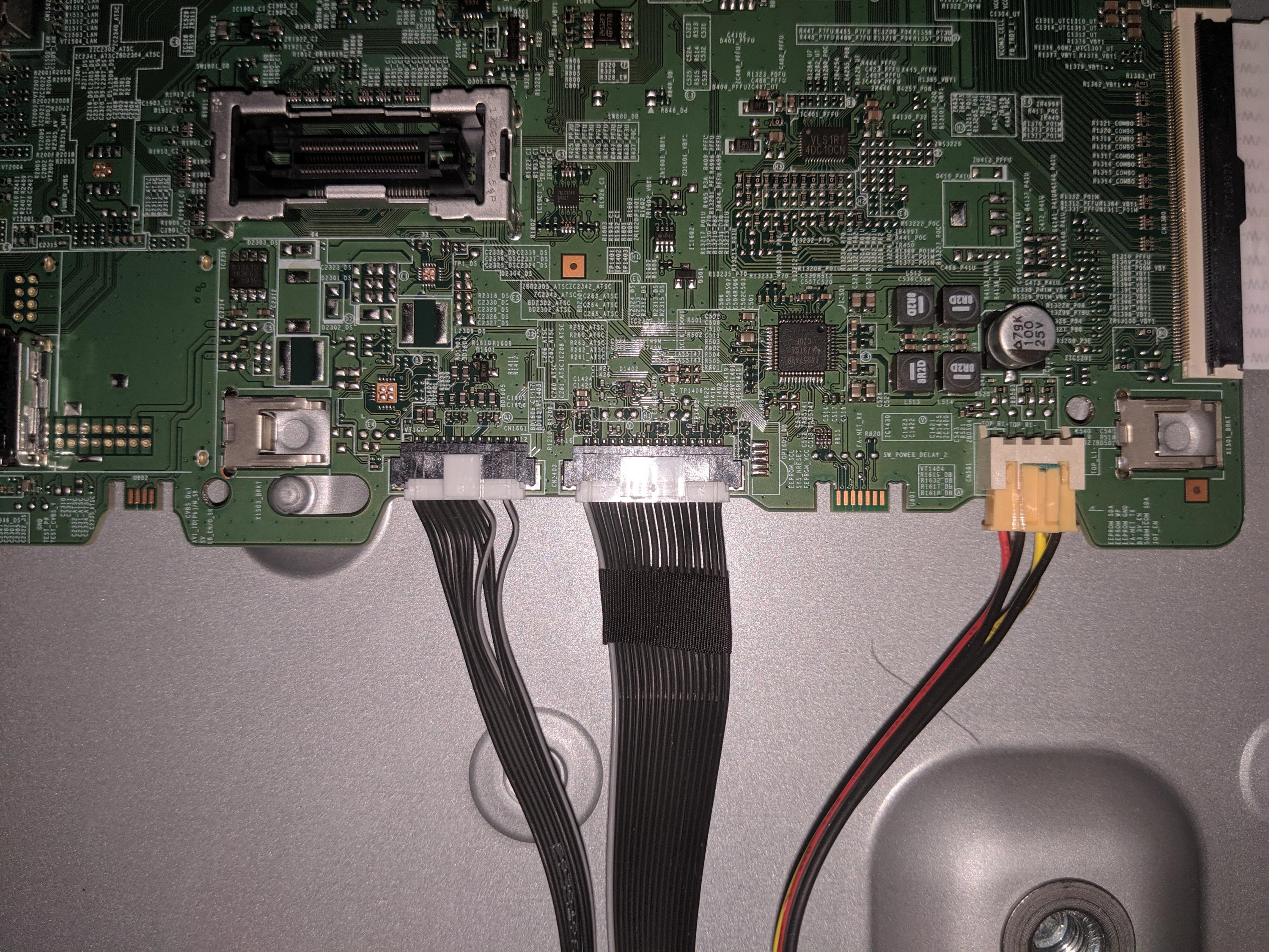

      I get 12.7v on them and the ground are -0.002 but could a bad main-board cause it to turn on and off repeatedly?
      • nomoresonys
        • Jan 2013
        • 12268
        • U.S.

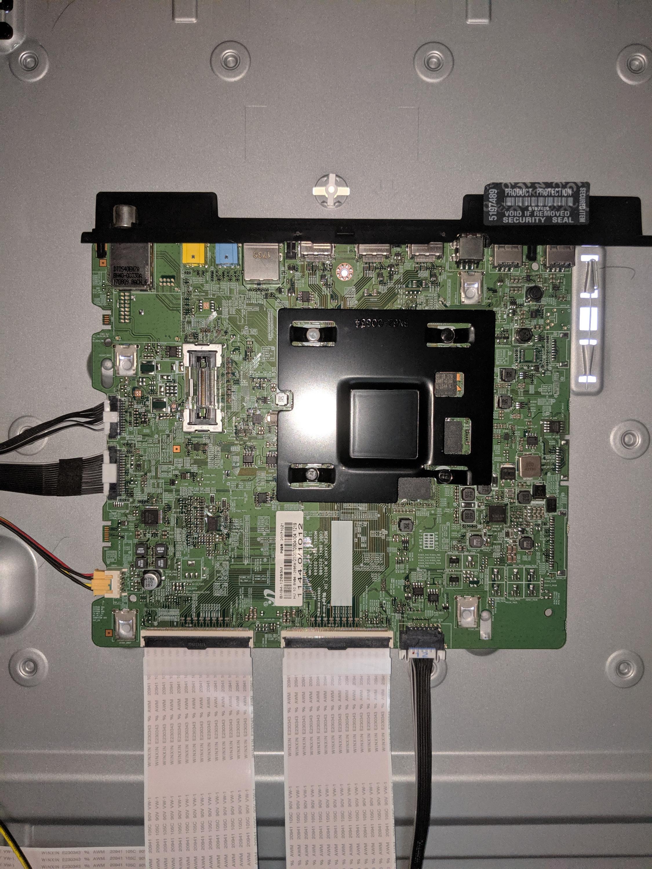

        It could, you need to test all the pins, the pictures are too out of focus to see the labels and such.
          Not sure what you mean pin number (Maybe CNM803)
          Incase anyone has similar here is a video of my TV fault
          https://vimeo.com/354973411
          From the top of the TV down these were the readings from the powerboard side
          3.18
          12.79
          12.79
          12.79
          12.79
          -0.007
          Temps were taken in standby
          Unfortunately I can't test with the TV off standby as of now for some reason it's decided not to turn on now only red standby tried button and remote
            With tv unplugged from power, unhook cable from powerboard to mainboard, plug tv into power, see if backlight comes on and stays on.

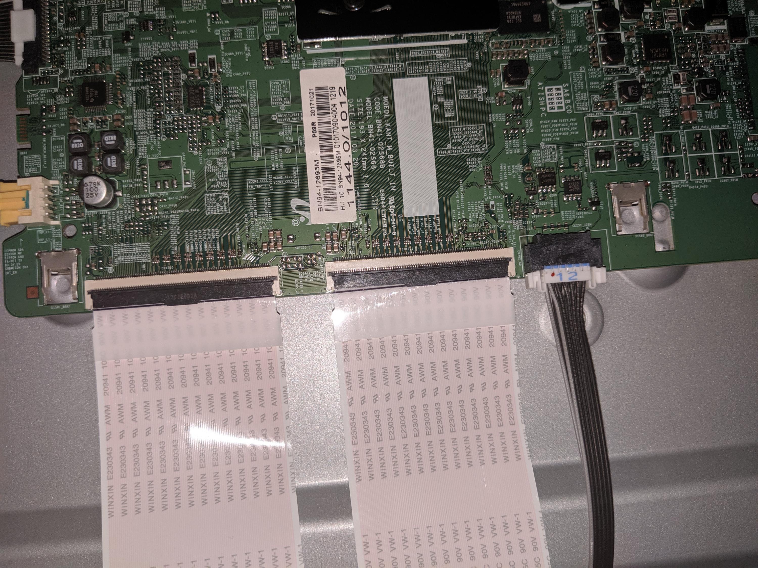

              What happen if you remove the two white flat ribbon cables on the main board that go to the LCD panel integrated T-CON board, does the TV still power off and comes back on by itself?
              BTW, inspect the female connectors of the cable that goes between Main board and power supply too for any sign of heating.
                Tested and yes it comes on and stays on.
                When tested the same thing happened off and on i could see backlights flashing and dimming etc like before. But i will check those cables in morning as i didn't check.
                  Disconnect the power cord from the outlet, then press and hold the power button on the TV (not the remote), for 30 seconds. Then wait a few minutes and plug the TV back in and press power once, variation could be hold power button while plugging in.
                    Looking like a mainboard issue.
