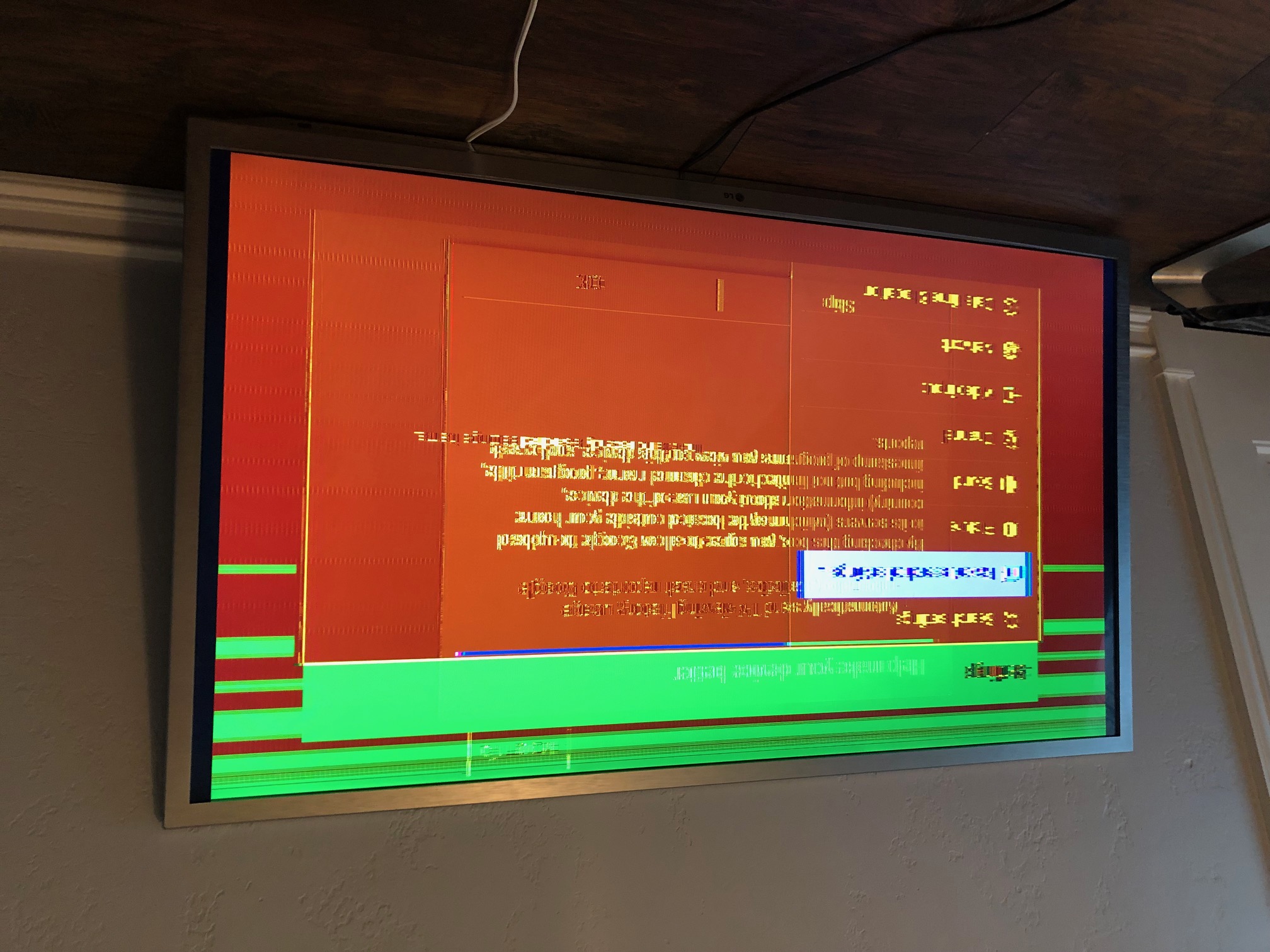

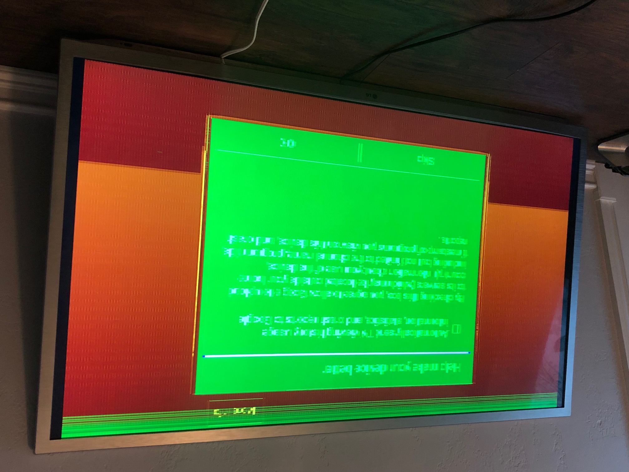

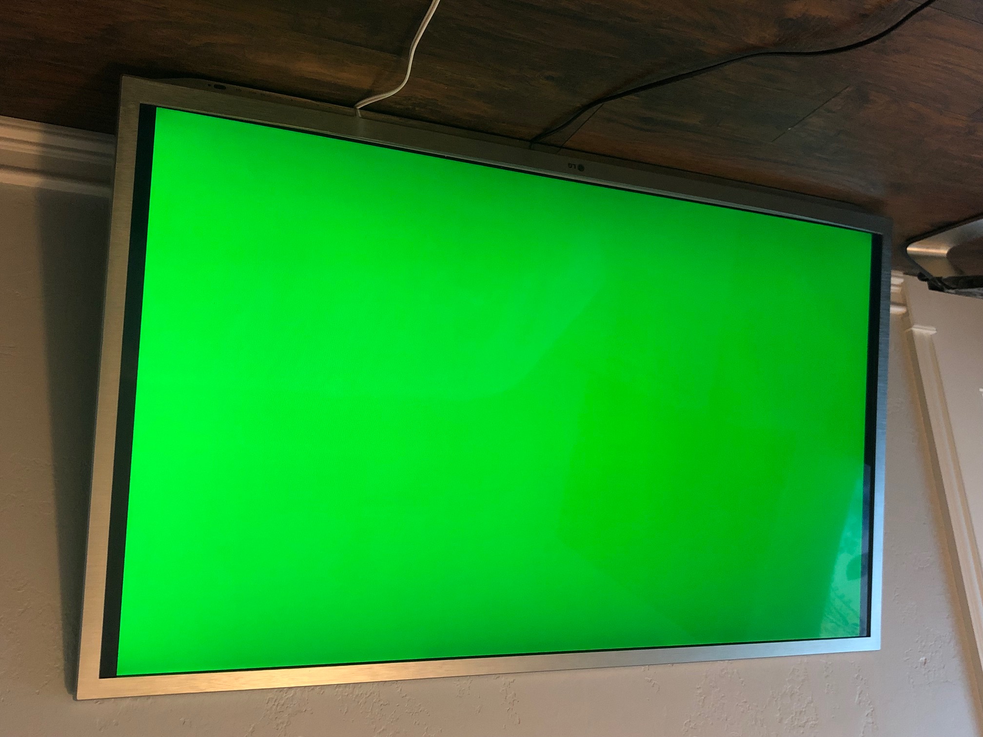

    Trying to get my parent's TV fixed. It boots up to a completely green screen with a one-inch vertical black band on each side. Then it will show a very distorted picture and the pixels will shift horizontally back and forth constantly.
    Here are pictures of the TV
    Every 10 seconds or so, the picture will go black and then pop back to the distorted green.
    I've unplugged each half of the T-Con and results stay the same. Where do I begin to figure if this is a T-Con issue, a main board issue, or simply a failed panel? From what I've read, horizontal lines are usually more failed panel than failed T-Con, but hopefully that is not the case.

      Can we see the screen shot that shows what the image looks like on the screen? Use file attachment function to upload the pictures.
      Attached, I used IMGUR because the attachment uploader flipped all the pics vertically for some reason
      Yes from what they told me, it just started like this one morning.

          Clean your ribbon connectors carefully, can use IPA alcohol, some use a pencil eraser, see if it clears up.

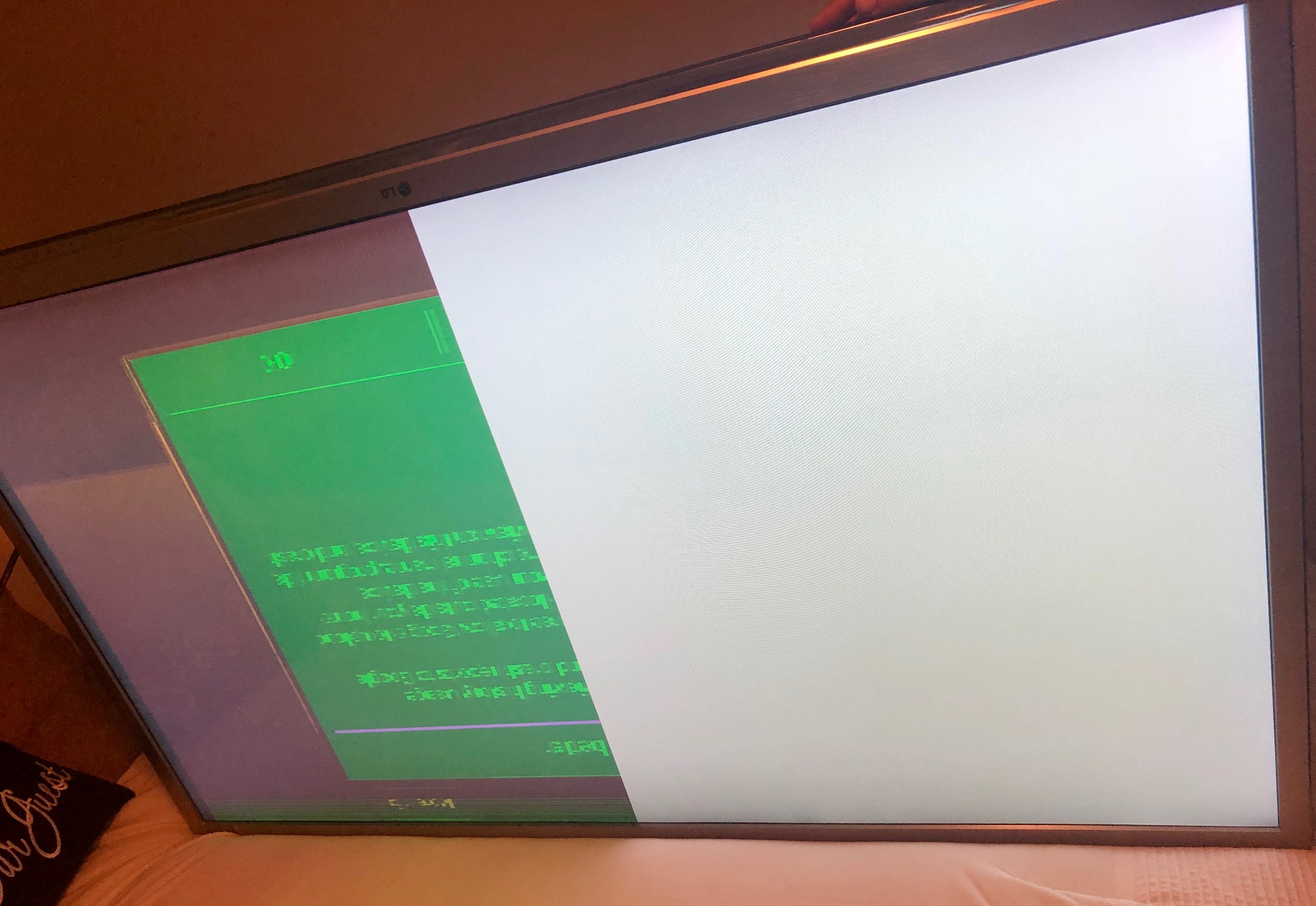

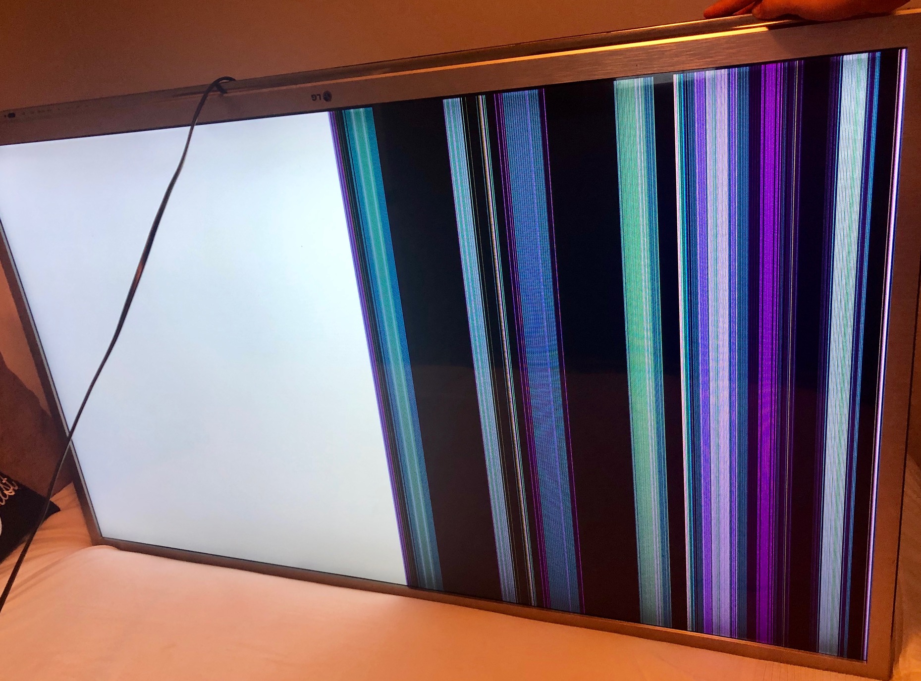

            Attached are pictures with each side of the LVDS unplugged. One side shows the same green/glitchy picture and the other will show vertical lines.

              Re: LG 55G2-UG Distorted Picture w/ Shifting Pixels
              The right side looks like it would be an issue with the T-Con from what I've seen, but I'm not sure why it would change messed up images based on which side was plugged in.

                Maybe also try cleaning the lvds cable end going to tcon. It does look like several displays I've seen with bad tcon, think I would try a tcon if not too expensive, there's usually test points on the tcon but it can be a little complicated if they are not clearly marked. Sometimes you can detect a panel defect by testing the little capacitors on the tcon for shorts, one easy way is set meter to diode put probe at each end of capacitor if it beeps it's shorted, that's if your meter has beep function. Can also test in ohm mode 000 is shorted. Diode and ohm mode checking is ALWAYS done with tv UNPLUGGED from power, can check by touching probes together and see if it beeps, then unplug ribbon connectors going to panel and see if it still reads short.

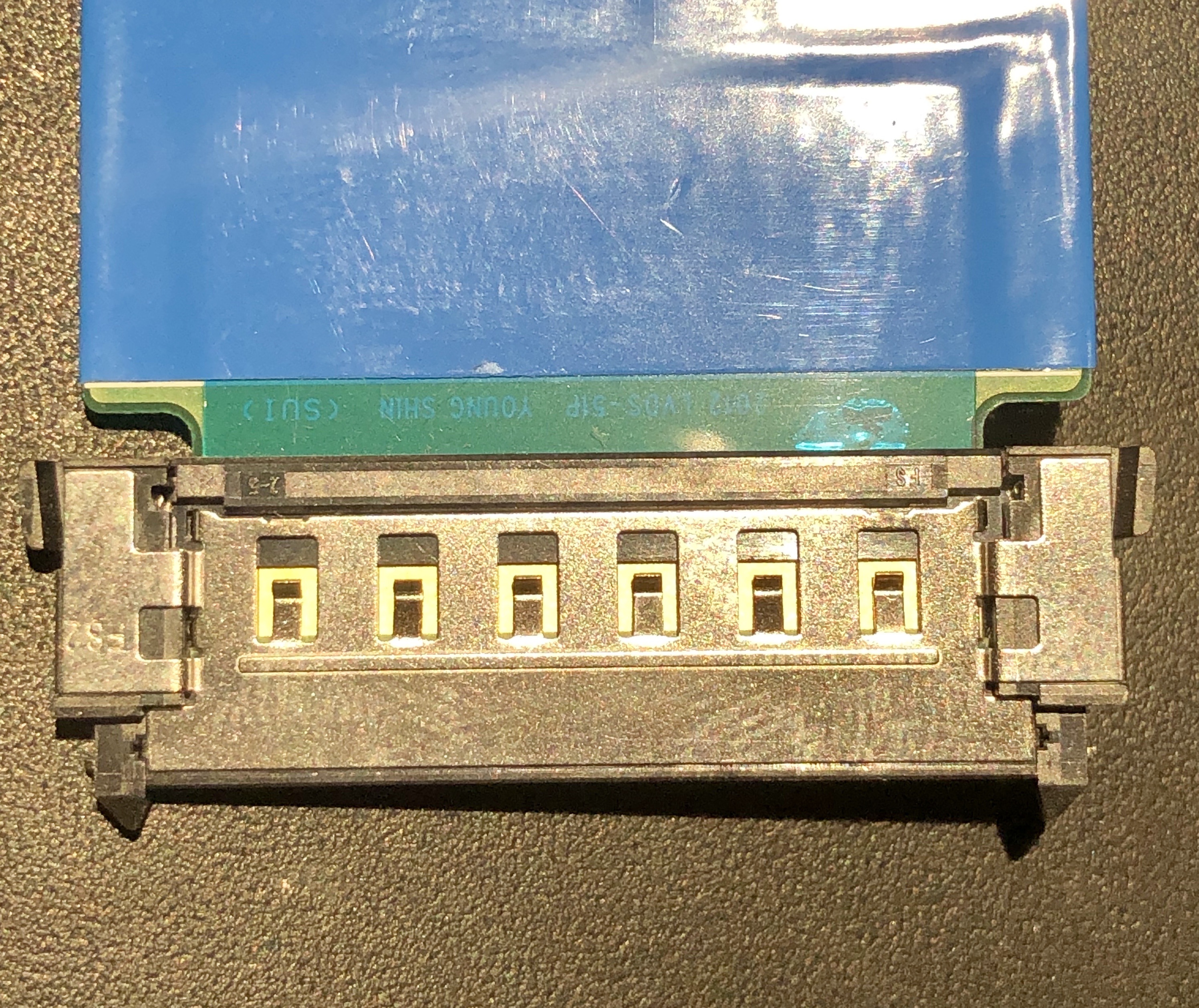

                      It looks like there is a small blemish/bubble thing in the cable running from the T-Con to the Main Board. I'm assuming that I can't remove the cable from the connector to try cleaning the top side.

                          In_STOP only via IR or android apk with mobile had IR or DIY with wave file.. all listed on this forum.
                          BTW. don't play with LVDS to take the cable out from it socket.. you will lost.

                            I do see the bubble, maybe you just need a new lvds cable, lots of times when you have a green screen it has to do with a bad/dirty connection, you may have found the problem. It's probably made right on there, taking it apart will most likely destroy it, grab a replacement if you can find one.
