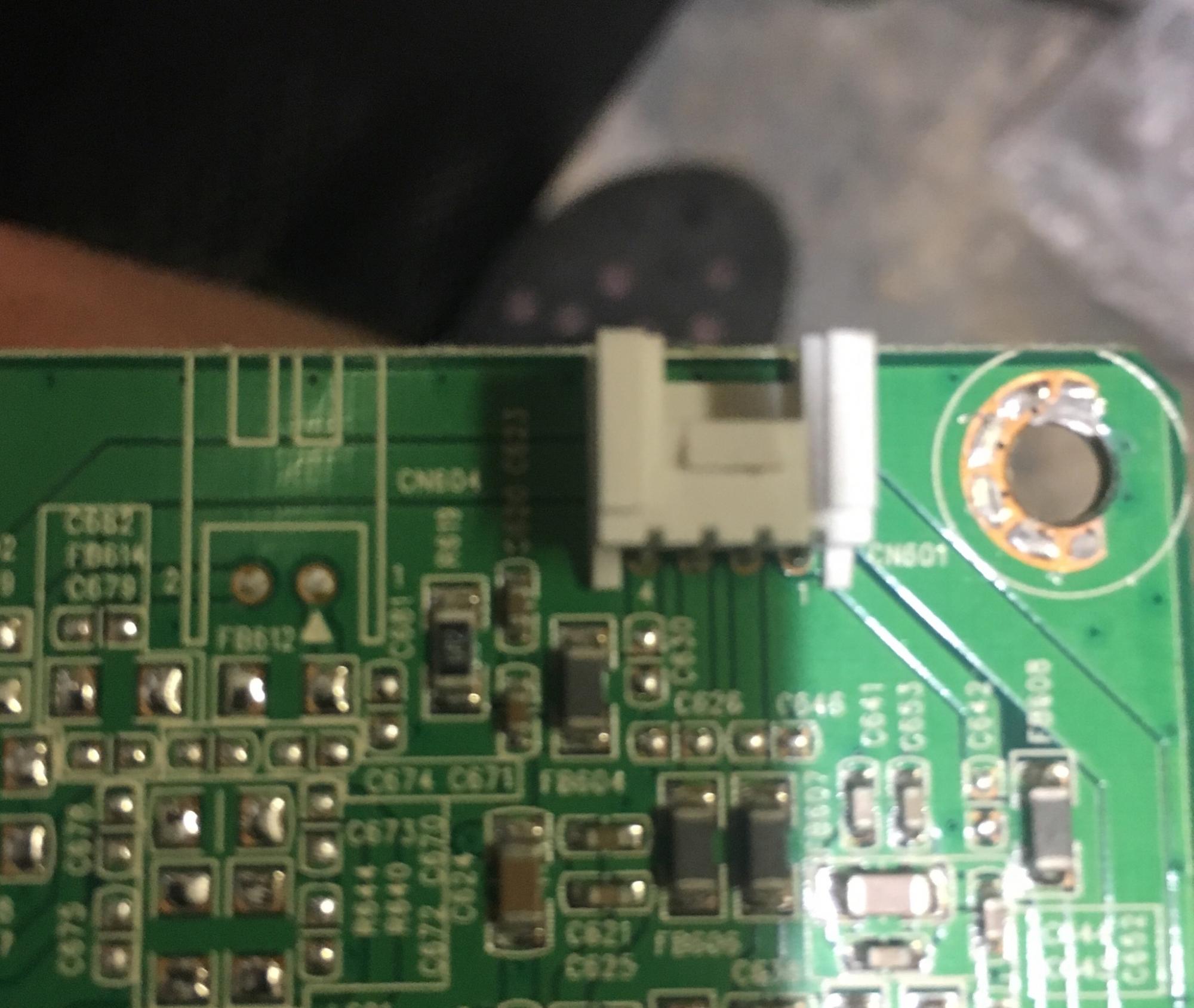

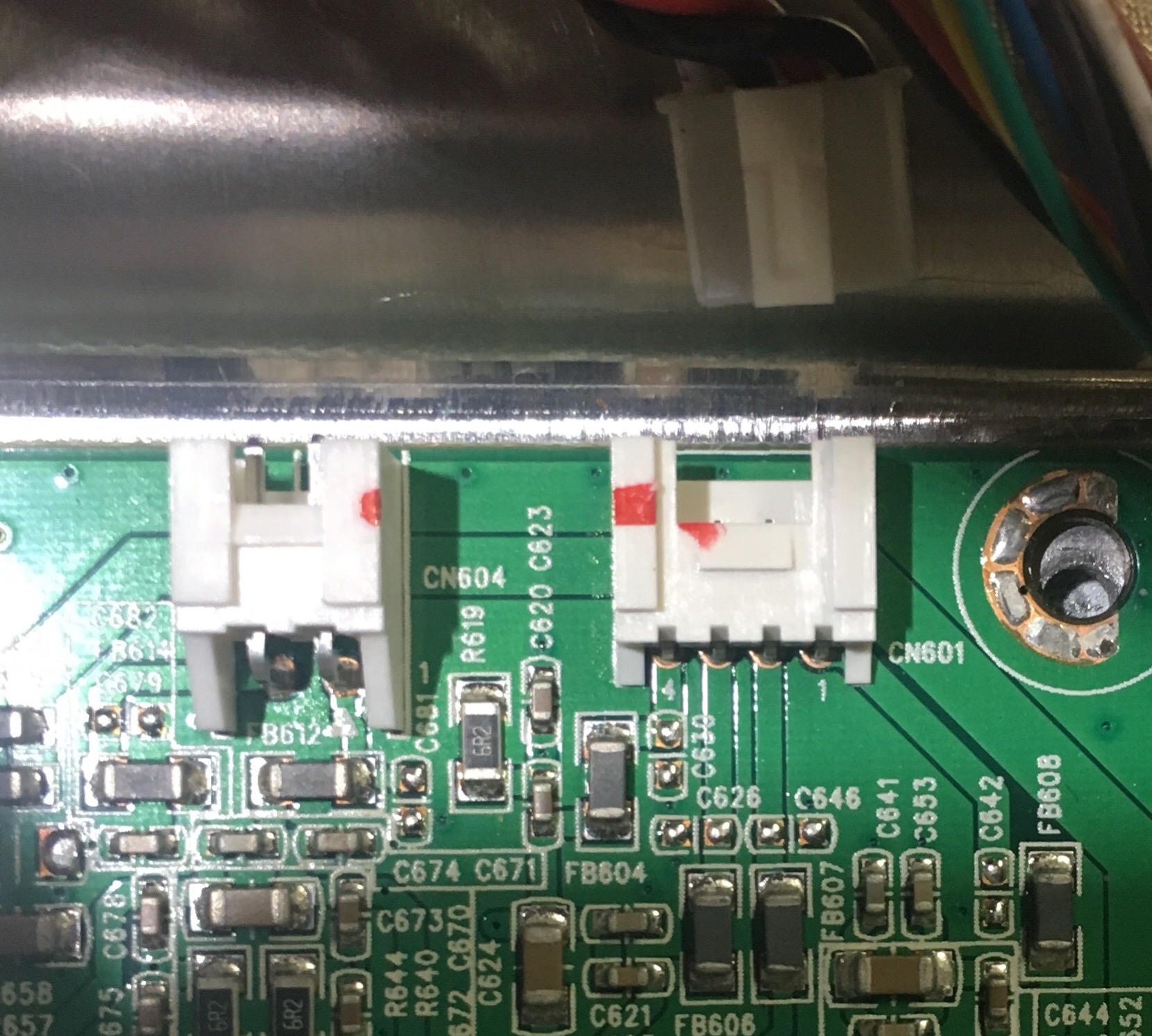

    I have a replacement main board for my Vizio M3D460SR. The only difference is that the new board has an additional connector. CN604 right beside CN601 both board numbers have the exact part number. Is this a later revision for Bluetooth and will it be ok to use. All other connections are the Same. I am including photos of the new and old board.

    Did you match the PCB assembly P/N as printed on the barcode sticker?
    Same blank P[CB can be stuffed to make the PCBA for many TV model.
    The EEPROM for the replacement board may not be made for your TV chassis that you have. You can take a chance trying to use it and hope for nothing to get damaged, or order the correct PCBA for your model.

      Yes I even took a picture of it and sent the guy I bought it from just to make sure it worked
      The board I received had the extra connector but part of the sticker is missing. I bought it off eBay and am contacting the guy now to see if he will exchange it. I hope he does. The original problem is the typical Vizio intermittent on / off problems. He has a good rating so hopefully he will.

        Hmm, shopjimmy shows the connector that is missing on your board:
        https://www.shopjimmy.com/vizio-cbpf...r-m3d460sr.htm
        Does your TV have:
        Panel Sticker Number: T460HB01 V.1
        Panel Manufacturer: AU Optronics

          Looks like there's a difference in the sticker numbers, think yours is TXBCB02K012, the replacement with cn604 is TXBCB2K012, your number has an extra 0, don't know if they are compatible.

            My first thought is maybe the extra connector has to do with 3d sets, is yours 3d?

                Got the tv fixed. The eBay seller exchanged the board for the correct main board. He said the extra connector was for surround sound. Got the replacement board today and it works like a charm. The original problem was intermittent turn on/off and freezing up. It is a 3D set and my friend that gave it to me said he paid over $1000.00 for it.
