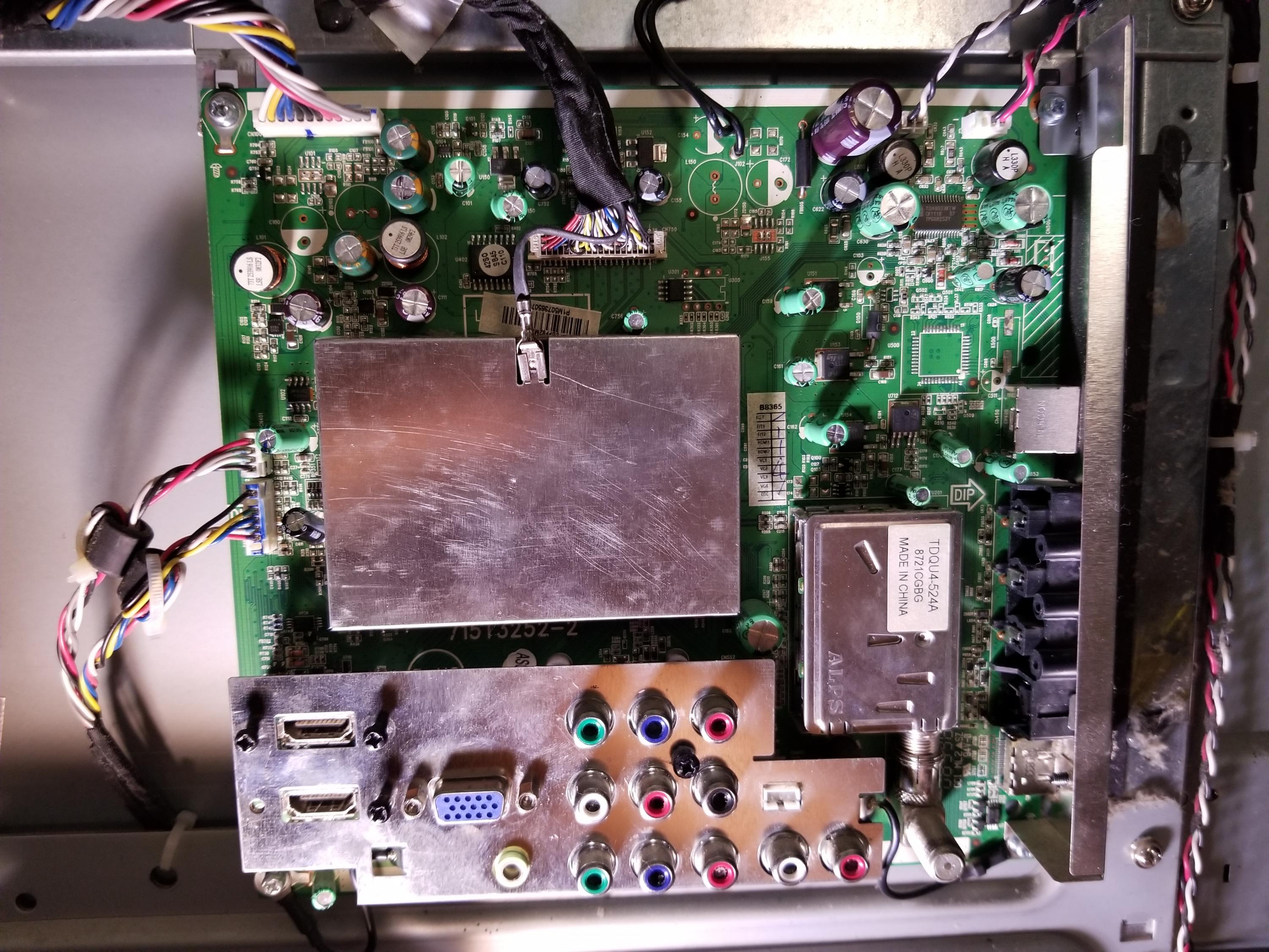

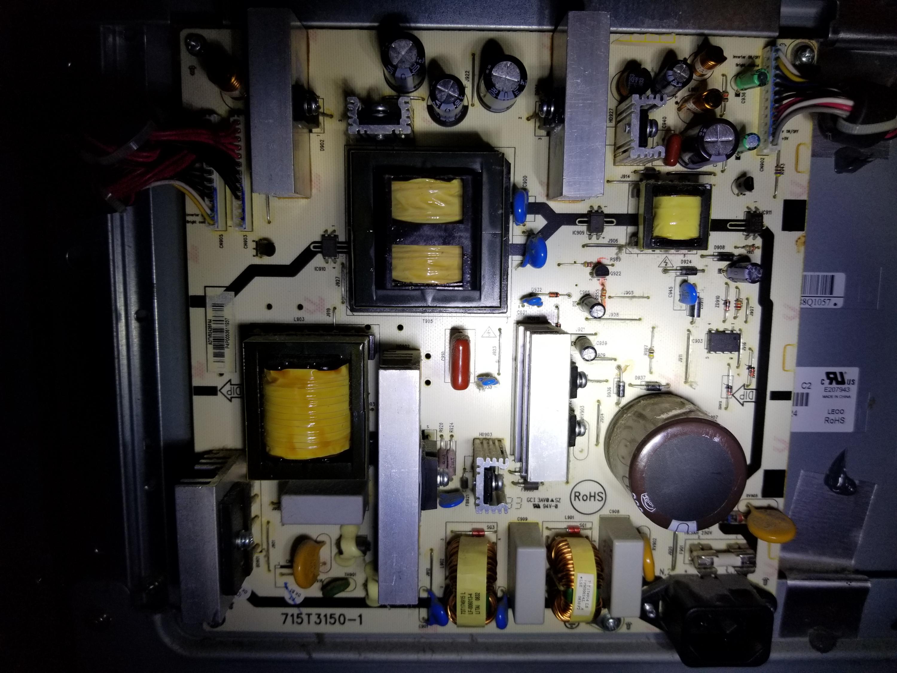

    I replaced all but the large 450V capacitor on the PSU board (excluding the turquoise ones) and all but two of the green 470uf 16v CapXon capacitors on the control board (again, excluding the turquoise components). Are the turquoise components capacitors as well? Neither of the capacitors I replaced was bulged or leaking, although the ones removed were tested using the continuity function on a multimeter and a few of them didn't conduct. The two remaining green CapXon caps are warm when the power button is pressed following a red standby light, along with the majority of the ones I replaced, so it seems as if they still conduct fine.

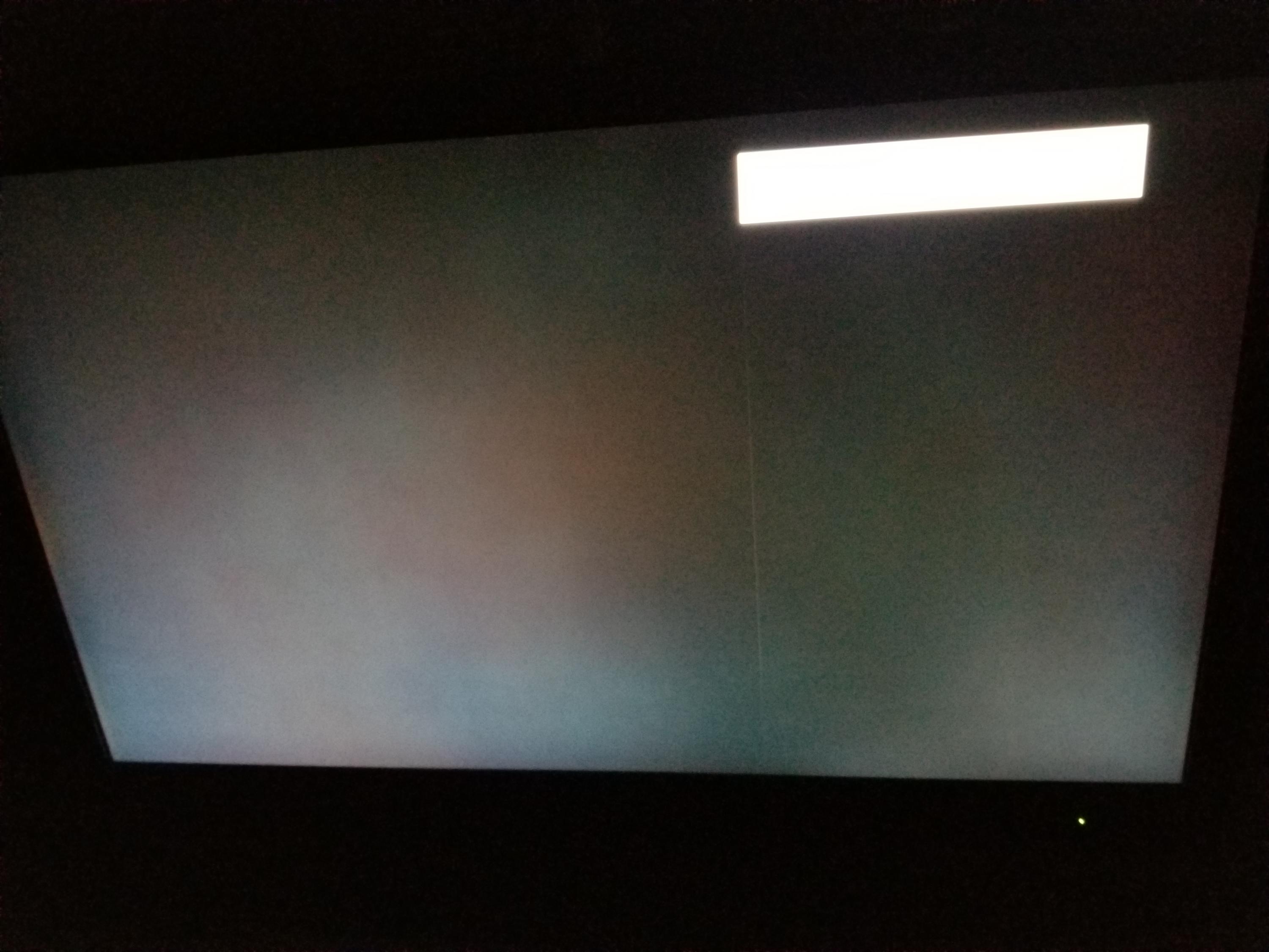

    Attached are pictures of both boards and a picture of the screen when the unit does decide to power up. That photo does the screen no justice, but the picture is much clearer after replacing the capacitors I did.

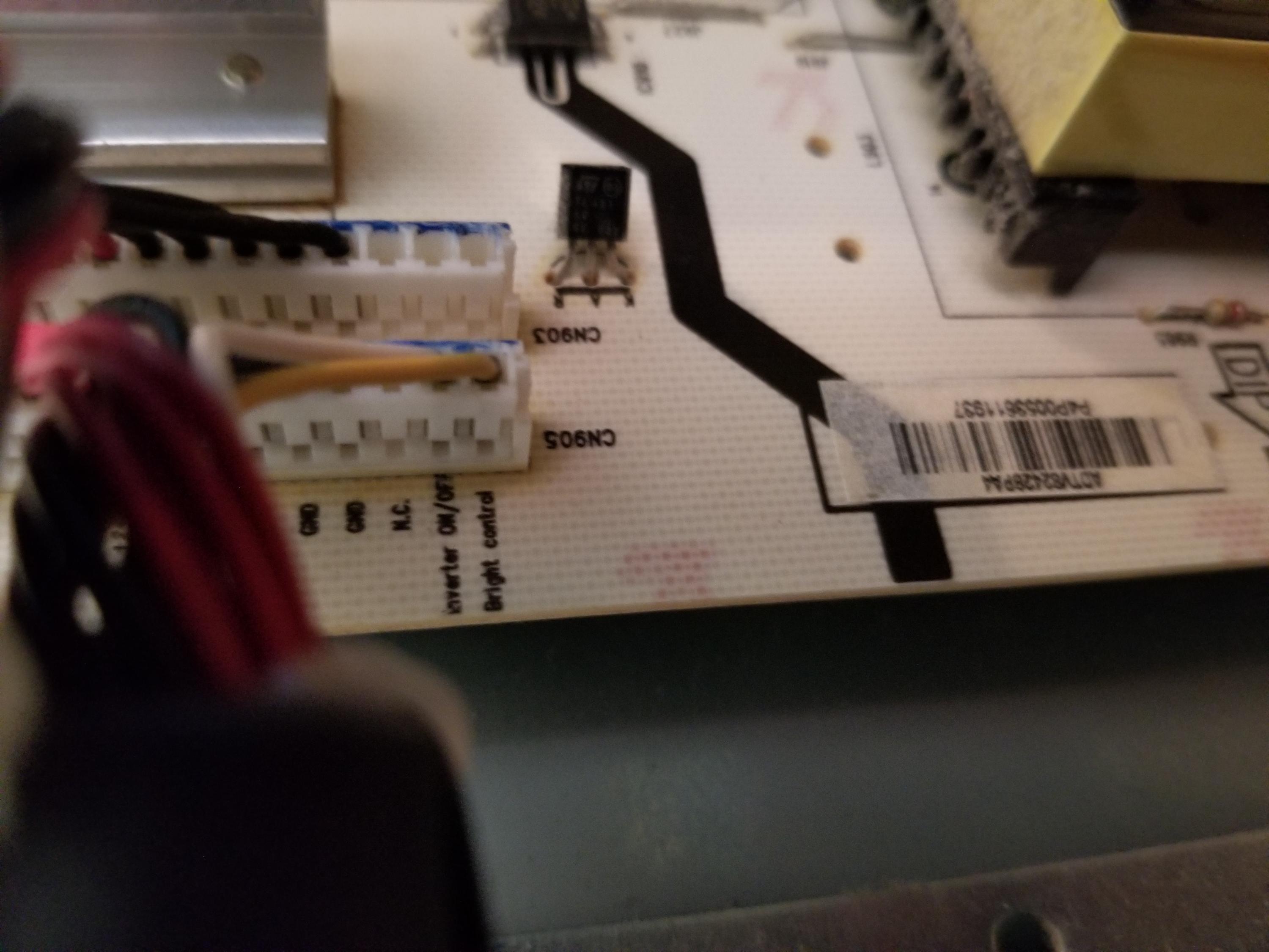

        OK, the set eventually came on, but I was out of the house when that happened. Did catch it in standby mode though. The only two leads reading something while the set is in standby are the "inverter on/off" and "bright control". With the multimeter set to the 20V setting, "inverter on/off" reads 0.14 while "bright control" reads 0.12. Could be possible that I wasn't making a good connection with the other leads, but I did them all the same way, so that shouldn't be an issue.

          Finally caught the set while it was on and tested the leads on CN 902. Inverter on/off and bright control both read 3.6V. The two 12V leads did read 12V. The two 24V leads did read 24V. Nothing read on any of the grounds. Power on/off read 1.6V, and 5V on the bottom 5V lead. I will allow the set to go into standby and test these leads then, as I mistakenly tested CN 905 the first time in standby.

            Re: Sharp LC-42SB45U Powers on at Random Intervals after Cap replacement
            The one voltage that always needs to be there is standby 5 volts, (CN902, pins 11,12) if it is missing, nothing else works
            You can easily check it on R943 (the lead near cn902)
              Originally posted by pilotguy251
              The only two leads reading something while the set is in standby are the "inverter on/off" and "bright control"...
              If there is no voltage around +5V on the STANDBY pin, then you aren't powering the necessary standby components, like the side controls and the IR receiver. Concentrate your efforts on the standby area of the PS. Double check your work there.
              Of the three transformers on your PS, the STANDBY XFORMR is the smallest one.
                  Kind of seems like a mainboard issue, possibly eeprom? Mainboard there for 37 bucks, if you get it make sure you triple check to make sure it's a match: https://www.ebay.com/itm/SHARP-Main-...0AAOSw-otdDHNb
                      Maybe try freezing eeprom U708 with freeze spray or upside down duster, can also try some heat on it, see if tv acts any differently.
