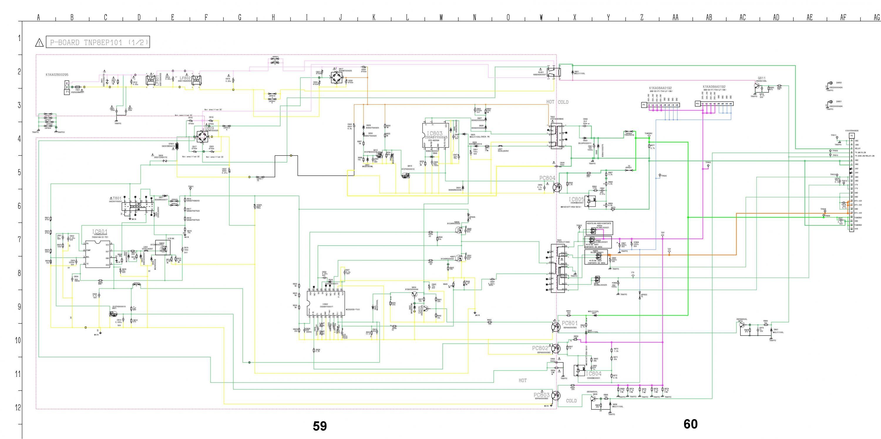

    a long time ago I replaced the PSU of a TX-L42 series LCD Tv. Now I have the bad PSU and I want to repair it, but have no luck so far.
    I attach the schematic and the part where only the power supply unit is visible.
    I have spent many hours figuring out, why mine won't start, but so far I have no answer. All the time I was looking at IC803 (A6259H) and its surroundings, but found no faulty component. Only thing I can't test is the transformer (T802) but I don't think it is faulty. I have ordered 2 replacement ICs for IC803, but when I wanted to start the circuit with the new one, it made the same nothing as the one before. So I would say that IC is fine. I measured every resistor, every diode, nothing seems off. I may be overlooking something obvious, but I can't put my finger on it.
    Only strange thing is the Vcc line (PIN 5) of this IC. When I connect the mains, it slowly ramps up (in about 3 seconds) to 9.5V, and stays there. This IC needs around 15V to start, and as I read the datasheet, it should produce this startup voltage itself.
    Cheers, Janos

    Re: Panasonic TNP8EP101 - no standby
    The ic will produce a small startup voltage with the internal startup cell, once the ic pulses, the transformer t802 will produce the run voltage, so check l807, r851, D826 and C851
        Get the datasheet for the ic. It is not a theory. The ic internally takes voltage from (7,8 D) and supplies vcc at about 1.1ma. to start the ic. The ic will start which should cause a voltage to be developed in the secondaries (only for a few pulses) this will should be enough to induce about 15~20volts High frequency a/c across pins 1&2 of T802.
        Check that R838 is good, if IC803 was bad, shorted, it is very likely the resistor opened up. You need to disconnect one end to check it because sometimes D844 can short and it will look like the resistor is good.
        Check that there is no short across D822 or D846, if there are no shorts, check if there is any voltage at all on C861
            Are you getting any voltage at all on the secondary side on D822, even a volt or two?
            If the ic is trying to start it should produce something.
            The other thing could be causing the problem is that Q810 and Q813 circuits are preventing the ic from starting, What is the voltage on pin 4 of the ic?
            I believe for the circuit to work, Q810 should be turned on, which would turn off Q813 allowing the feedback voltage to control the ic, If Q810 off, Q813 will be turned on effectively grounding pin 4
              No, I have nothing, not even a tenth of a volt. I used my oscilloscope to see if my multimeter is too slow for this measurement.
                What about the voltage on pin 4?
                if there is nothing at all on the secondary the ic is being held in the off state so it does not try and start, not even one pulse.
                  Update on the case (also, good news everyone)!
                  I found the bad part. The little bastard (disguised as D825) was measured 30K Ohms in one direction, 68K Ohms in the other direction. As I changed nearly every single diode and resistor in the standby part, I also removed D826 (better be safe than sorry) and soldered a good-looking 1A schottky there.
                  And now I have standby (5.7V). Thank you again R_J, you helped a lot (again).
                      Used this thread today after so many years
                      In my case for no standby voltage 0v, Pin 5 IC 803 12v. Found 1MR R887 Open circuit.
                      Pin 4 was 0v. With main board disconnected and supply on, Pin 4 rose to 0.35v when tv in standby. Pin 5 supply rose to 18v.
