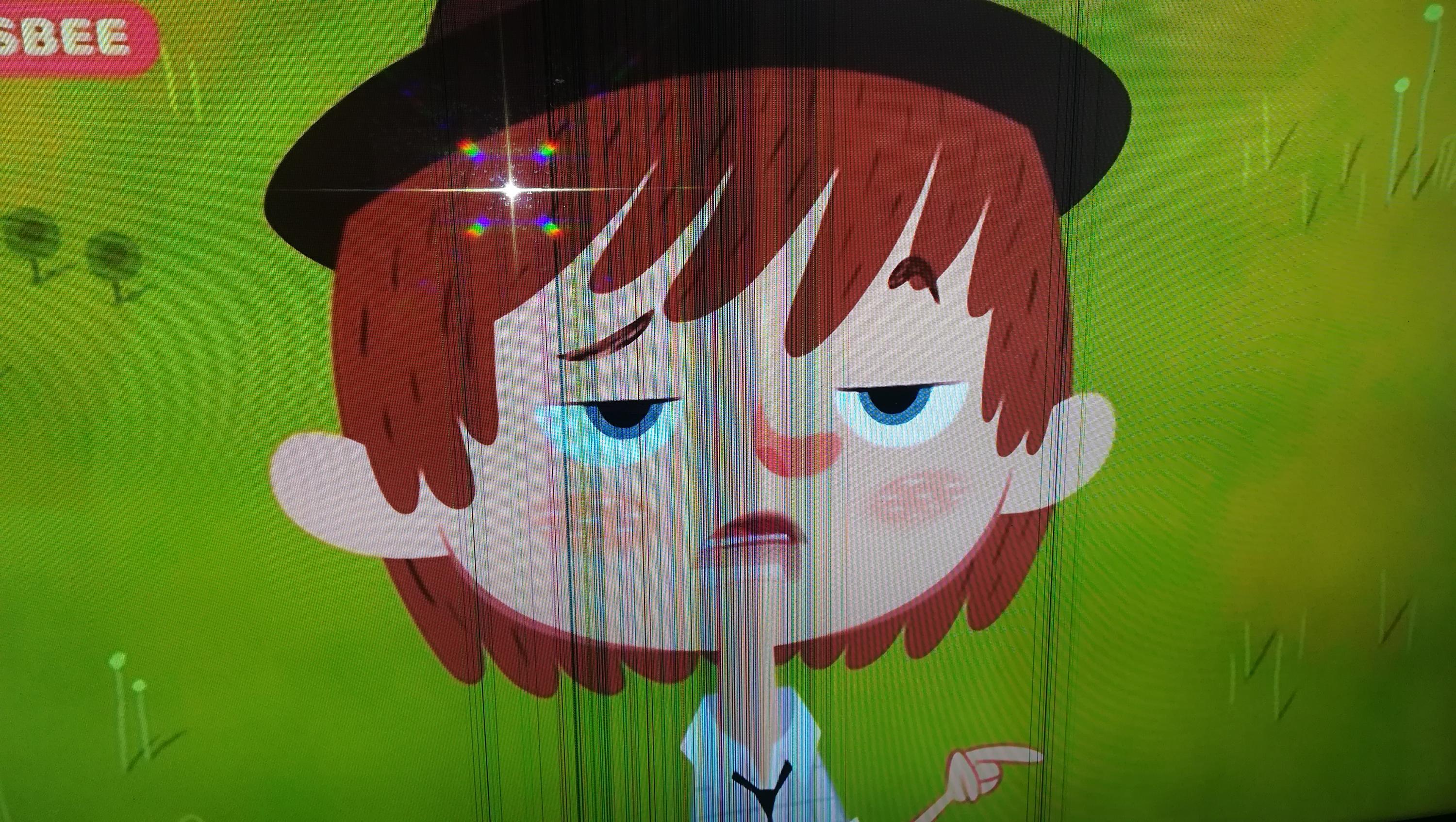

    tv led samsung UE46F8000SZ vertical lines
    Hi everyone, this TV has vertical lines, I tried to touch the flat on the panel and on the t-con but it doesn't change anything, do you think it is a panel problem and therefore not repairable or the defective t-con? I attach photo of the defect
    Re: tv led samsung UE46F8000SZ vertical lines
    What is the history of the TV? The problem just started by itself?
      What is the label on the panel?
      Inspect the bottom of the panel. Traces of oxidation remain if it is washed with liquid. 50% of the chances are to fix it with a alcohol, microscope or magnifying glass.
        Clean and reseat tcon ribbon connectors with ISA, make sure the tcon lvds cable is clean and not loose, as good a starting point as any.
          I don't know, they didn't know how to explain how the defect started
            the display model is: samsung CY-KF460DSLV1H
            What kind of alcool is used for these cases?
            I've seen videos where they replace the flat between t-con and display, how are they electrically connected and which glue is used?
              Isopropyl or "rubbing alcohol " . Do not use Johnny Walker, (ha,ha.).
                what is ISA?
                  Isopropyl alcohol.
