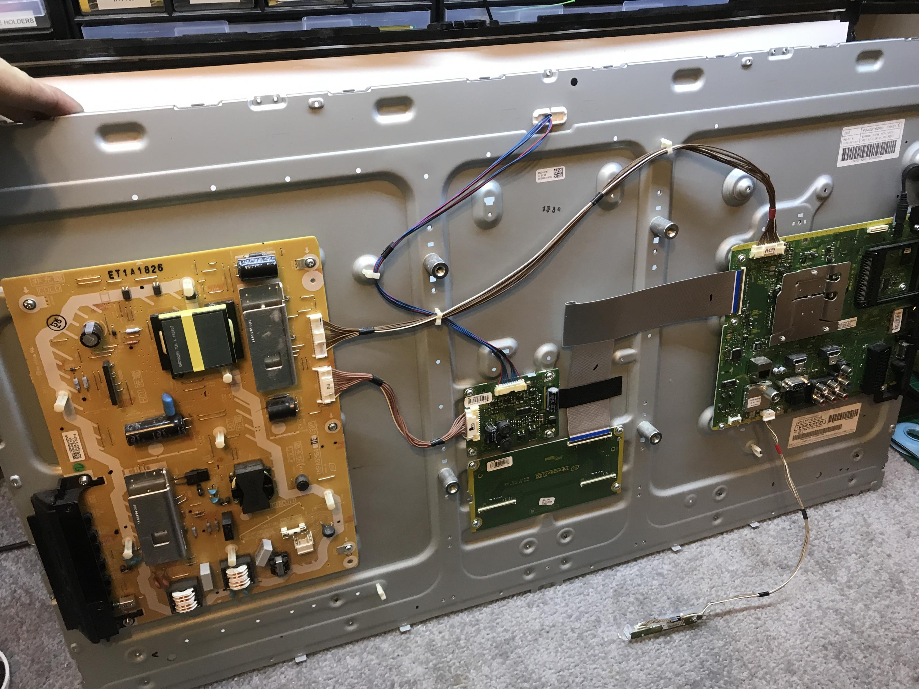

    Hello everyone.
    So I have this Panasonic TX-L37E3B which when switched on, the green LED flashes rapidly for 2 or 3 seconds, then stays on. No picture and no backlight at all. I can't determine if there's any sound.

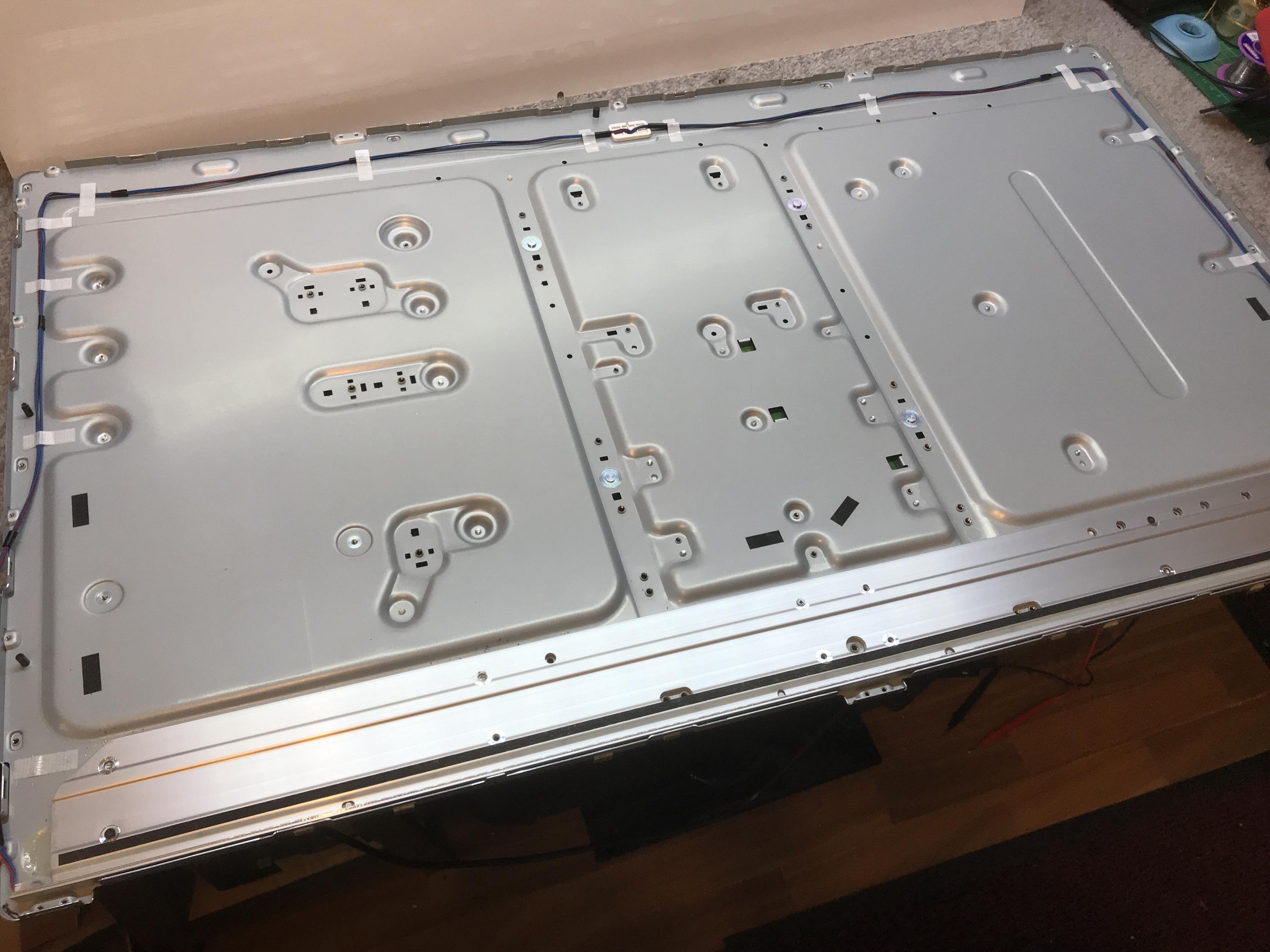

    I immediately thought it will be a bad backlight LED so stripped the screen down, but the backlight strip is not like the Vestel ones I'm used to. It's on one aluminium strip at the bottom of the screen. I have a backlight tester but the strip seems more complicated, with 3 wires connecting at each side. I've tested each individual LED and they all work. While the TV is switched on there is zero voltage at the strips however. I cannot test voltage at the exact moment of switch on (I need an extra pair of hands!)
    Does anyone have experience of this model or this fault?

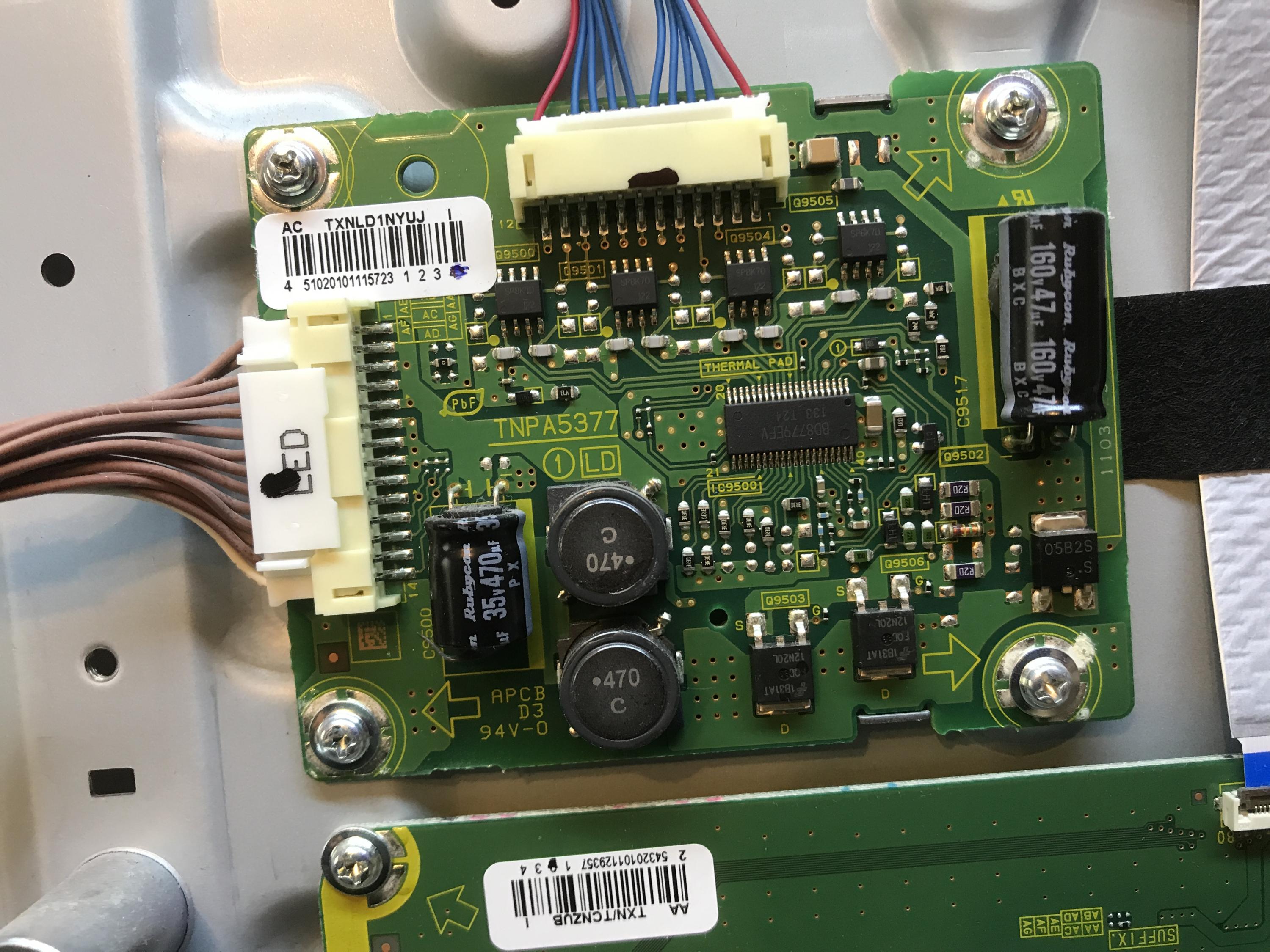

      Thank you, do you mean the sockets on the LED strip?

          You have 4 strings of LED's, One red wire for 4 blue wires for 4 LED strings, same for another set, so the test each string you will remove the connector from the LED driver board then put red probe on red wire and Black probe on each blue wire of the LED set, the do the same for the second set of the LED's.

            I've resoldered the plugs on the LED strip Diah but still the same problem unfortunately.
            Budm, thank you for the info. Using the backlight tester, all 4 strings of LEDs operate correctly with no fault shown. It looks as if my fault lies further back possibly? I'll try and rig something up so that I can monitor the backlight voltage at switch-on.
              Re: Panasonic TX-L37E3B Green light but nothing else..
              You have two set of 4-String, so 8 LED strings total.

                Yes sorry Budm, I meant 4 strings each side. I've just managed to get back to this TV and the first thing I did was test for voltage on the LED plug at switch on and there is none at all, with the plug in or out there are zero volts. I wish I tried that before stripping the screen down lol, lesson learnt.

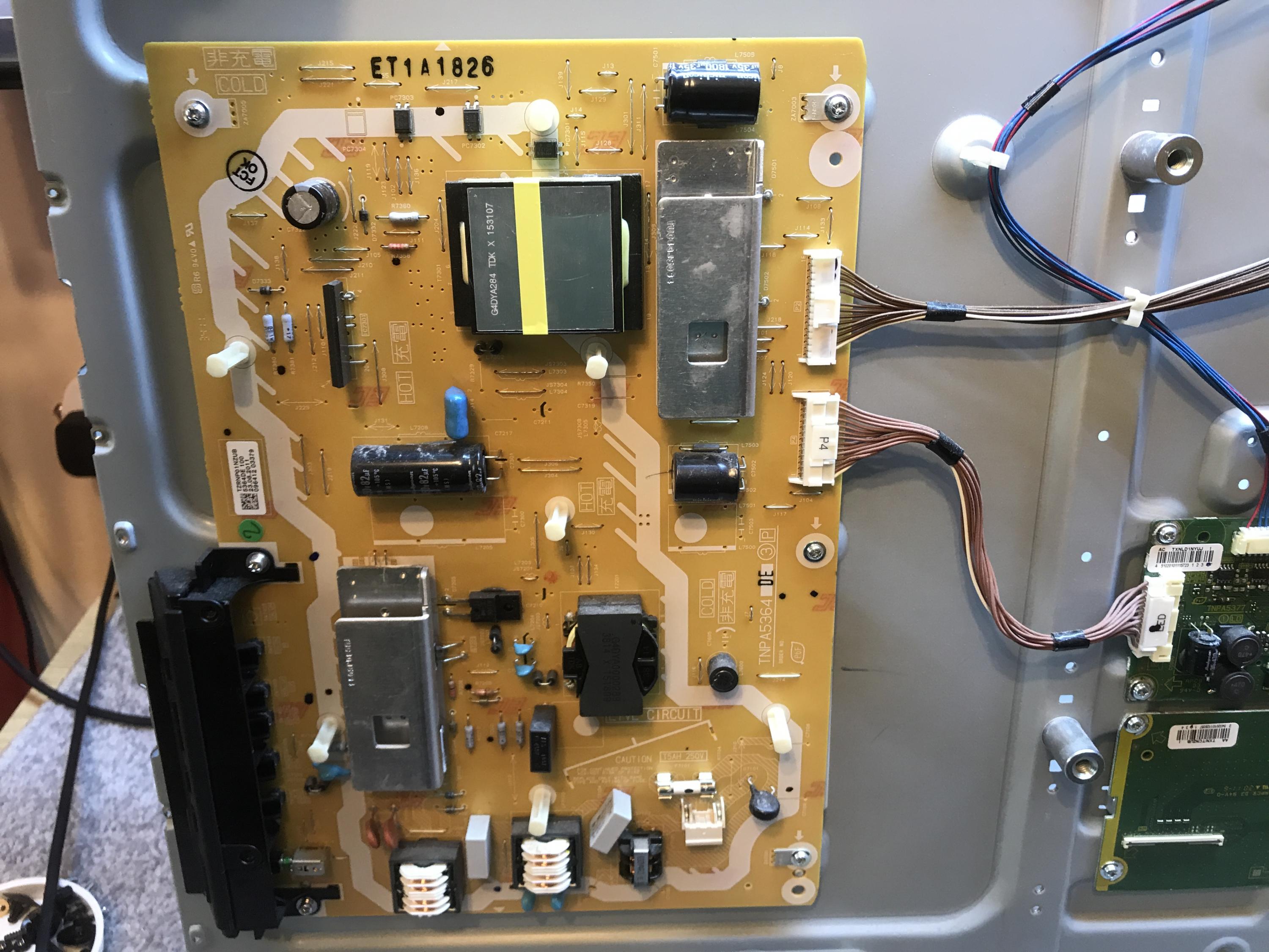

                Checking around on the small LED driver board it does have a 24v supply, not sure what other voltages should be there though. One electrolytic cap has a voltage rating of 160v but this remains at a steady 24v across it when switching on so clearly somewthing amiss.
                These LED driver boards are really cheap on ebay so I might buy one, but would prefer to get the fault to component level if possible?
                  https://www.badcaps.net/forum/attach...3&d=1560434141
                  The 24V is the feeding Voltage to the boost converter circuits (you can see the two inductor 470C printed on top and associate MOSFET's and that LED driver IC. The output should be over 100V when BL-ON signal is present.
