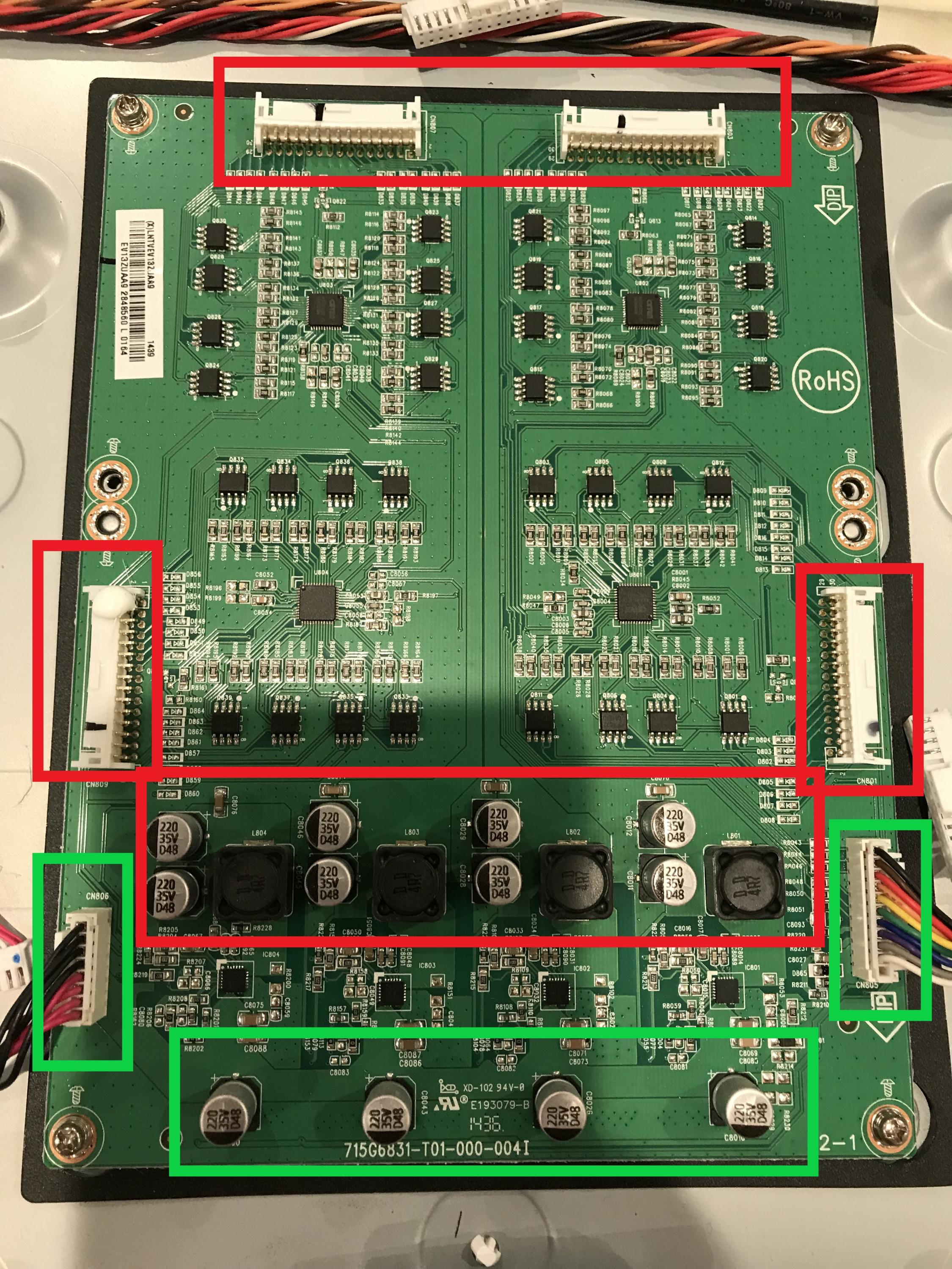

    My Vizio P502UI-B1 TV has no backlight and from what I can tell no image. The TV power indicator turns on for a few minutes then begins flashing for about 30 seconds then turns off. I've tested Power board and that looks good. Even changes the eeprom, but that didnt help. One thing I noticed is that the LED driver board has no power going to the LED plugs. In my image, I can see there is power on the green connection/capacitors but I get no power on the red connections/capacitors. Is it safe to say that the led driver board is bad? Anything else I can check before ordering a new board?

      You need to check if you are getting PS-ON and BL-ON signals from the main board and if all your voltages are good.

        Check if you get +5 volts on CN805 pin 9 of the driver board, all the other pins on cn805 are clock/data lines
        Do you get any voltage on L801,2,3 or 4 when the tv is first turned on, that should be the boosted led voltage.

          I don't see anything labelled BL-ON. But I get 2.9V for PS-ON.
          PS-ON = 2.9v
          BL-ON = Don't see anything labelled BL-On
          cn805
          Black - 0
          Brown - 0
          Red - 3.1v
          Orange - 0
          Yellow - 0
          Green - 0
          Blue - 0
          Purple - 4.9v
          Grey - 0.05v (pin 9)
          White - 12.14v
          cn801,2,3,4 = 0v
          It looks like the issue may be with CN805 pin 9 since I'm only getting 0.05v. What should I be testing from here?

            What is cn801,2,3,4 =0v ? Does CN805 pin9 connect to the main board?
            Check the voltage on ZD801 anode and D865 cathode, check if C8027 is shorted?
                cn801,2,3,4 is:
                cn801
                cn802
                cn803
                cn804
                They all have 0v on all pins, so no power is going to the LED's.
                ZD801: 24.3v and 4.3v
                D865: 4.03v and 0.05v
                C8027: Not shorted

                    I had asked if you had any voltage on L801,2,3 or 4.
                    If ic801 is a aoz1268, pin 2 is the enable pin, see if it connects to cn805 pin 9

                      Hi, this model commonly has no backlight symptom. Many people try the eeprom as they are sold on eBay and a lot of them available. We just repaired 3 of these models last week all same symptom and all same fix. Failed bga solder on main board. To fix it properly you will need to reball the bga on the main board. To test the theory you can heat the chip alittle and see if your symptom changes. Hope this helps and saves you from buying unneeded parts.

                          Usually under a heatsink, usually the biggest IC.
