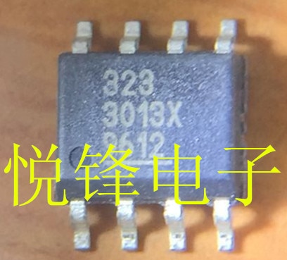

              Hi diif,
              I used same 3v led, 3528 2835 1W. There is an a 8 leg IC close to CNL802, I am wondering if that is a led driver IC?
              https://www.badcaps.net/forum/attach...1&d=1510788361
              • diif
                • Feb 2014
                • 6978
                • England
                Re: Samsung 39 LCD TV no light
                Originally posted by yobbgsm
                Hi diif,
                Some LEDs have the anode and cathode switched around, did you check you have the correct ones ?
                What's the markings on the IC ?
                • yobbgsm
                  • May 2017
                  • 63
                  I tested the LEDs using my backlight tester. All strips / led are good prior to installing. IC appears 421 3013x 8609. That's the marking.
                  • R_J
                    • Jun 2012
                    • 9588
                    The ic's number is 3013X
                    • yobbgsm
                      • May 2017
                      • 63
                      Its a Octal, 8-Bit Voltage Out DAC, not sure if that is related to the LED supply?
                      Thanks.
                      • R_J
                        • Jun 2012
                        • 9588
                        Nope, It is a 3013x, Very similar to a HV9910B or TS19450 LED DRIVER
                        The other numbers are mfg./date codes
