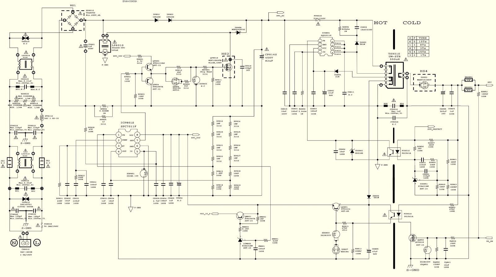

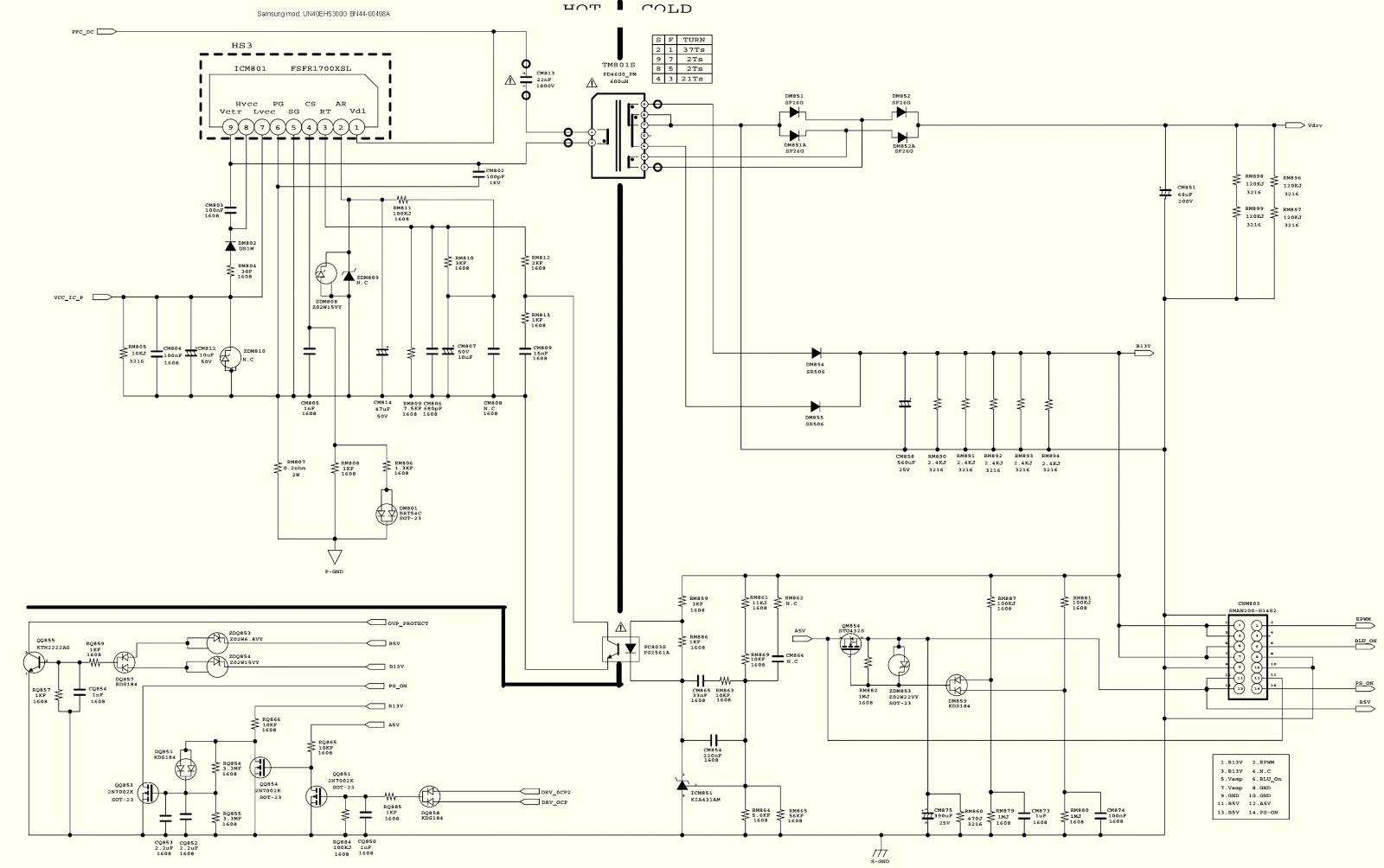

    Just Picked up this UN46EH6000 TV that has a BN44-00498A Power supply, nothing happens when power button is pressed moments later a slight clicking sound can be heard. Back lights will not turn on when unplugging the connector to the other board. I seem to have all the voltages on the hot side. At CM803 I only have 5V on pin 12 and 3v on pin PS_on (other board unplugged). all non surface mount diodes are good, capacitors CM851, C9110, CS855, CM875, CM858 removed and tested good. Someone have an Idea of what could be the cause, do I need to 'activate' PS_on to see other voltages? Is PS_on looking for a ground? or 5v to turn on rest of the board voltages.
    Attached is the schematic to help figure it out, the number is slightly different but seems to be the same from what I can see and is easier to read.

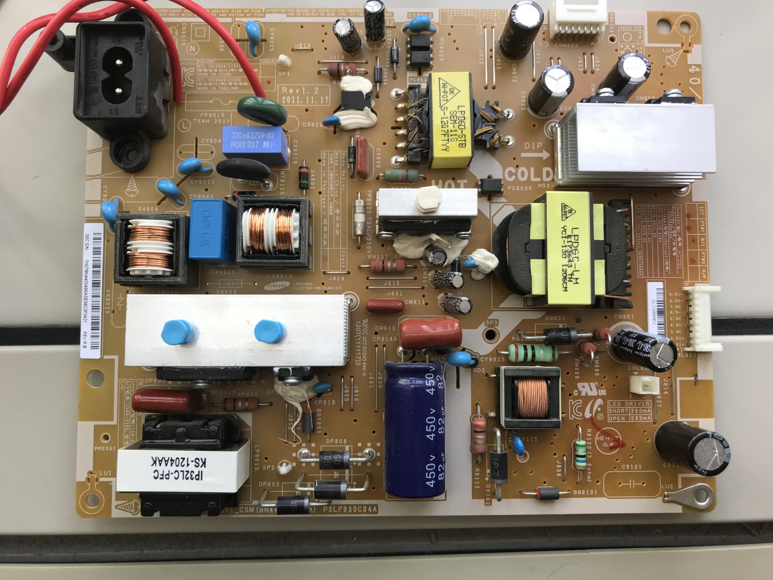

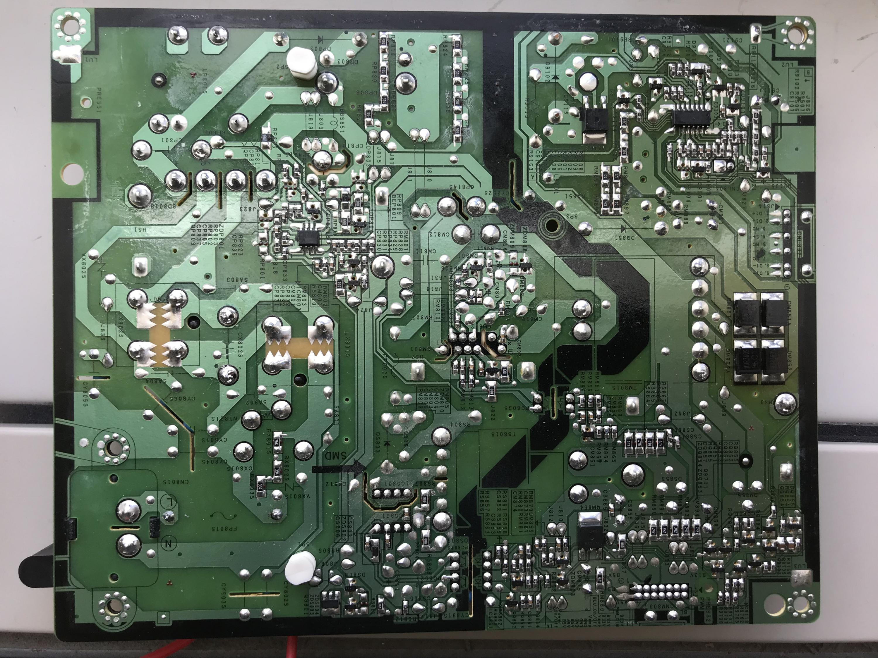

    Lets see good clear pictures of the hwole top and bottom side of the power supply board.
    Since the PS-on is present, then you sjould have about 380 ~ 400V DC between the two legs of the main filter cap in the hot side.
    BTW, your board is BN44-00498A, not BN44-00473A, correct? The schematic you provided is for BN44-00473A.
    We also need to know the Voltages of all other pin of the power supply connector that goes to the main board, measure them without having it connected to the main board, make sure to put down pin names and follow by the voltage reading for each pin so we can easily see what are missing.
    This is your board, right?

            I need to see the pictures of your whole board, top and bottom side.

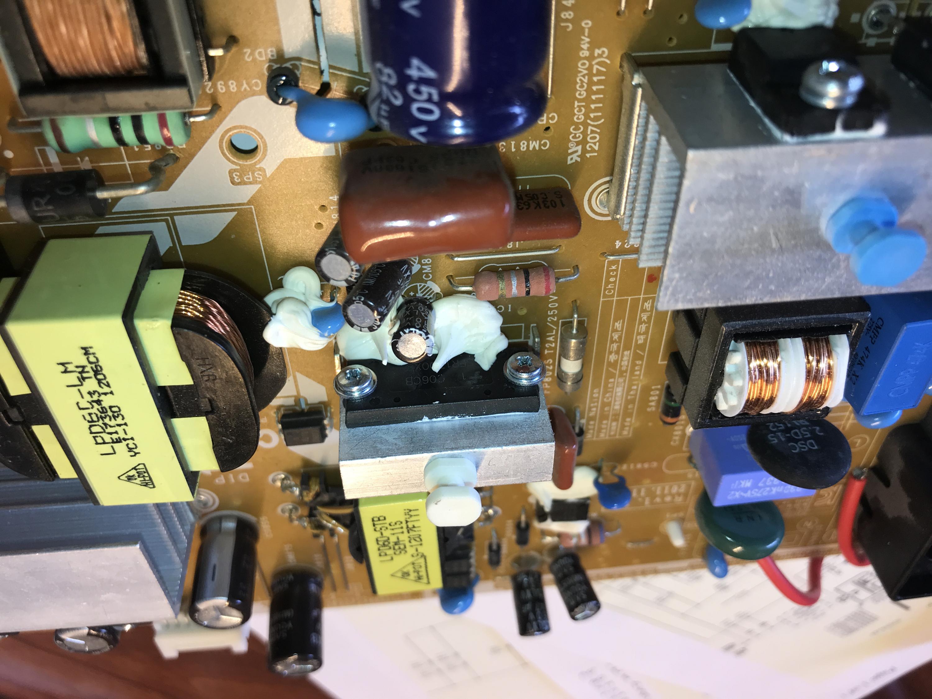

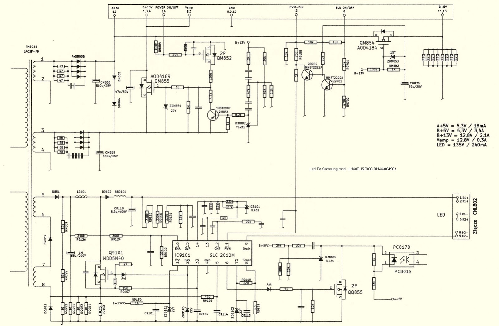

              Attached is the pictures of the board, and the schematic matching the P/N of the Board. Note that the red wires goes to a fuse holder since I don't have a solder on fuse at this time.
              Also note that ALL test are done with circuit board and Back lights disconnected. I am on a business trip and only brought that board with me to pass the time.
              nomoresonys since back light is not connected I assume that if I jump the pins I would expect to see voltage somewhere in the back light connector?

                What is the P/N of that SMPS IC right next to the fuse FP802S? You need to find out if it is getting VCC Vaoltage for it to run or not.
                That is the section you need to check, that section is for the switched B5V, B13V, and power supply for feeding the boost converter for the LED driver circuit.
                No need to poke around the PFC section, the section with part designator with P, I.E. DP8O3, that diode belongs to the PFC section , that is why it has P in the designator. You need to be able to section out the board and know what each section of the board is for, we do not want poke around and may have accident and damage the working section, just concentrate in the B5V, B13V as suggested, since the diagram does not match your board so the result you get may not be correct. Designator with S is for the standby section.

                    See attached picture, is this the IC you are talking about? HS2 with the White plastic piece on top? the number is SFR1700XC.
                    Interestingly on the board that chip is identified as HS2 but in the schematics it is HS3 (confirmed by P/N)

                      HS = Heat sink, the ic location number is under the silicone, Check if you have VCC_IC_P going to the ic, Checking on the bottom is easy but if checking from the top, try and get to CM812 positive leg (in front of ic in silicone)
