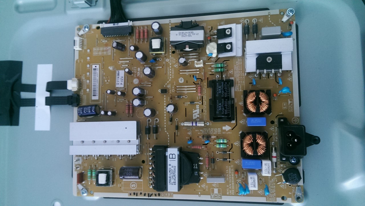

    Hi everbody,
    my LG TV 43UF7709 wont turn on. It only tries to show something, but it stays only blinking. So i removed the Backcover and first checked some Voltages.
    I get on the powersupply all Voltages correctly, equal to the schematics nearby. The only thing i get maybe wrong is "LED+". On the Powersupply there stand it had to be 50V Output. I only get 38V on LED+. Could this be a failure?

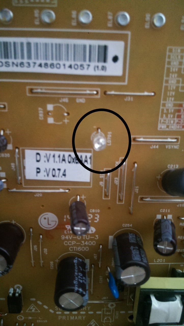

    Also there is a LED, LD701 which blinks 6 times in row YELLOW. What can this mean?
    I also checked Powersupply out of the chassis. I couldn´t find any issues. But have to say, that i´m not a pro.
    I also checked Voltage on TCON Fuse: I get 11,5V on each side.
    What i noticed to is that the heatsink on the mainboard run very hot.
    Would be have, if we can get this TV back to life

    Re: LG 43UF7709 - Blinking Screen, No Picture, No Sound
    Test connector from mainboard to powerboard on powerboard side, test with tv plugged in but off then hit power, report both conditions here, give pin number, pin description and condition on and off.
      Please provide good clear pictures so we can see what we are dealing with.
      You say 'Blinking screen', are you referring to backlights are blinking?

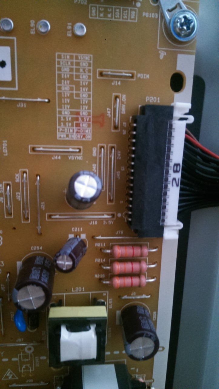

        So, i will List from Top to Bottom (i think top ist Pin1?)
        LEFT ROW, TV PLUGGED BUT OFF
        0V "SIN"
        0V
        0V
        0V
        0V
        0V
        0V
        0V
        0V
        0V
        3,5V
        3,5V
        0V
        0V "PWR_ON"
        RIGHT ROW,
        TV PLUGGED BUT OFF
        0,055V "VSYNC"
        0V
        0V
        0V
        0V
        0V
        0V
        0V
        0V
        0V
        3,5V
        0V
        0V
        0V "DRV_ON"

        I have to say, LD701 is blinking ORANGE not YELLOW^^
          Unplug tv from outlet, unplug cable from powerboard to mainboard, plug tv back in out let, see if backlights come on and stay on.
