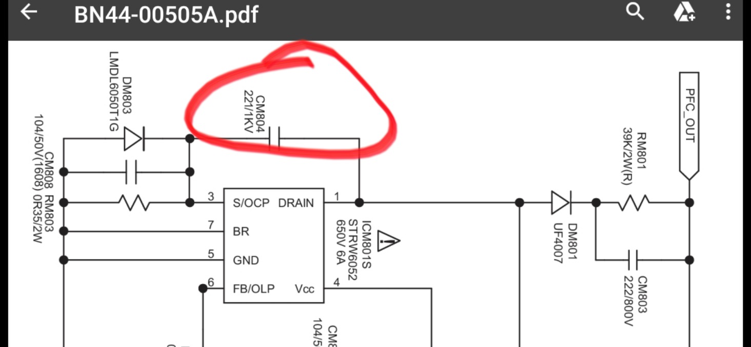

    Hello.
    This board comes in a Samsung that does not turn on. I do not have any tension in the pins and I could see a condesador(CM804) busted near the IC but I do not know what value it has. I guess it will be 1KV but I do not know the capacity and I can not find the scheme.
    Any ideas? Thank you

    Re: Condensate burst on board BN-00506A
    This smps is listed as a substitute for yours.

        • 31090
        is the fet o.k.??
        (pins 1 & 3 shorted out or not)
        if not then your lucky - btw i would upgrade that to 2KV - i'v seen 1KV ceramics fail a lot in some psu's

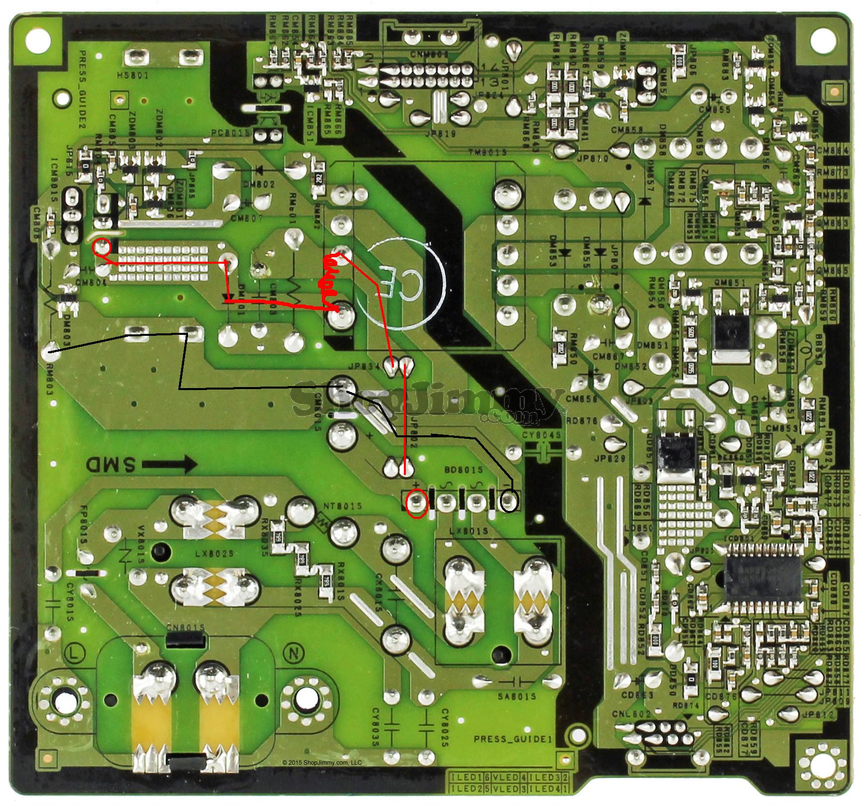

                            Ok, so following the advice of RJ, I have measured the tensions in the TM801s, and I have 0v in the red dots that I painted in the photo. The two pins left in the TM801s give me 300v. The DM803 has been removed and it is fine(red circle), and the RM803 is also fine.
                            In ohms the TM801s is isolated the primary of the secondary and in the primary I get very low resistance between the pins, so I discard it.
                            [IMG][/IMG]
                              Originally posted by Nawual
                              Hello again. I have changed the condenser and checked the FET with pins 1 and 3 and they are not shorted. But I did not have DC in the large filter condenser. Reviewing the hot zone I found the rectifier bridge broken and the protection fuse was open.
                              I have changed them and now I have voltage in the condenser but it does not reach the IC.Suggestions?
                              You said you can NOT get the voltage from the "large filter condenser" to the ic, this is the path of that voltage.
                              Also check RM802 (2R2) resistor
                              Check if you have A5V (5 volts standby) on DM857
