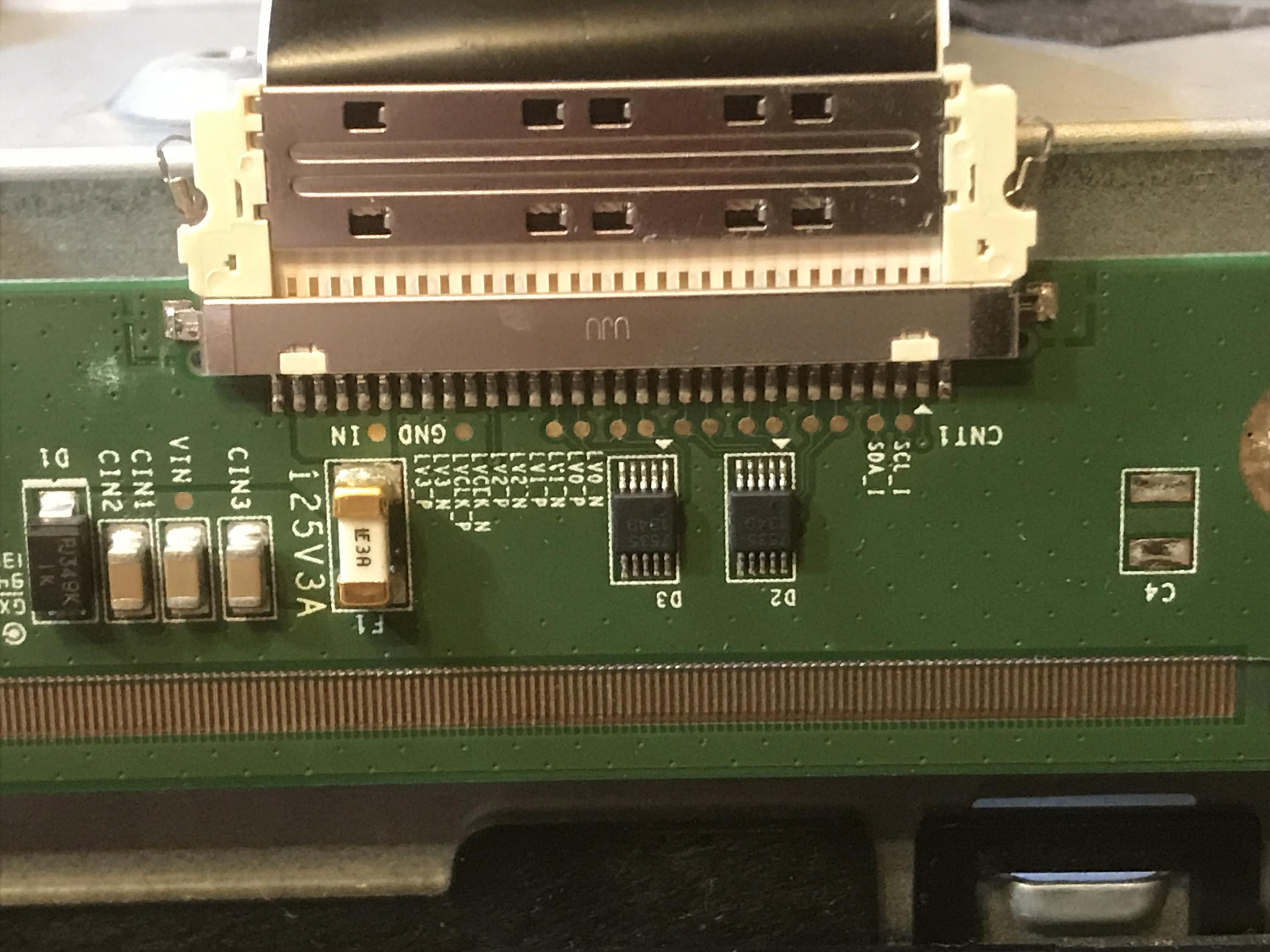

              Can we see the pictures of the T-Con board?
              Does it have two ribbon cables between T-CON and the LCD panel? If it does then try having one ribbon cable connected one at a time to see what you see on the screen.
              • sickboy
                • Jun 2015
                • 86

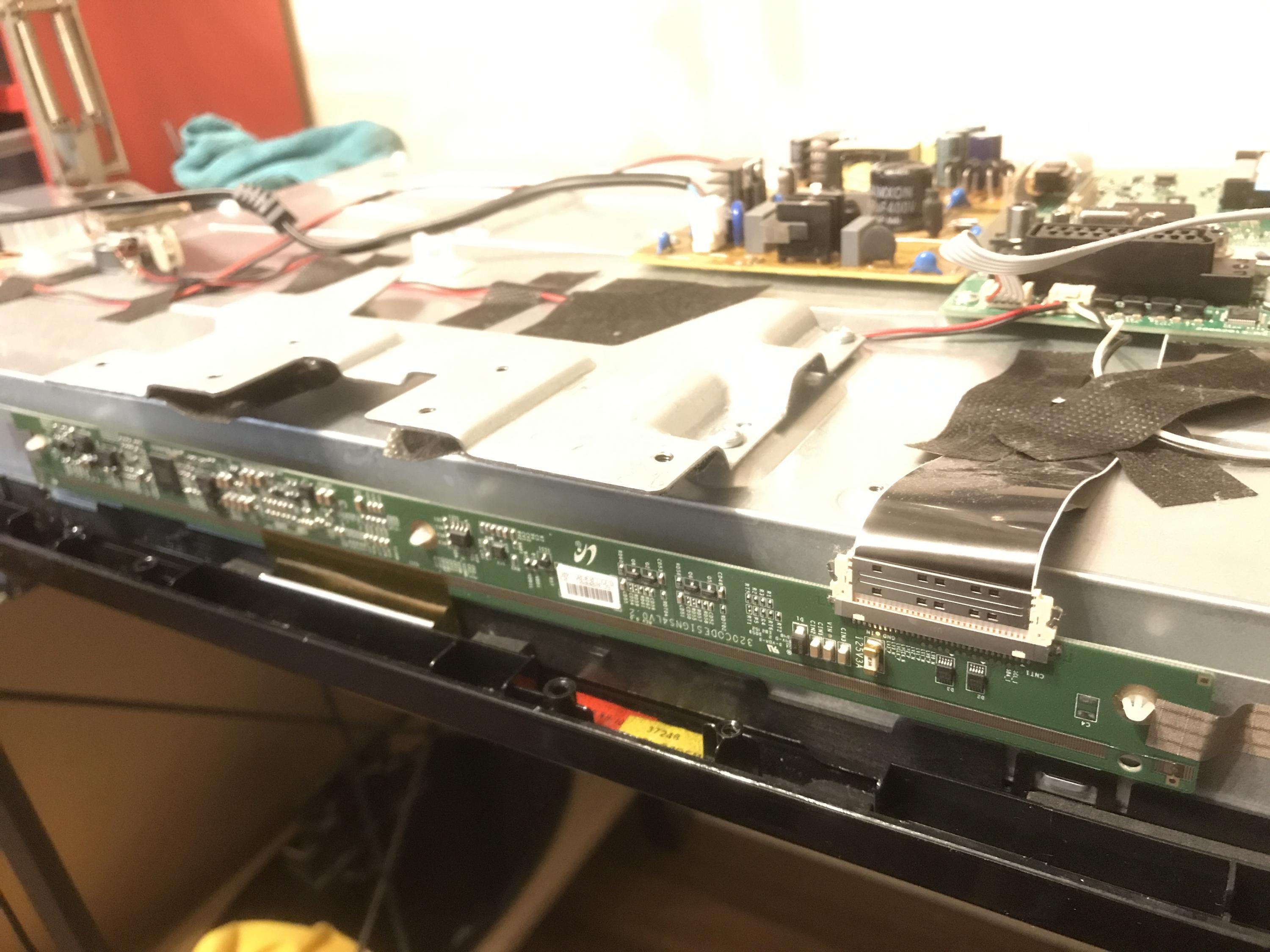

                Re: Celcus DLED32167HD Dim Backlights - Sound but no Picture
                Big wide tcon board Budm, looks like it's directly bonded to the screen via one wide ribbon... so it's safe to say if the tcon board is at fault the set's a scrapper
                  Oh, it has integrated T-CON board, you can check the resistance of the MLCC (Muti Layer Ceramic Cap) to see if any one of them shows low resistance readings.

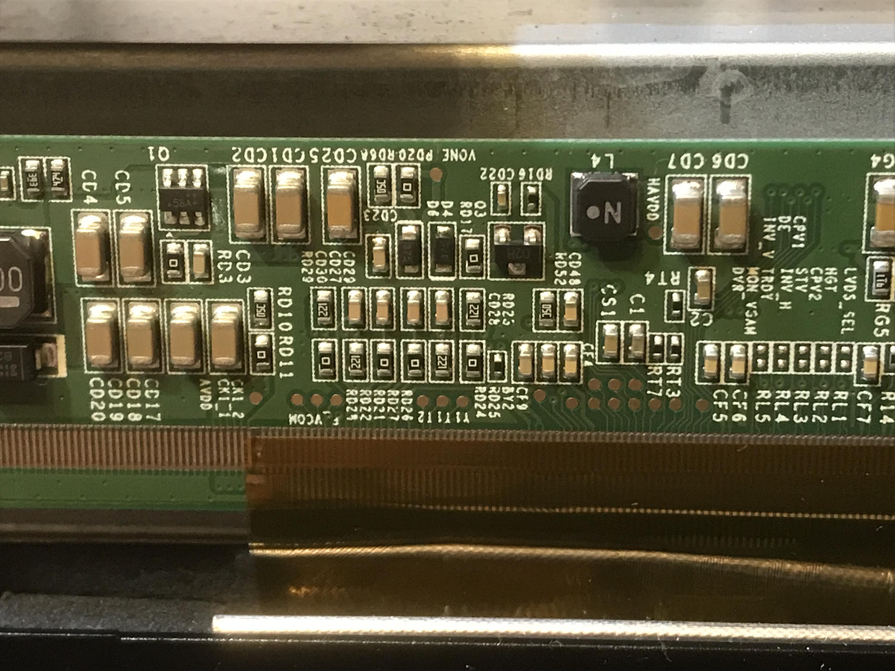

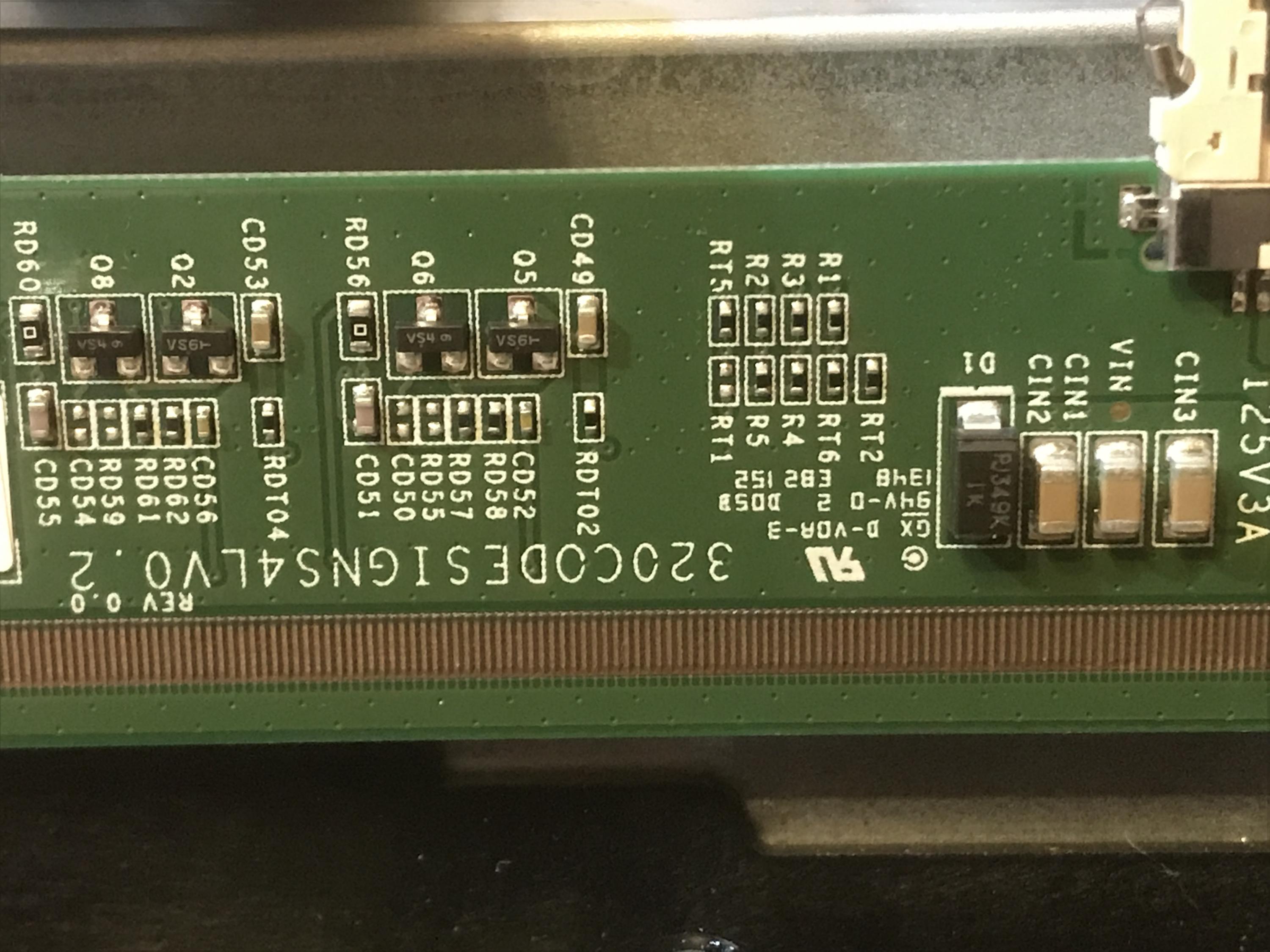

                      Ok, I wasn't quite sure which of the SMD caps you meant, but I tested all of the larger smd caps on the tcon but none had low resistance.

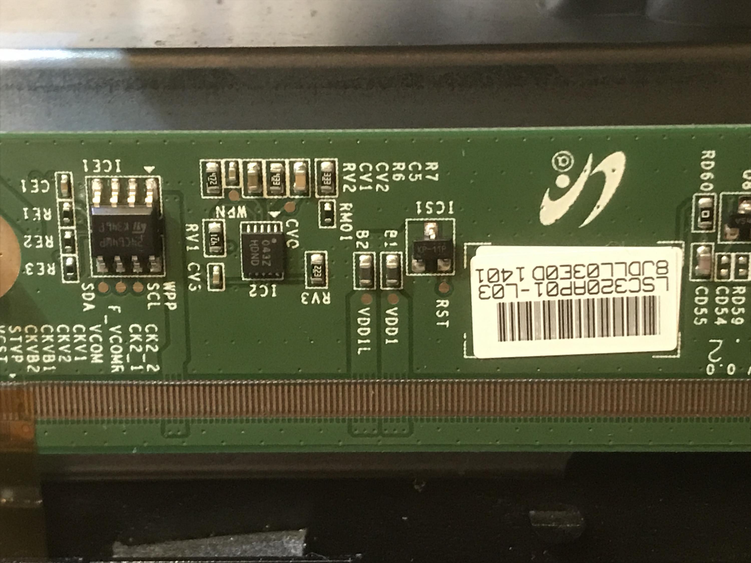

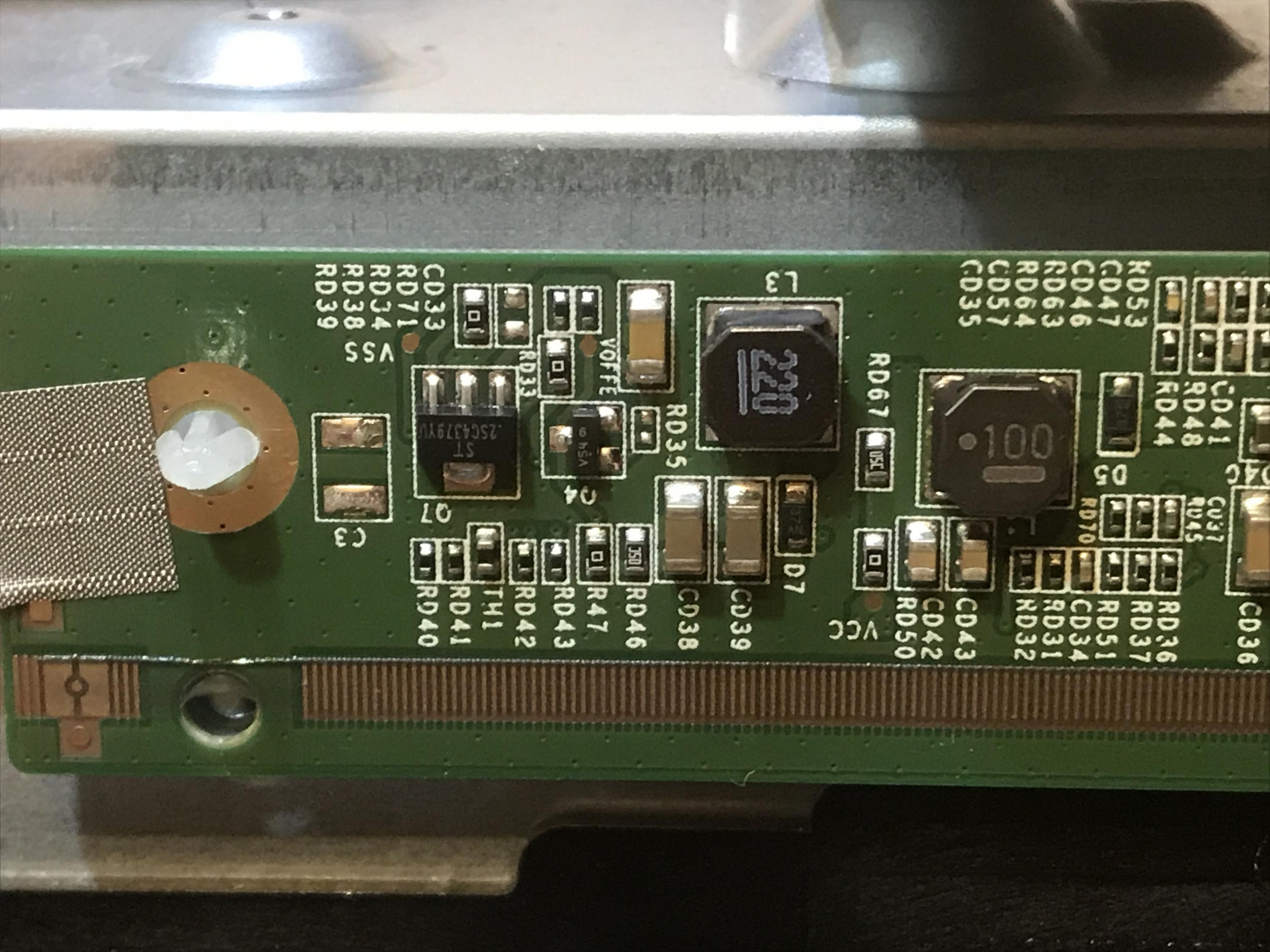

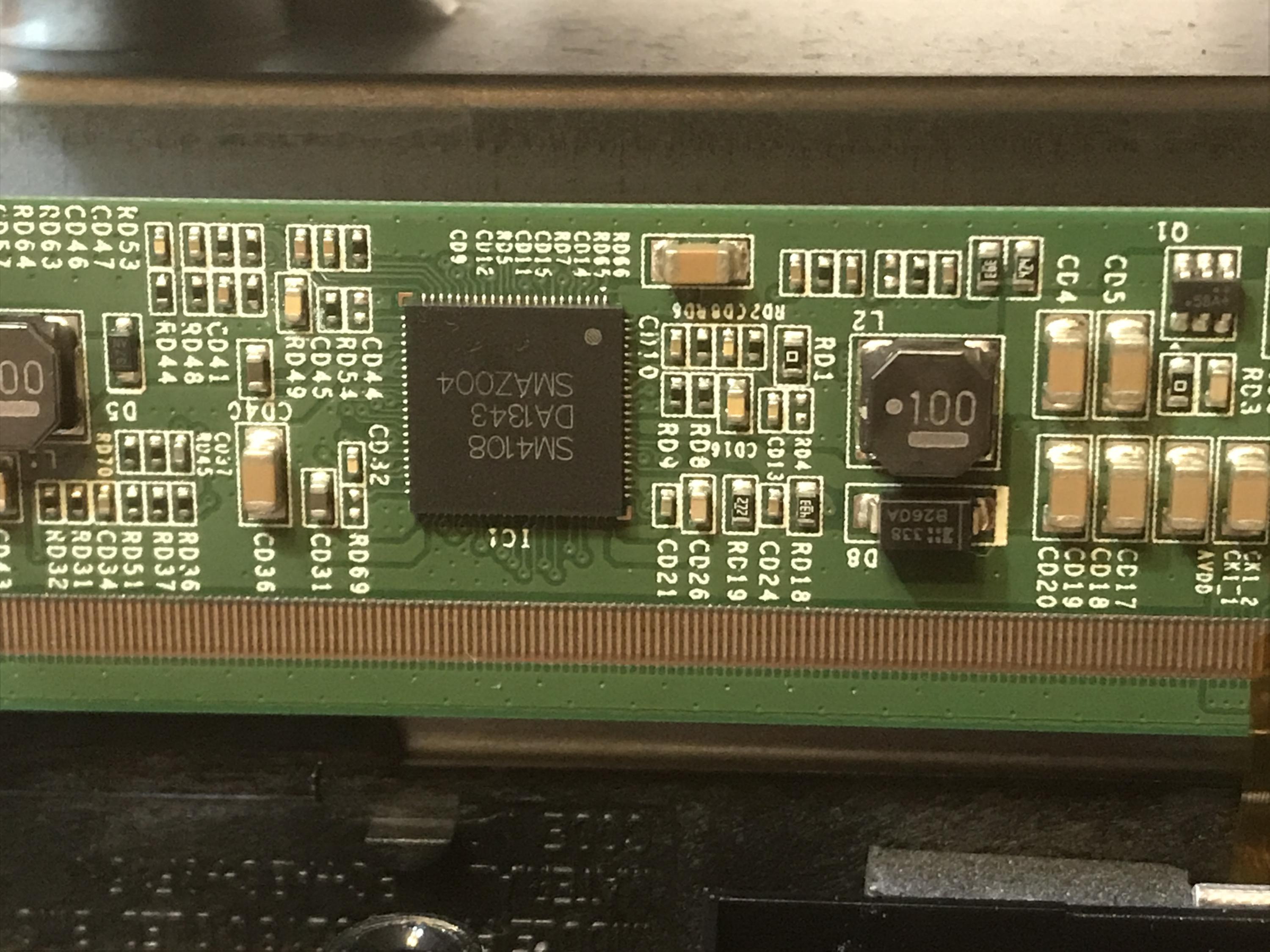

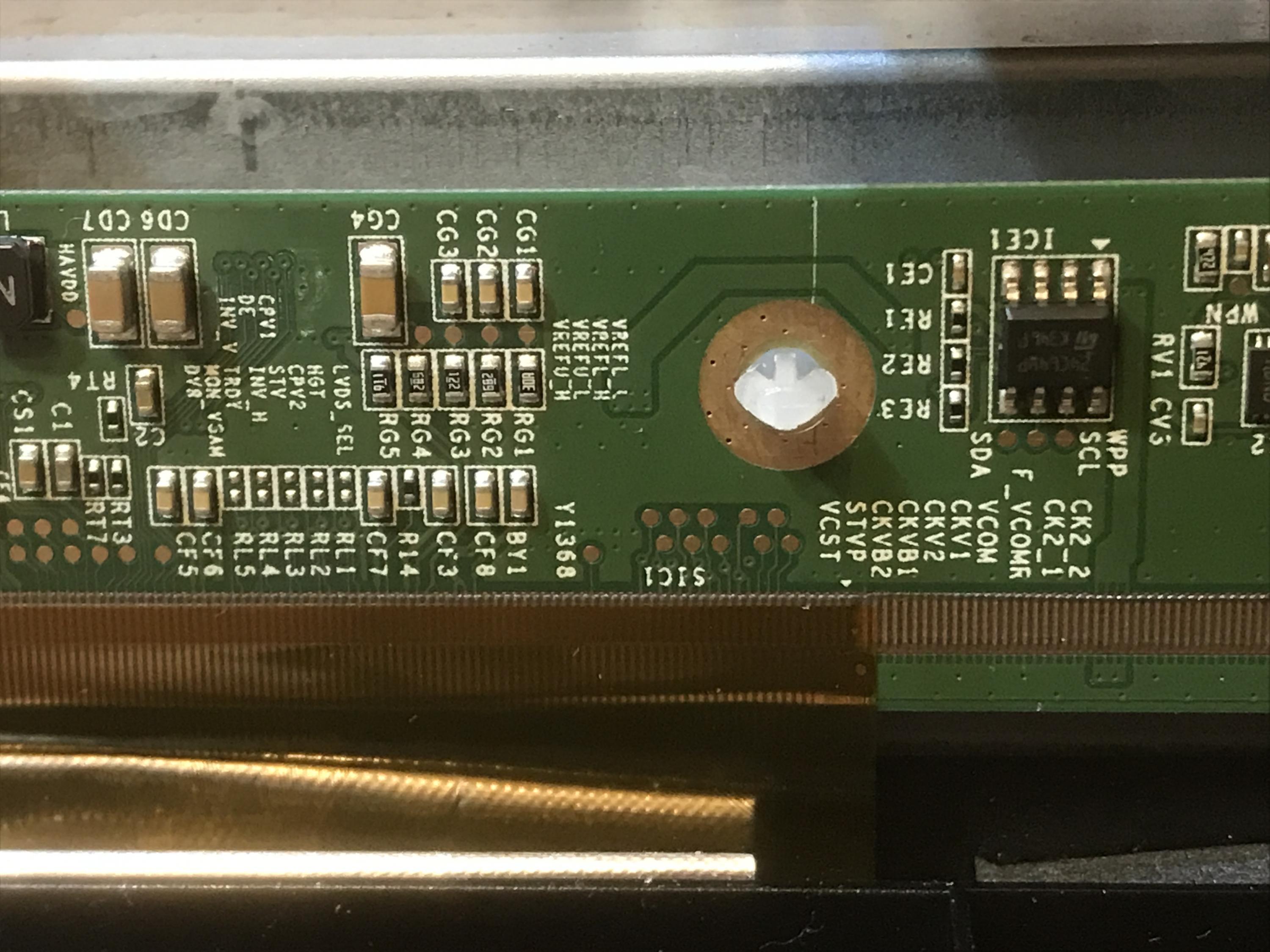

                      Here's some close-ups of the tcon if they help.?
                        Check them all.
                        I also see some Voltage test points that you should check, I.E. VCC, VSS, VCOM, etc....

                          Ok, test points as follows:
                          VDD1 = 0.58V
                          VDD1L = 0.58V
                          VSS = 0.8V
                          V0FFE = 0.2V
                          VCC = 0.58V
                          F_VCOM = 0.1V
                          V0NE = 0.0V
                          VCOM = 0.58V
                          F_VCOMR = 0.58V
                          I have to go out for the rest of the morning but when I get back I'll check some more components with power off. There a few diodes and plenty of resistors with a zero on them to test.

                                You sure do have problem on that integrated T-CON board based on those Voltage readings. You may want to trace out the VCC line to see why it is so low, typical VCC will be 1.8V, or 3.3V.
