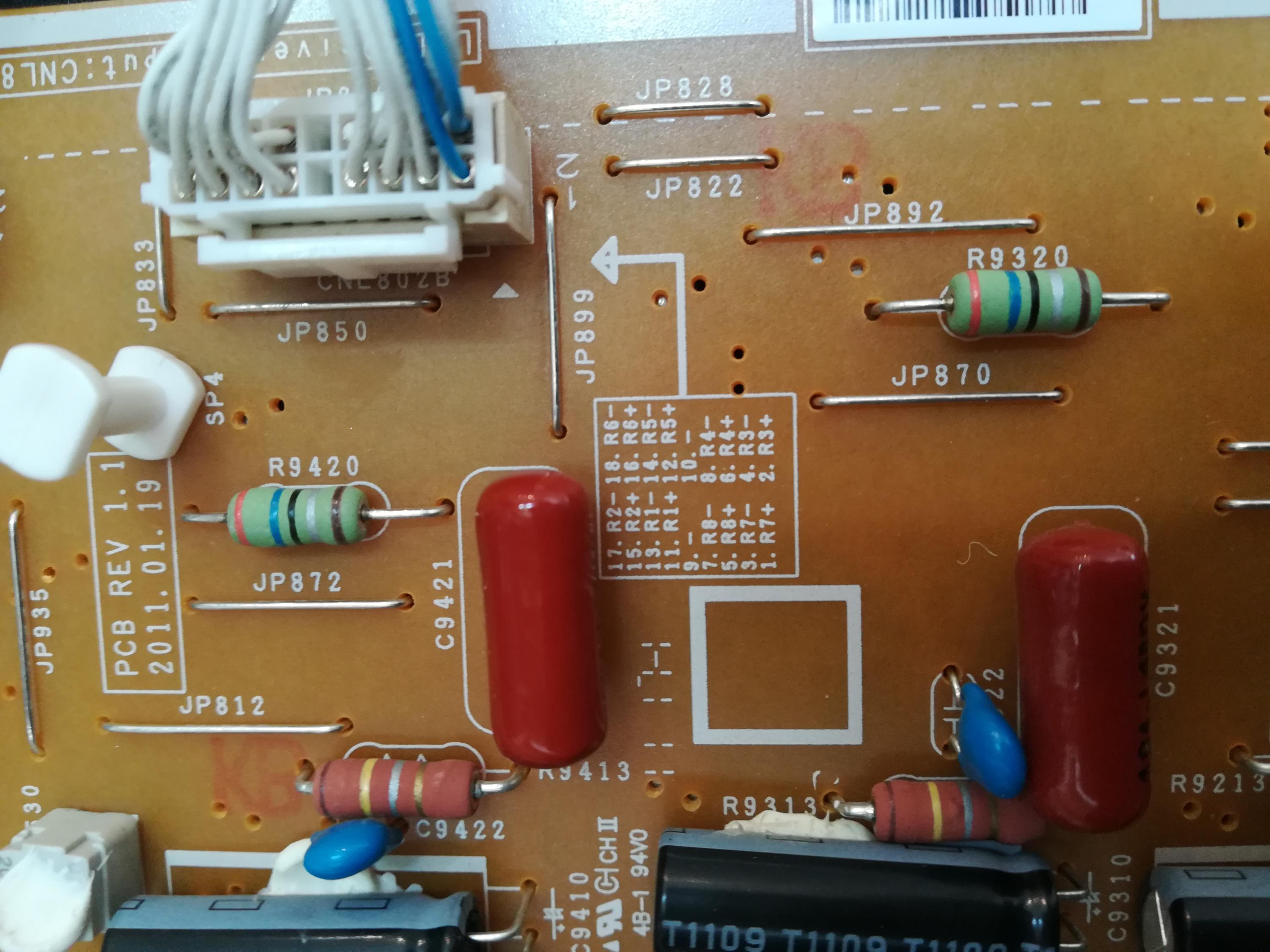

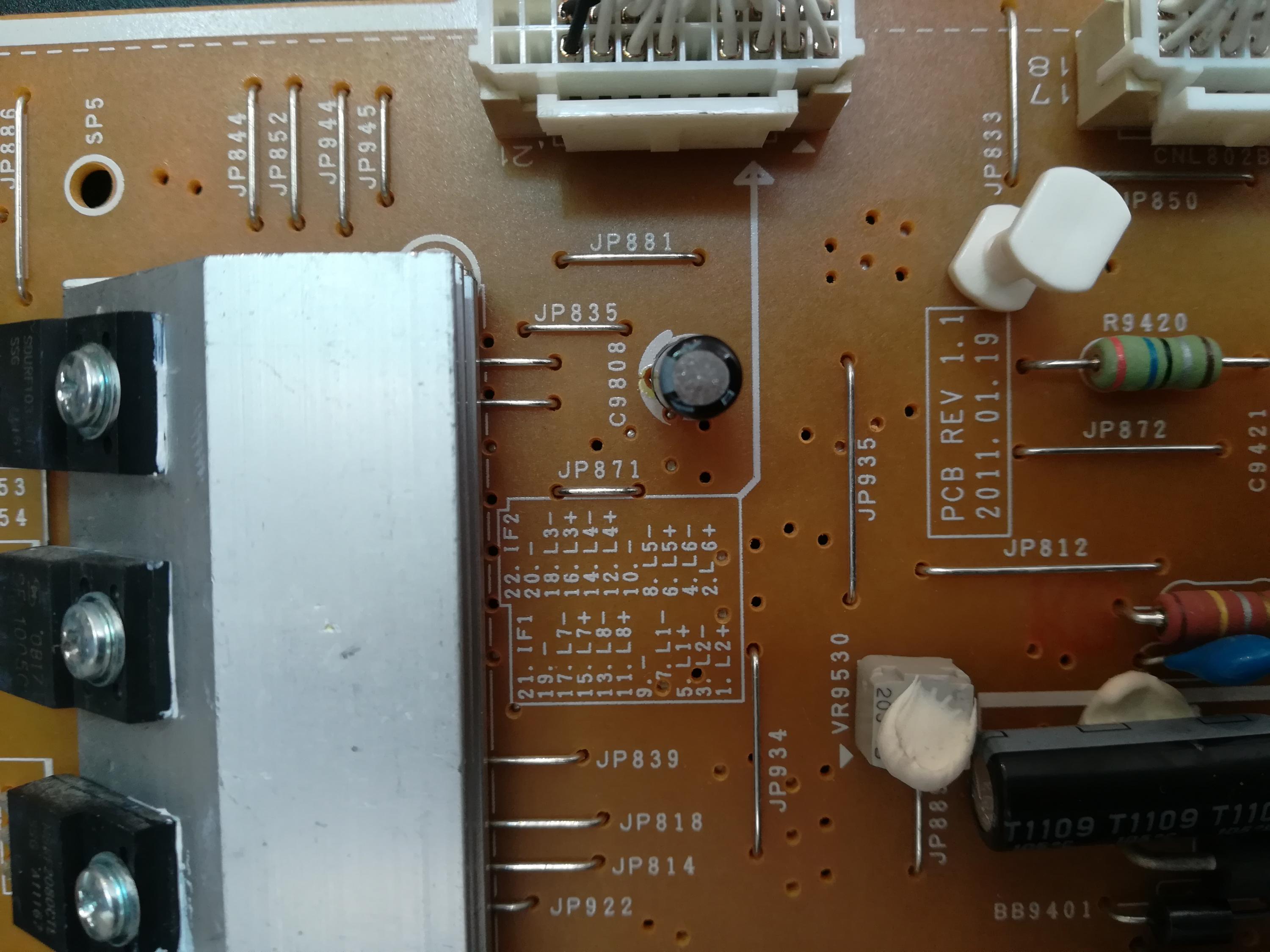

    These voltages seem to be OK according to the stamp on the board (see attached)

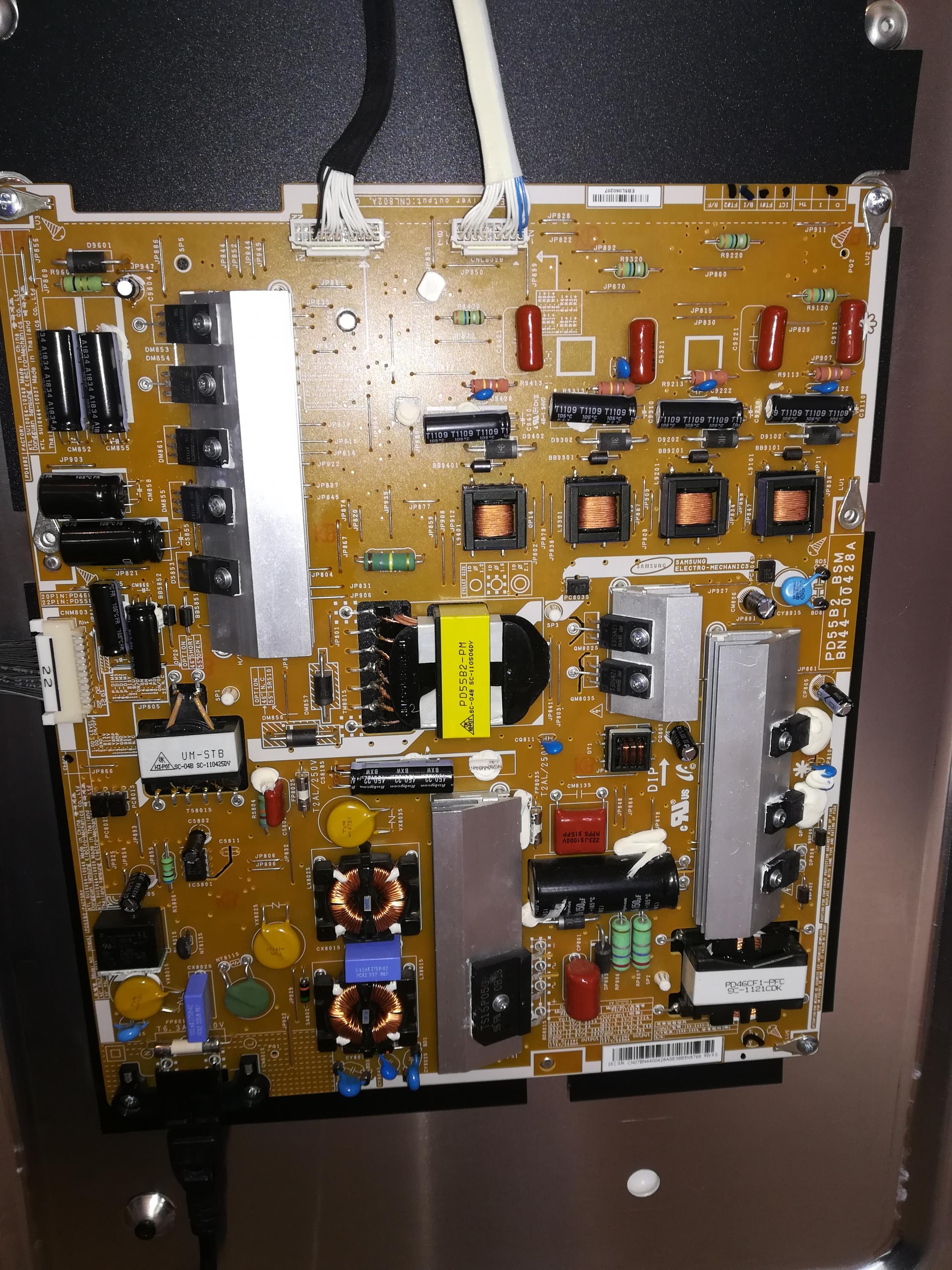

    Re: Samsung UE55D8000 not powering up

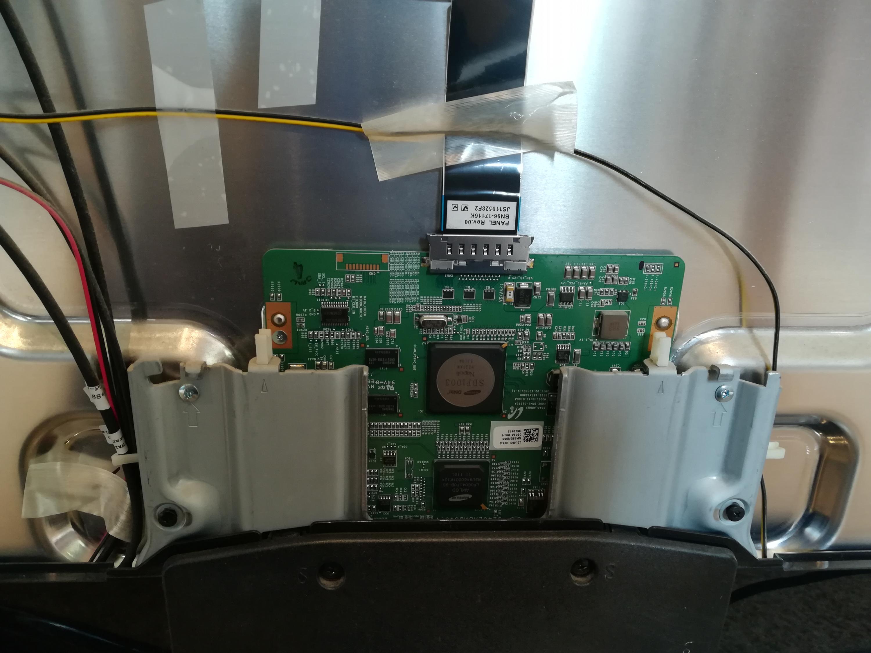

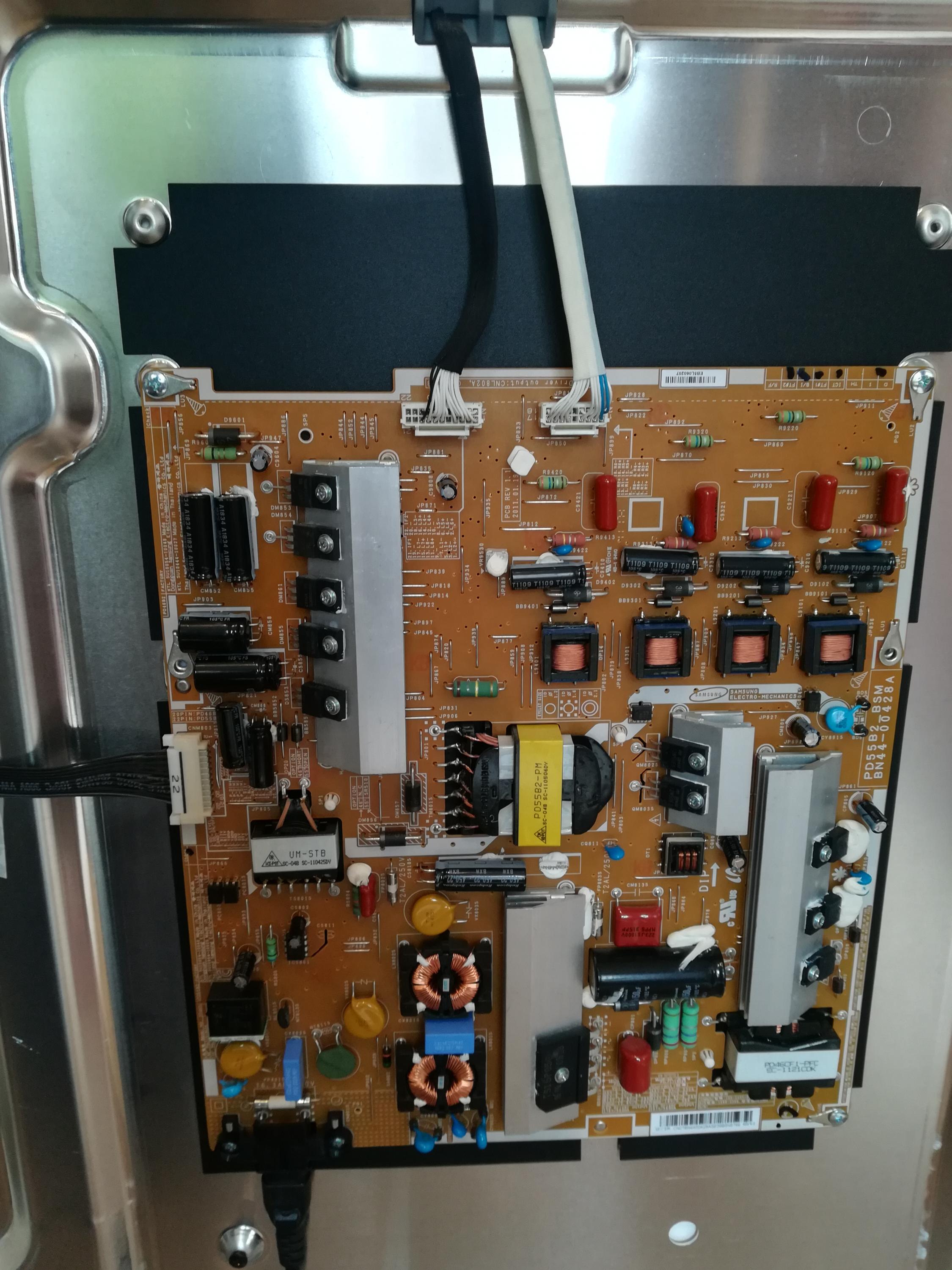

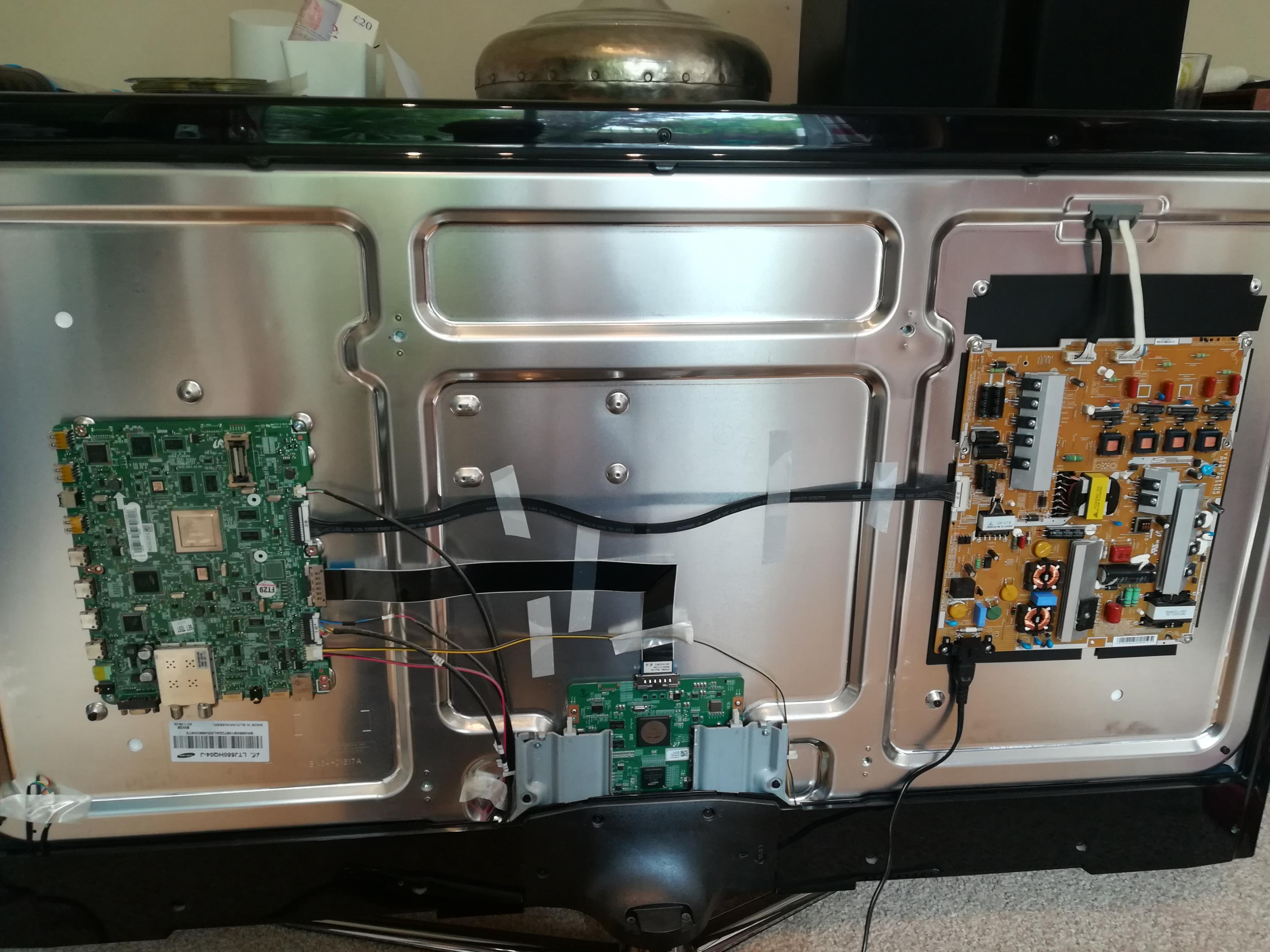

    Can we the pictures of the whole backside of the TV showing all the boards and the picture of the whole power supply board?
    What Voltages do you have on the LED connectors when main board is not connected to the power supply board?
      Thanks for the reply.

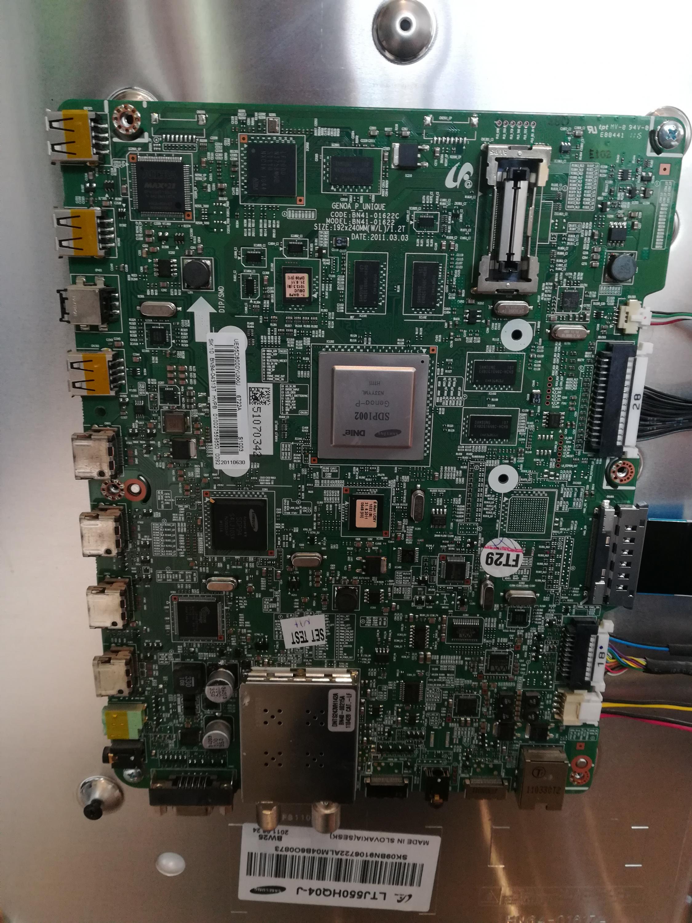

      Sure, here are some pics of the whole backside and the whole power supply board.
      Also a pic of the voltage readings when the main board is disconnected from the power supply board.

        An update:
        After taking readings, I thought that the Main Board may have been at fault.
        I replaced it with a known working one, and I still have exactly the same symptoms as before.
        Can anyone advise where to go from here?
