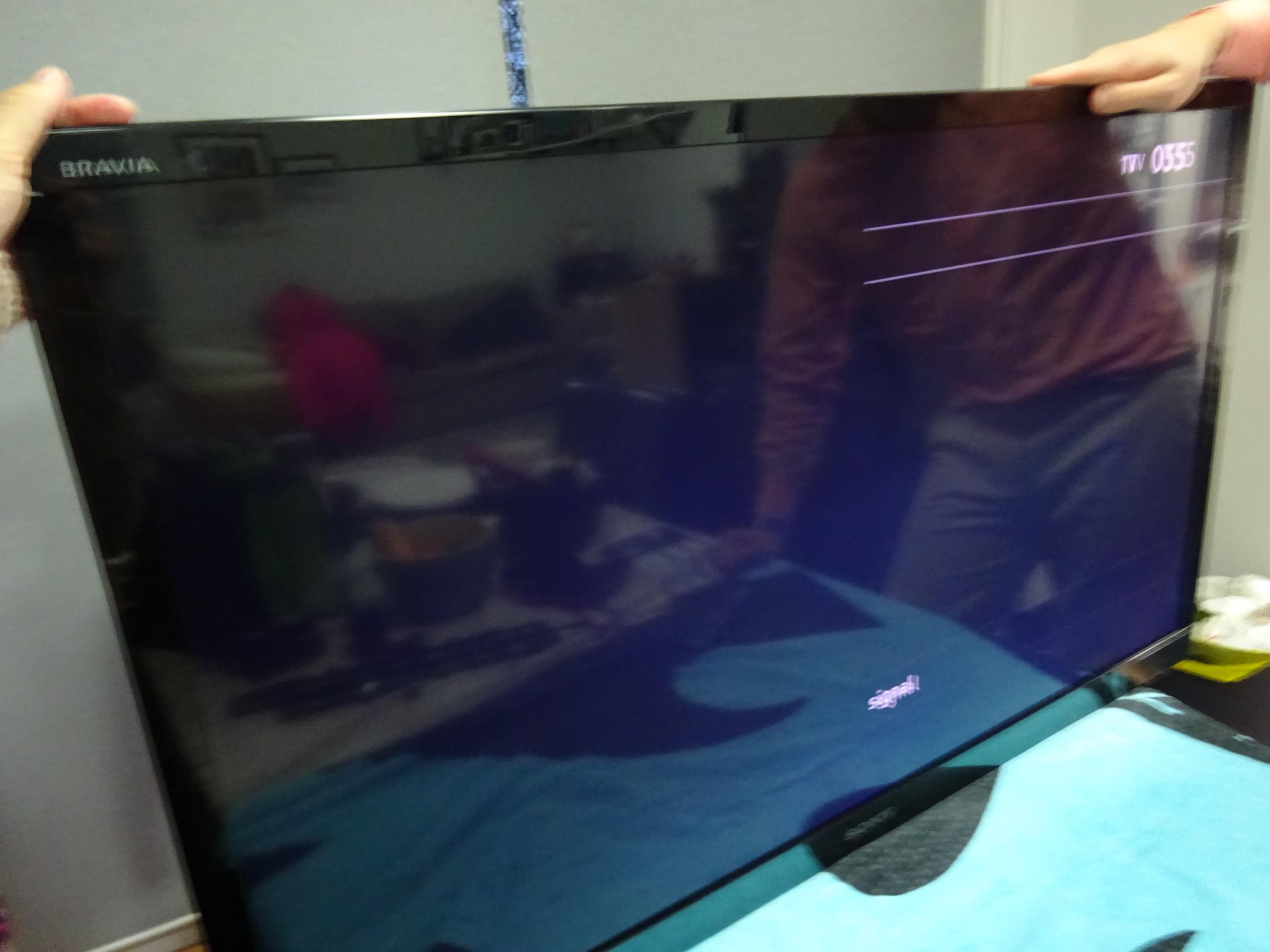

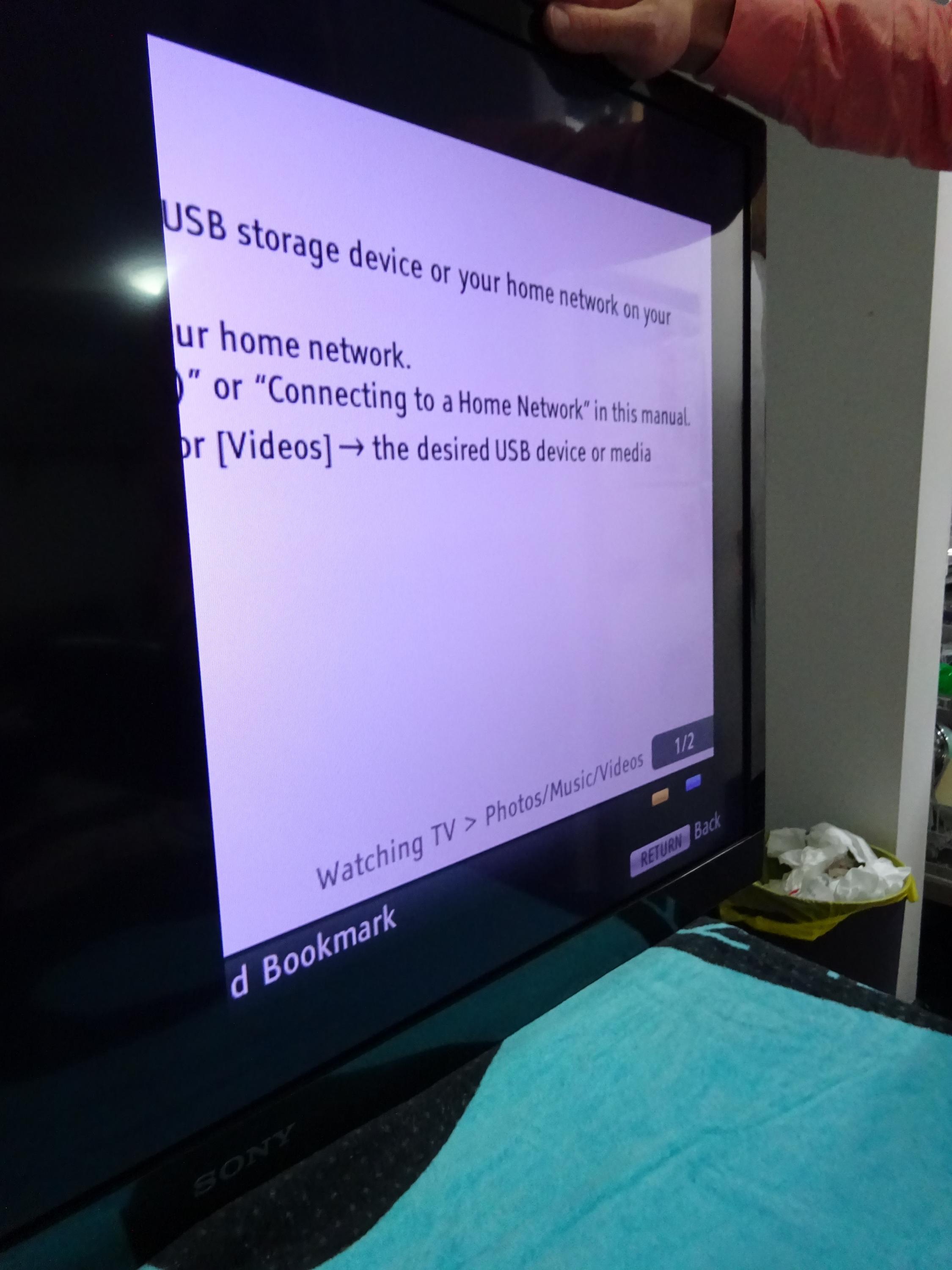

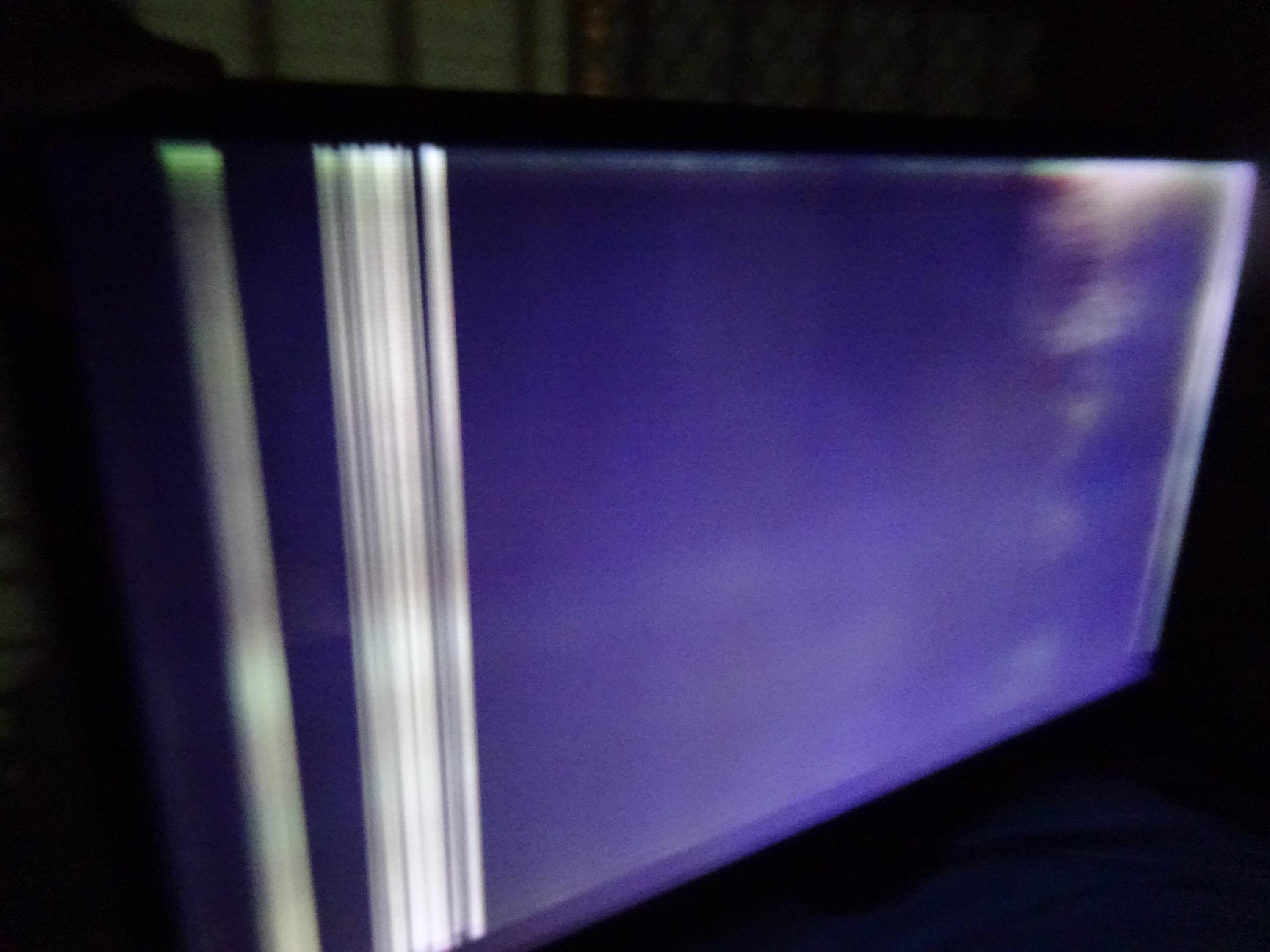

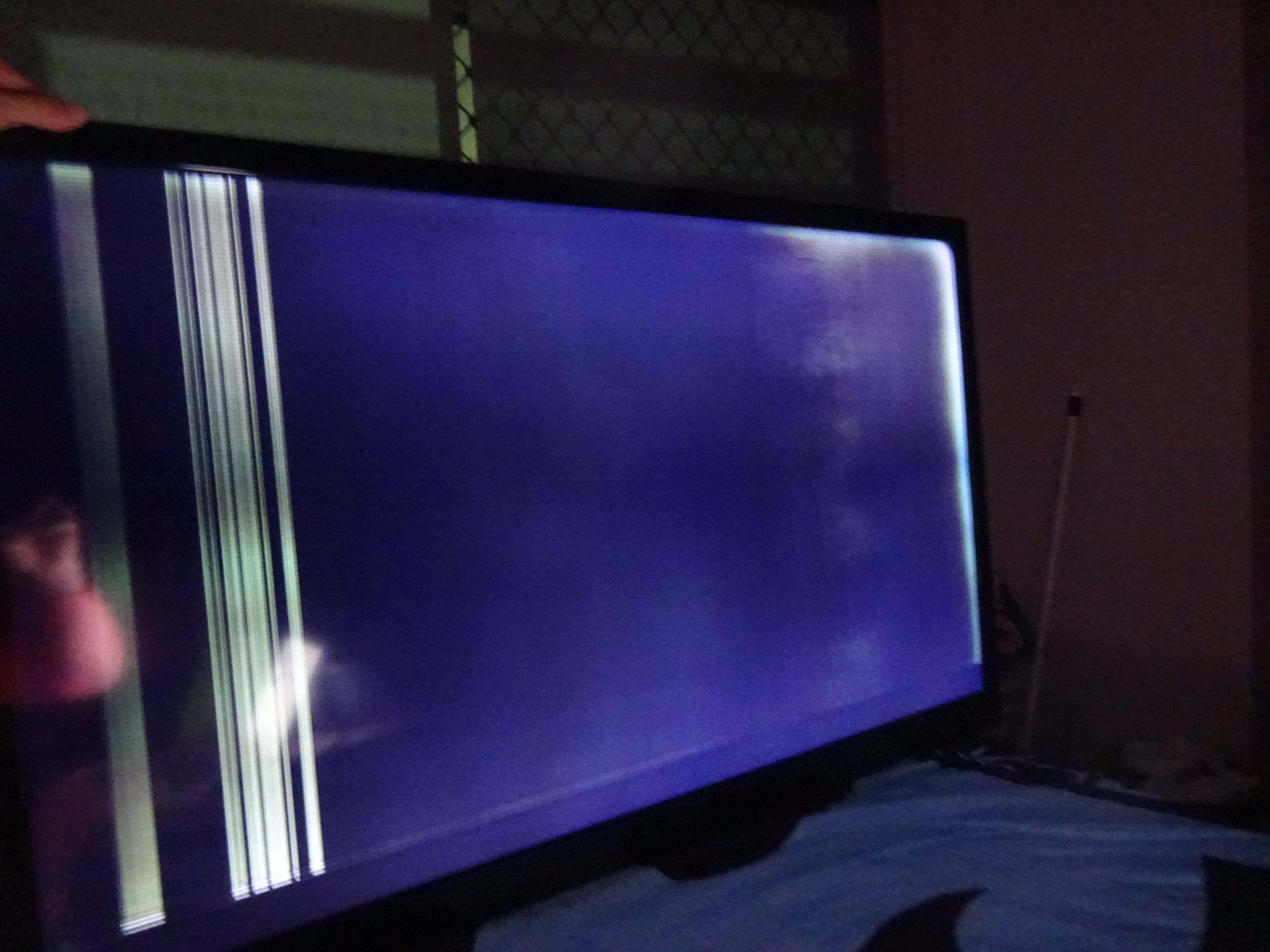

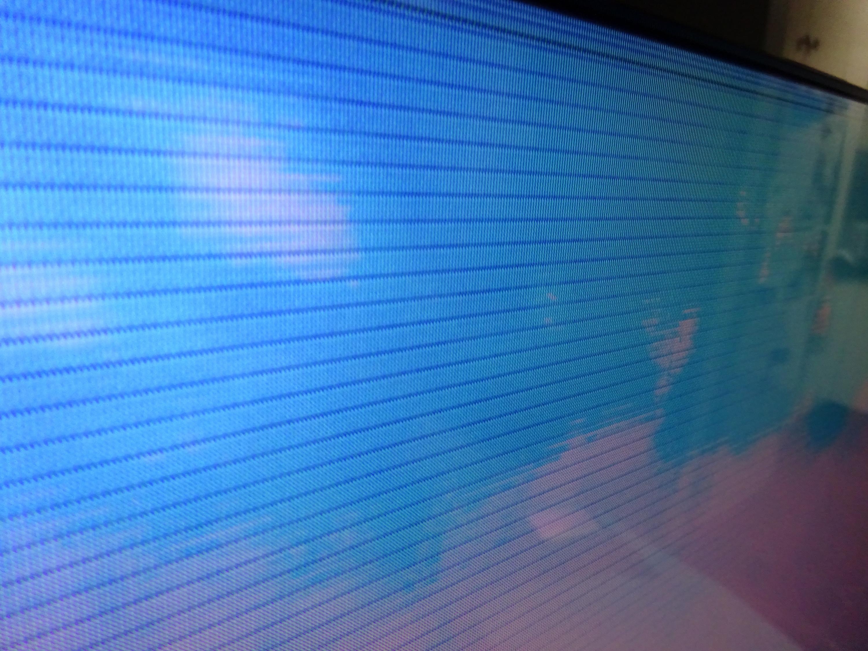

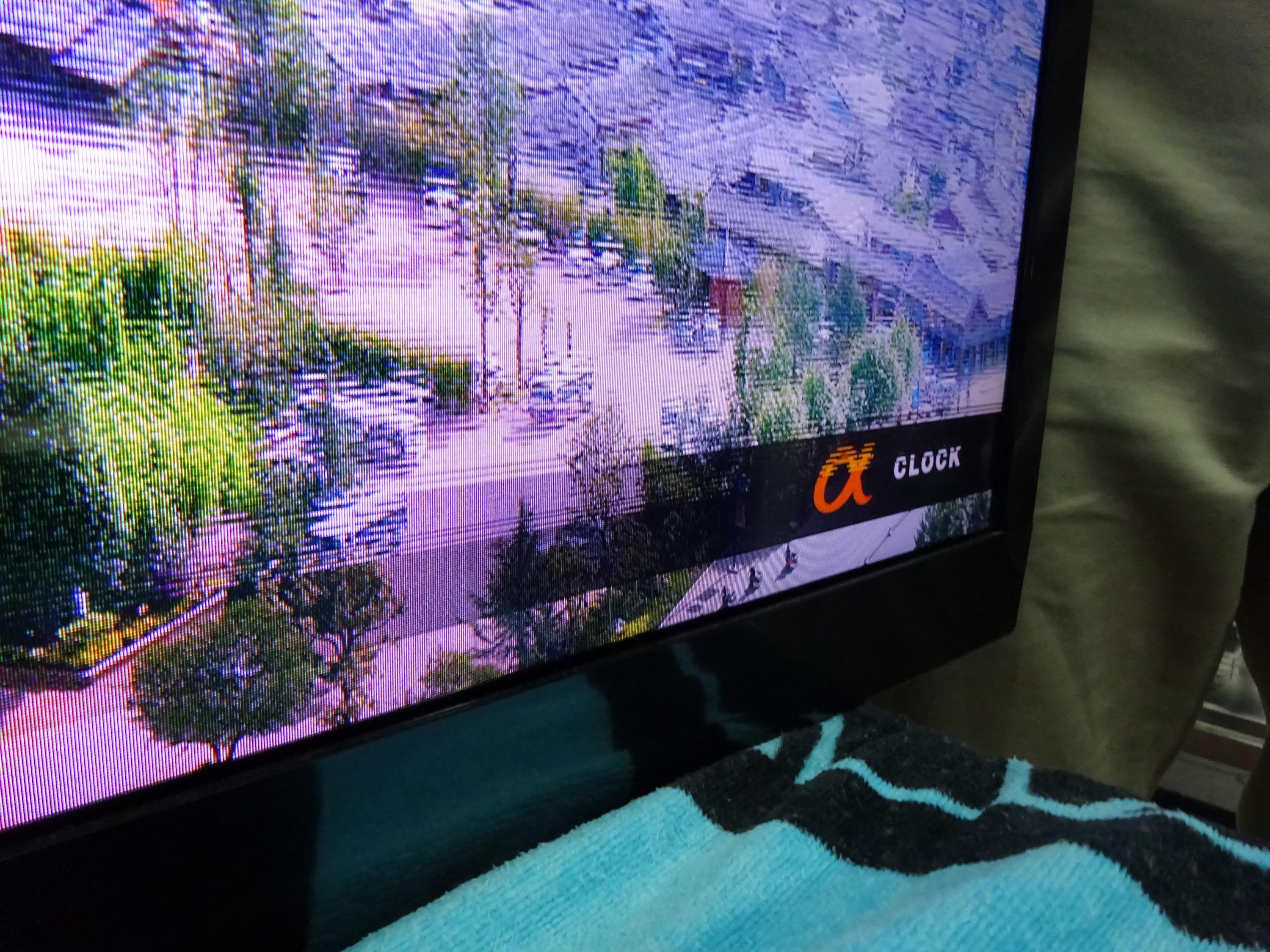

    Yesterday, horizontal lines appeared on my television and I am unsure whether the problem lies with the T-con board or LCD panel.
    I have removed the back housing and visually there are no obvious electronic issues. I then removed one of the ribbon cables from the T-con board, which resulted in blacking out half of the screen and the other half appeared normal (ie problem resolved - no distortion). I replaced the ribbon and then removed the second ribbon and there were horizontal lines across the entire screen.
    I have attached several photos.
    Any advice or other checks would be appreciated.
    Thanks in advance.

    the last two picture show vertical lines... those are usually not good as there is likely a problem with the panel near that area. You can check the tabs in and near the area. Is the panel on this set connected to a small edge board at the bottom or top? You might get lucky by carefully checking the edge board for a component failure (resistor or capacity). The corner area also drives the side of the panel which is the reason that you see the lines in the second picture.

      If no luck finding/fixing fault, the "cutoff tape" method might get you a good image.

        The edge board is on the bottom and seems quite hard to get to. I will check the panel tabs tonight.
        If it sounds like it might be a panel problem it looks like i will be needing a new TV.

          Not much to it, may have to play with the width of the tape to get it right, might work might not: https://www.youtube.com/watch?v=j7vl7-vZEL8
