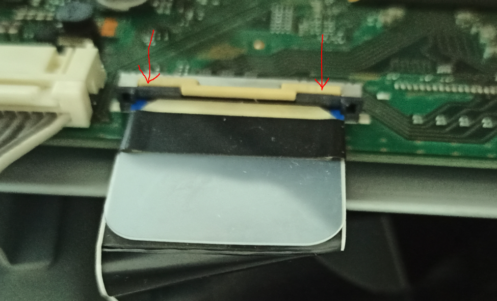

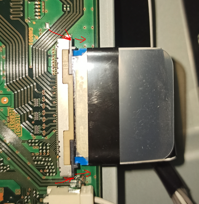

                          I update. I have cleaned the flex at both ends. It hasn't worked. In fact, yellow lines now appeared, some wider than others, until suddenly there was no image left.
                          Of course, I did a correct manipulation, everything turned off.
                          But I discovered something. The noise was not from the power supply, it came from the area of the controller boards, the area where the tcon is integrated. When the lines were no longer visible, and there was no image, the noise disappeared.
                          Could it be a coil in that area in poor condition that is causing the problem? Or could it be some tcon chip?
                          Thanks to all for the help.​

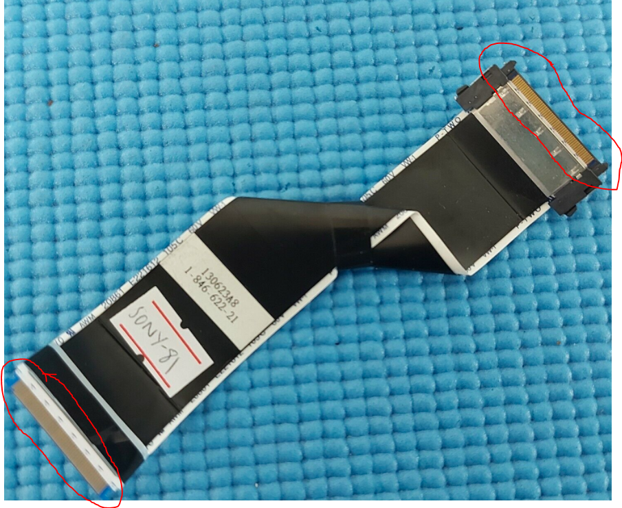

                                you have damaged the LVDS...,, so how it come after cleaning it produced yellow line as you stated... use your mobile camera to focus on the contact pins
                                • Raulnn
                                  • Nov 2022
                                  • 103
                                  • España
                                  Now nothing is seen on the screen, only backlight. I haven't been able to damage anything. I did everything following security measures
                                  the pegs are fine
                                  • Diah
                                    • Feb 2013
                                    • 6424
                                    show here clear high resolution photo of both end lvds cable pins
