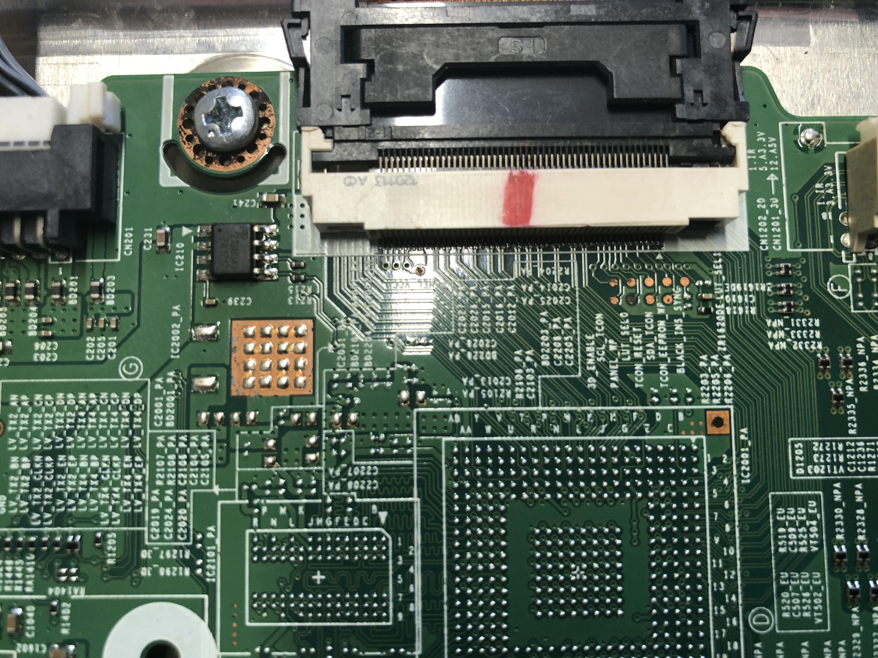

                        Finally got this tv repaired. I suspected a main board from model UN46D6000 may work since that model is more common. First one I bought, the connector to the front panel was different so I had to return it. Second one I made sure the connector was the same and that one is working. The 6000 main board has 4 HDMI (2 on the 6003) and also adds a VGA and ethernet port both not on the 6003. Wifi still needs a dongle. I think the 40" version of the main board may also work.

                          I have a UN46D6000, when switched on the backlights come on and stays on, although no picture or sound. Voltages on CNM803A reads as per printed list on board. However, there is no 12V on the T-CON fuse.
                          I do find 12.2V on (looks like pin 51) on the mainboard on the LVDS connector going to the T-CON, but can't find that voltage on the T-CON connector. How often do these cables fail, or I am looking at this wrong. I suspect if I don't have 12V on the T-CON, I have a Mainboard or LVDS cable problem.

                              IC210 on the main board looks to be the switched MOSFET for providing the switched 12V to the TCON board, so if you check the resistance between pin 7/8 of IC210 and the SMD fuse of the T-CON, it shows open circuit instead of < 1 Ohm resistance?

                                Hi budm
                                Resistance readings between both the fuse and 7/8 of IC210 are 0.2 ohm. Thanks budm

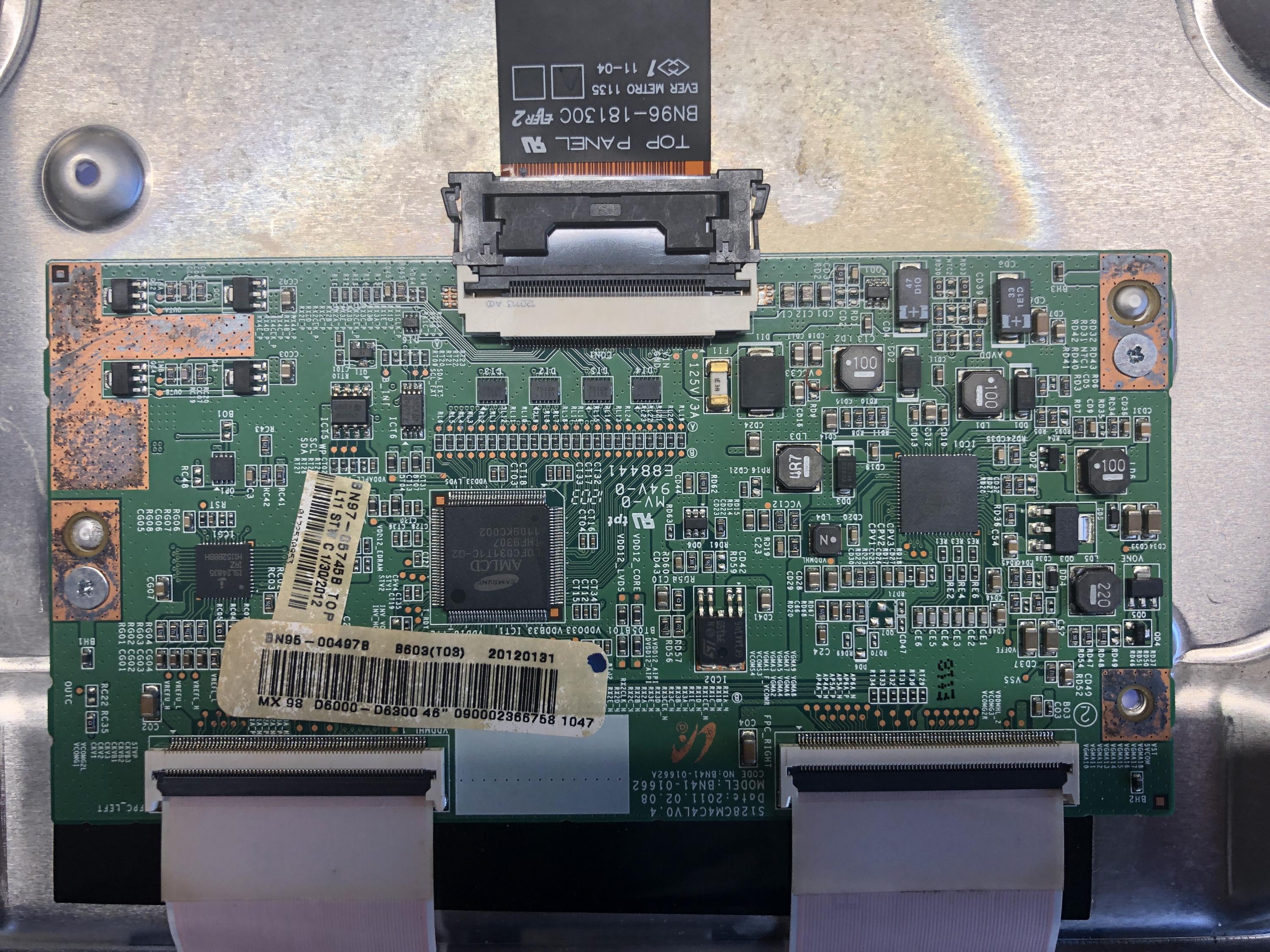

                                  Hi budm
                                  I found another LVDS cable, although it is the same number on the cable, this one is slightly shorter. Probably out of another Samsung. When I connect this cable to the mainboard, the voltage on the end of the LVDS cable is 12.07V, but as soon as I connect it to the T-CON, the voltage drops to 0.87V. That is then also the voltage on the T-CON fuse. If I disconnect the two flat ribbon cables going to the panel, the reading still stays 0.87V. Do you think I have a bad T-CON?

                                    Try powering one side of the tv at a time with one ribbon disconnected from tcon to panel. If one side displays a picture, you have a bad panel.
                                      Re: Samsung UN46D6003SF Won't Turn On
                                      Seems like a tcon issue, check the V12IN test pad, will probably be the same .87v, how are you testing the tcon fuse? proper way is black - probe on chassis ground and red + probe on each side of fuse.

                                        Hi guys
                                        I removed one of the tabs going to the panel, getting no display or picture. Same with other one. The voltages I took on T-Con was ground on Chassis and Red on both ends of the fuse.
                                        I think I'll order a new T-CON from SJ and see what happens. Thank you so much for your help so far. Will keep you posted.
