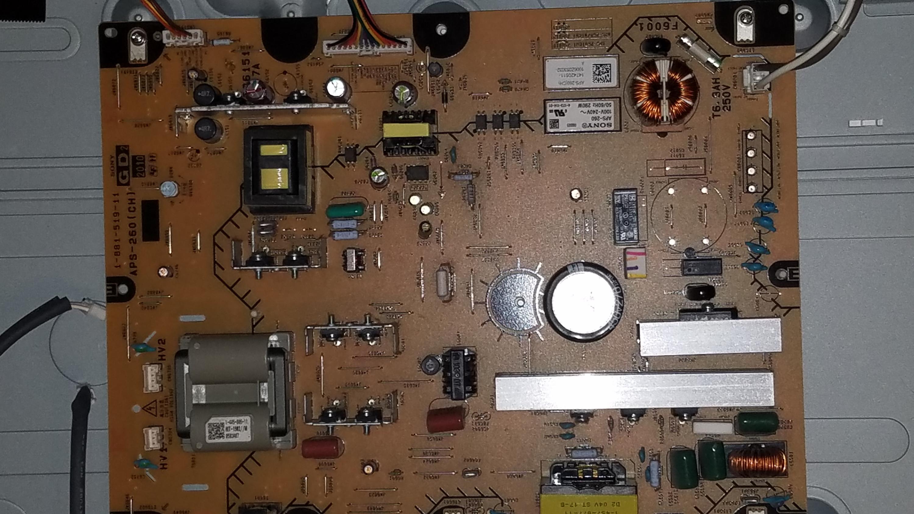

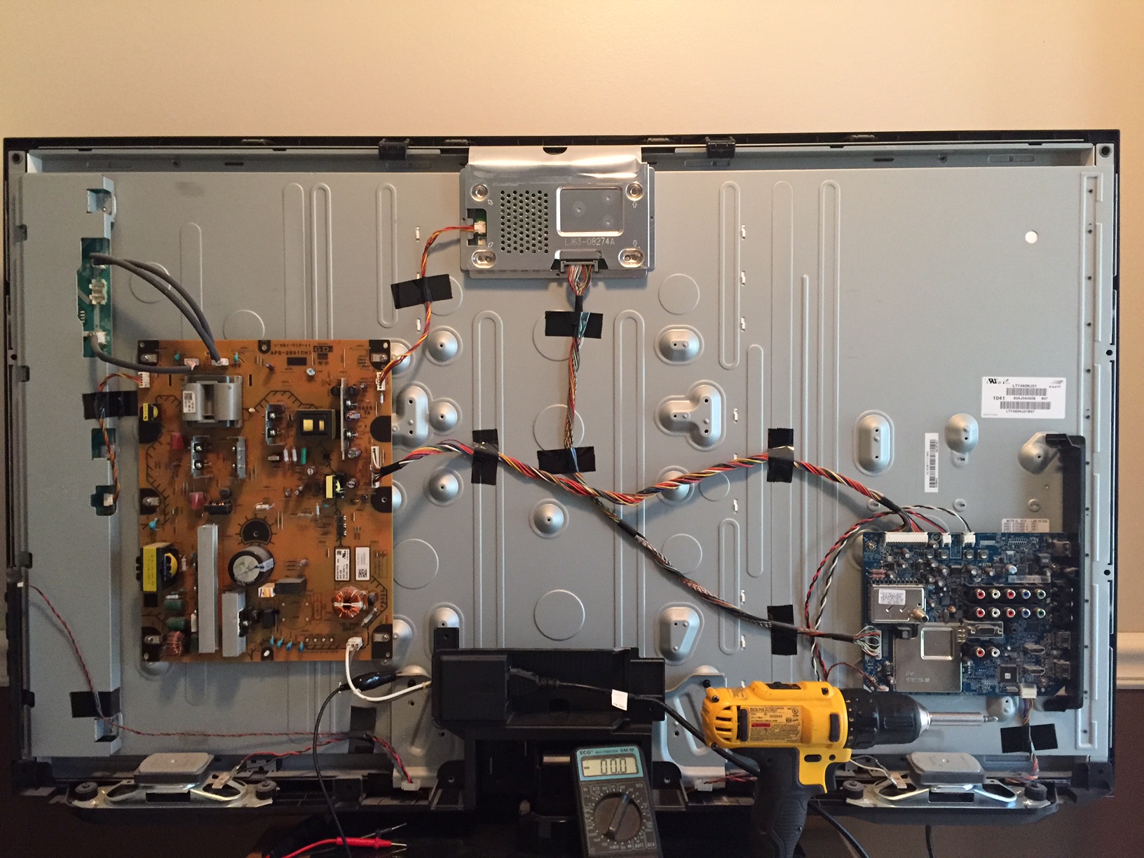

    Hi
    I received a Sony KDL-46EX500 that I'm not sure where to start on.
    No lights (standby- red or Green)
    3.3 V is present on STBY (3.248V)
    AC-OFF-DET is 2.79 V
    POWER-ON is 3.23 V
    BL-ERR is 3.2 V
    All other voltages on the Power and main board are in the 0V range
    The POWER-ON Does not change when the keypad button is pushed (main board), yet the actual power key signal on the main board is triggering (Goes to 0 V when keypad power button is pushed, and returns to 3.xxV when not pressed)
    The Manual indicates that I have to replace the GD2 (Power) board. though the power button behavior makes me suspect that in addition, the Main board is dead?
    I don't want to spend money to replace bother boards as the TV is not worth the costs of individual boards. Just wanted to check my theory that both boards are dead (maybe even the Inverter since the BL-ERR signal is 3.3 V)

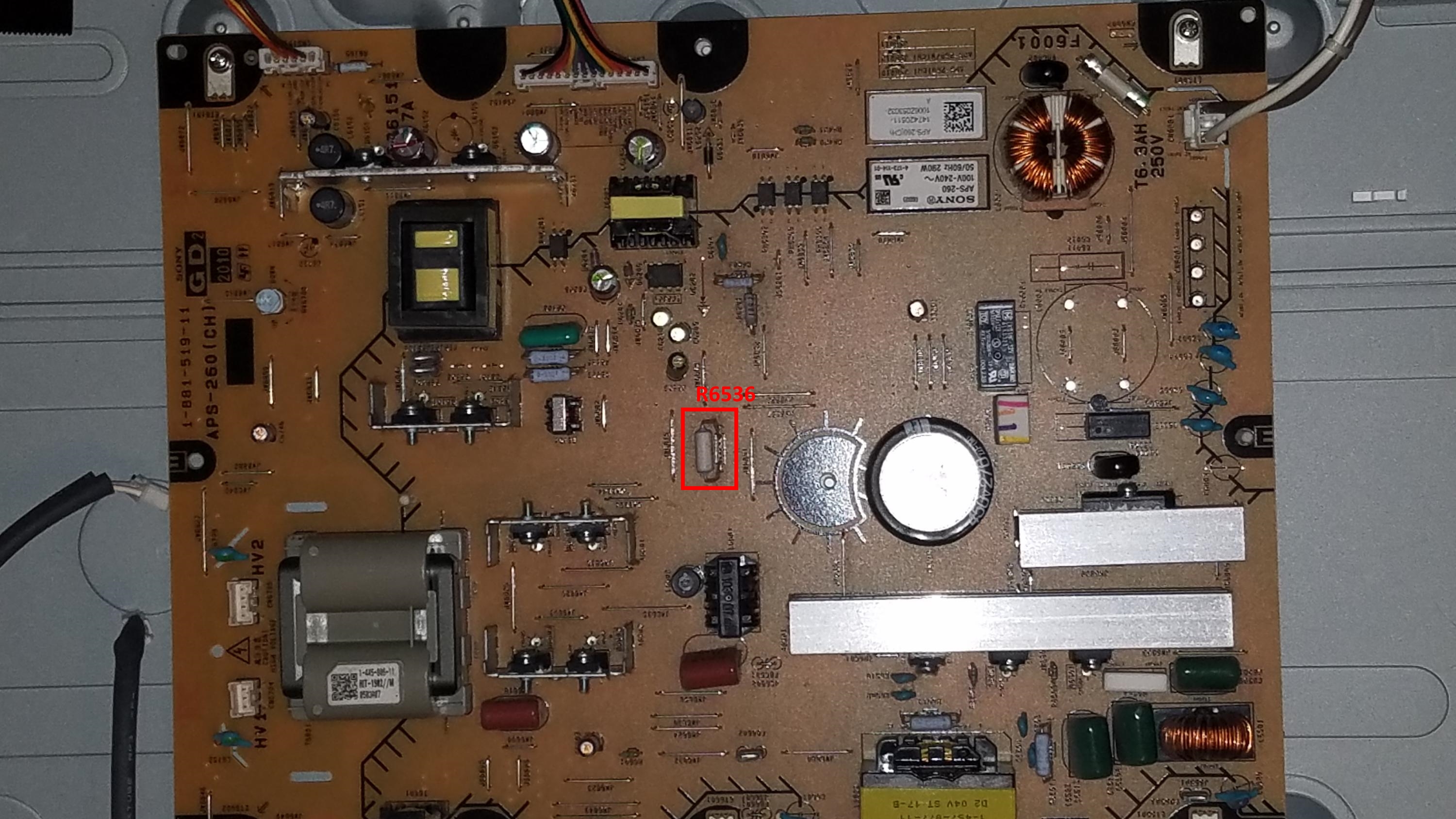

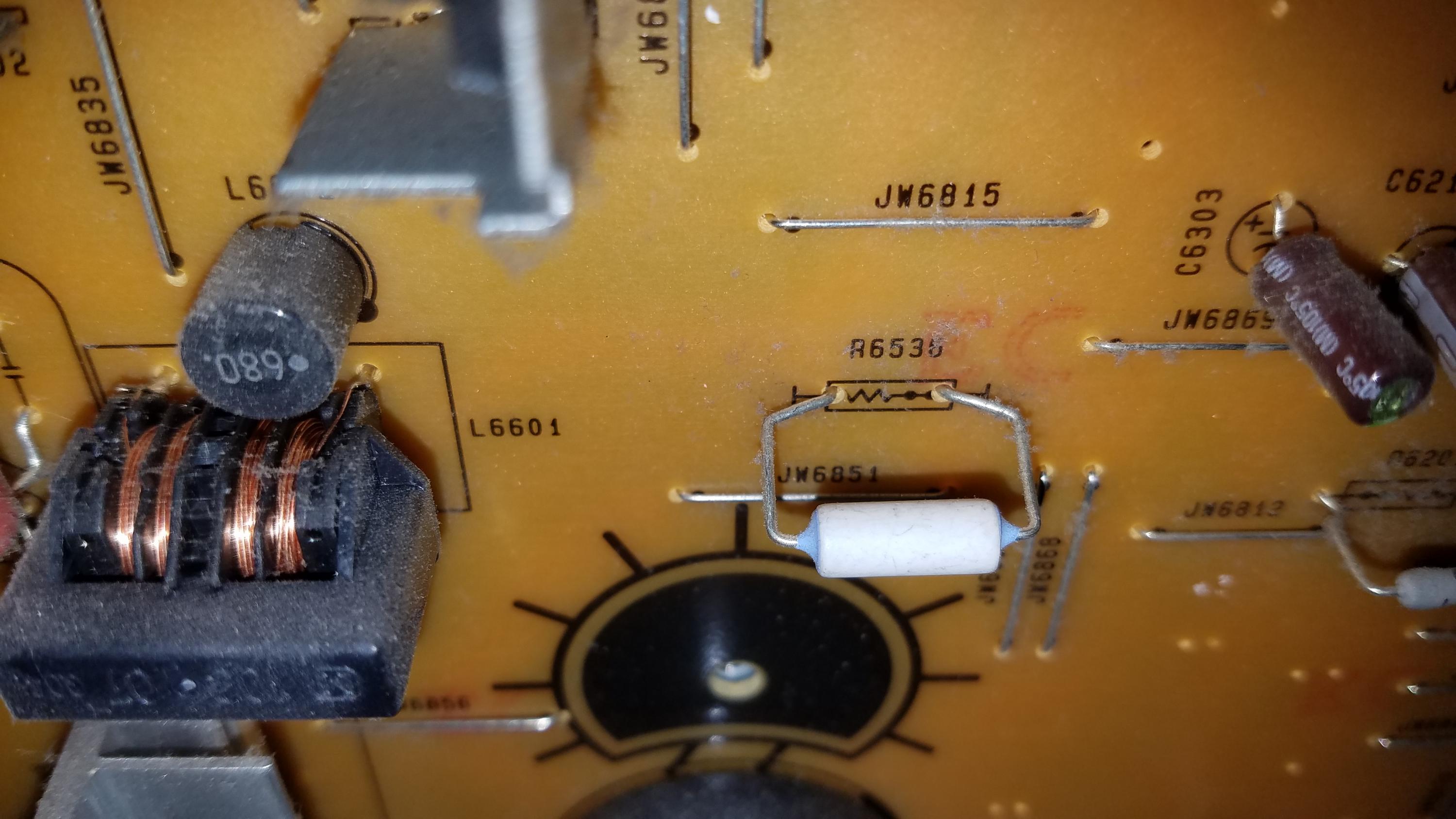

    I found a kit on eBay and ShopJimmy, but the fine print states that R6536 would be open in this failure mode that the kit would fix. My R6536 on the GD2 is reading 23.3kOhm.

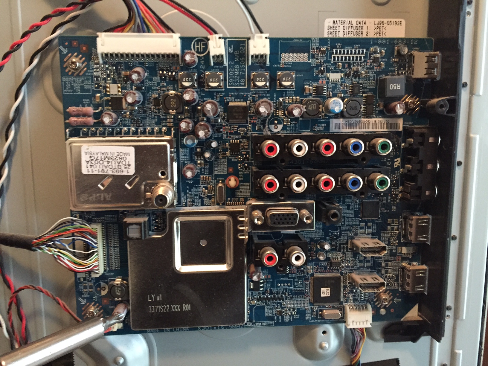

    What happens when you unplug mainboard from powerboard and turn on tv?

      Look at the resistance of the R6536 as printed on the body of the resistor then you will know why your R6536 is no good, the GD2 board may have some shorted out component that takes out R6536.

        Just tried. Nothing at all. Just the click when I connect the AC cable (relay) and that's it.
          the photo I provided is one I stole from another post here. My board is identical but my resistor has "U40" on it, that's all. Can't tell what value that is. Any thoughts?

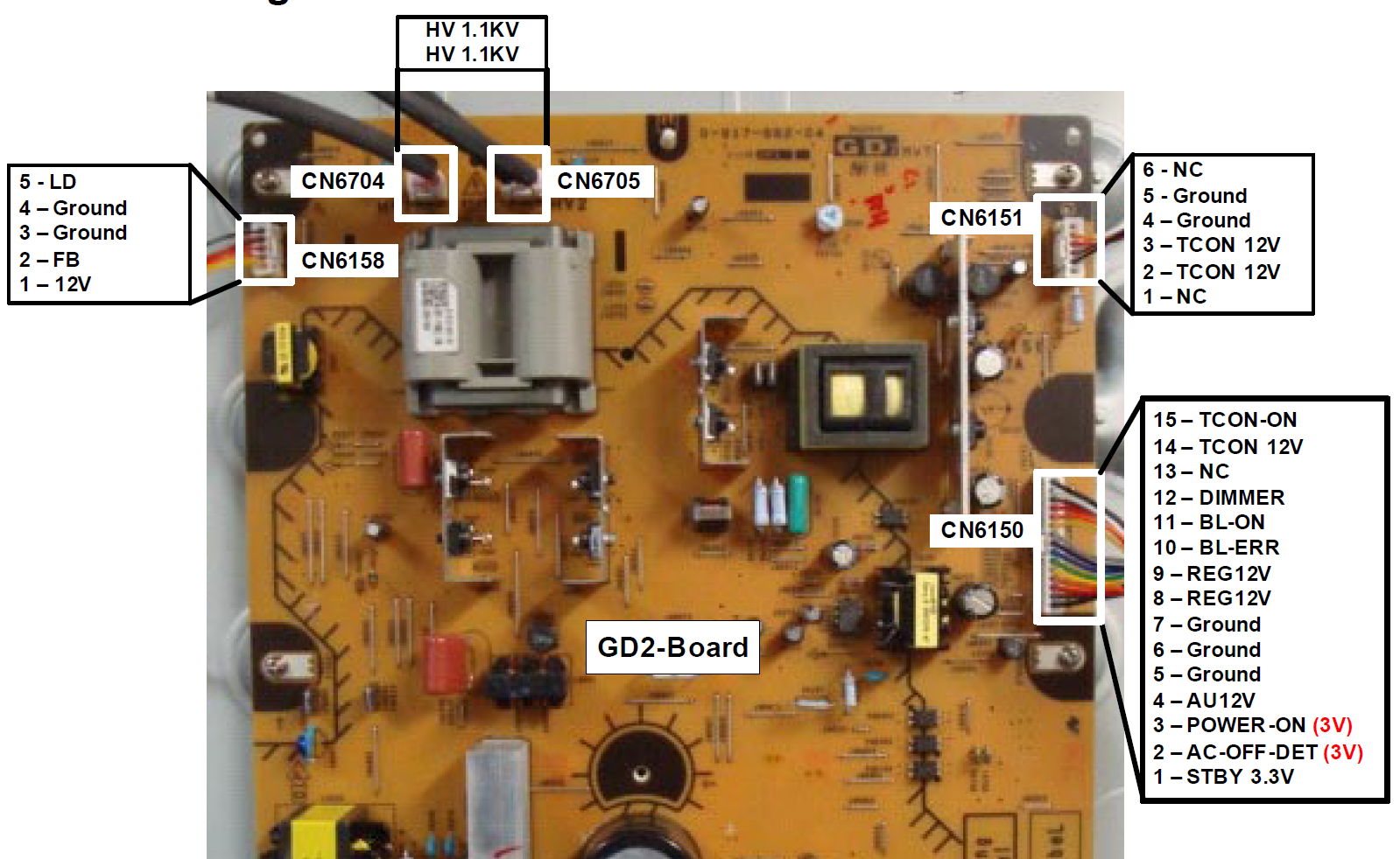

            you might want to do a "nice list" of the labels versus measurement of the connectors of ALL the pins at the power supply at power plugged in and then again at power on button pushed. NOTE: you might have to watch some of those pins "quickly" at they may change "state" rapidly. It would appear from your first "description" you are missing 12v everywhere.... or could be your oversight. :-)

              Thanks. The short list of voltages are everything that I could measure on the PS board. All the rest are 0 (+/- few mV)
              STBY 3.3 V is present as 3.248V
              POWER-ON is 3.23 V
              BL-ERR is 3.2 V
              All other pins on the board are 0 V

                Maybe test powerboard with mainboard unplugged, using resistor/s, see if your other voltages come back.

                    OK... so you were watching 12v reg while you pressed power on to see if it ever changes?
                    IF it never does anything, then that should be where your focus is... tracing the 12v in the power supply circuit toward some regulator to see if that regulator is "good" and has got what is needed to do its regulation.
                    Of course, having a BL-ER is not likely to help anything... since that I believe that is sent to the main board. Bad inverter / tube?
                    Probably since the inverter likely has NO 12v going to it either, its "logic" can't help but set the bl-er... maybe.

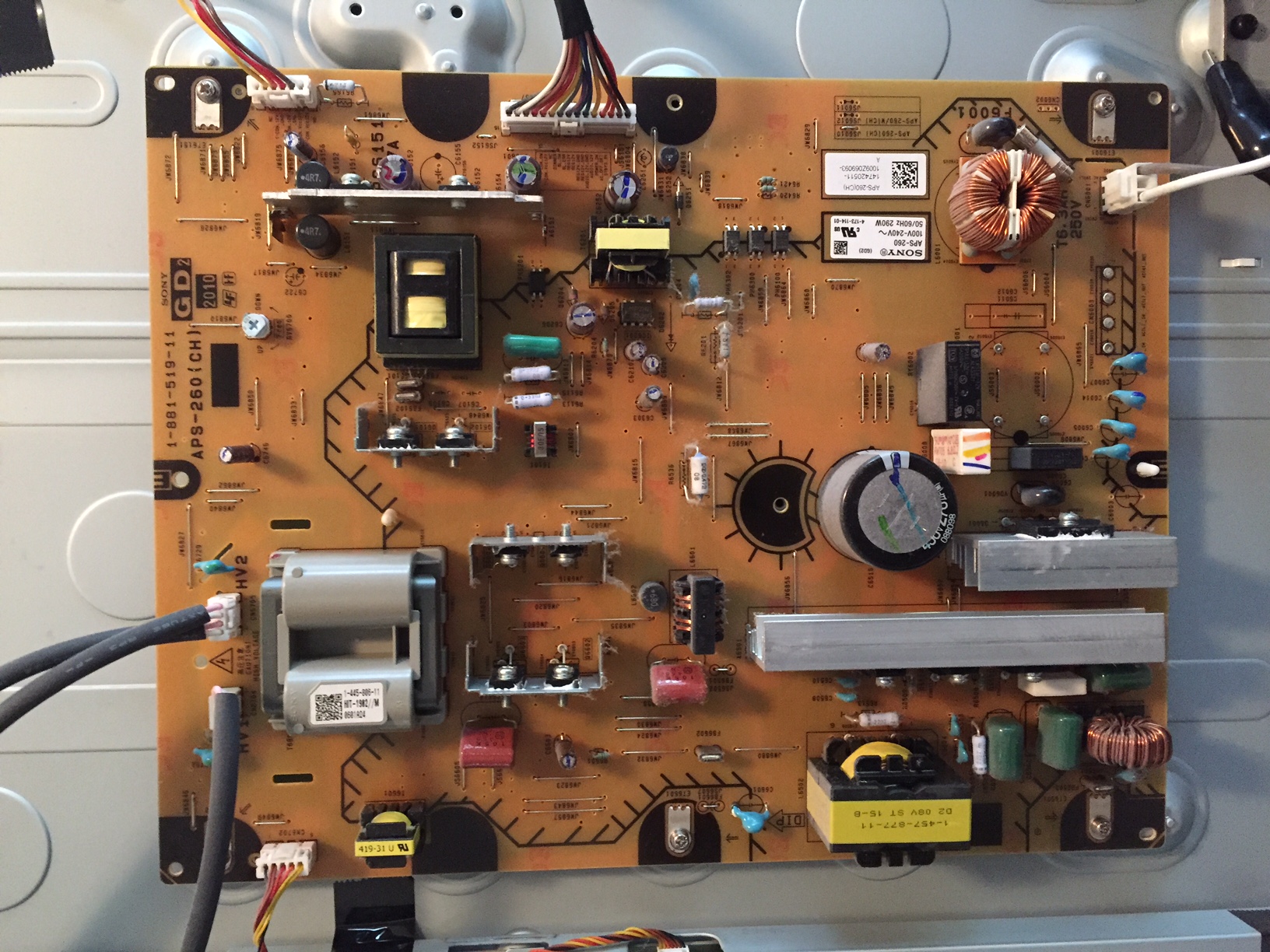

                      1) So this is not the picture of your board?
                      2) Show us the pictures of YOUR board and the pictures of the fusible resistor R6536, there should be lots of printing on that body of that resistor R6536. It should be 0.47 Ohms fusible resistor as printed on the body.
                      3) If that fusible resistor has gone open circuit then there will be no 12V, no high Voltage from the inverter section.
                      Is this your board with matching numbers? I do not see U40 printed on the resistor.

                        I need to find out the correct value for the R6536. budm seems to imply that the value of 23.3k is out of spec, and I'm asking around for that value. If indeed it's off, then I'll get the repair kit for $16.xx from ShopJimmy and will attempt a board repair.

                          If actually look at R6536, you will see the value printed right on that body of the resistor if we are looking at the correct board. read post #11.
                            Shopjimmy:
                            https://www.shopjimmy.com/sony-1-474...er-supply.htm#

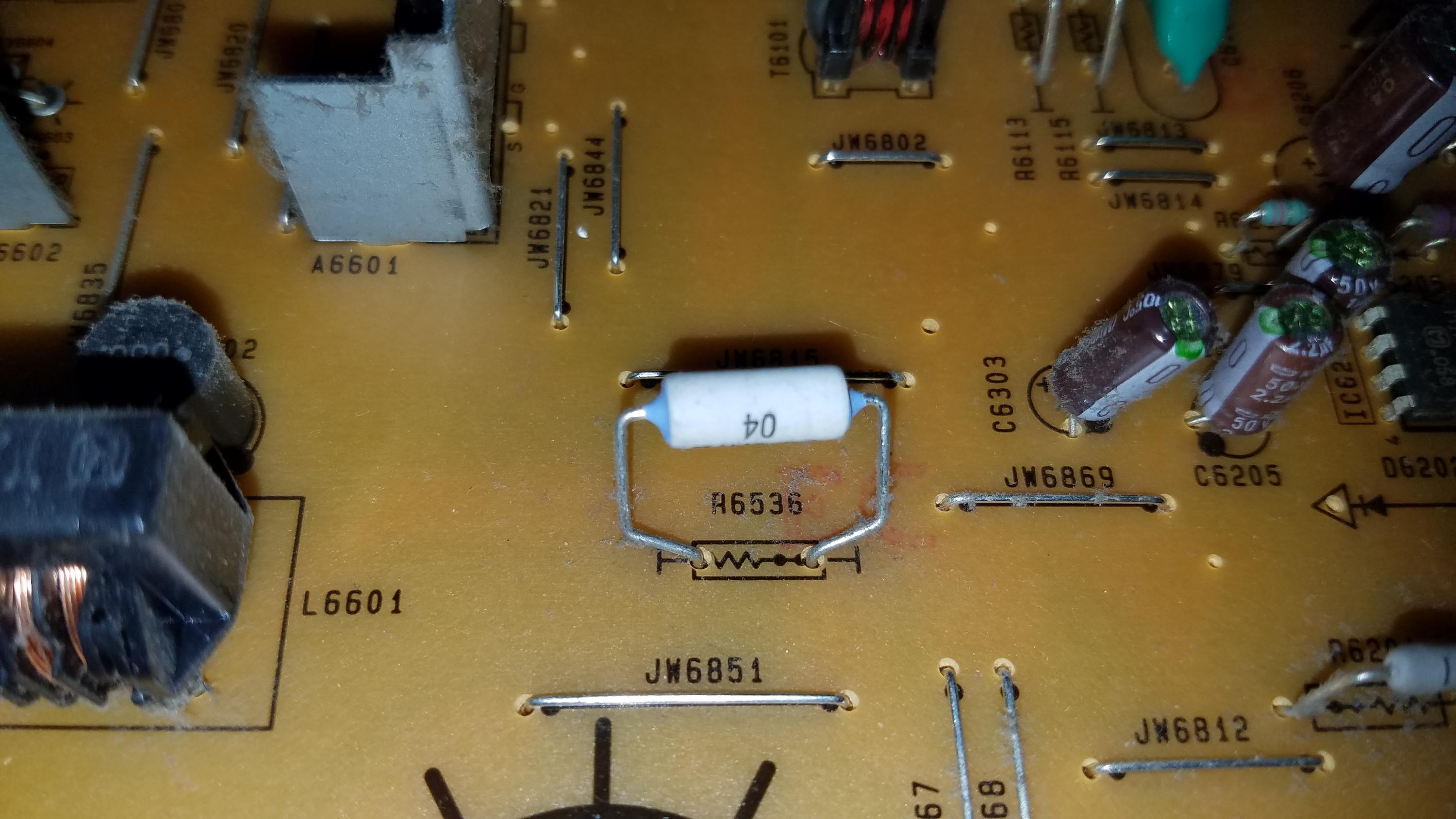

                            1) No this is not a picture of my boards - I found them on another post here - They're the same part layout and numbers and TV model, but not my actual TV.
                            2) Attached is my board - I'll get a better photo. U40 is the only thing I can see on that resistor.. I'll get one of the kids to look as my eyesight is not what it used to be
                            3) Fusible resistor value is 23.3k - Kit states that it will work with TVs that have this resistor open. 23.3k is definitely not open. Will the kit still be a good investment?

                              It is open, it shows 23K on meter because it is still connected in the circuit, so take it out and show us what is printed on that white body of the fusible resistor.
                              You need to test the MOSFETs in the inverter section and in the 12V section to see if any of them shorted out not which will cause the resistor to blow.

                                Here are photos of the body - Yes, out of circuit, it's reading open.
                                I ordered the shopjimmy kit.. will update when I get it.
                                Thank you

                                  R6536 is a a 0.47Ω 1/2 watt RF, if open check for shorted Q6101 & Q6102
