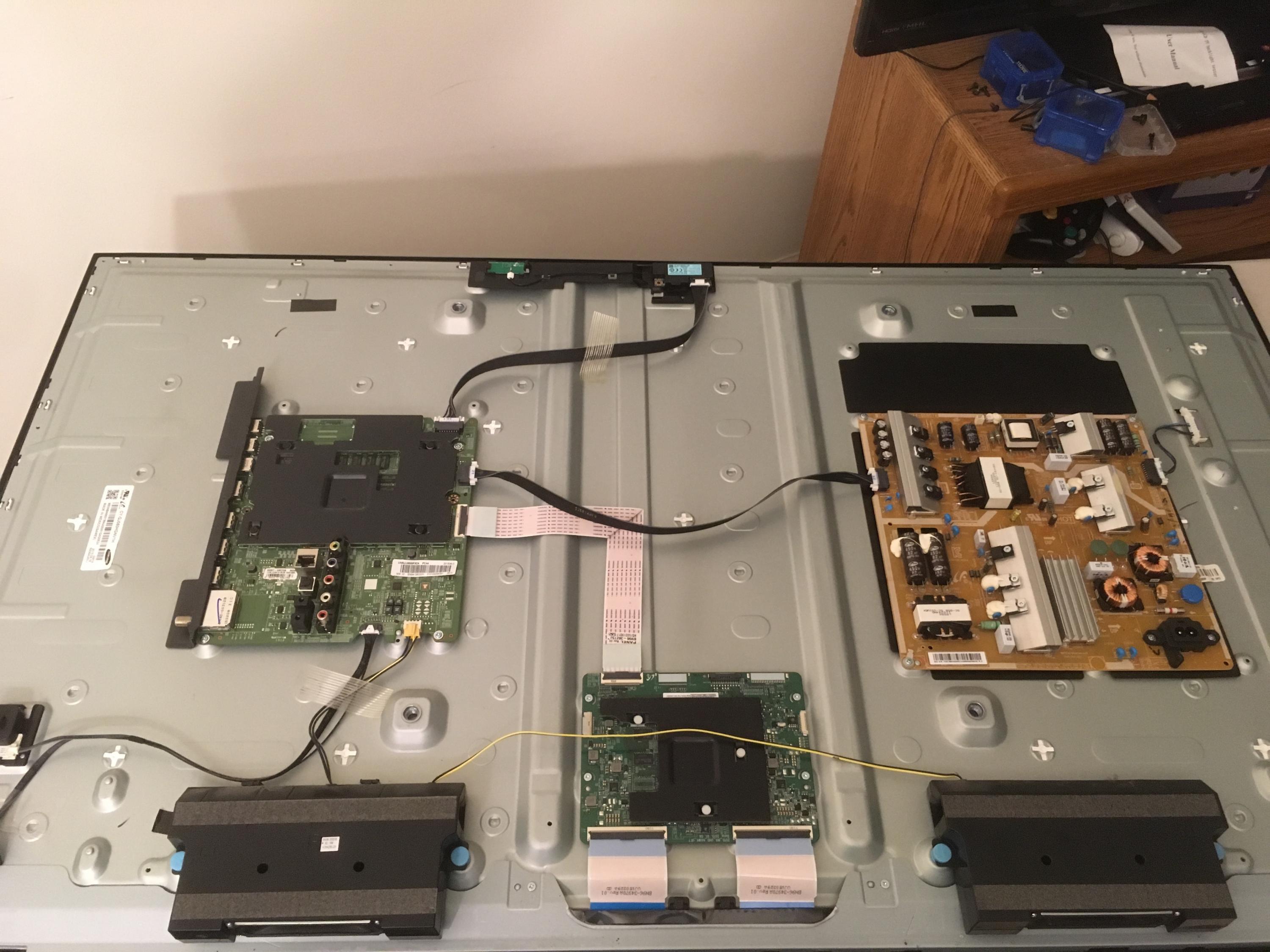

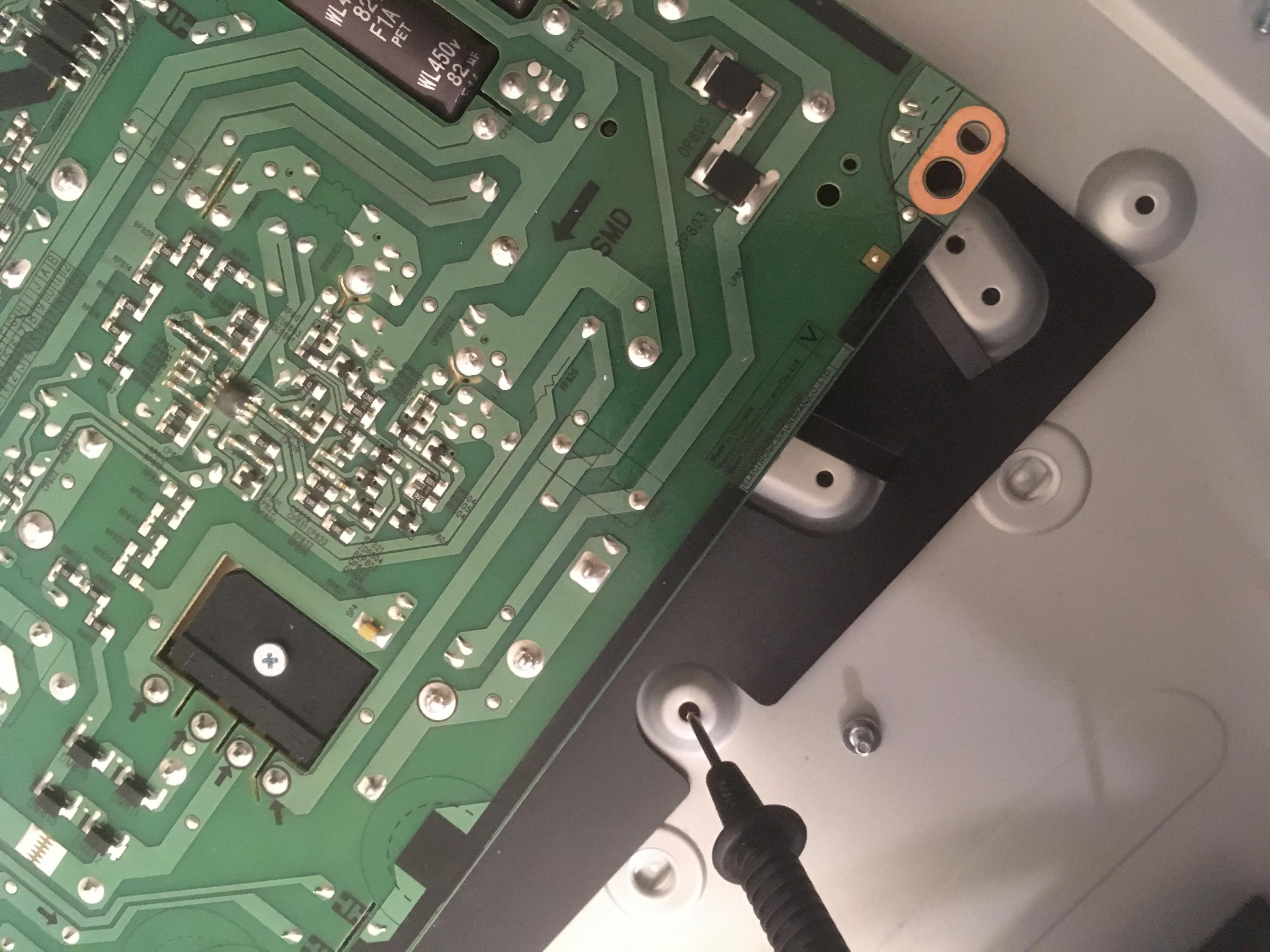

    ok Diah wanted some additional pictures. Including complete set up.
    as far as BudM's post...i might've tested incorrectly now that I saw the picture posted. As I Was testing it ...like my 2nd picture - only demonstration purpose there.

      Re: Samsung UHD UN50JU6500
      Ok, those are some swell pictures, did you do the requested tests tho?

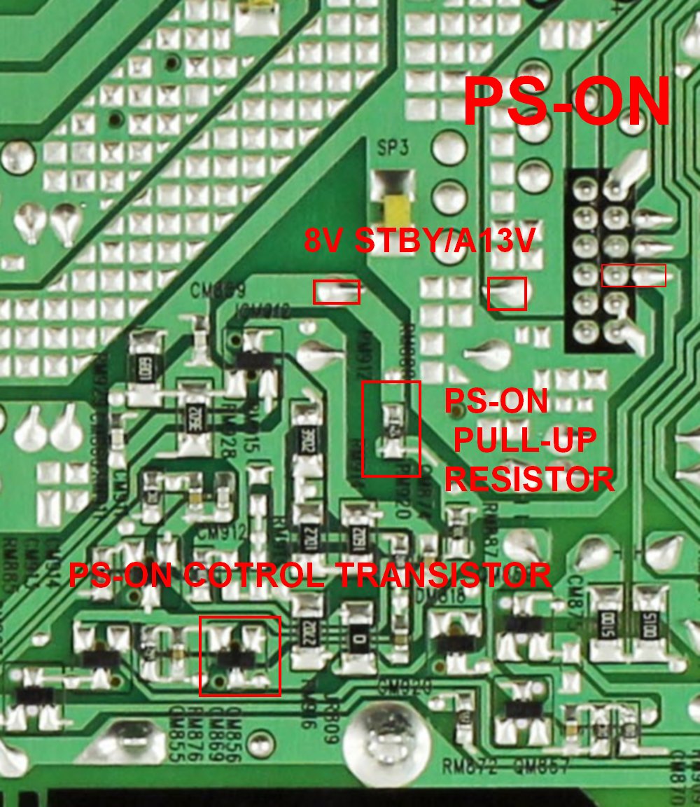

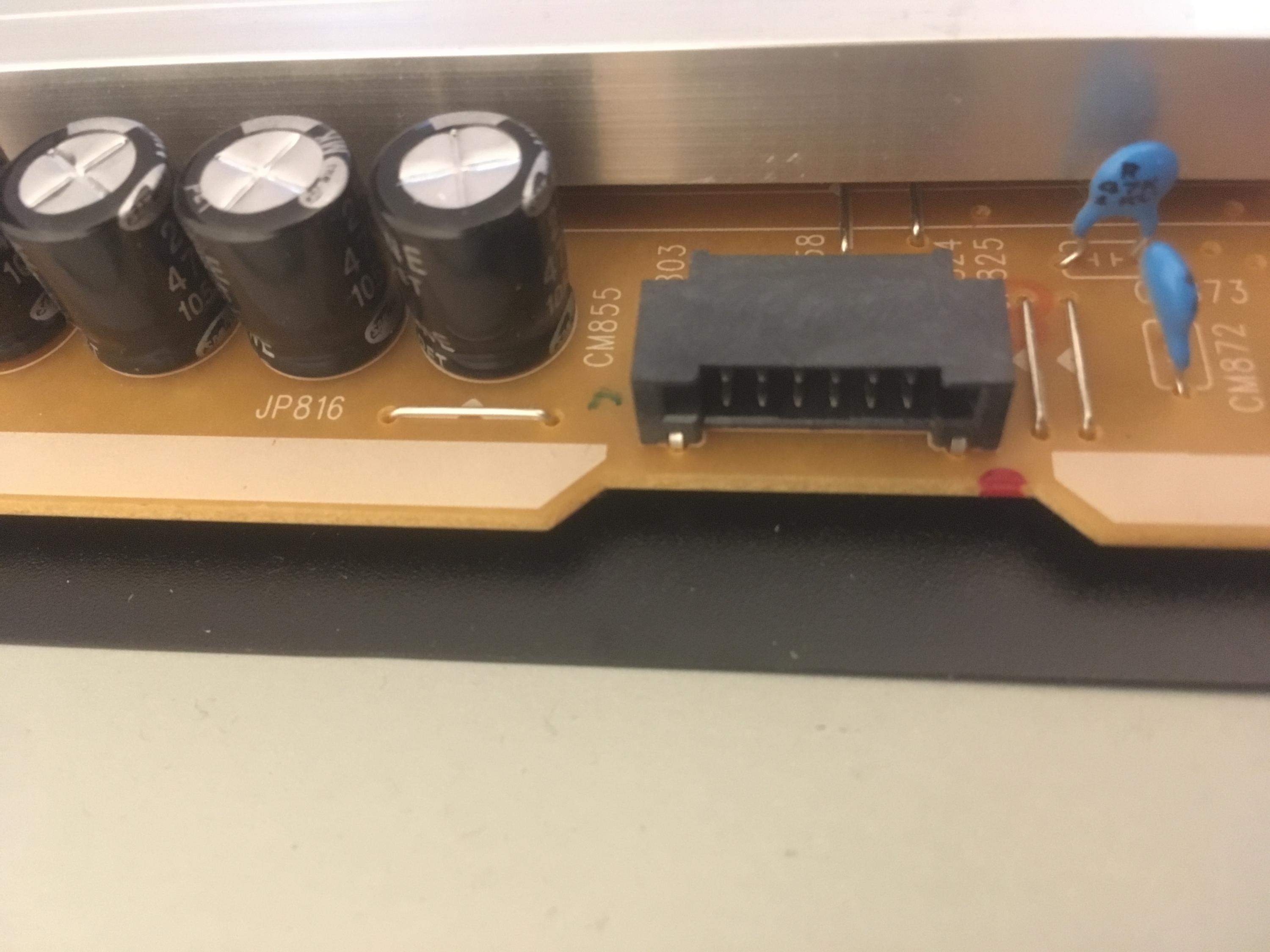

        Connector CNM803 pin 8 (PWR-ON/PS-ON) has pull-up resistor for self-test function. If the PS-ON is not present, the A13V will be about 8V, when the Main board board is disconnected (PS-ON pin on the main board side has open Collector circuit) from the Main board, the PS-ON will be pull up high which will cause the Voltage at A13V pins to go from 8V to 13V, at the same time the PFC boosted Voltage on the main cap will jump up from 160VDC to about 380 ~ 400VDC.
        So What are the Voltages at the CNM803 when main board is NOT connected? The result will tell us which control pins have pull-up resistors or not.

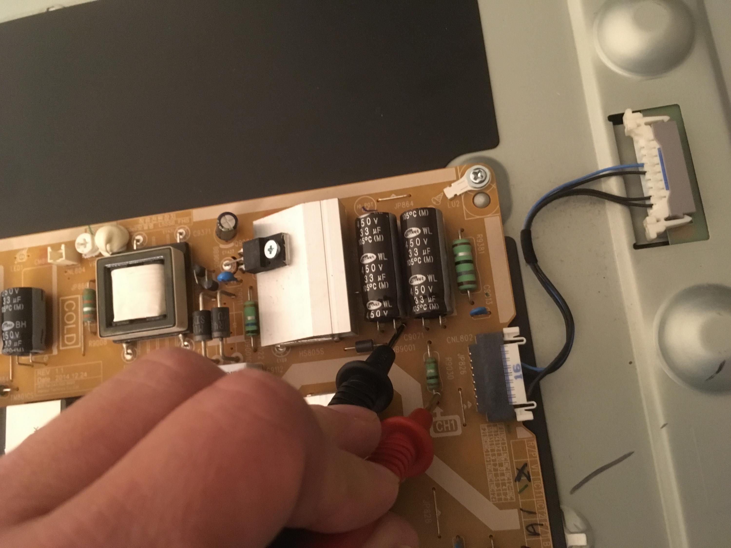

        I attempted to test the A13v standby by flipping the PSU board over and unplugging the LED and Main board. However, When I tested the A13V, i didn't get any voltage there or at the PS-ON (where boxed on your pic) when it was plugged into the outlet.
        The PS-ON Pull-up resistor showed no voltage either.

          What did you use for meter ground? If now you do not even have 8V standby Voltage then some thing must have got worst since you did have 13V when all the boards are connected, it is measurement error.
          Meter is set correctly?

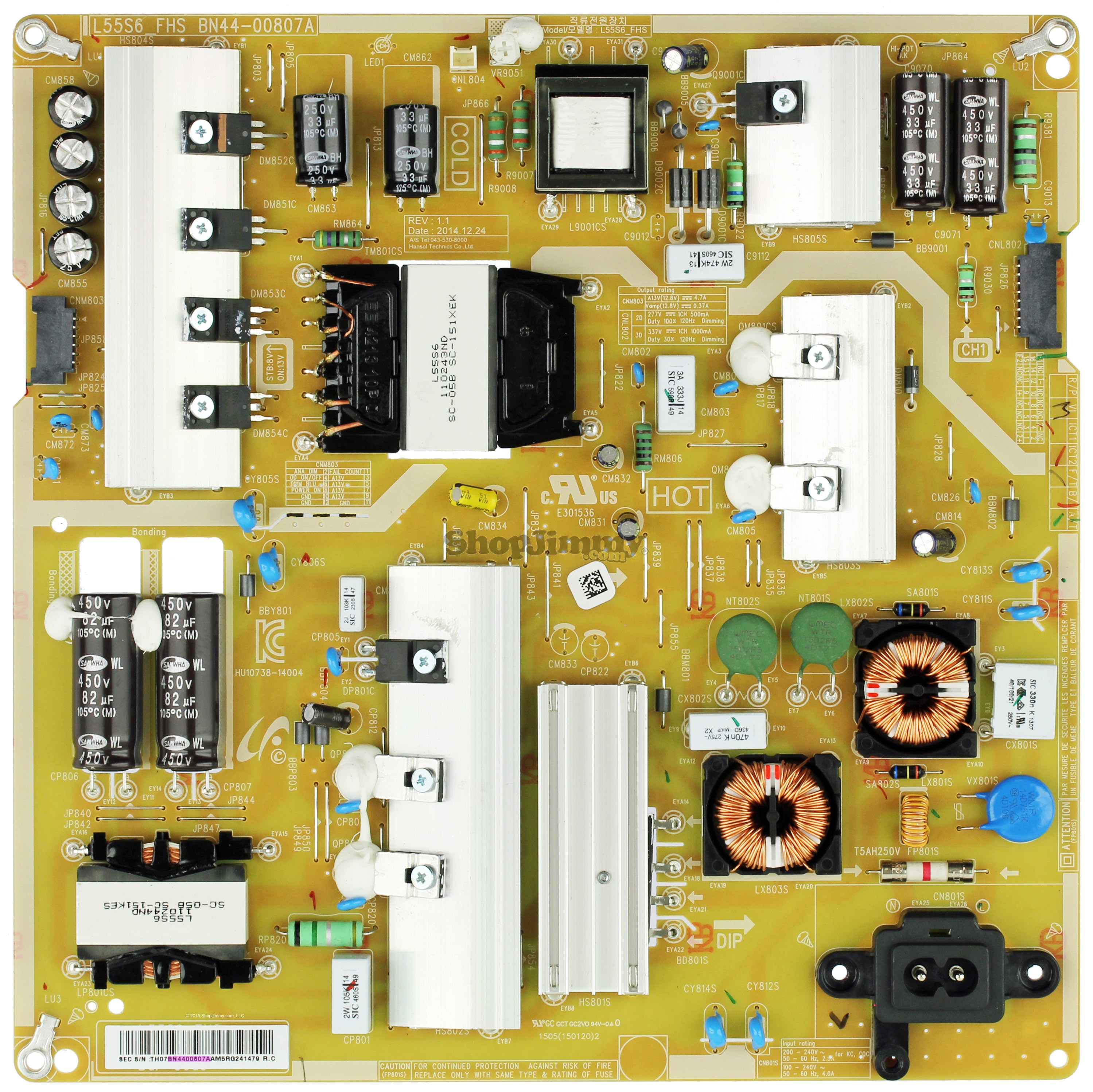

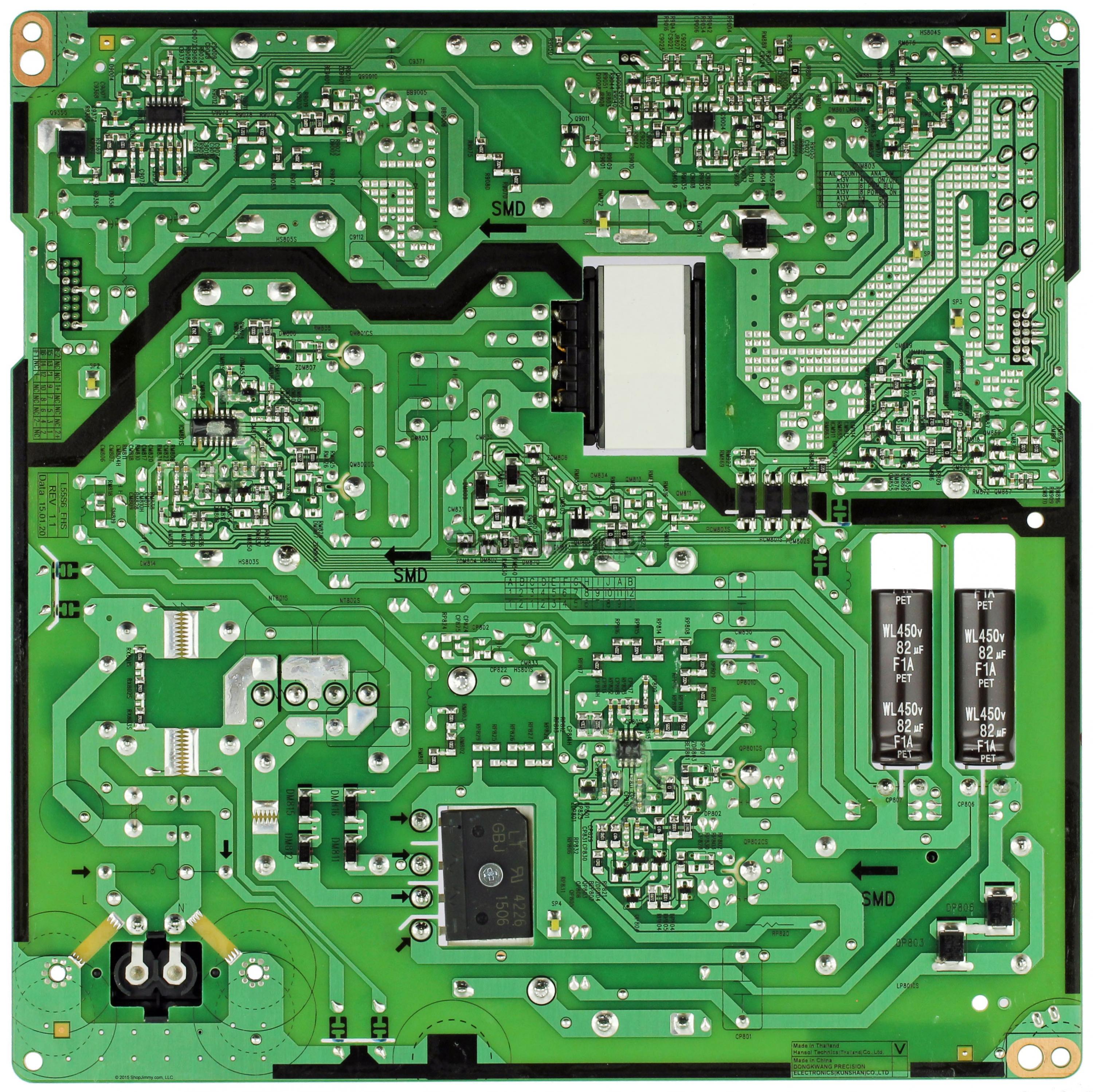

            Power supply/LED driver board P/N BN44-00807A.
            https://www.shopjimmy.com/samsung-bn...led-board.htm#

              I had the Red lead on the A13V and the black lead on the TV metal chassis. Meter was set to 20V DC as was looking for low voltage of 8 and 13 v.
                Since the board is no longer mounted to the metal chassis you cannot use the chassis as the ground for the meter, you have to use the ground pin on the connector that goes to the main board instead.
                You should also use bigger insulation sheet so you do not accidentally short out the live circuit to the chassis, I.E. the heatsinks. Also do not touch any thing in the hot deadly side of the circuit, you should at least plug the TV into the GFCI outlet.
                BTW, you do have tools to do surface mounted component repair, correct?
                    from yours first POST you have all voltage correct A13 13V. ps on ok. only you have LED indicator blinking as there fault at LED BL and you found 5 bad LED.
                    my question to you.. you replaced whole strips or just only one which had the 5 bad LED. could you show me the strips you changed the label of it and the OLD Original one..?
                    thought the problem you have now just happened direct after replacing LED.. need to go back to this point to check this replacement. to avoid more damage

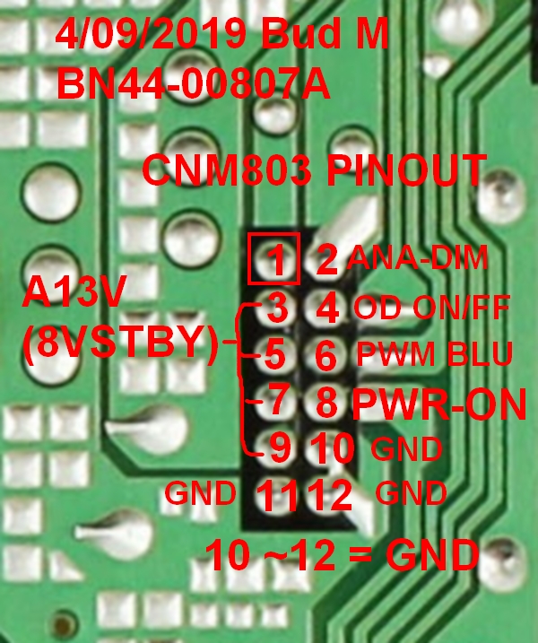

                                  1) Your post #34 (Yes I'm still getting the same voltages as post#3.) you indicated that you get the same reading as in post #3 without having the main board connected as instructed in my step #1 (Disconnect power supply board from main board), step #2 take the reading of all the pin of the power supply connector that goes to the main board.
                                  Your Post #3 readings:
                                  Pin Label Voltage
                                  pin 1 Fail Count 0 V
                                  pin 2 ANA Dim 3 V
                                  pin 3 A13v 13 V
                                  pin 4 OD On/OFF 3 V
                                  Pin 5 A13v 13 V
                                  pin 6 PWN Blu 3 V
                                  pin 7 A13v 13 V
                                  pin 8 Power On 3 V
                                  pin 9 A13 v 13V
                                  Pin 10 Ground
                                  pin 11 Ground
                                  pin 12 Ground
                                  2) Now your post #35 now you indicated:
                                  "Ok I did the A13V which fluctuated from 4v to 8V. the 8V standby side had 0 Volts.
                                  The Power-on with ground read little either 0.7 or 0 Volts."
                                  Your data does not make any sense to me. Post #34 you get steady Voltages, now post #35 you do not. Hard to help with bad data. The thread is now at #36.
                                  May be it is time to buy LED tester and the working power supply board to try.

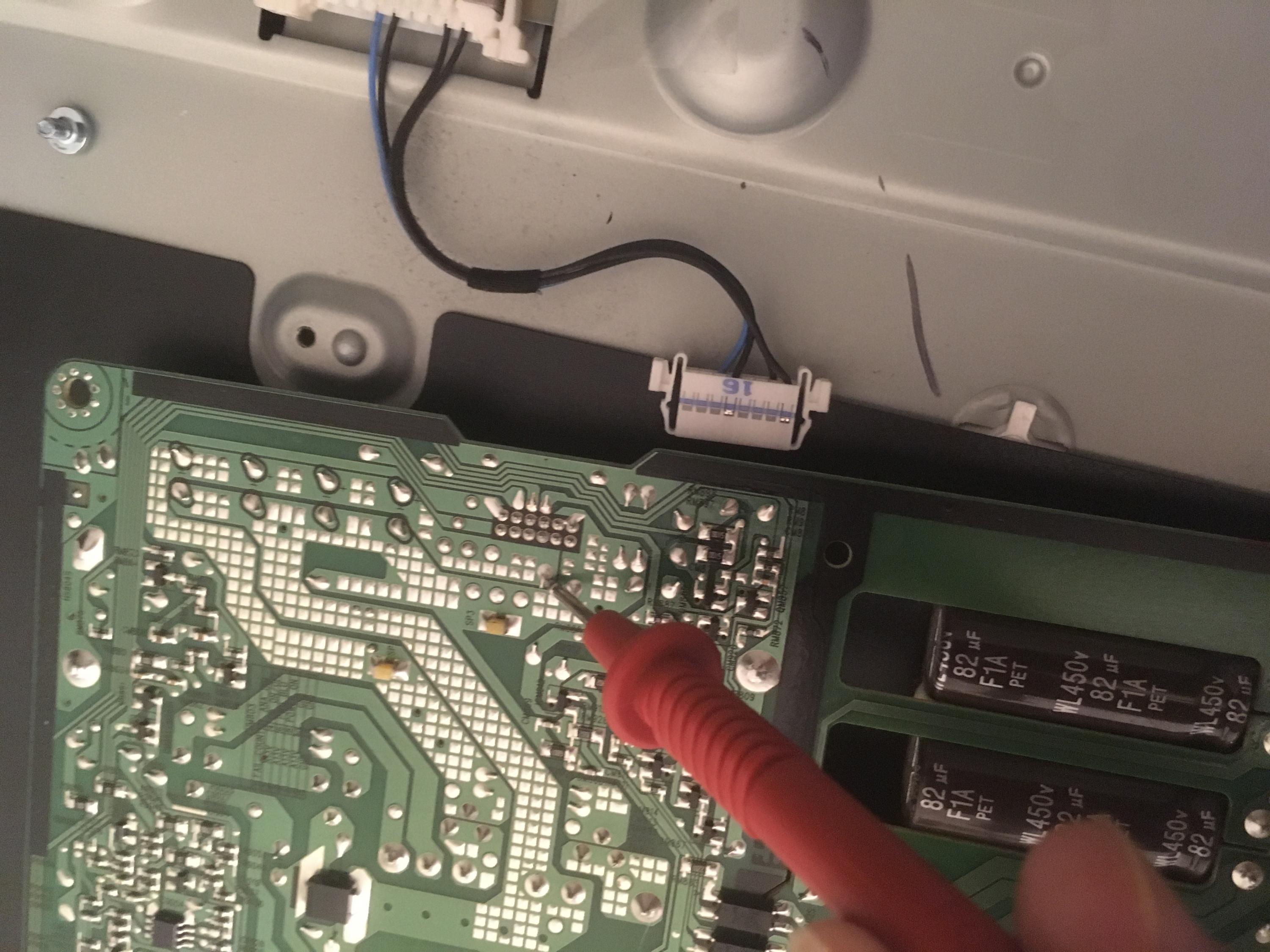

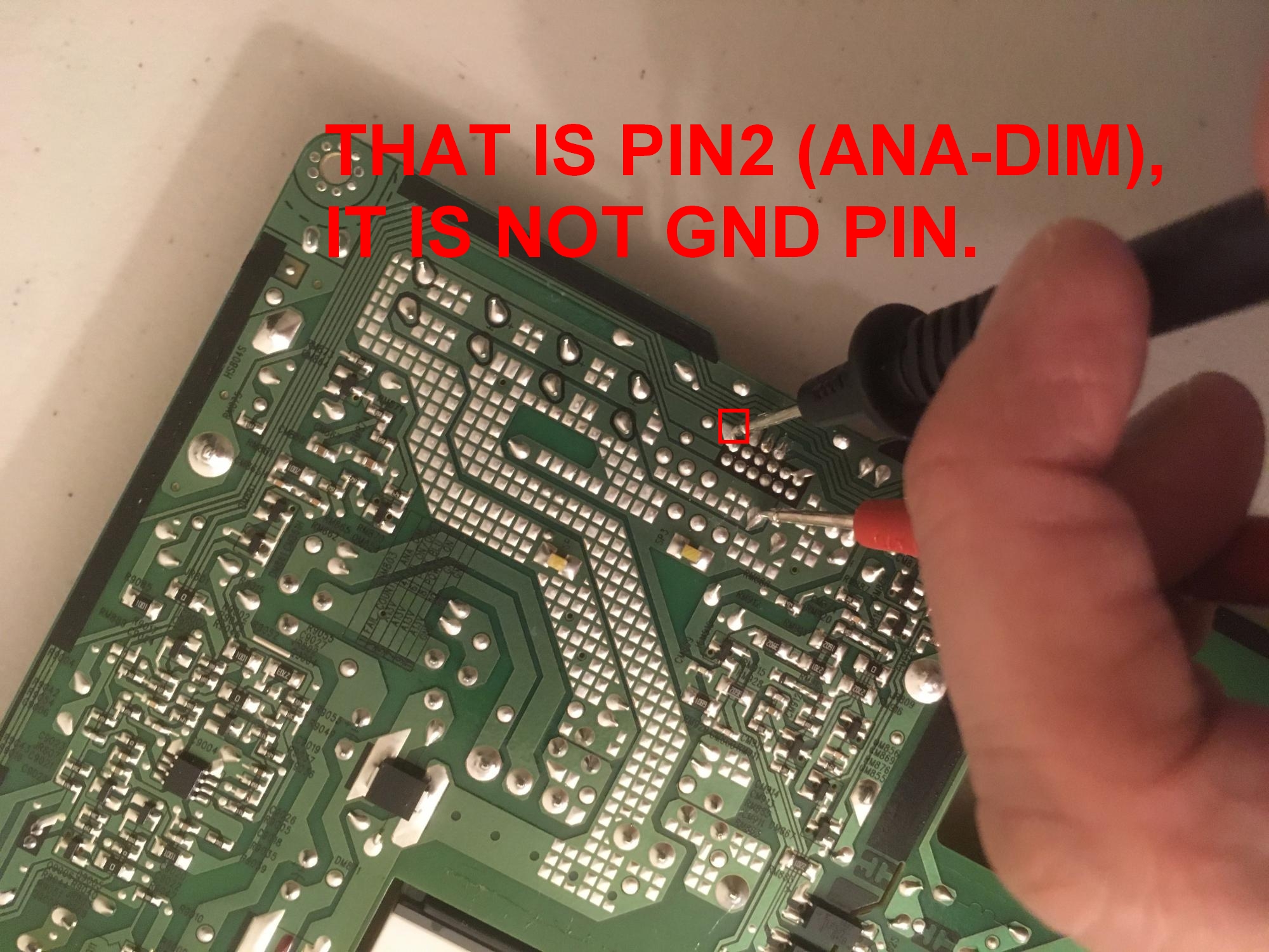

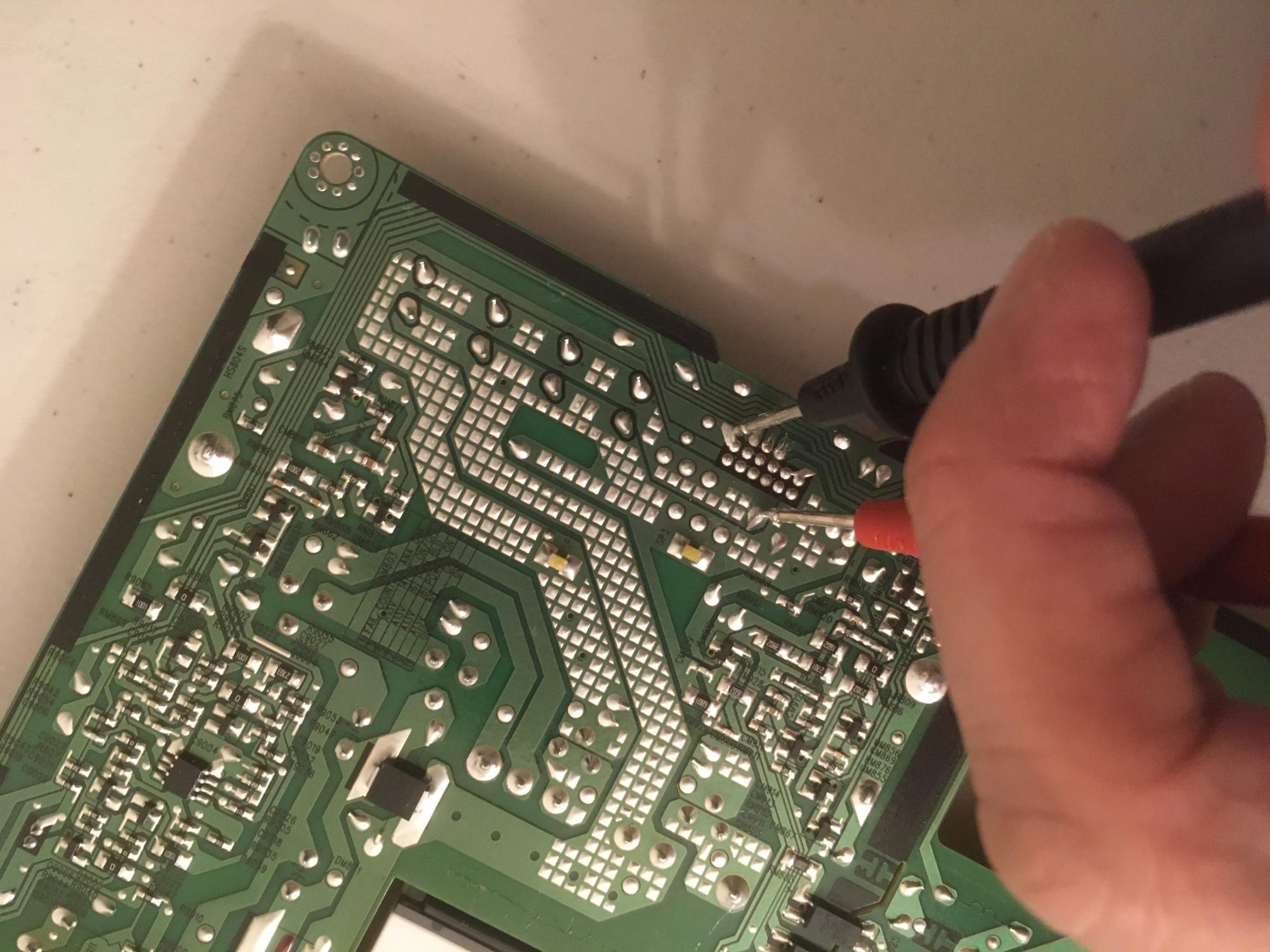

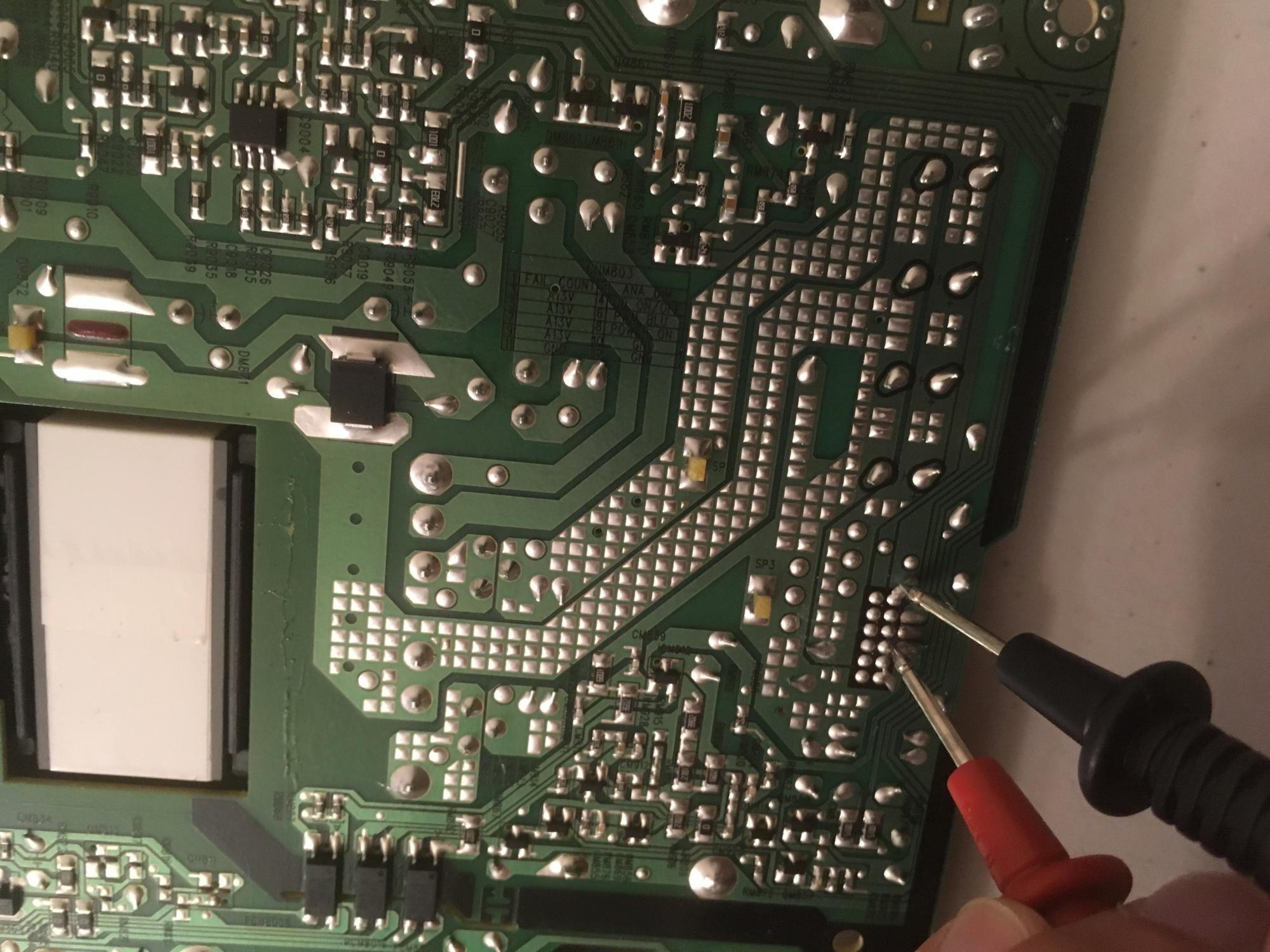

                                    This was with the PSU Separated from the LED and Main and just plugged into AC and PSU Flipped over. I was testing based on your picture you posted and that's what I got.
                                    so the one pic. Was ground to A13V which was fluctuating form 4-8 Volts.
                                    The 2nd pic was ground to the PS-ON which was reading pretty much 0 V. Maybe bad placement or not grounded correctly there.

                                      Based on your last two pictures (https://www.badcaps.net/forum/attach...5&d=1554867815, https://www.badcaps.net/forum/attach...4&d=1554867815) I have no idea why you have Black probe of the meter on pin 2 which ANA-DIM, it is not Ground pin.
                                      I think you should start it over since you are using pin 2 for the ground point for your meter based on your pictures.
                                      Pictures provided by shopjimmy.

                                          Ok I didn't realize I had the black lead on pin 2 (which I thought was pin 1). I tested it briefly this morning and got much better numbers similar to post#3. I will post the voltages and variance when I get back from work and if not too tired lol.
