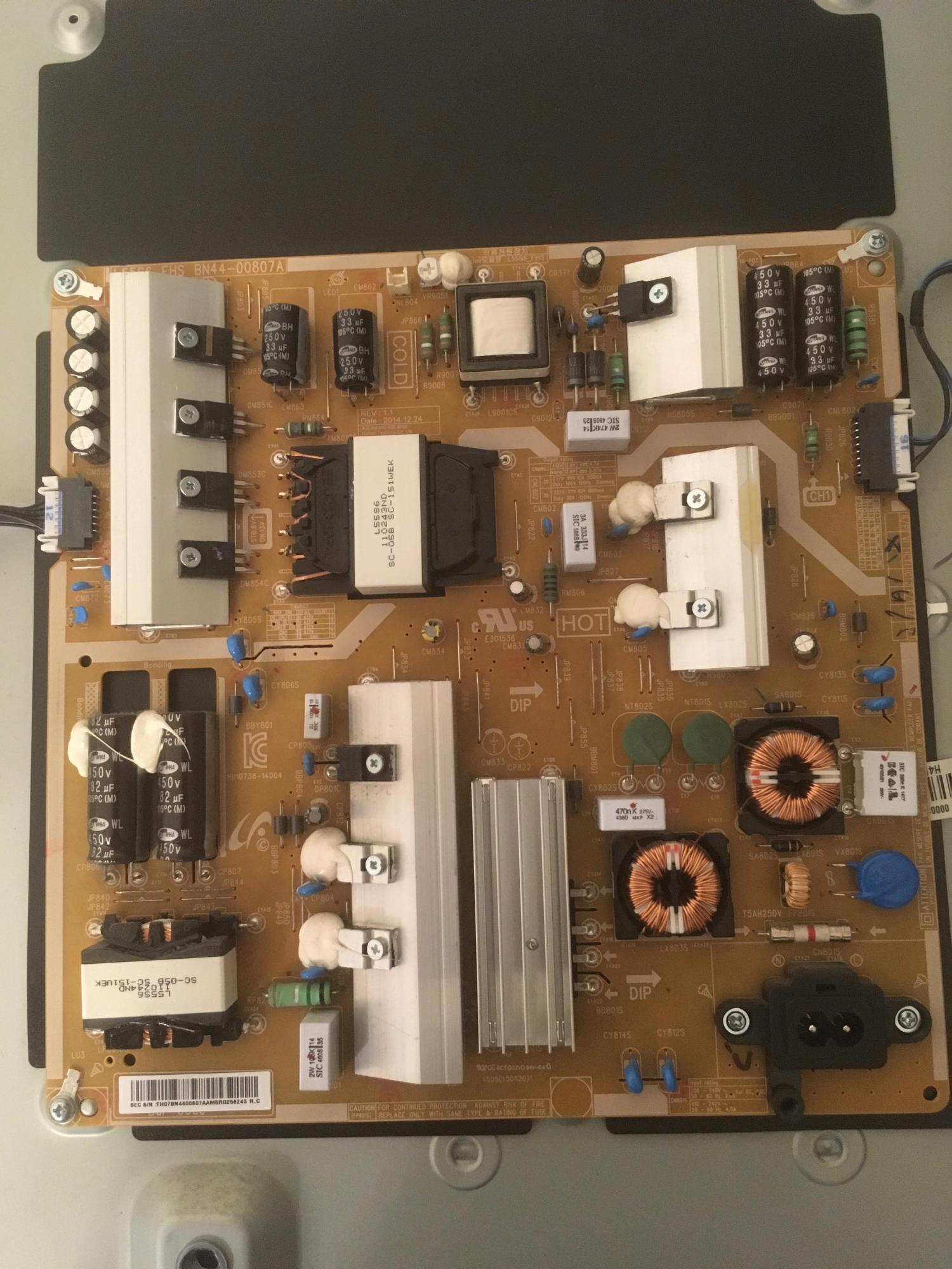

    Got this TV from a person. It does show some power with the LED lighting up and blinking LED indicator which continues.
    There is no backlight when plugged in or attempted power on.
    No image with flashlight.
    Interestingly, the Main board optical port flashes, as well as the T-con(blu lights) syncing together i believe.
    The Remote and power button on the TV seem to not really effect the Power, so I'm thinking the Main board.
    Checking the power board pin voltages.
    Pins To the main board.
    Pins 3,5,7,9 all register about 13 v
    Pins 2,4,6,8 register about 3 v
    Pin 1,10,12,12 all show no voltage
    Pins to LEDS
    Pin 1 registers 100 v with the main board unplugged from power
    Pin 1 registers 200 v with the main board plugged in.
    All other pins show no power flowing through them.
    So before I break down the TV to look at the LEDs. Was wondering if there was thoughts that maybe it was the Main board vs the Power supply.
    or anything else that I should check.

            Ok I did find a couple of bad LEDs and replaced All the Strips(From Shopjimmy). However, with the Main board unplugged, The LED lights are rhythmicly flashing although very dim.
            If i plugged in Main board as well. Then I get a dim flash and then a brighter flash and then off again more rhythmic.
            So Right now I'm thinking Power supply board is bad and either I can hunt for the bad component or just buy a new one.

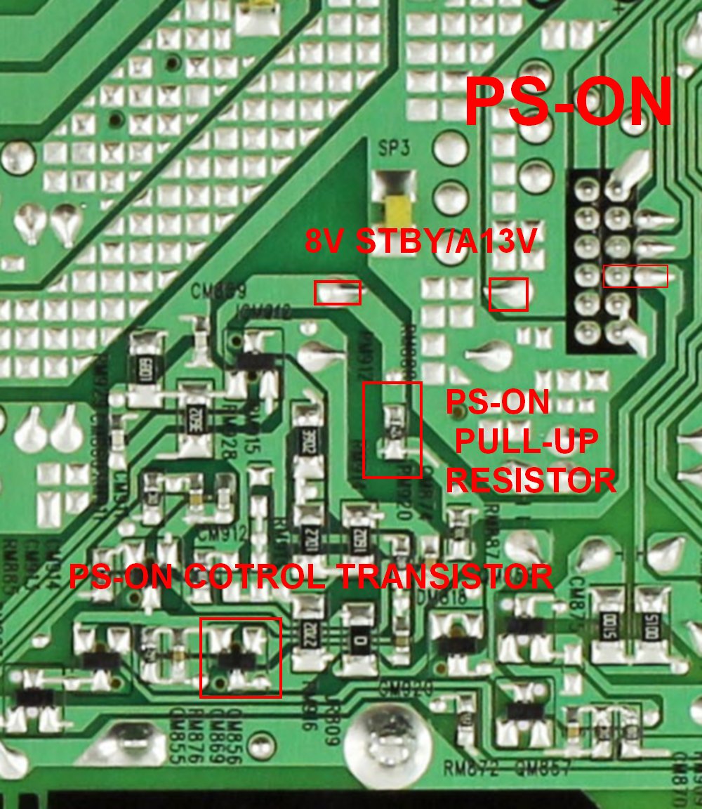

                            This TV has all the LED strips connected in series to form 1 large LED string.
                            Connector CNL802 Pin 1 (2+) is the Anode pin for the #2 LED set, this pin is connected to the Boost converter circuit (puts out 277 or 337 VDC as printed on the board). Pin 4 (2-) which is the Cathode of #2 LED set and it is connected to pin 9 (1+) which is the Anode of the #1 LED set, then pin 12 (1-) is the Cathode of LED #1 set, this pin is returned to circuit ground via MOSFET Q9355 and the current sensing resistor R9381.
                            1) No main board connected to the power supply board.
                            2) Are you still getting the same Voltage on the power supply connector that goes to the main board as reported in post #3?
                            3) TV not plugged into the AC outlet, LED connector in place, SET dc meter to be able to read 400 VDC then put DC meter black lead on the negative leg of C9071, put red probe on the CH1 test point (the leg of the resistor R9030.
                            4) Keep an eye on the meter while plugging the TV into the AC outlet and see how high the Voltage jumps up to and wait 10 seconds to see how low it goes down to.
                            5) Report the result.
                            Power supply/LED driver board P/N BN44-00807A.

                              Re: Samsung UHD UN50JU6500
                              Unable to turn the TV off or on. But plugging in the Power into the AC cause the
                              Voltage from the C9701 and R3090 to cycle from 0 to 183 thereabouts.
                              I do get 3 v to the main board.
                              it appears the Power is cycling up and down.
                              The fuse on the T-con will show 3 v and then go to 0 then back up to 3 v.

                                        OP: Did you test as suggested in my post #14?
                                        Connector CNM803 pin 8 (PWR-ON/PS-ON) has pull-up resistor for self-test function. If the PS-ON is not present, the A13V will be about 8V, when the Main board board is disconnected (PS-ON pin on the main board side has open Collector circuit) from the Main board, the PS-ON will be pull up high which will cause the Voltage at A13V pins to go from 8V to 13V, at the same time the PFC boosted Voltage on the main cap will jump up from 160VDC to about 380 ~ 400VDC.
                                        So What are the Voltages at the CNM803 when main board is NOT connected? The result will tell us which control pins have pull-up resistors or not.
