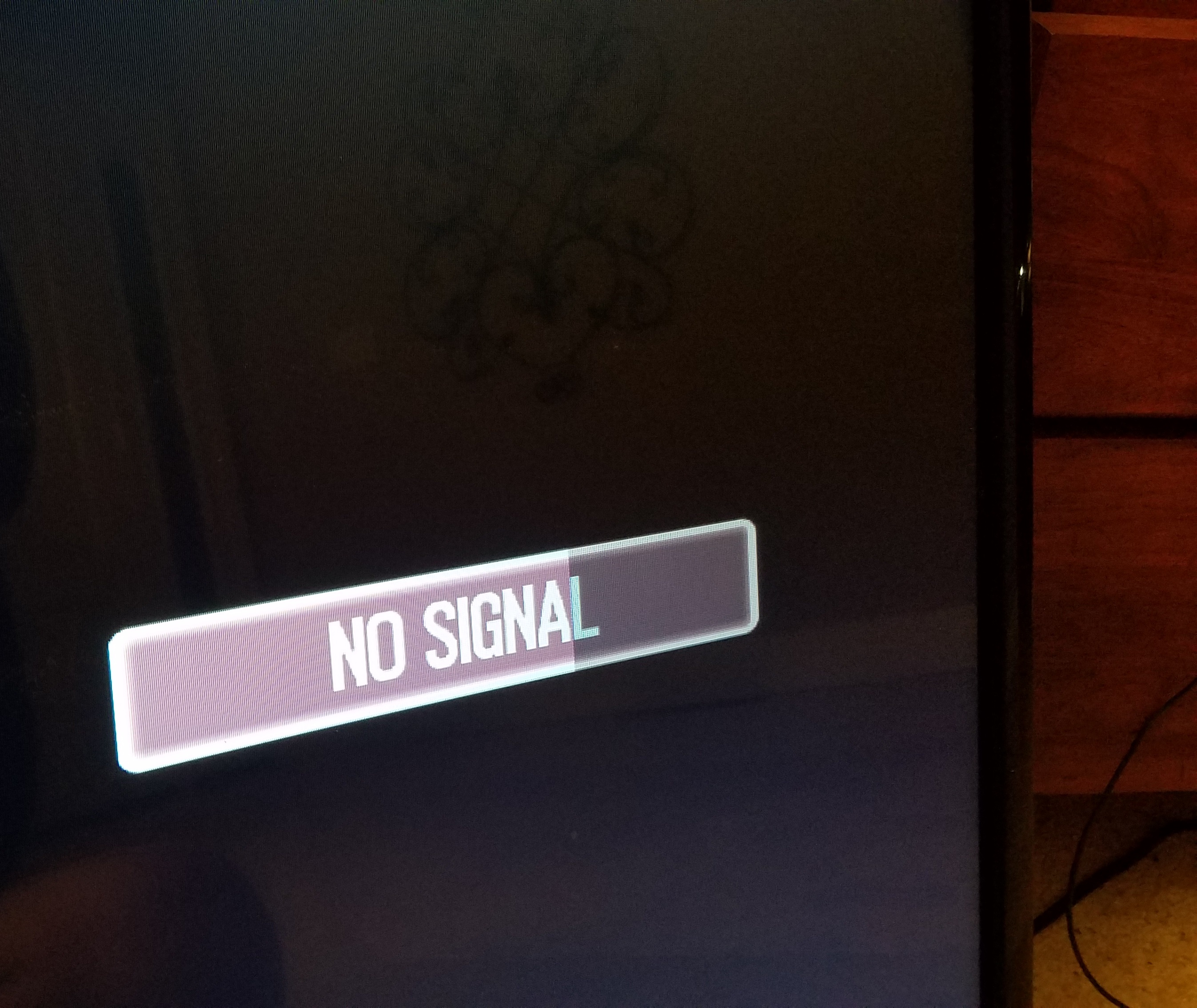

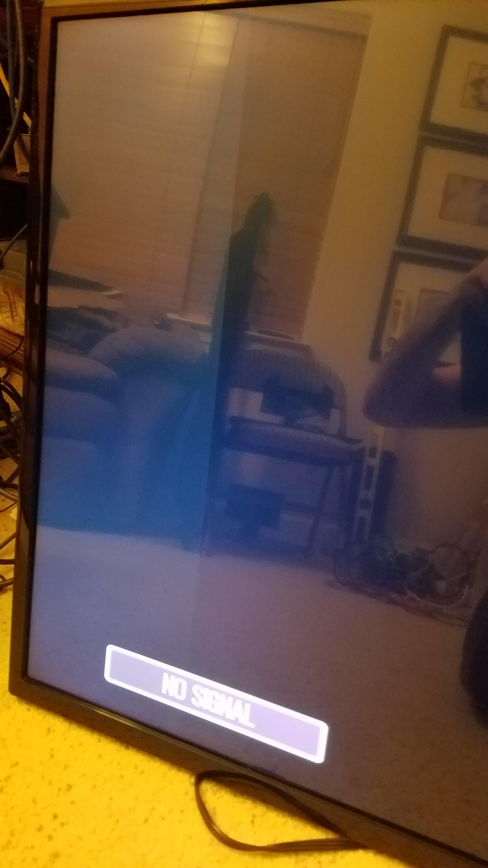

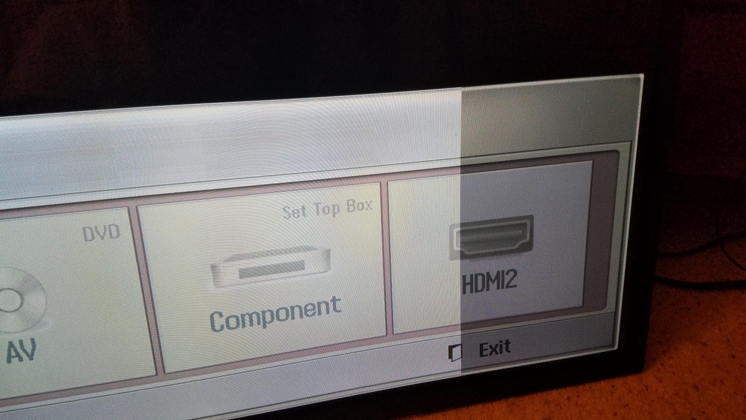

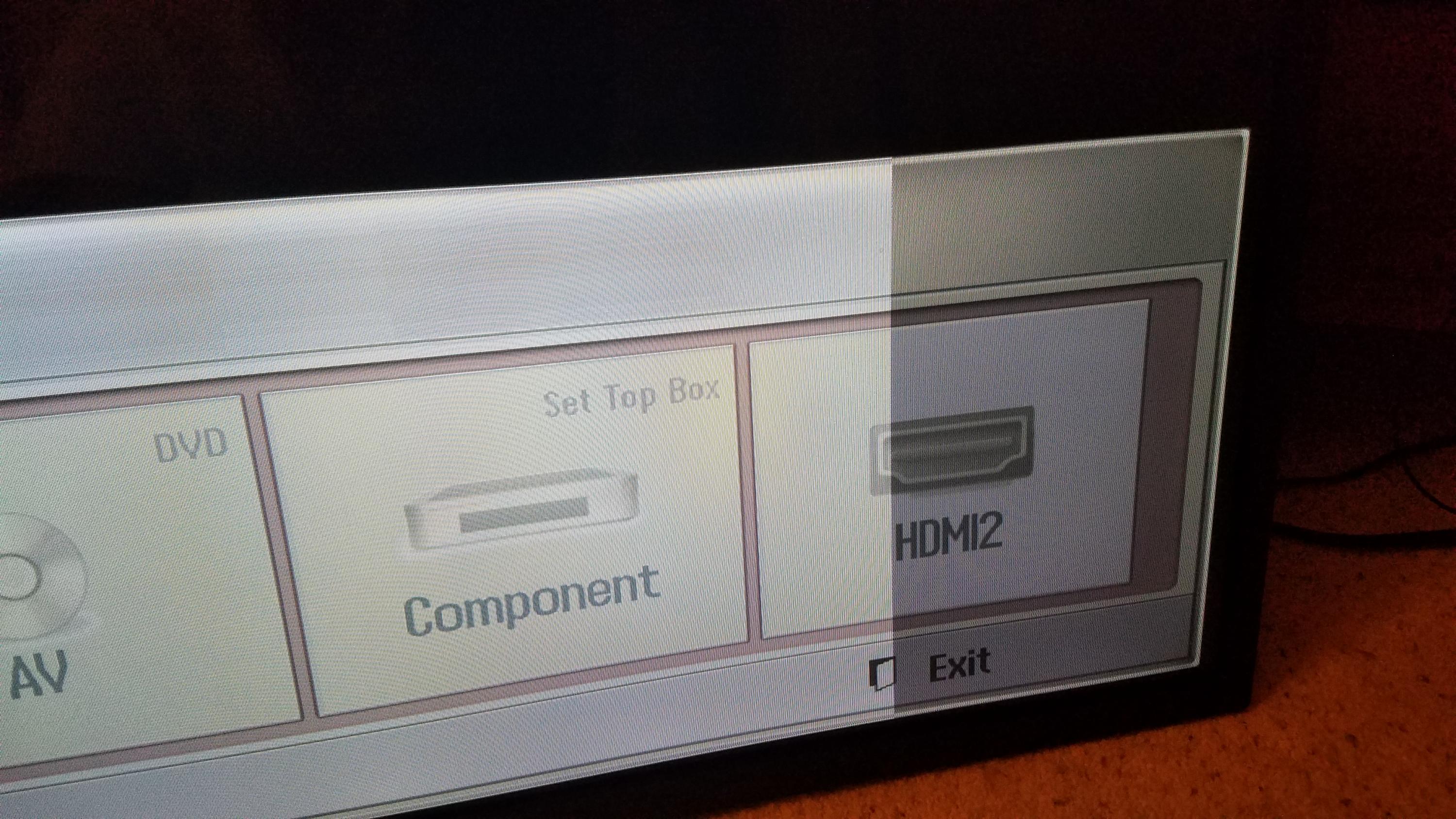

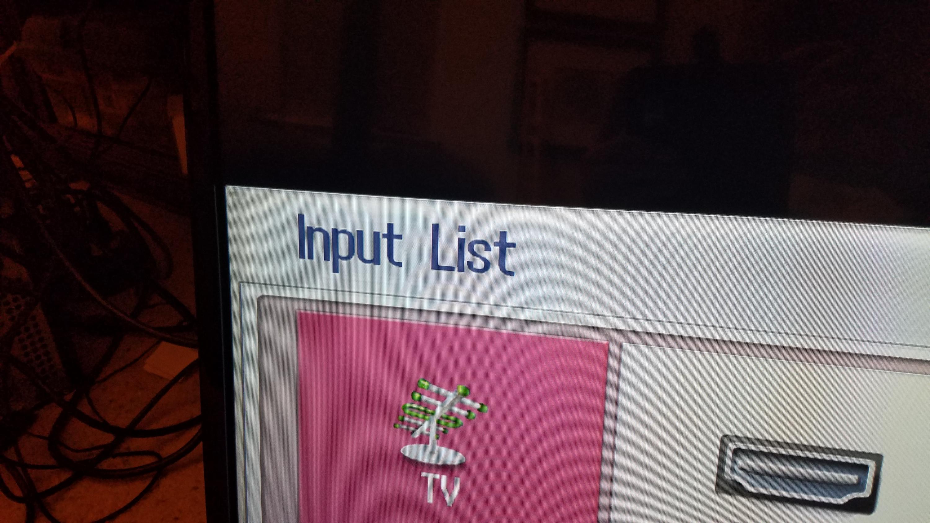

    Just need an opinion on this please?
    Got this smaller 47" TV - initially, no backlight, turns out the connector for the Backlight is not plugged in all the way. Yay - easy fix.
    However the picture quality is off. With black background, about 1/5 or so of the left of the screen is brighter color (Almost like a lighter band) when the picture comes on the left hand side seems ok.
    However when the menu is turned on, the right hand side 1/5 of the screen shows color issues. Seems the overlay vs. picture is shifted and not aligned. See photos. TCON board? this has the usual Main, TCON and PS boards.

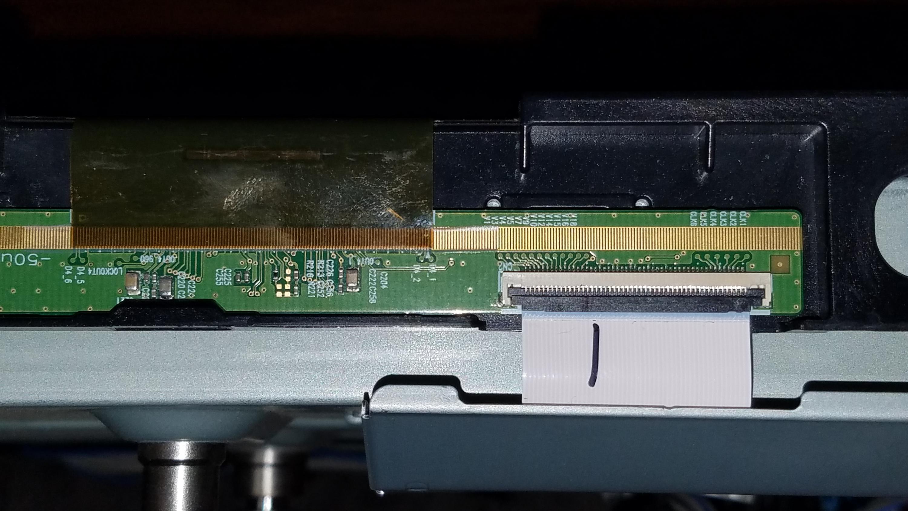

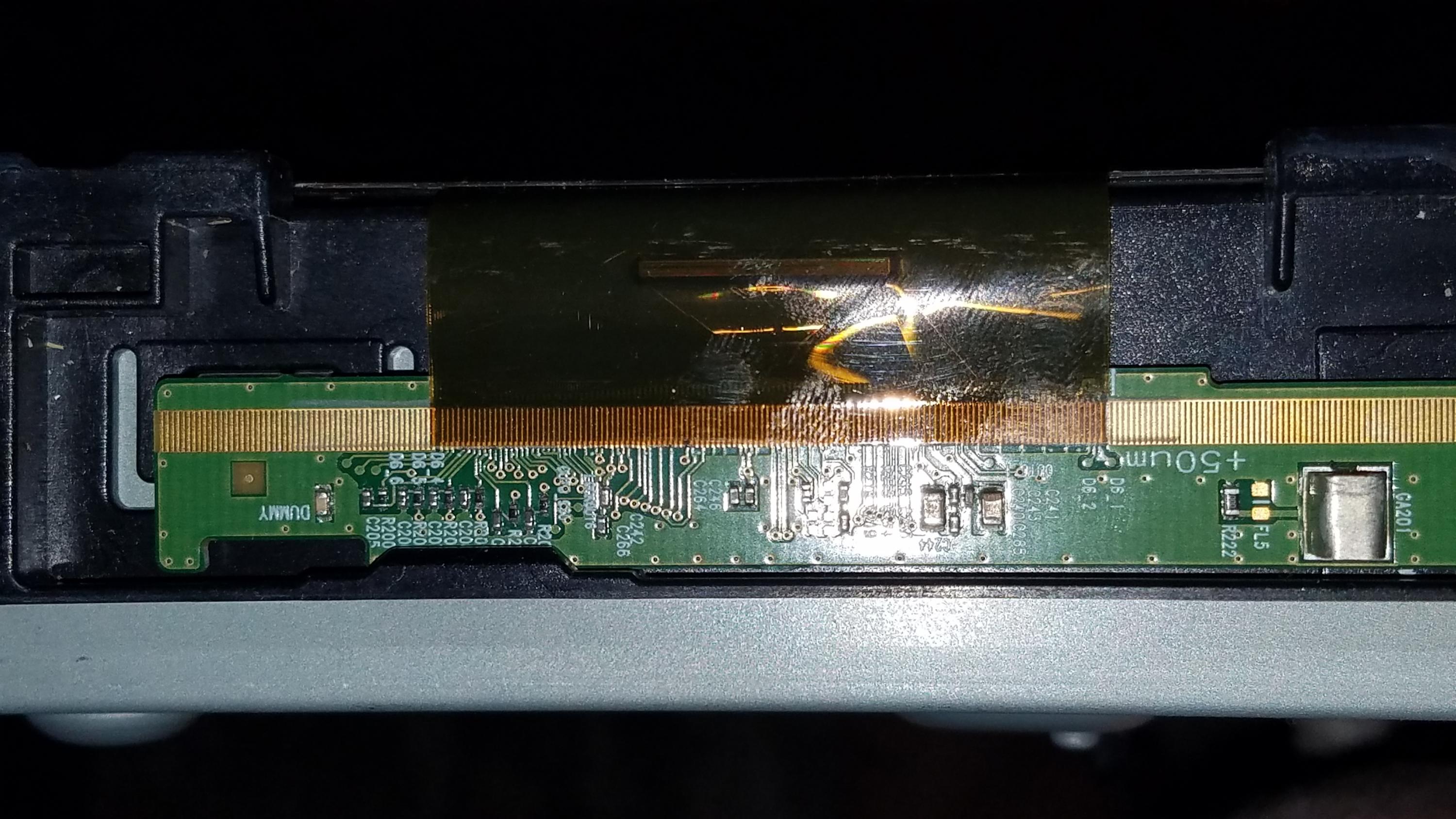

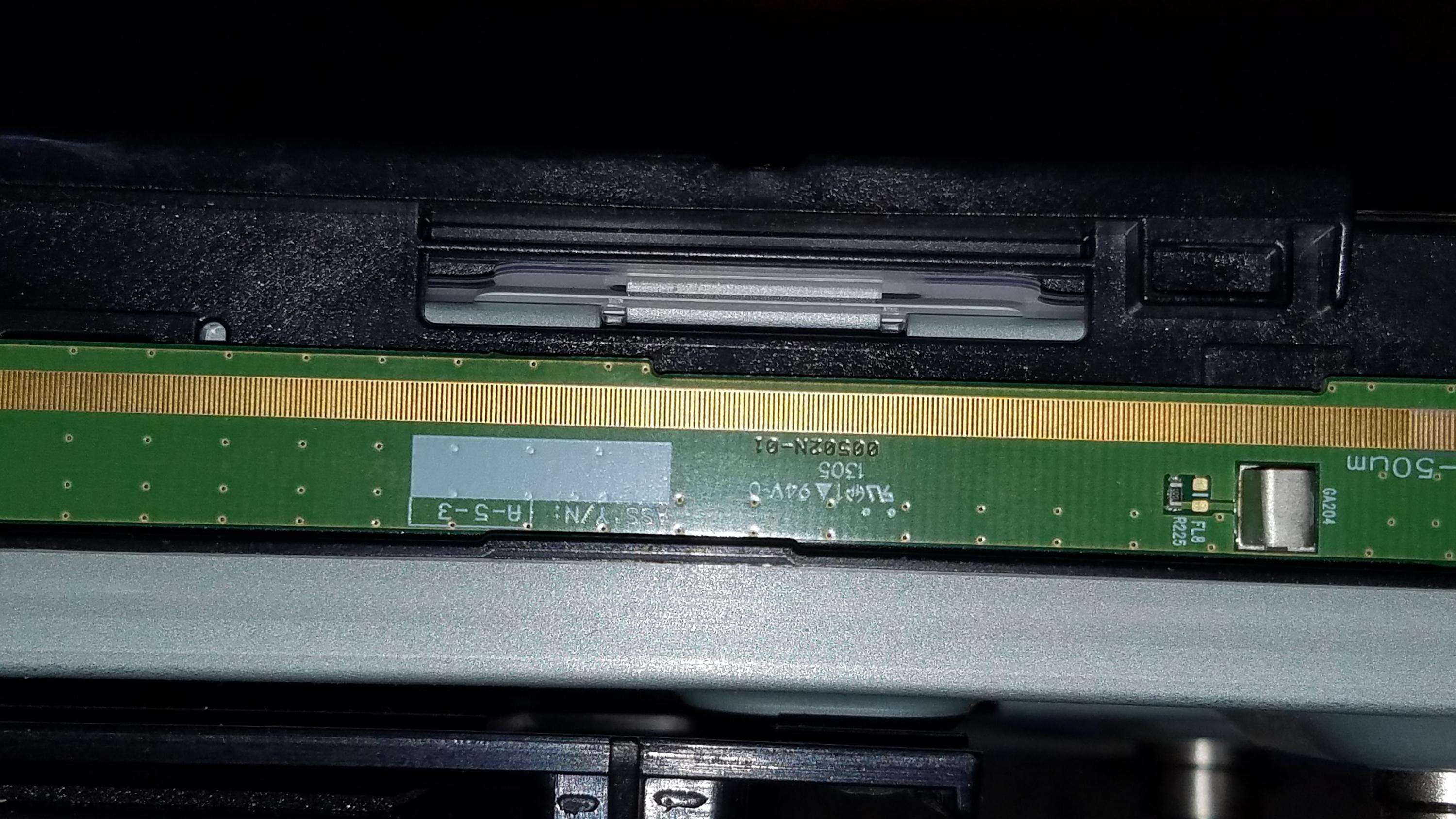

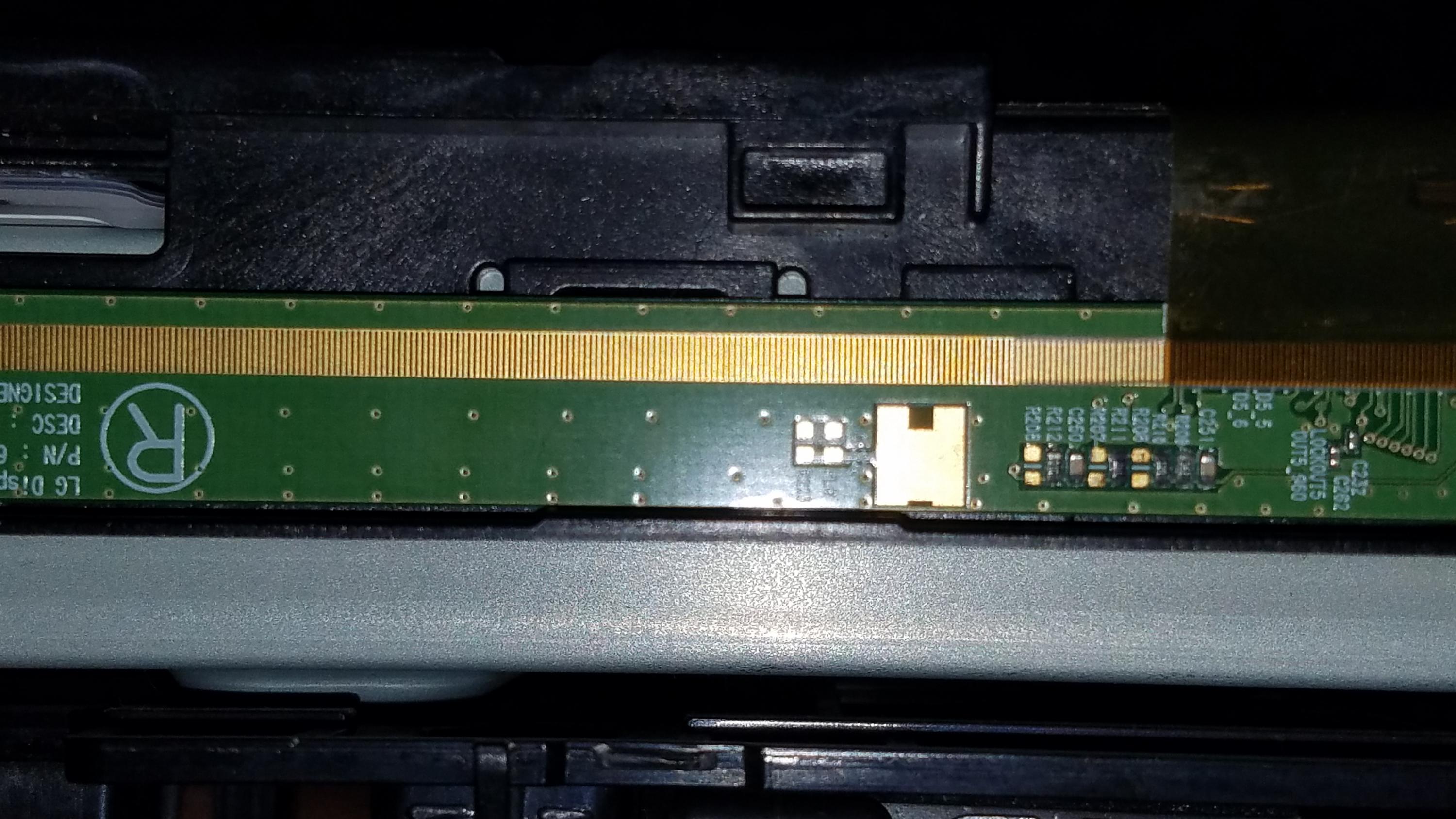

                                disconnect panel totally from T-CON and make access to the Tap board of the screen, you will have 2 side of same component, with DM at Ohm or Diode mode. you can compare the reading between each piece of parts of the good side of panel and the bad side of the panel. you will find one or more had different value i hope.
                                post clear photo of tap board the left and right one
                                • Unspun01
                                  • Jun 2011
                                  • 341
                                  Re: LG 47LN5400 - Overlay shift?
                                  I was just looking back at your photos. Is it just the left 1/5 of the screen? or is it both the left and right 1/5ths of the screen? Your photos appear to show that both the left side and the right side have symmetrical areas that are brighter/darker.
                                  In pictures 2 & 3, the text "No Signal" is facing up and appears at left side, and is facing up and appears at right side suggesting both sides of the panel display this issue?
                                  Is this accurate?
                                  This could be a panel error, but if you have symmetry in the error, perhaps is it mainboard signal error.

                                    When you power it up with nothing on the screen, the left 1/5 or so of the screen seems lighter as you see in photo. Right hand side looks fine. When you display the menu, or put in a source, the left 1/5 of the screen is perfect image, and the right 1/5 of the screen seems messed up as you see in the photos. as if overlay (best way to describe it) is shifted. You are correct.
                                    Tcon replacement did not fix it. and the theory now is that it's a bad panel. I'll take a look at the tabs and see if I can find anything. I've ordered a main board, but I'm not sure it will fix it.. if it's a panel, then that's $20 down the drain I hope it's fixable

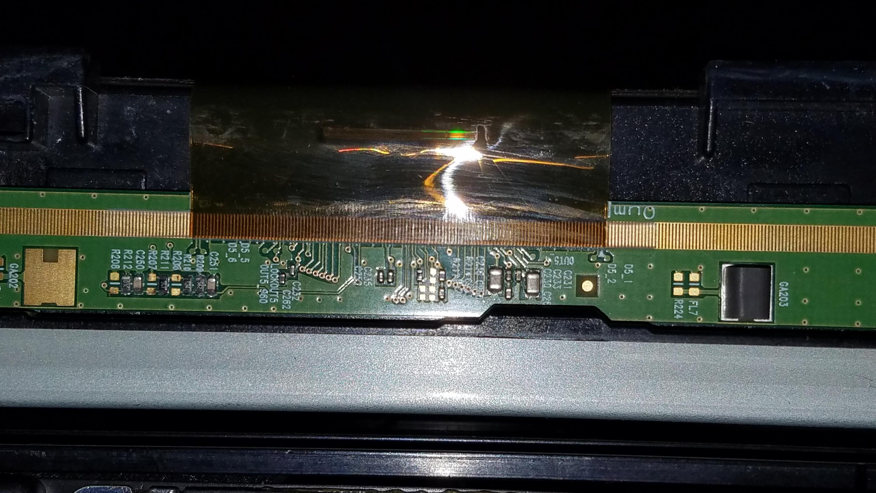

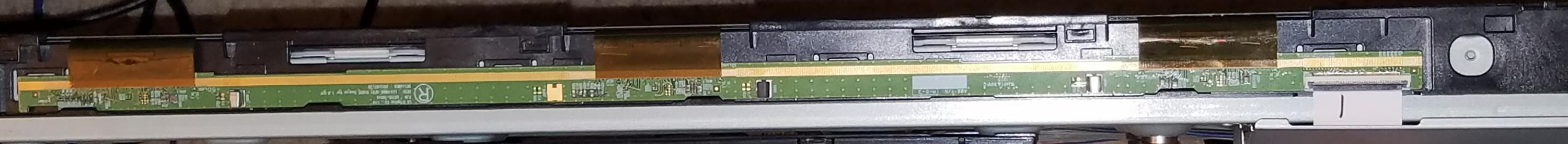

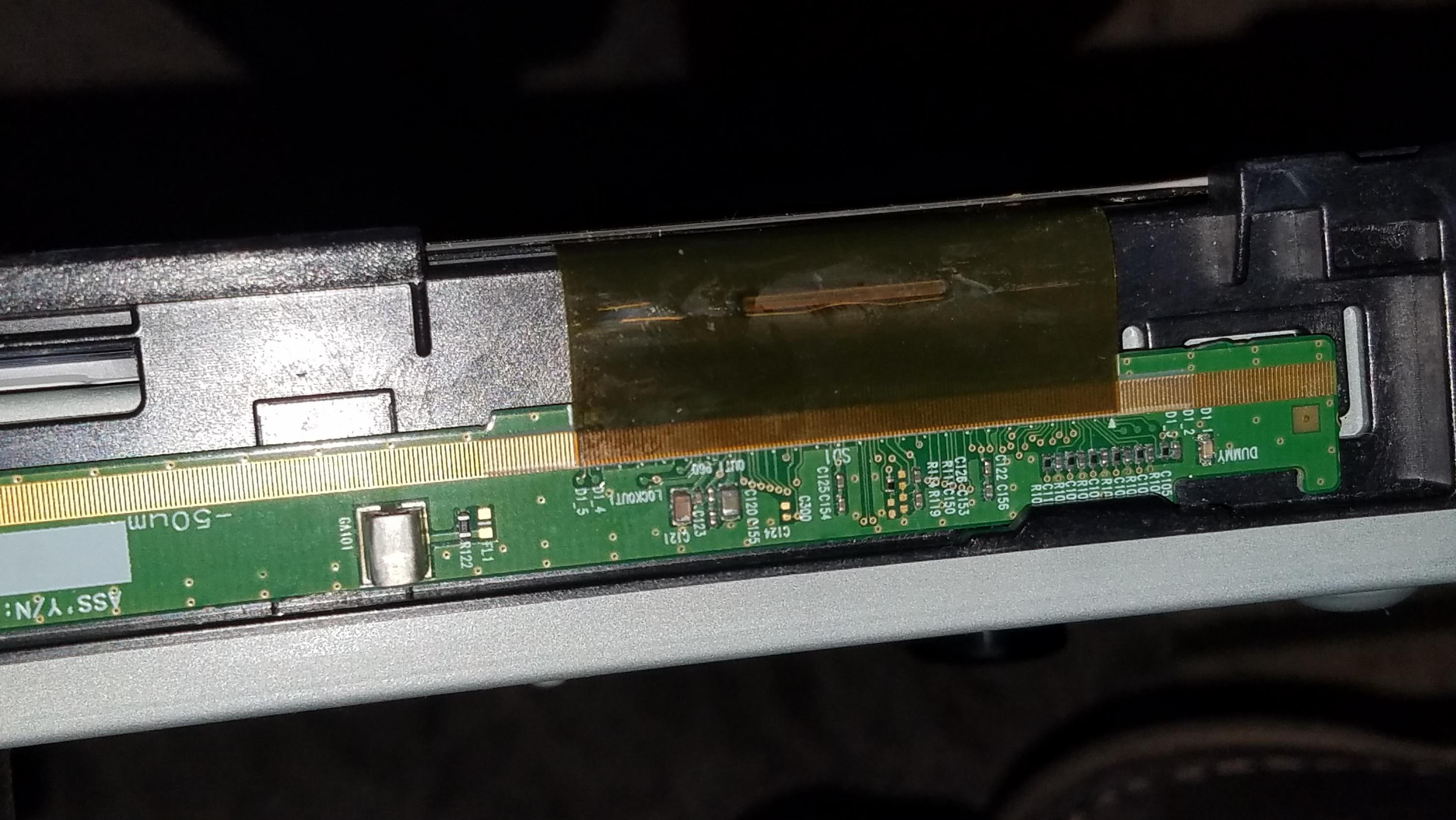

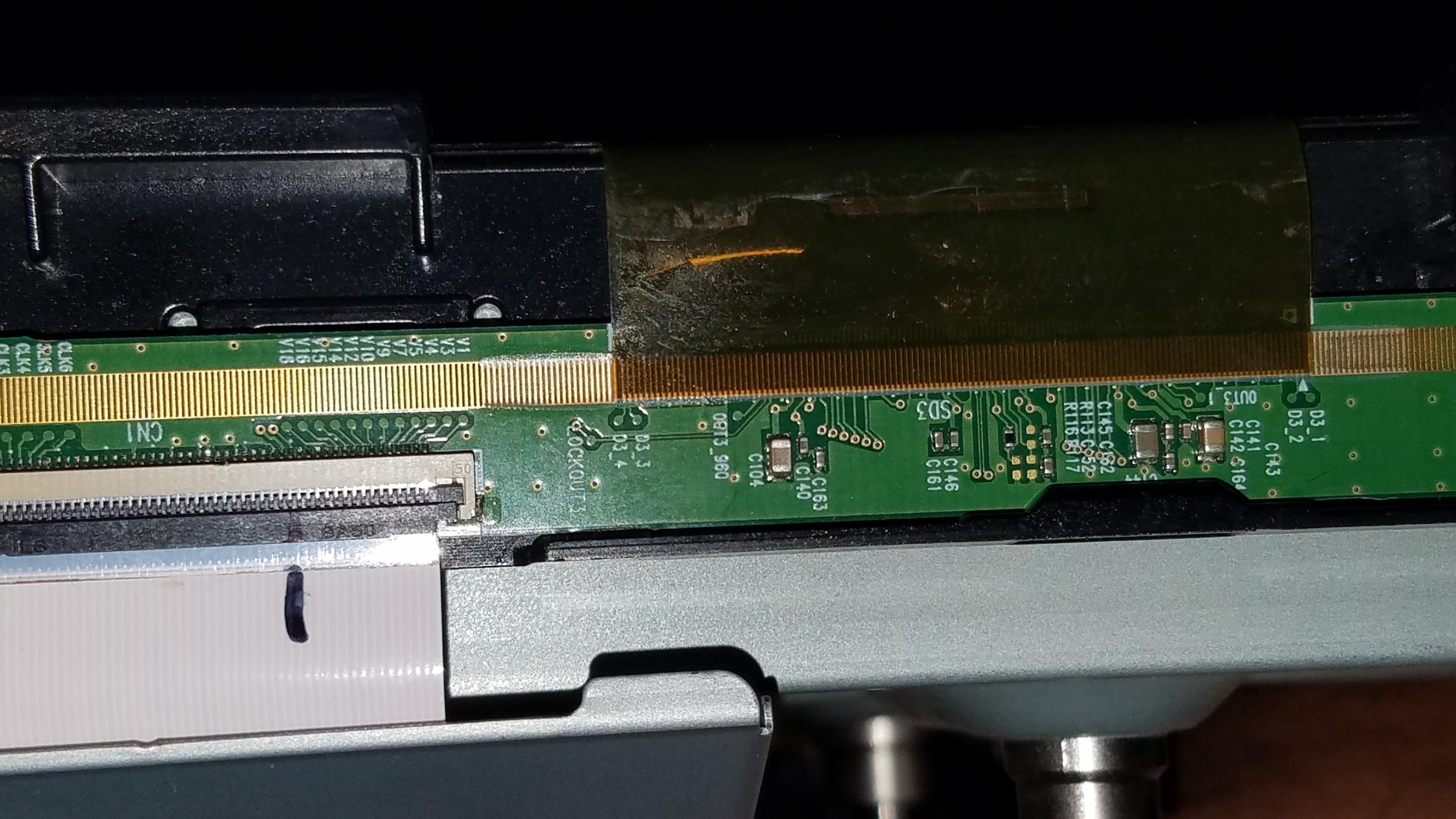

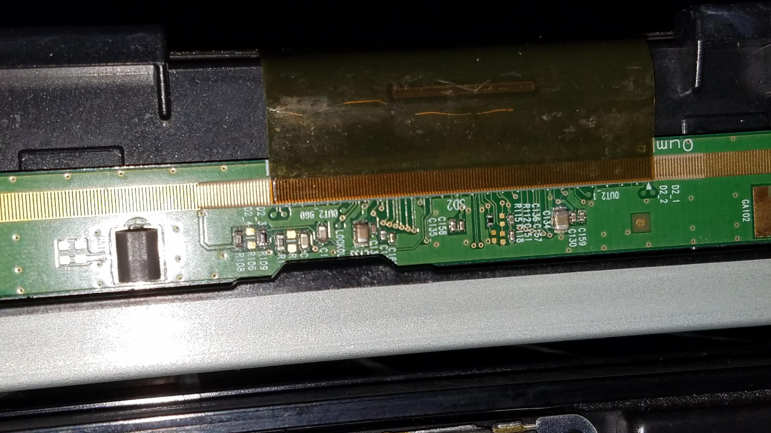

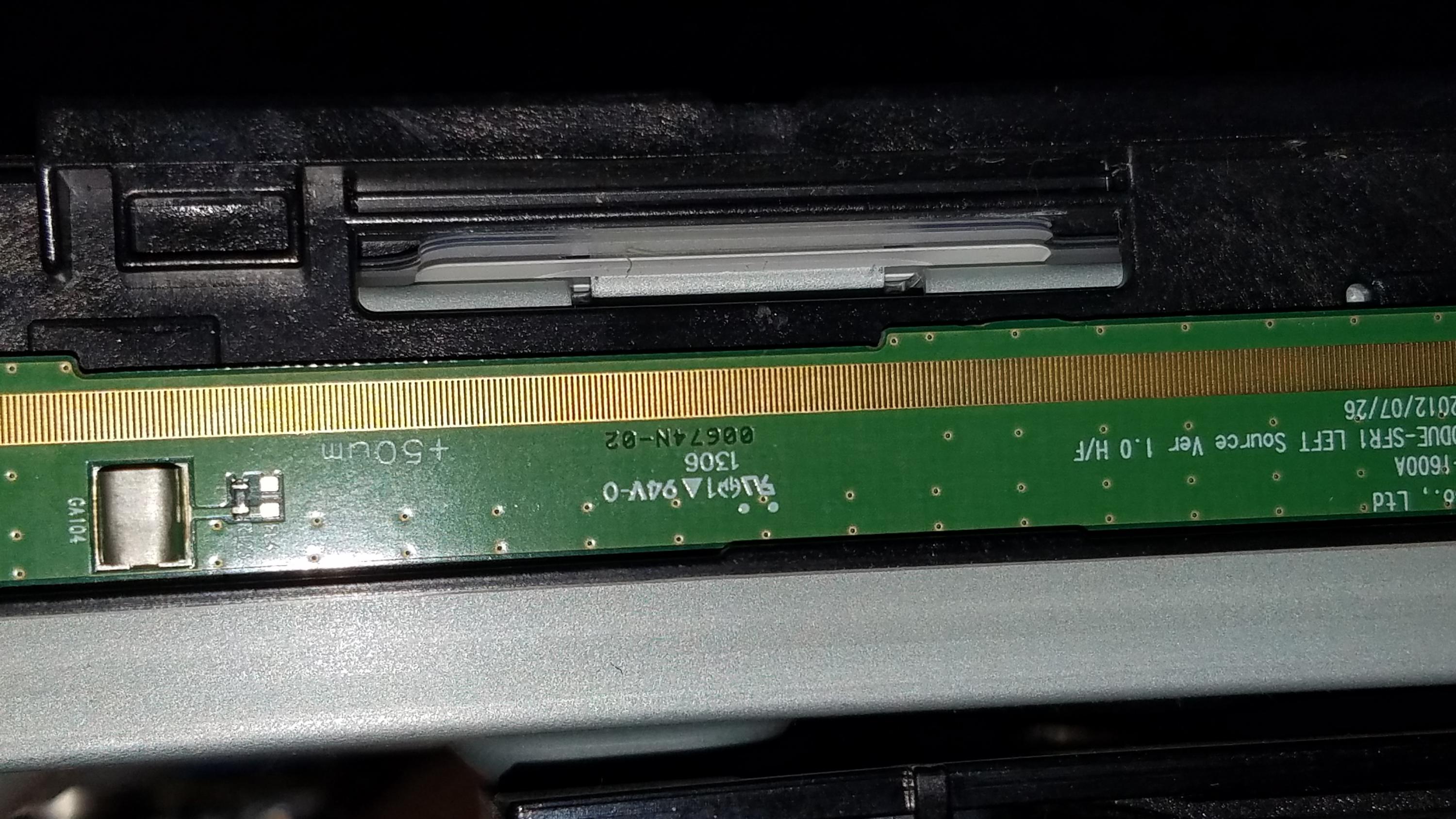

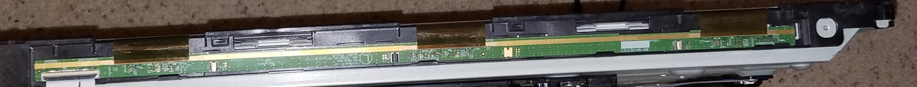

                                        Thanks Unspun01 - That's where I'm leaning also - The tabs "Seem" to check out. Dirty components (cleaning didn't help) - I did update firmware and no luck.
                                        Here are photos of the tabs, just for completeness
                                        Left Tab (Bottom left when facing the tV) photos first starting from ribbon cable in the center
