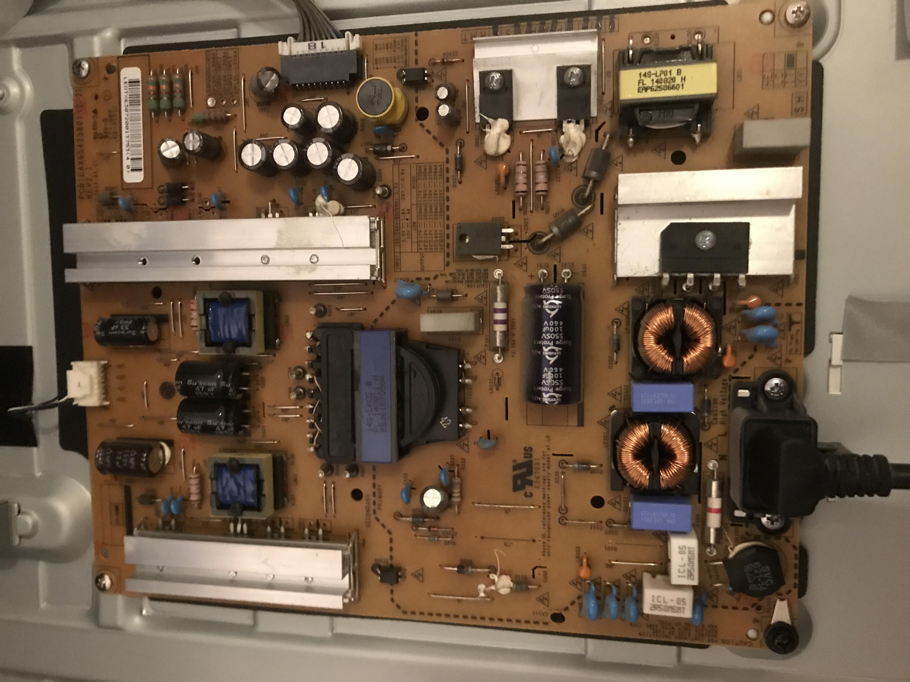

    Ok I despair!
    I've just spent the last hour or so replacing 5 faulty LEDs in an LG 47LB570V.
    When I got the TV in a few days ago the backlights were flashing on and off roughly every second. So I stripped the screen down tonight and found 5 faulty LEDs. That's the most I've ever found to be faulty in one TV.
    Anyway I replaced them with the correct 6V replacements. Tested each circuit and they all lit correctly. I've built the TV back together (slit my hand open in the process and got blood all over the diffuser...) and the backlight is still flashing.
    I can get a board off ebay for around £28 but I'd rather fix the original if I can.
    Any tips in narrowing the fault down?
    The board is eax65423801 (2.2)

        Did you test the tv with the panel off? The TV should turn on without the panel connected to verify all the leds are functional. Sounds like you still have a faulty LED or bad connection somewhere.

                Double-check your wiring connectors and check that everything is plugged in properly.
                If you said each strip lights properly then your repair may be ok, but flicking on and off means you may have an open point somewhere, and the Overvoltage Protection is tripping.

                    Thank you for all the help and advice guys. I opened the screen again and found that one of my replacements had failed. Set is now working but has really obvious rings around some of the LEDs, not all of them and not the ones I replaced either. One of them is quite blue so I think more failures are imminent..
                    I'll have to ask the previous owner if these rings were present before the backlights failed.
