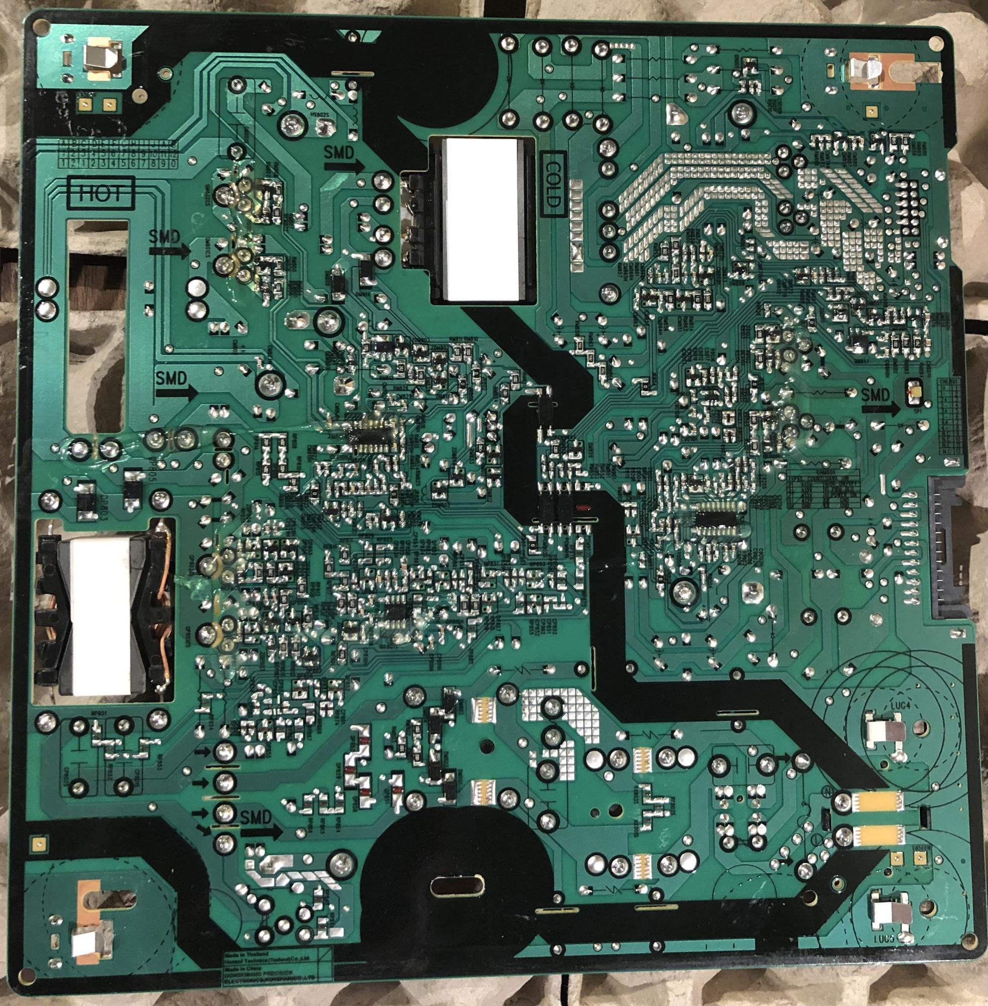

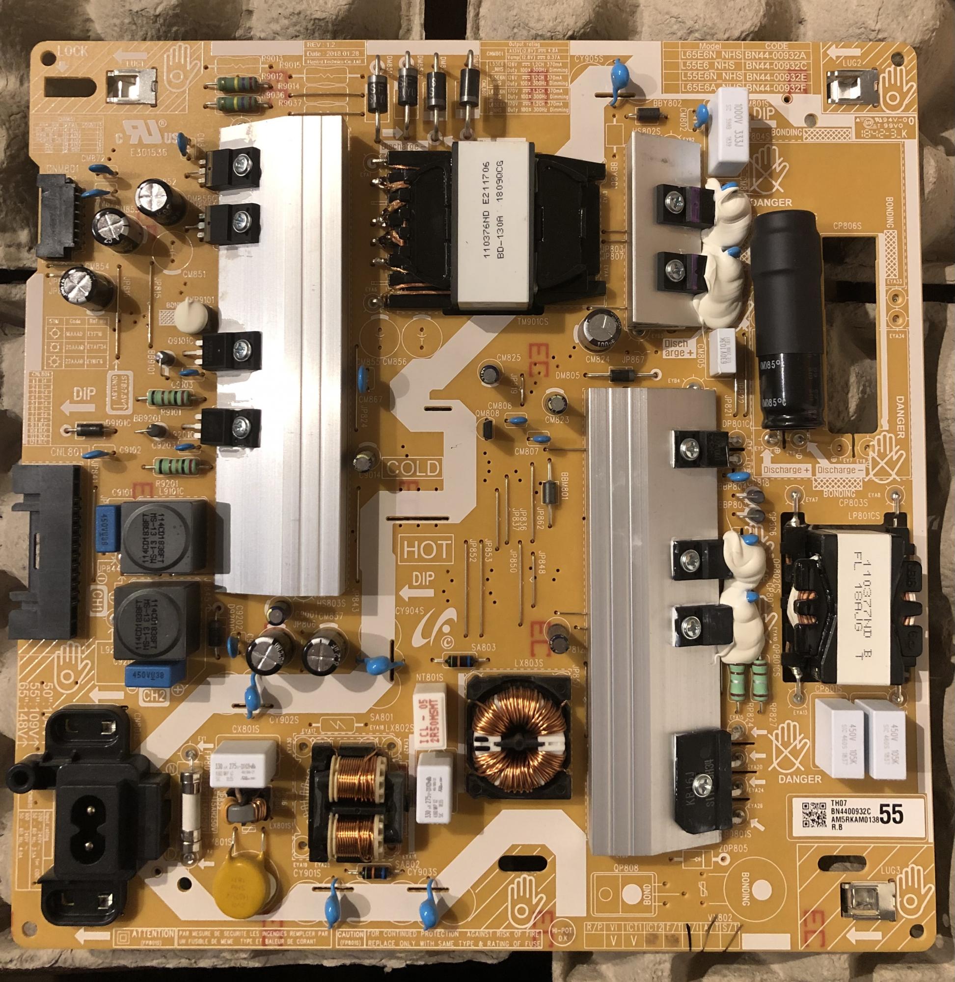

    I'm looking at a Samsung model ue55nu7096u that I've only ever seen in a non-working condition, i.e. I don't know if the failure was progressive or instant.
    Symptoms
    No backlight at all — LCD and logic board are working normally. Resetting all settings and installing system updates has no effect.
    I tried reseating the connectors between PS and logic board, and PS and panel. No difference there.
    I could not find a service manual.

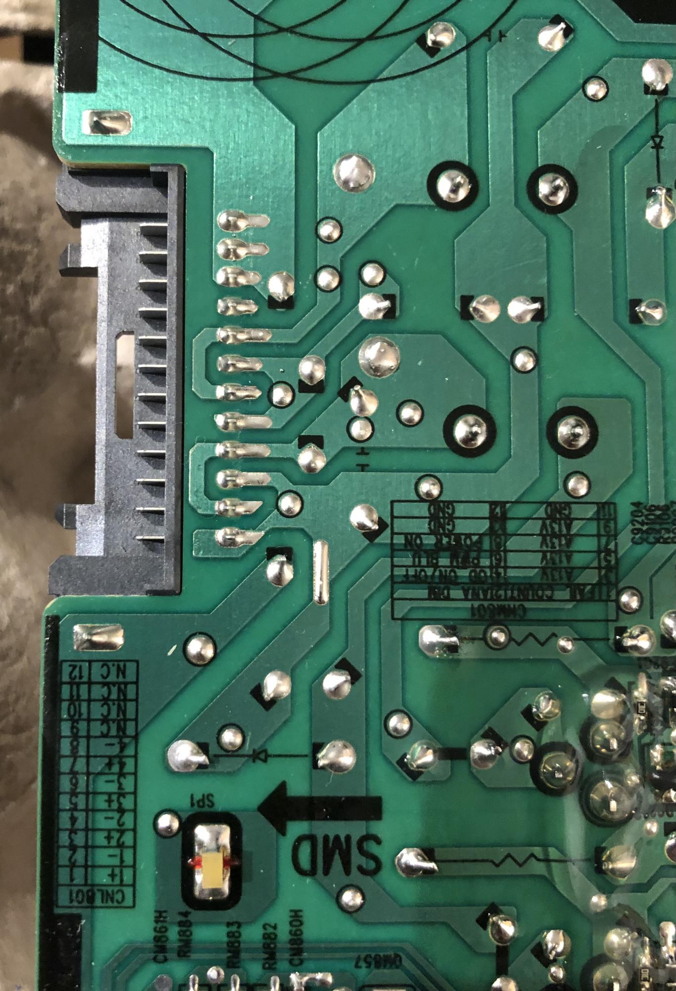

    Measurements when powered on
    Bulk cap: 388 V. Stable.
    PS panel/LED connector:
    Pins [1,2,3,4]+ are all connected with each other on the PS board.
    Pins 1-, 2- are likewise connected on the board.
    Pins 3-, 4- are connected on the board.
    Positive pins measure ~237 V, relative the negative pins. Stable.
    Total power draw about 23 W, compared with 12 W when unplugging the panel connector from PS, and 3 W in standby.
    Goal
    Determining with high probability whether the cause is a faulty LED strip before attempting the dreaded task of lifting the panel off. I imagine first having to acquire a pair of suction cups to do that safely anyway, not to mention replacement LEDs if there are any to be found.
    Questions
    1. Is there anything weird with the measurements? On the PS board I can read '55": 109 V ↑' which I'm not sure about... It's the 55" model.
    2a. Are all the LEDs in series? If so, I assume it's probable enough that they're at fault, so that I can confidently order replacements.
    2b. If not all in series, is it still likely that multiple strips have died?
    3. Having a bit of trouble finding listings for a replacement — only finding LEDs for similarly numbered models like UE55NU7300, UE55NU7100, UE55NU7105 — but I'll cross that bridge when I get to it I guess.
    Background
    I do repairs at a hobbyist level for fun. So far, every repair I've received guidance for on this forum has been successful (1 x PSU, 1 x CCFL monitor, 1 x amplifier). Thanks!

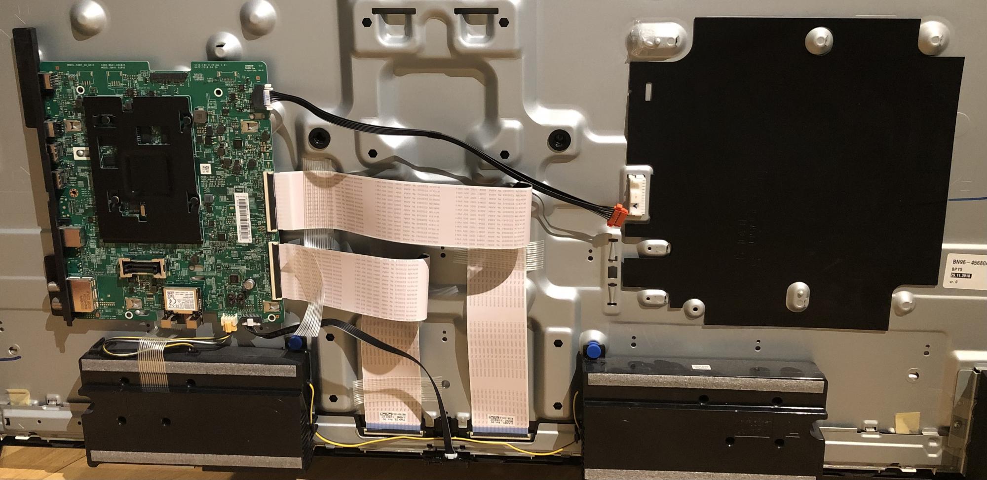

          That was the conclusion I came to as well after looking in the sticky tv troubleshooting guide for the definition of T-Con board. As a side note I found the description a bit hard to understand, since the description could, at my level, also have fit the long thin board on the LCD (name? Addressing board?), except that the picture mostly ruled that out.
          I disconnected the two ribbon cables going to the LCD from the logic board, and powered it on — there was no visible change even in a dark room. Power draw reduced to 19 W, everything else behaving normally (I.e. bootup sound). If you don't mind me asking, what was the theory behind this particular test?

              The voltage for the led's should be around 126 volts, you measured 237v, this indicates the led circuit is open and not drawing any current.

                          NU series are edge lit from the bottom and 55 in has two strips. LED failing open circuit would have acted like a fuse and might prevent the plastic panel from melting. https://techhometravel.com/samsung-n...ight-failures/

                              Though there are two strips, they are likely wired as a single string so one open circuit would create no backlight at all.

                                    You likely have an open circuit in each strip. With bad backlights, just replace them all with new. They can have different wiring configurations so there isn't a point in trying to figure out how the strips are wired. Search UE55NU7105 on Aliexpress and there are lots of sellers. Edge lits are extremely finicky and any imperfections can cause bright spots or an uneven backlights. Easiest way to confirm an open circuit in the string is with a LED tester at the backlight connector.
