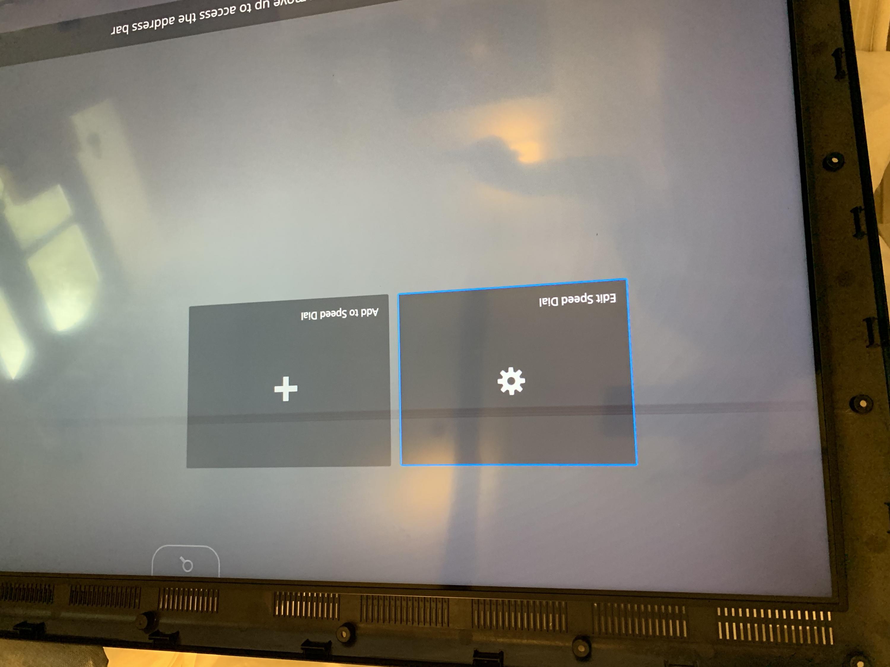

              But unfortunately the panel seems to have an issue with a small band of slightly dimmer horizontal lines, I'm pretty sure these were there before I fixed the backlight ... it was an eBay punt!
              Anyway, I assume this is a panel issue so not fixable?
              Picture attached.
              Even if it's a write off, it was a great learning experience doing the backlight.
              Cheers,
              Lee.

                not so fast on the "write off"... there are ways to potentially get rid of the "lines"... depending on the design of the panel... if it has side driver edge boards or not. IF not, a "tape cutoff" method may be used to block the signal to certain pins at the tcon that results in the drivers on the side associated with the lines to not be driven any more... clearing the picture. If there are side edge boards, then potentially there are ways of dealing with those. Read up some more on the forum about these issues and techniques and you might get a "fully working" display and learn some more things.
