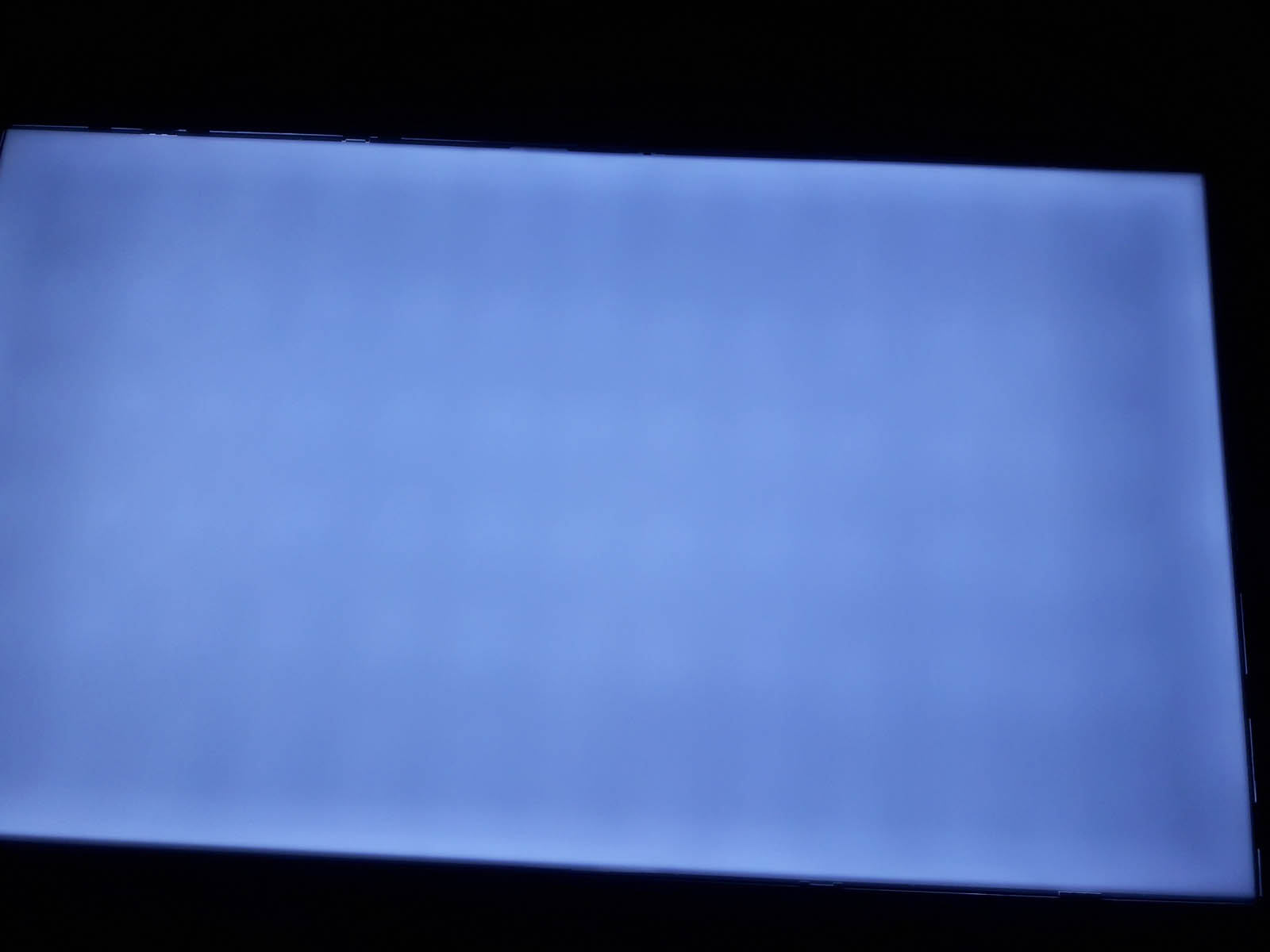

    I uploaded a video with hard plastic diffuser only; pressing it and lifting it
    Could we conclude that the problem is the leds or the lens?
    https://vimeo.com/321624748
    And this is a real life video; rings are noticed in clear background. Always appear in sky, very anoying
    https://vimeo.com/321629946

      the fault is the LED strips .only replacement will fix

          Looks like dirty/obscured diffuser lenses to me

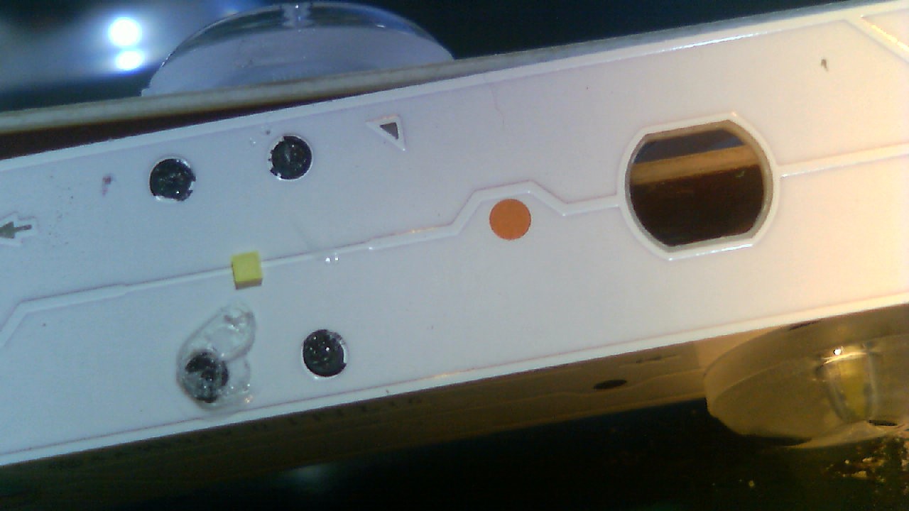

            In one case for me,on LG,same lens type,something similar after replacing some led’s.
            But problem was too for some untouched led’s.
            Since no way to fix it I replaced all led’s and lens with problem,result was OK.
            On those with problem I can see something like fog or smoke in lens.But no way to clean them.
            What I say,some lens was crystal clear,all OK
            Some others looks strange,like fog or smoke inside,no matter how I try to clean,no result and result was rings or spots in backlight.
            Some of led’s are blue already,replace strips and solve problem.

              Ok, looks like all the time that these backlights were maxed at 20, ruined/prematurely aged the lights and the lenses, will probably be seeing a lot more of this.

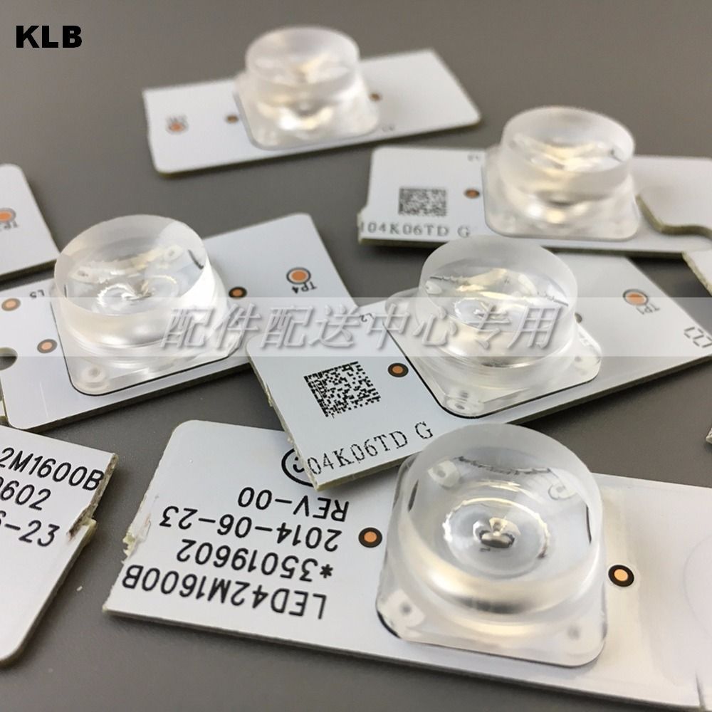

                  The size of the "rings" is directly related to the "light scatter pattern" of the lenses, rather than the size of the actual lens itself.
                  I have seen this style of larger "cylindrical" lens used in both LG and Samsung LED TVs, but I have never seen such a "ring" effect.
                  As much as I hate to say it, I think the LED "lenses" are faulty.
                  In the picture with no diffusers where we can see all of the individual LEDs and lenses, some appear to have a different (more blue) color.
                  By comparison, in the picture with the diffusers in place, the LEDs that are more "blue" have a less pronounced ring effect through the diffuser sheets. It looks like the lenses are bad.

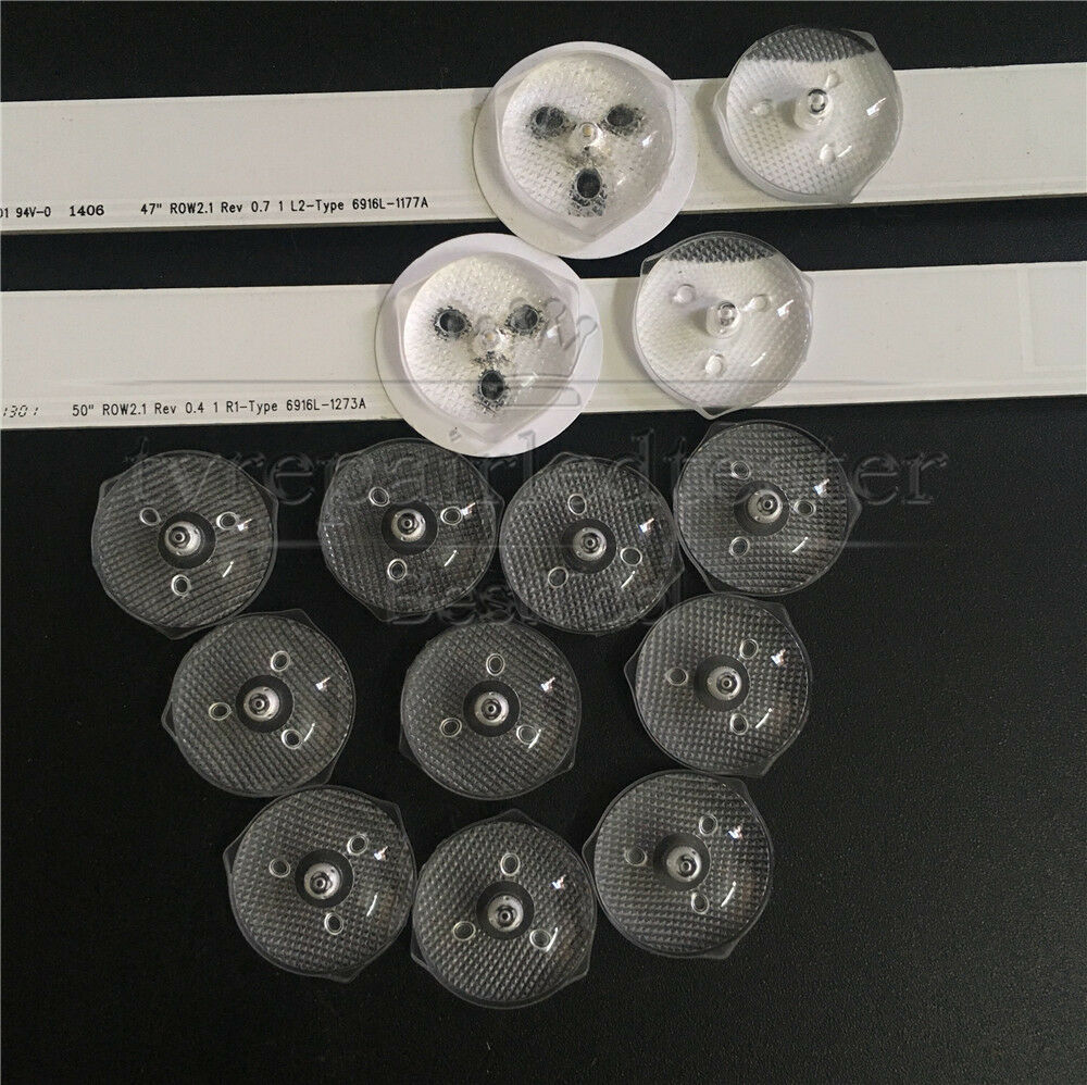

                  Possible repair options:
                  You may try to pop off a few of these larger "cylindrical" lenses and try to replace with smaller "convex" lenses. By replacing a couple of cylindrical lenses with convex lenses, you can probably see an immediate effect.
                  See the attached photos for examples of the different lens I refer to.
                  I don't think the LED strips need to be completely replaced... Only the lenses (which is cheap but a lot of work). You can get 100 pieces on eBay for less than $5. The replacement lenses can be crazy-glued in place but make sure you directly center each lens over the center of the LED or you will get weird scatter patterns.

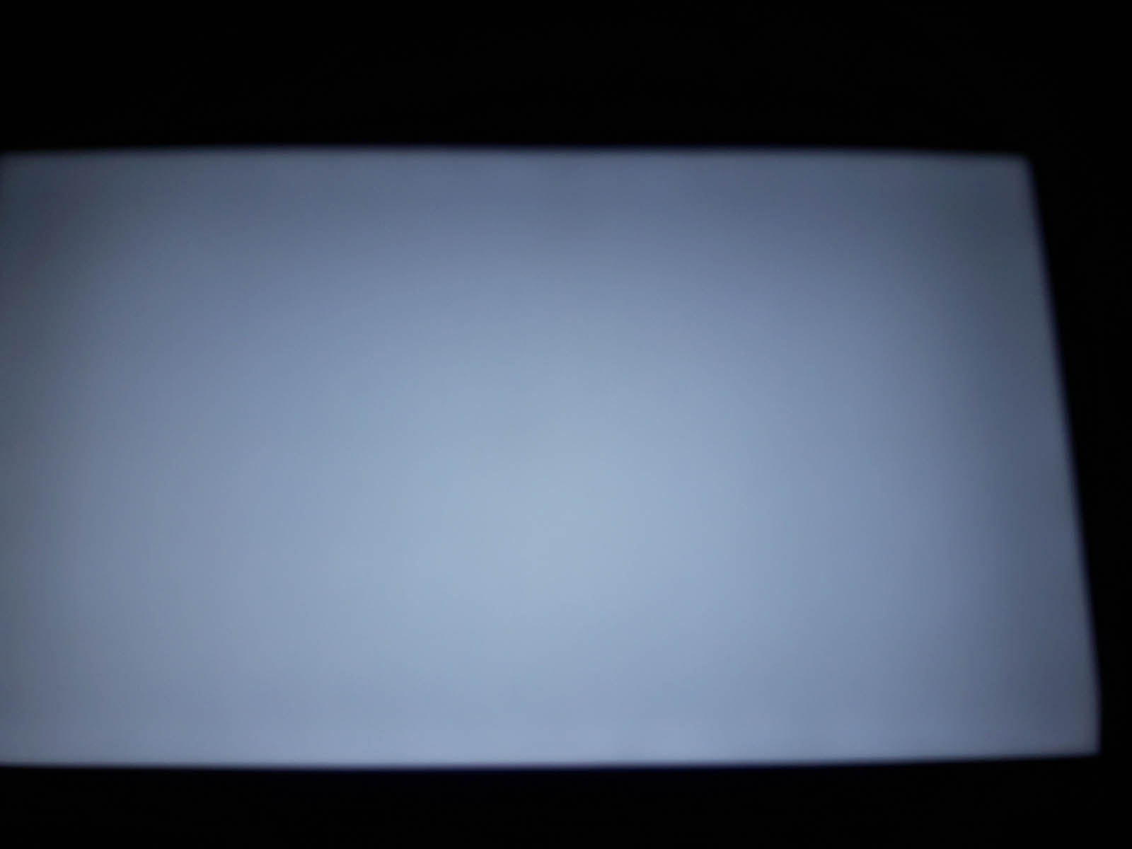

                        In picture 20190305_192113.jpg I see 9 blue leds, replace the led strips. After replacing adjust the backlight down to around 60%.

                          Well, problem is solved!!! I think the root cause was worn leds because of backlight setting 20/20 for over 2 years..
                          I finally bought all 6 led strips from as “used” retired from another tv with screen broken (I didn't found where to buy brand new strips)
                          The strips are exactly same model as my TV has, and they came with same kind of lens attached
                          The new strips when turned on didn't look too different to my old ones; I mean were not noticeable change in light power but the new strips don't have blue leds obviously.
                          I didn't take photos without diffusers and with both kind of strips mixed, I just attached two photos; one with hard plastic diffuser only (some irregularities but rings disappeared) and one with all the diffusers (a very good distributed white)
