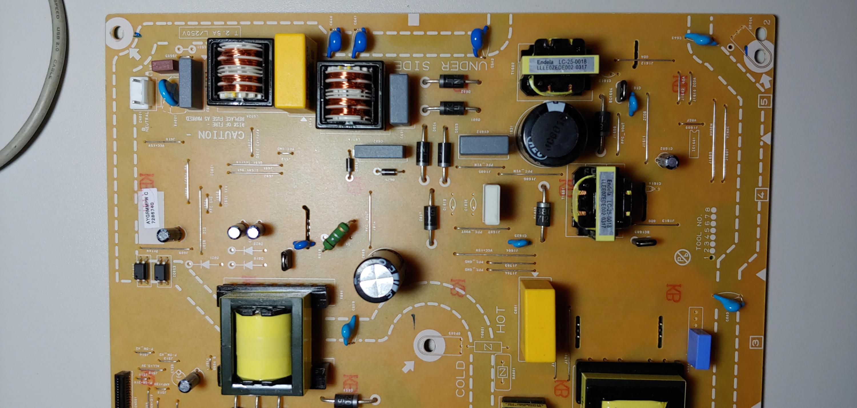

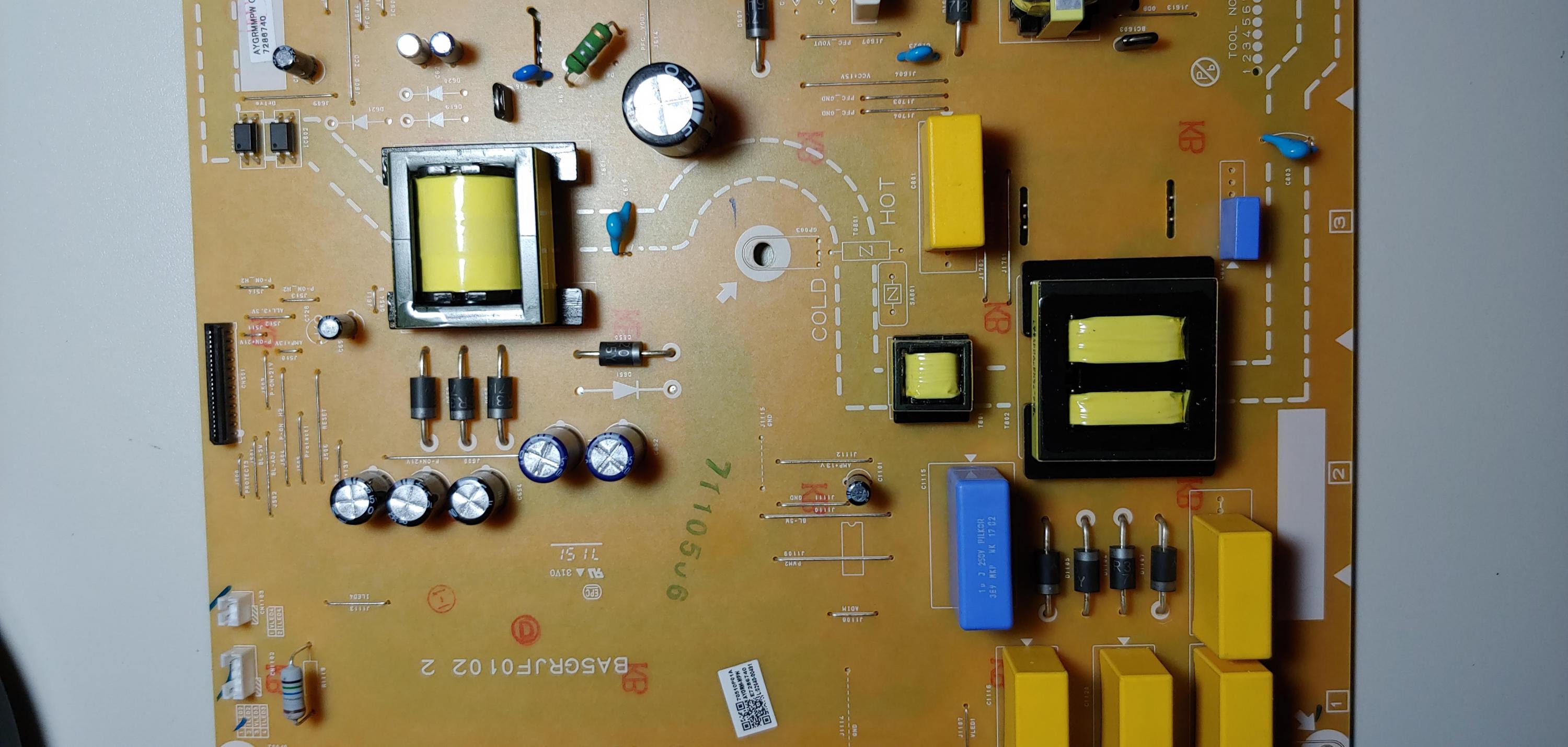

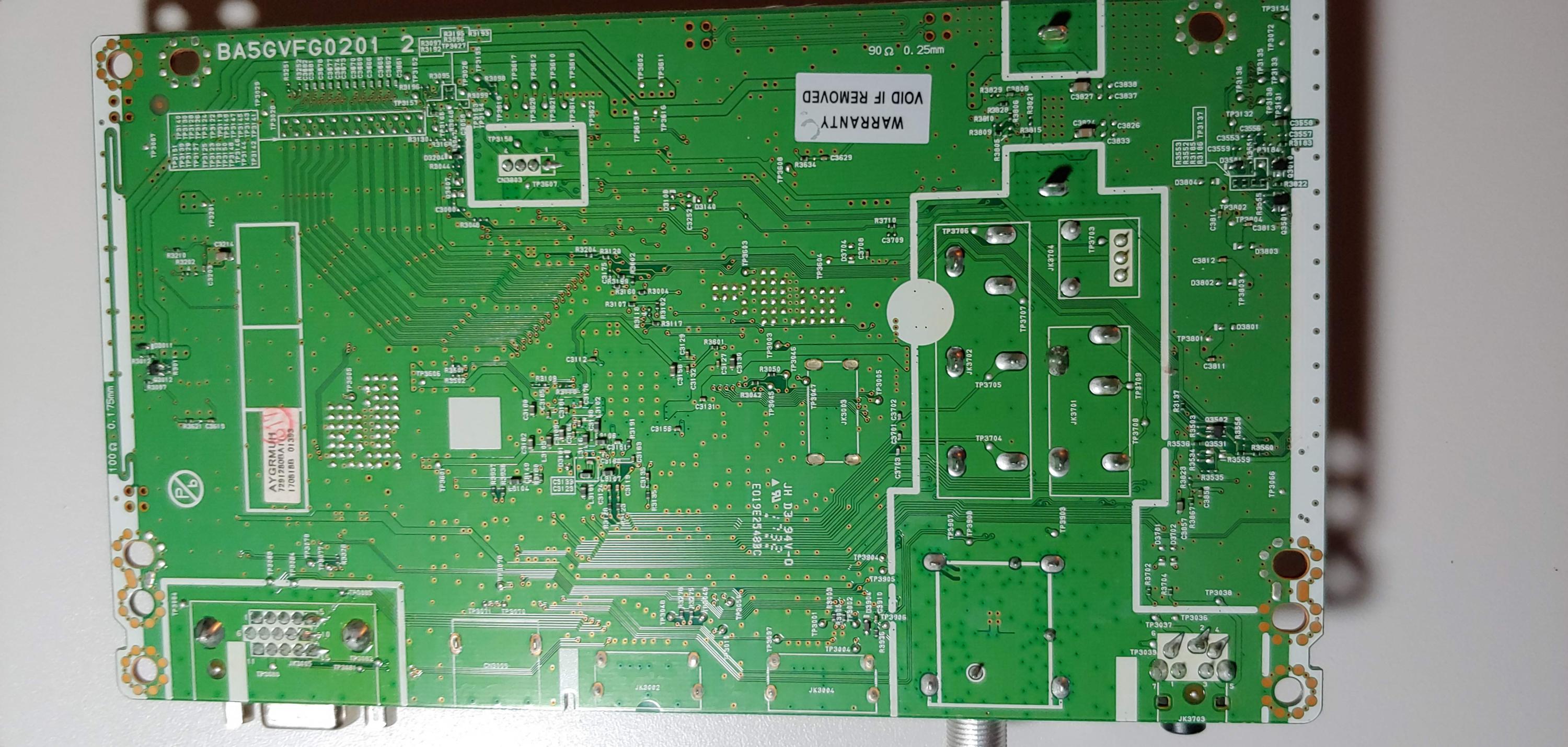

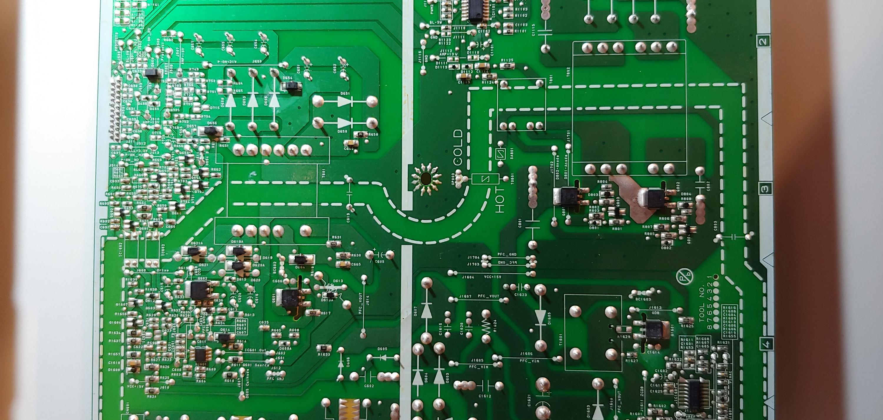

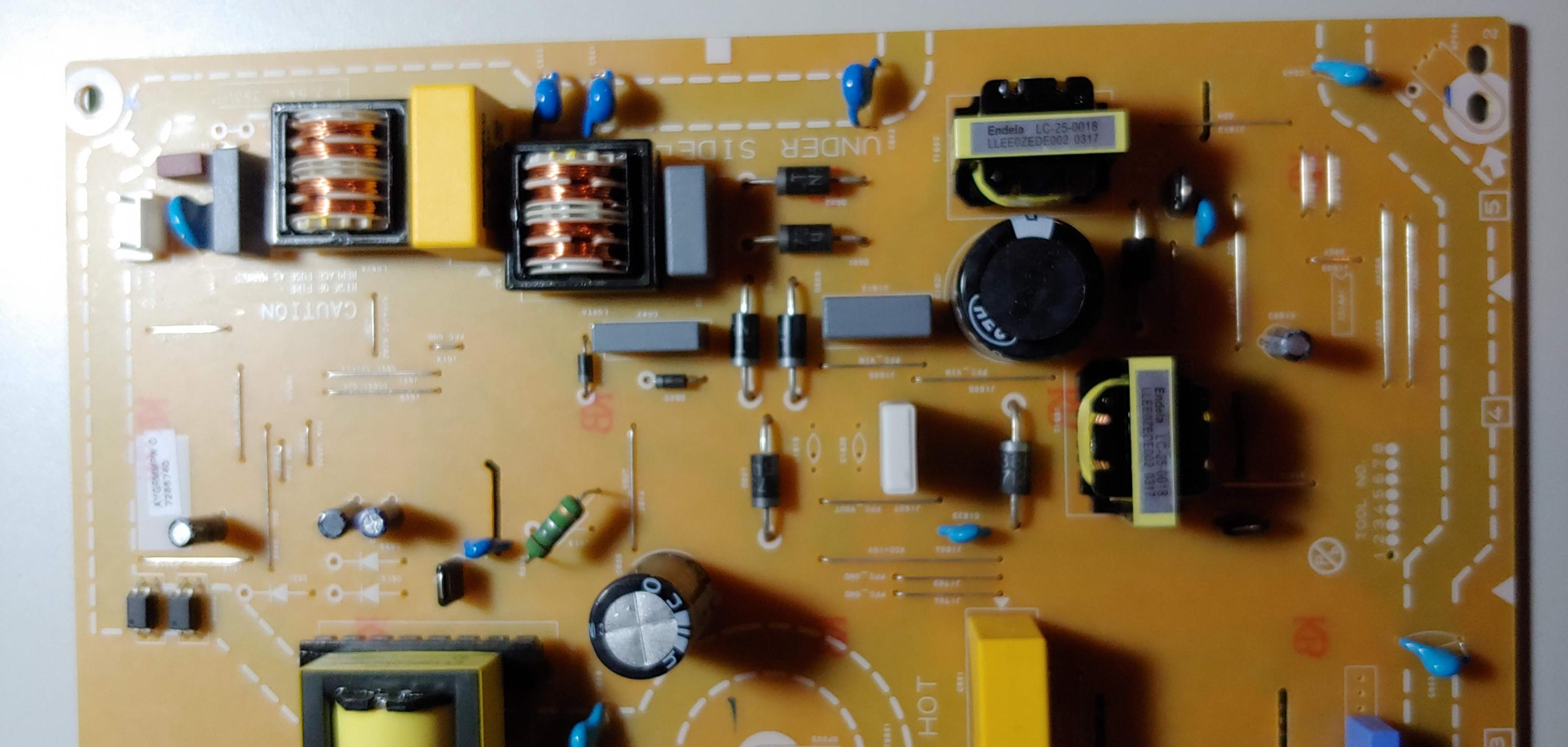

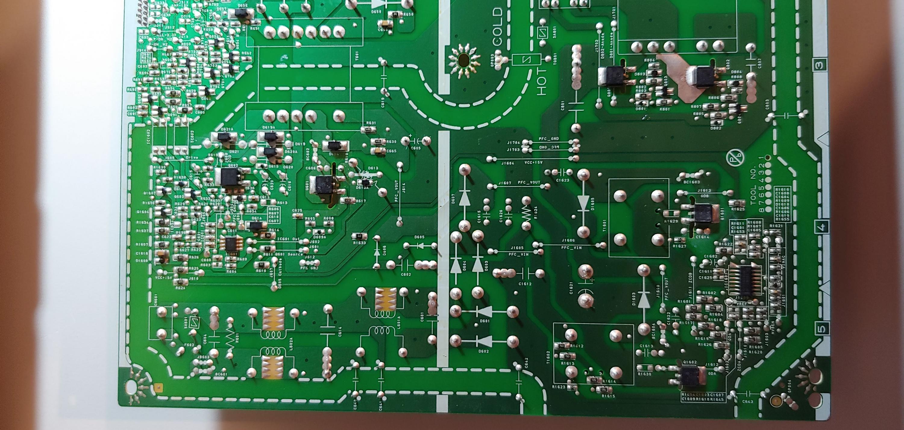

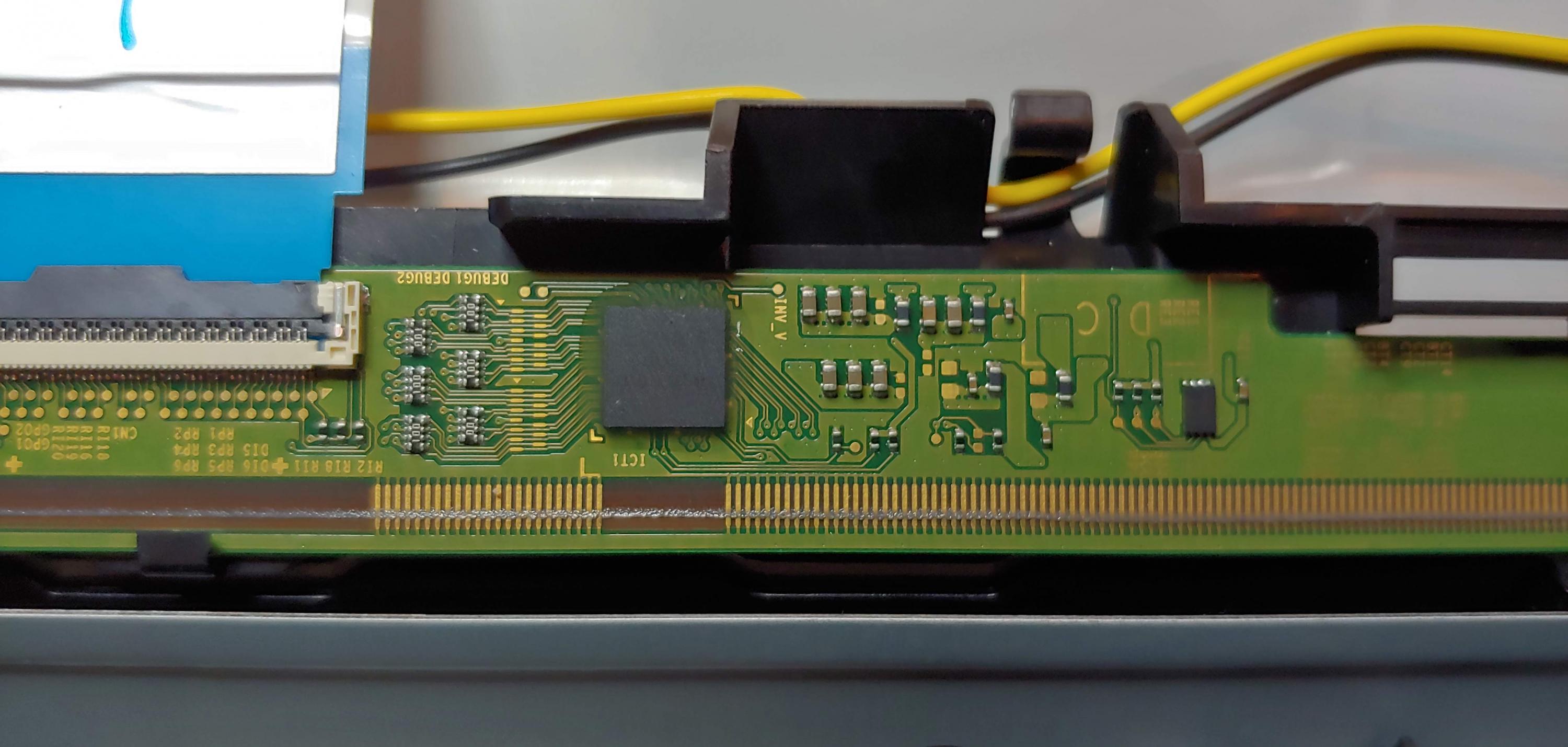

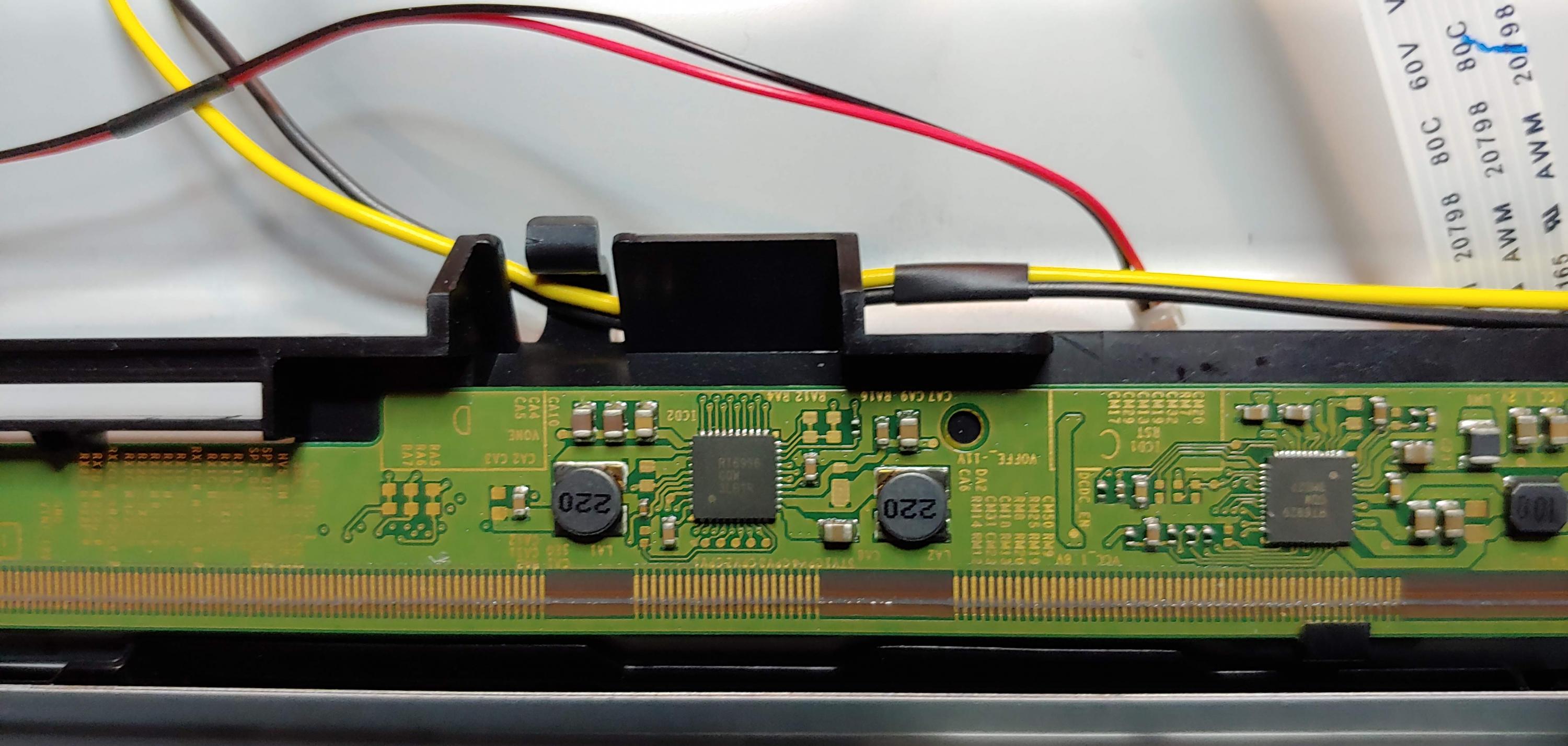

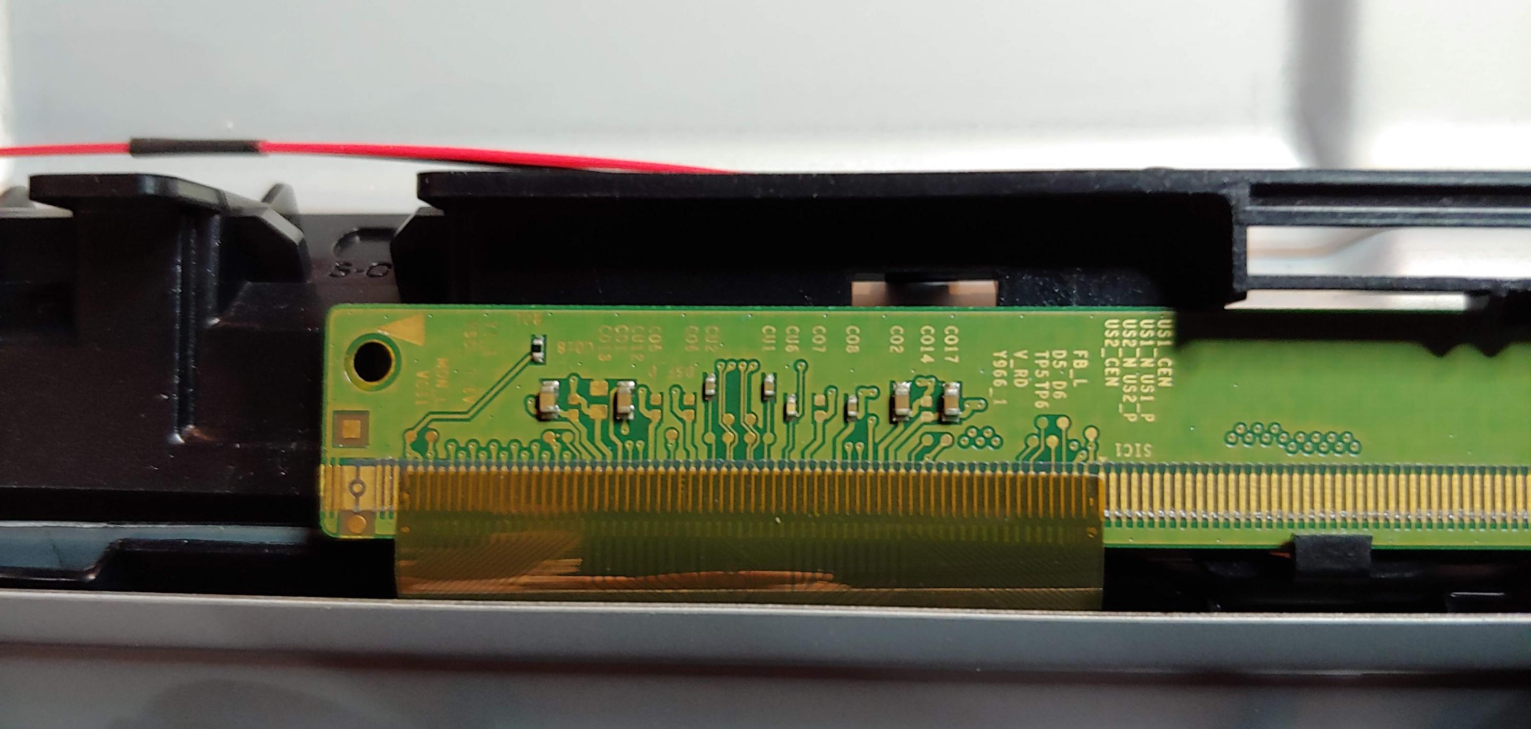

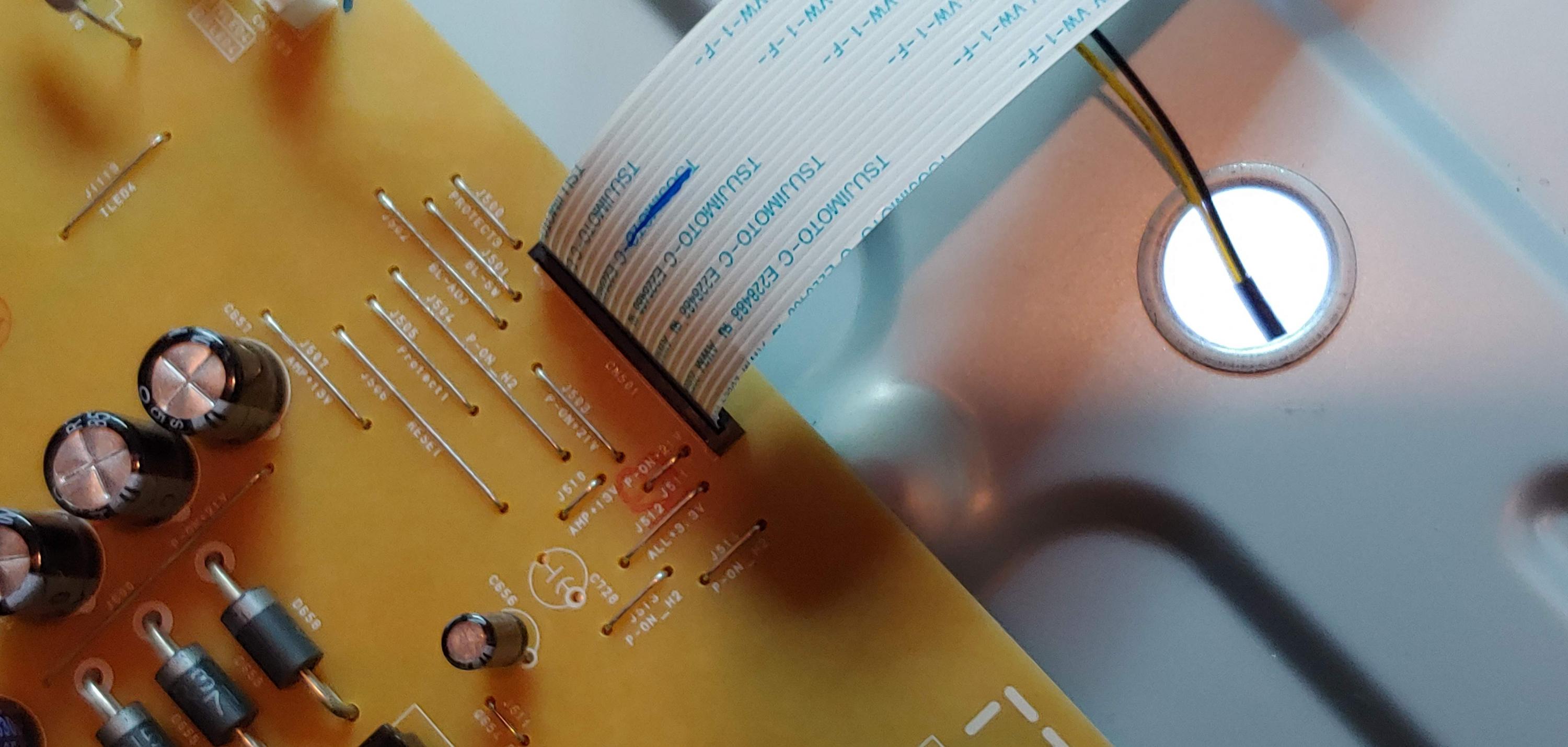

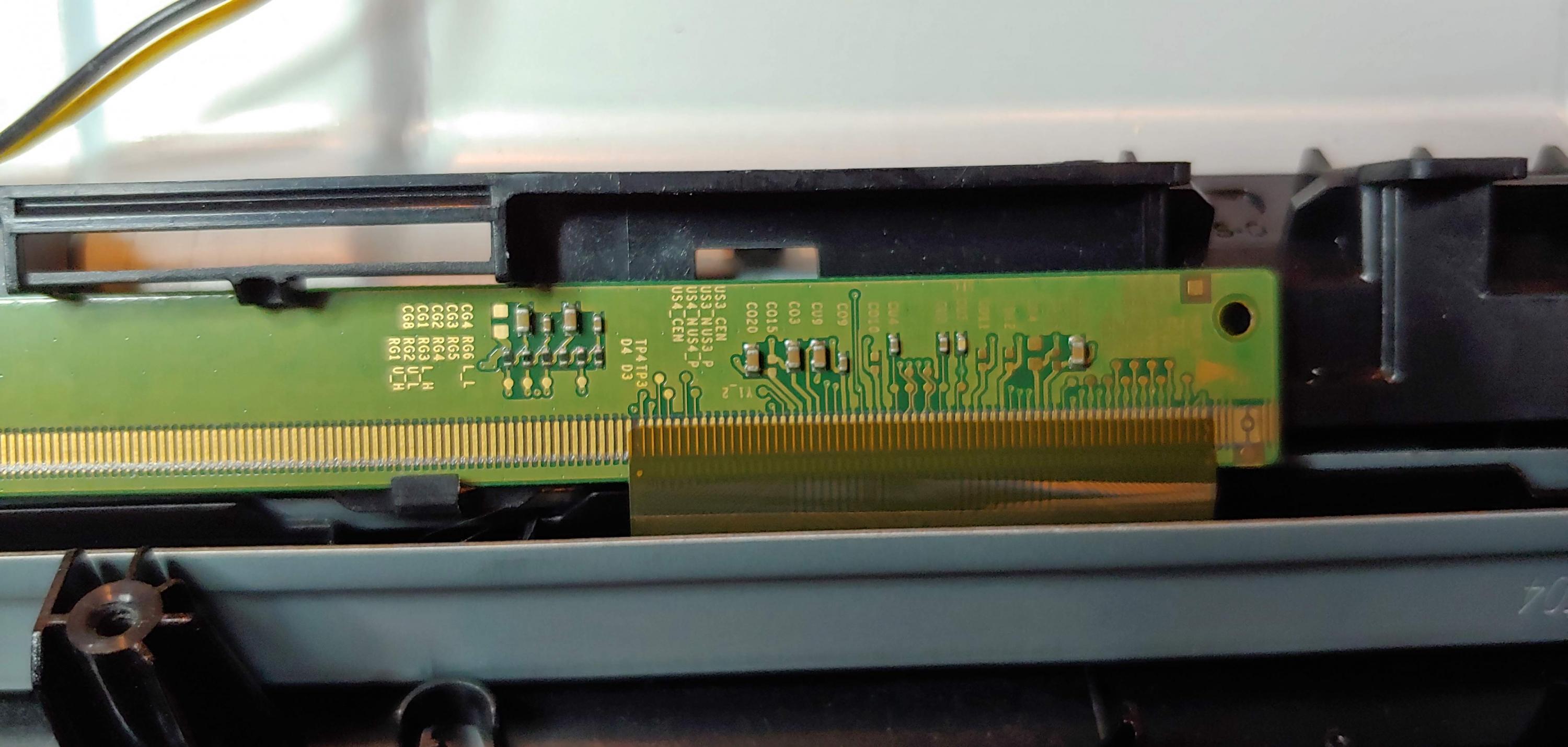

    Here are all the pictures i promised to upload. I did the best with the current lighting i have in my work area in the basement. I recently moved and i don't have everything the way i want it yet. I still need to get and put up some florescent lighting. I laid the power board in place and plugged in the cables so you could see how it is hooked up and yes i didn't put the screws back in
    this link from shopjimmy might help if you want better images. without shadows. https://www.shopjimmy.com/sanyo-fw55...-parts-kit.htm

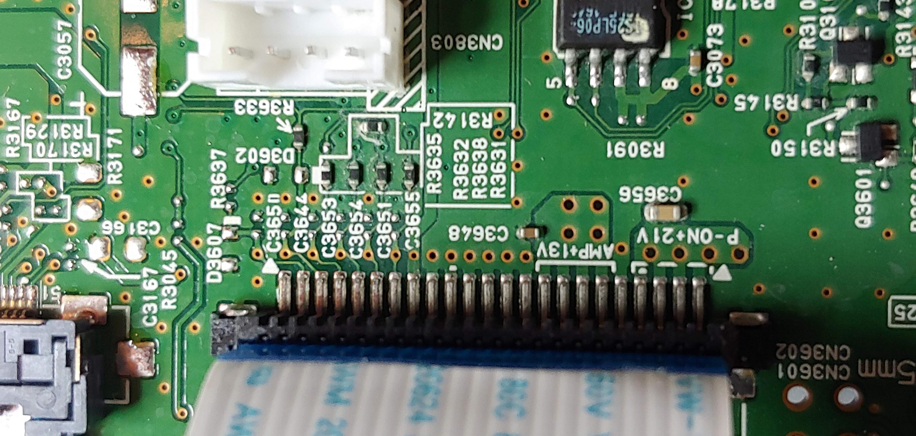

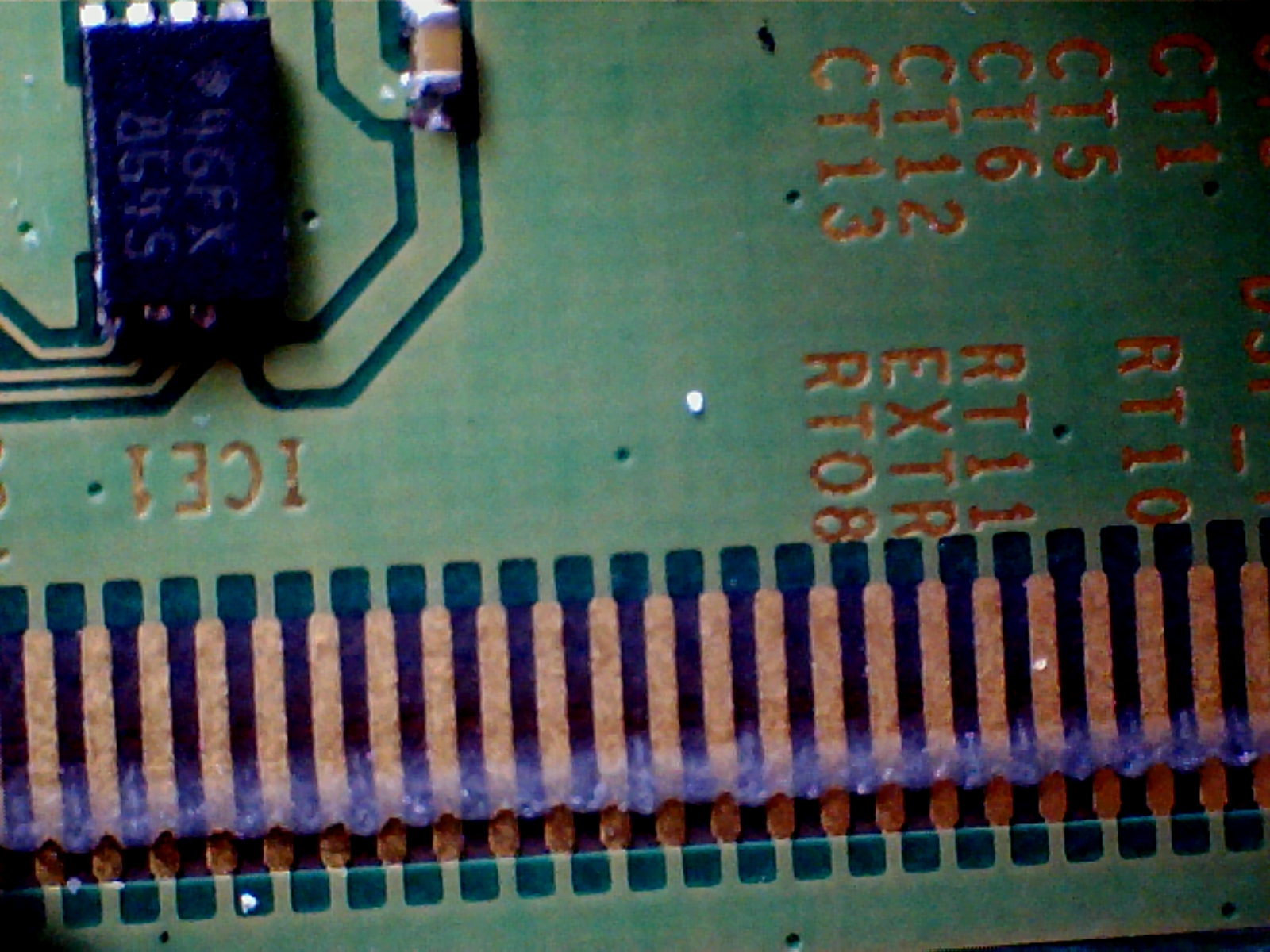

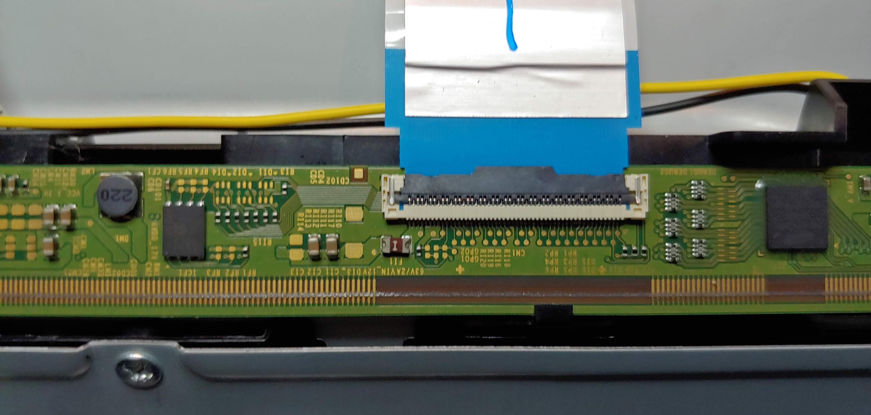

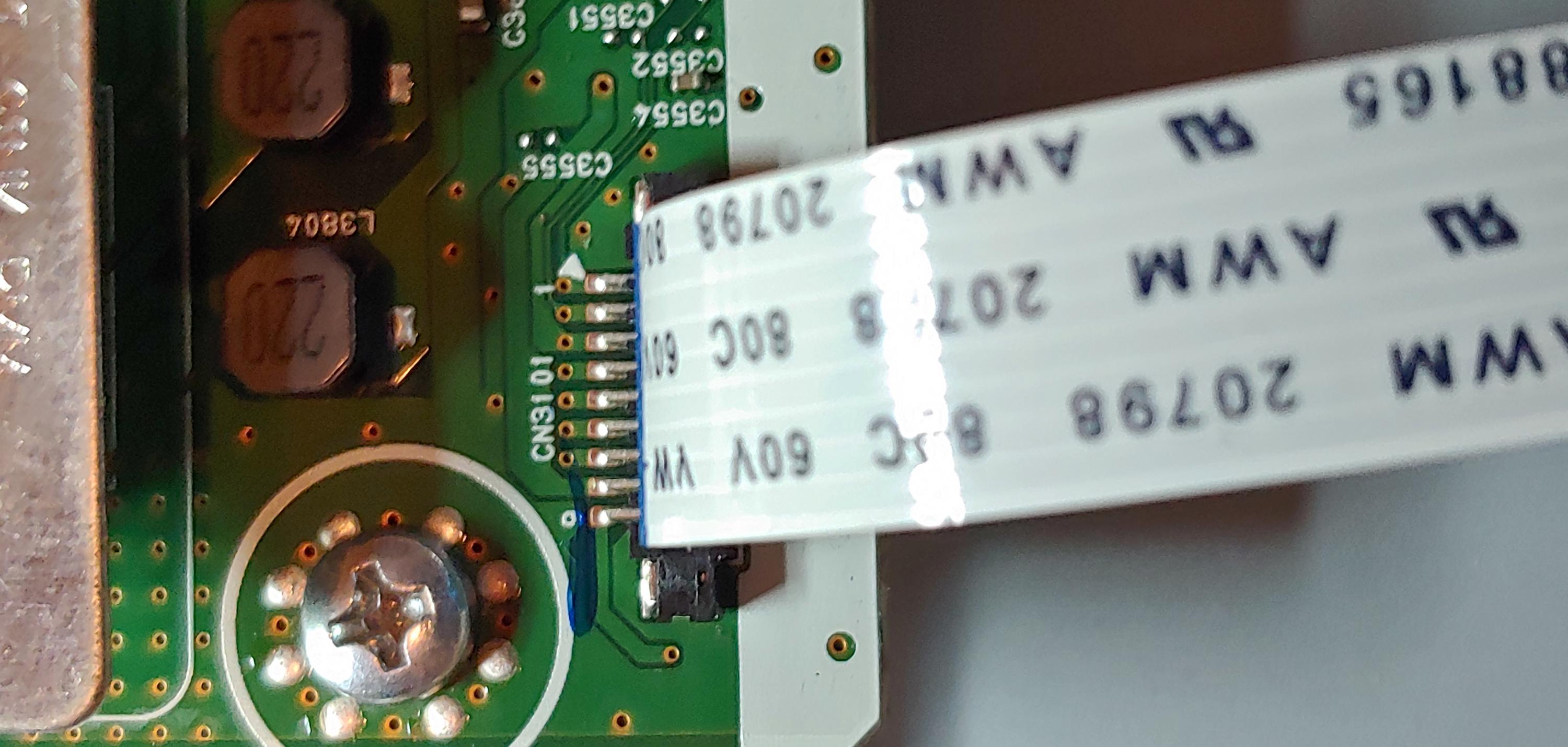

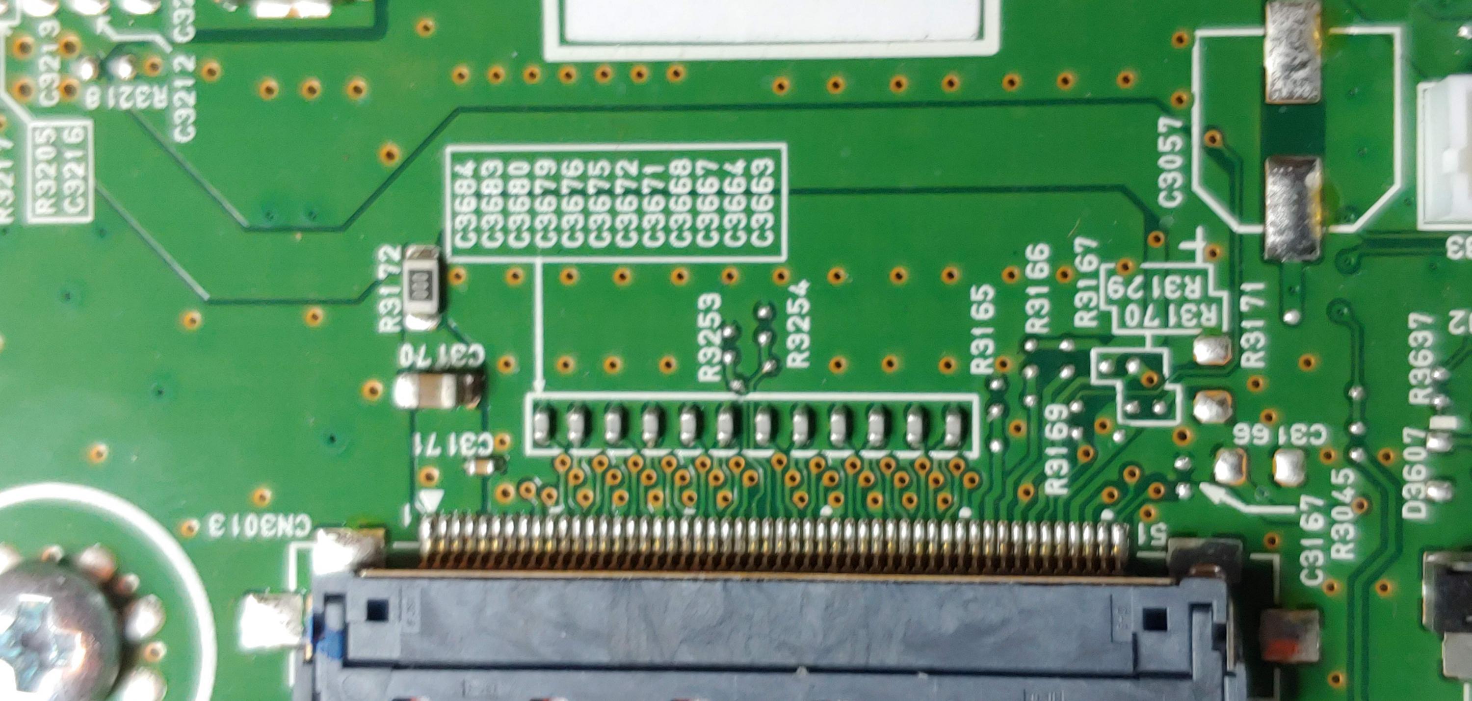

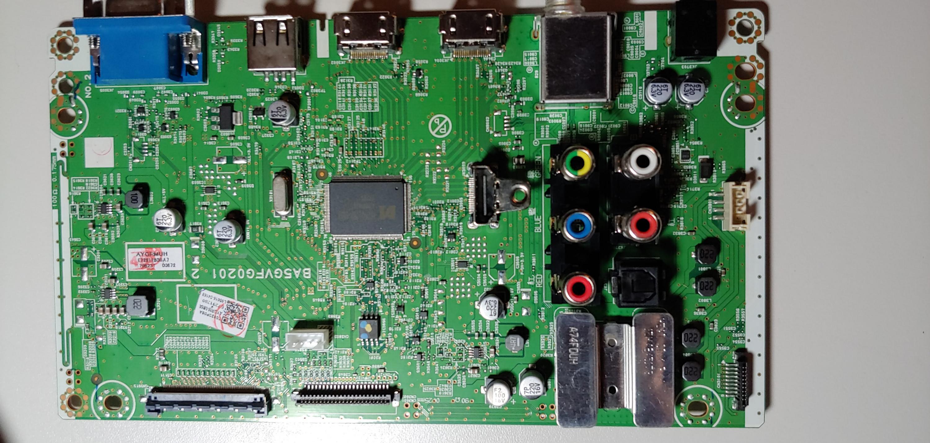

      Re: Sanyo FW55D25F stuck in color test mode
      here are some up close pictures of the connectors on main board and one going to the power board.

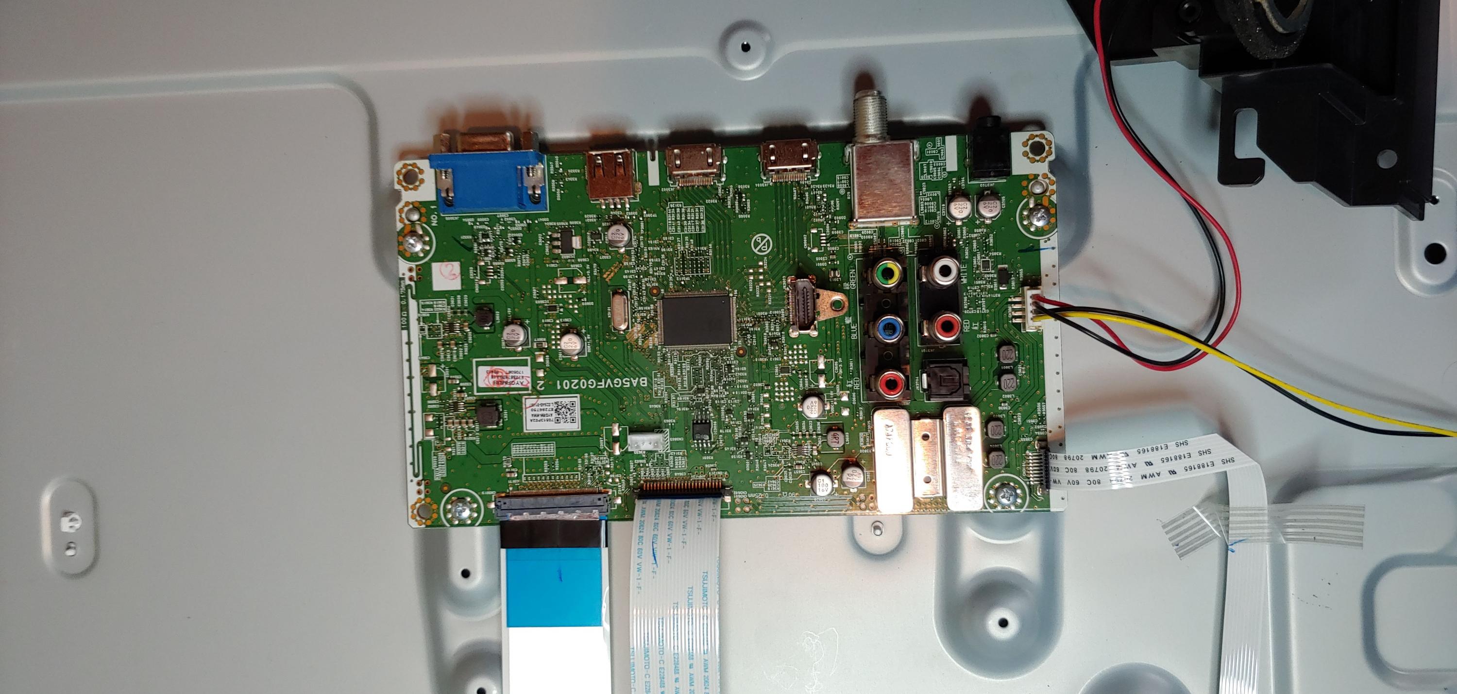

        can we see a pic of the whole back of the TV showing all the boards?
          Ok. Upload request picture and measurements with power off and power on. It is from the connector that runs from the power board to the main board.
                you need to know what the pins are in terms of voltages / labelling not just measurements. The labels for most / all are on the power board for the corresponding pins. Having said that, first "look" at your measurements appear to missing a lot of voltages, can't be good.
                  the 21 volts and 13 volts at the one side of the main board connector are what they are suppose to be, but the voltages i am getting at the other end if the connector are not listed what they are. I was just listing the voltage i was getting depending if the power was turned on or off. I would agree this is a cheap a** tv. It is my brothers and i am trying to do the best to solve this as best as i can. Not having a schematic suck. there is nothing on the power board side of that cable that indicates what is what .

                    #29
                    all you need to do is match the pins to the "label points" at the power board... its a simple continuity test.... then since the cable is "straight", the voltage should appear at the same pins at the other end.
                      I'm not sure you have a physical problem, yet...
                      Color test mode can be bad EEPROM or corrupted firmware, but can also be user error by accidentally entering the mode without knowing it.
                      Do you have the remote control?
                      Try at least a few of the following individually:
                      With TV on, press LEFT arrow, then RIGHT arrow, then POWER. Unplug TV, wait 30 seconds. plug TV back in and turn on.
                      With TV on, press UP arrow, then DOWN arrow, then POWER. Unplug TV, wait 30 seconds. plug TV back in and turn on.
                      Try just holding EXIT button.
                      Try holding the MENU and ENTER buttons together, then press the POWER button.
                      I'm not saying these will work for you, but have worked for others.
                      Let us know if anything works.
                        None of those had no affect on the TV. I don't understand by both main board i have are doing the same thing. How could both be corrupt. I've fixed several other tvs in the past but this one that looked simple is being a challenge.
                          Yes, both could have corrupted firmware or EEPROM.
                          It is not uncommon for TV parts resellers to turn on a cracked screen TV (cannot fully test) and see that it turns on and displays some kind of image. Then they sell the parts as "working" but perhaps not fully functional.
                          However, both of your boards display color purity test. RARE. It is more common to have infinite rebooting, or loads up then hangs, etc.
                          As I stated in post #19 of this thread, I have had a TV that enters the color test mode with a known good mainboard so, it could be a bad panel. Or specifically, a panel with shorted or damaged components on the panel driver boards attached to the panel itself.
                          From your photos there are a good many chips on those boards. Some are BGA so who knows what they are or how to test. But Some have exposed pins and may be easier if you are patient.
                          I would start by testing across every single surface mount cap for shorts or suspiciously low resistance. Then check each of the small coils (markings 100, 220, etc) for shorts to ground. They will measure short across the coil which is normal, but they are generally connected to voltage rails so there should not normally be any shorts between the coil to ground.
                          Report back.

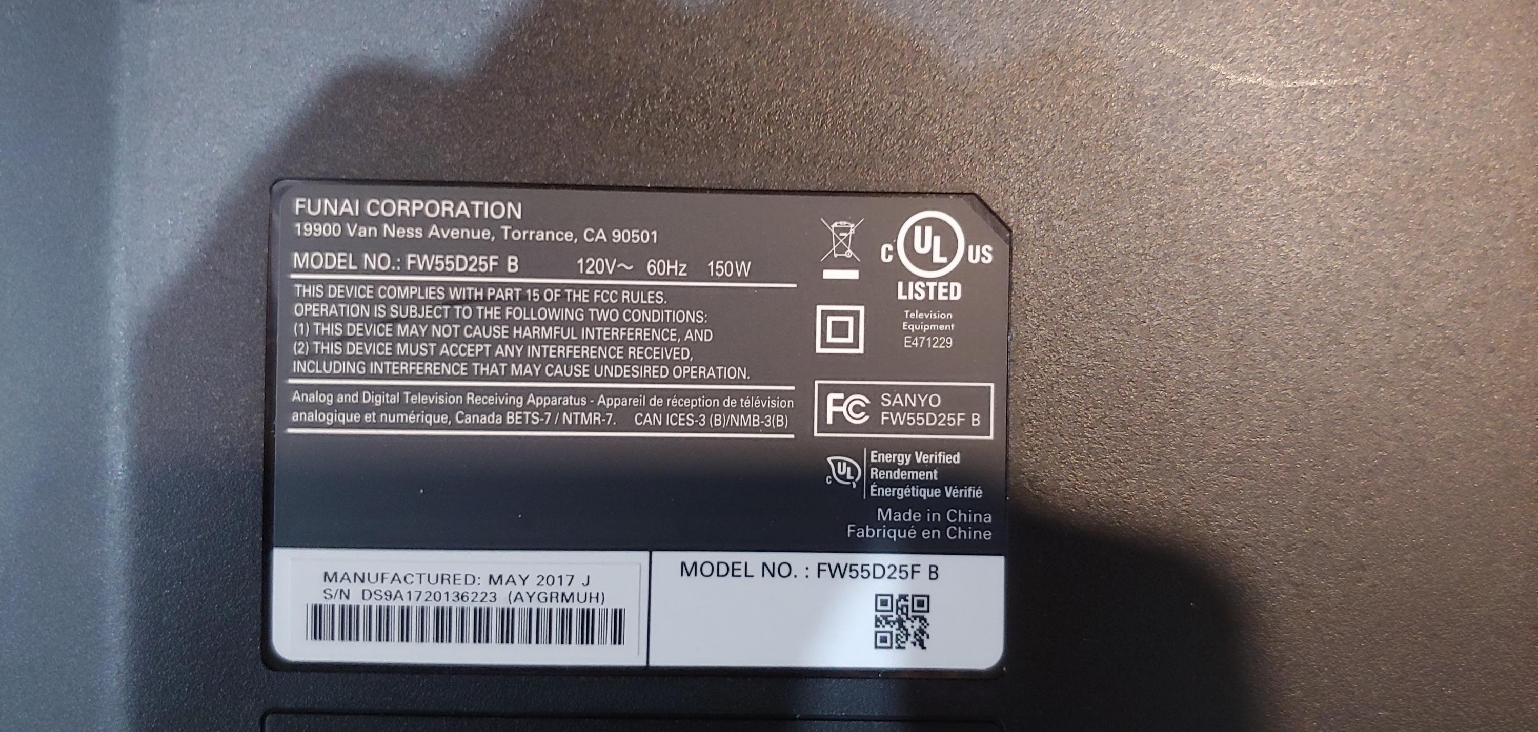

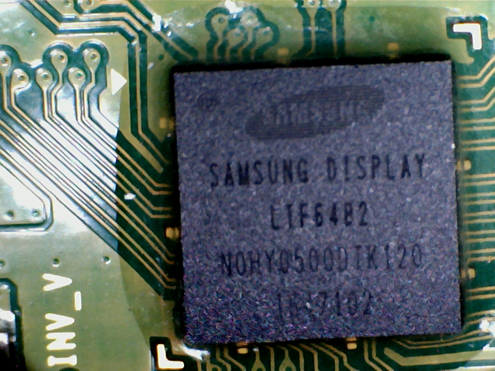

                            here are the panel number and the Tv model # so you have all the info on this tv that i do.

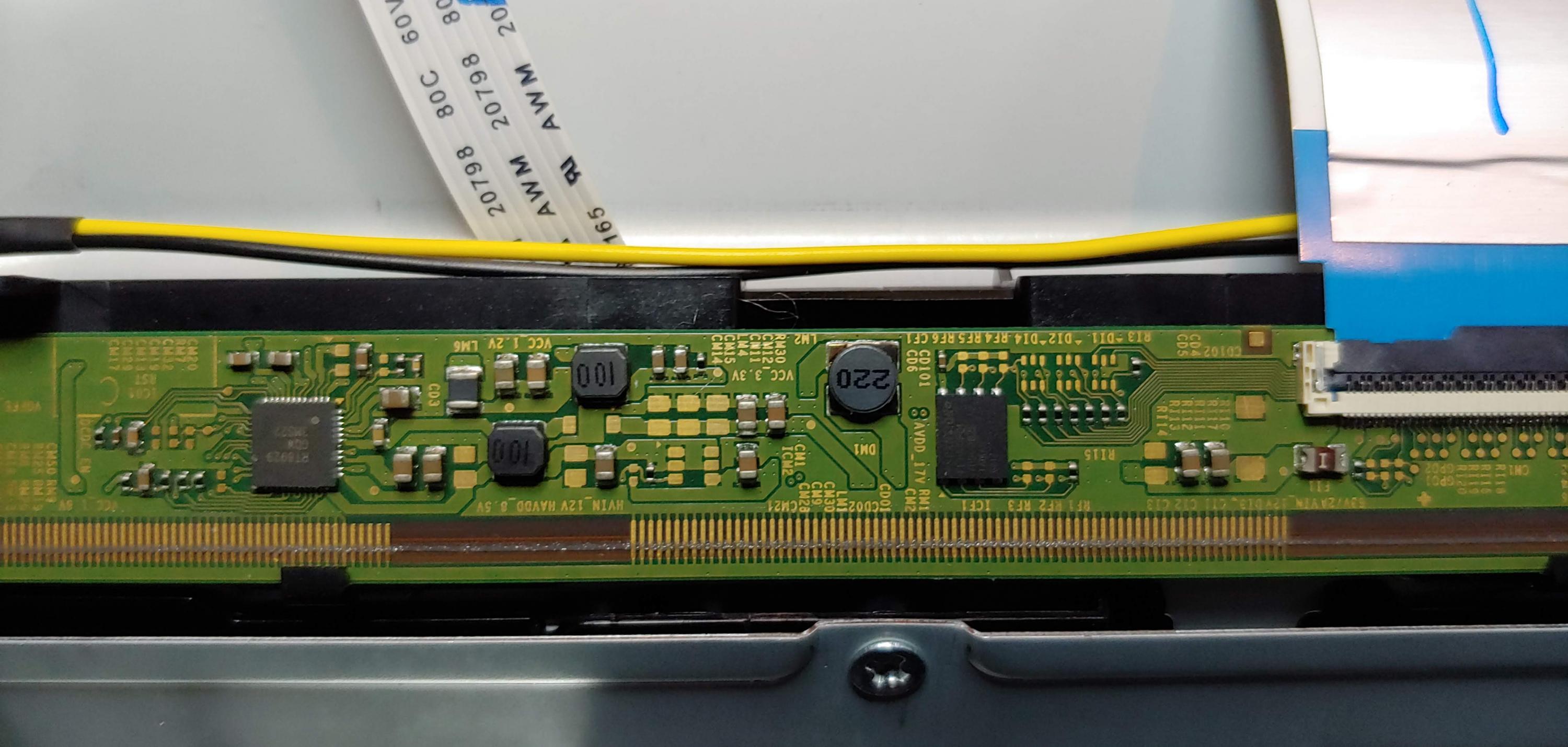

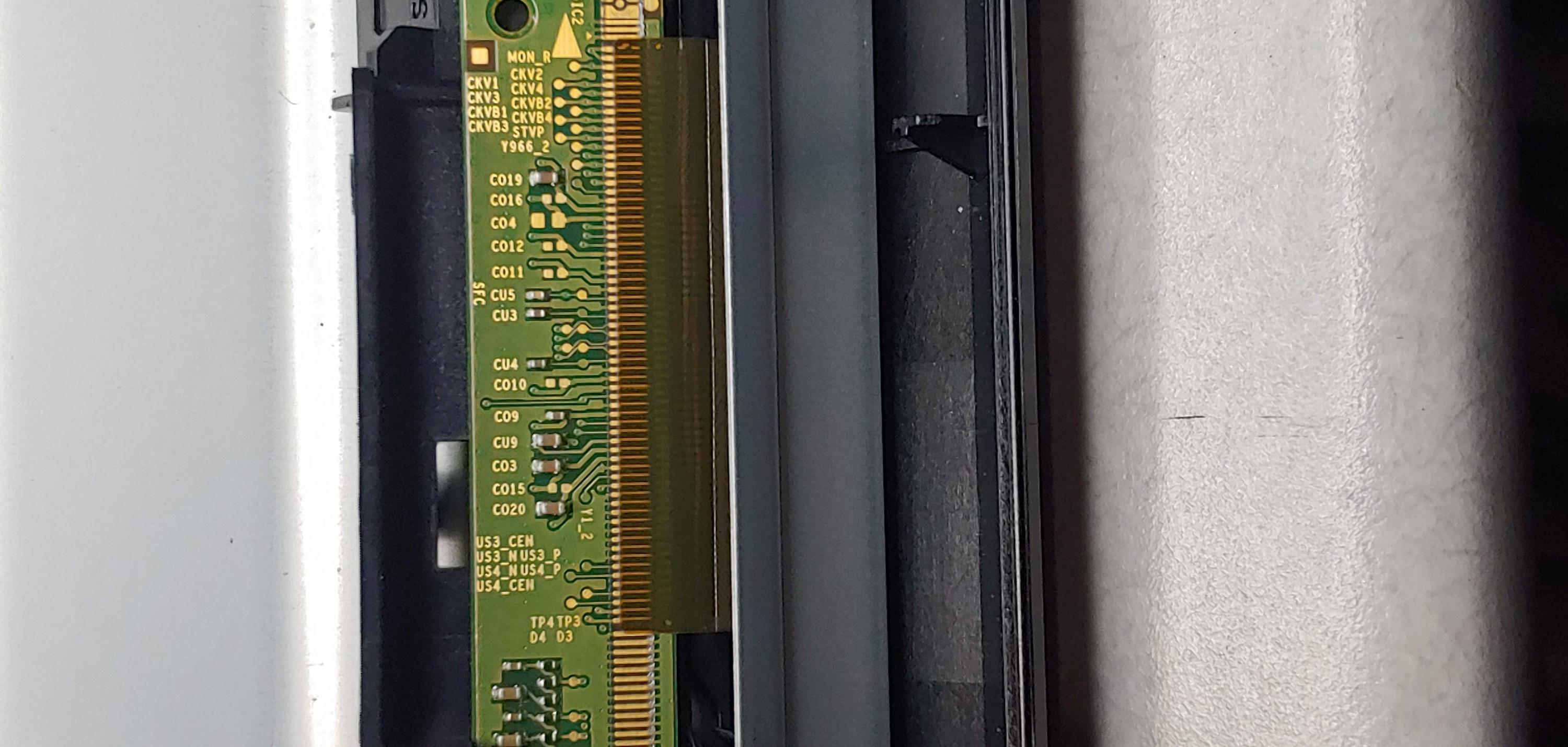

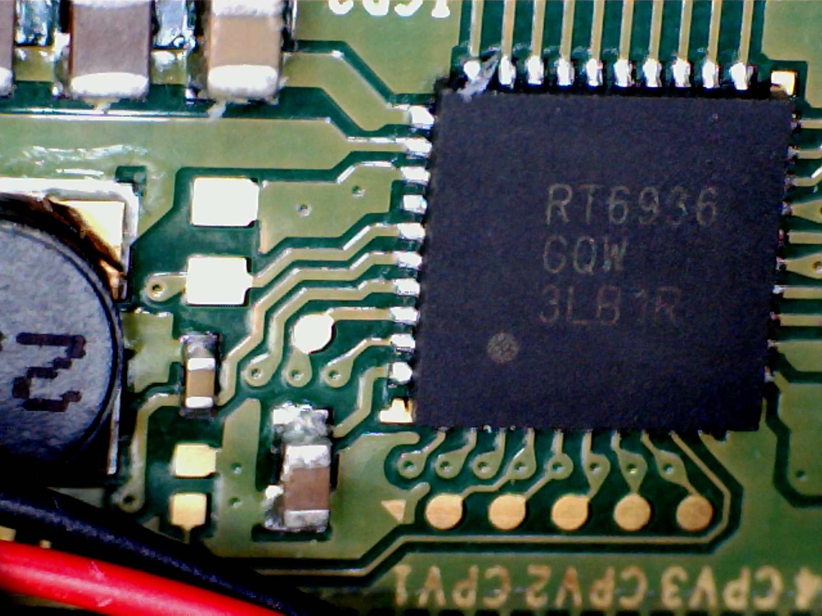

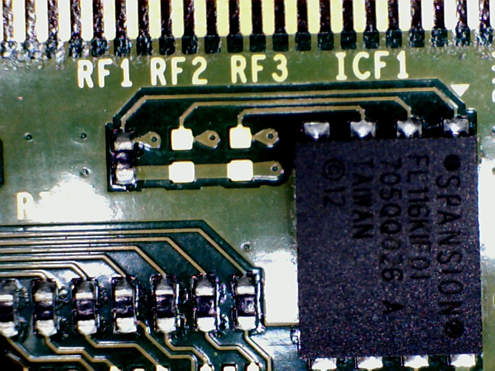

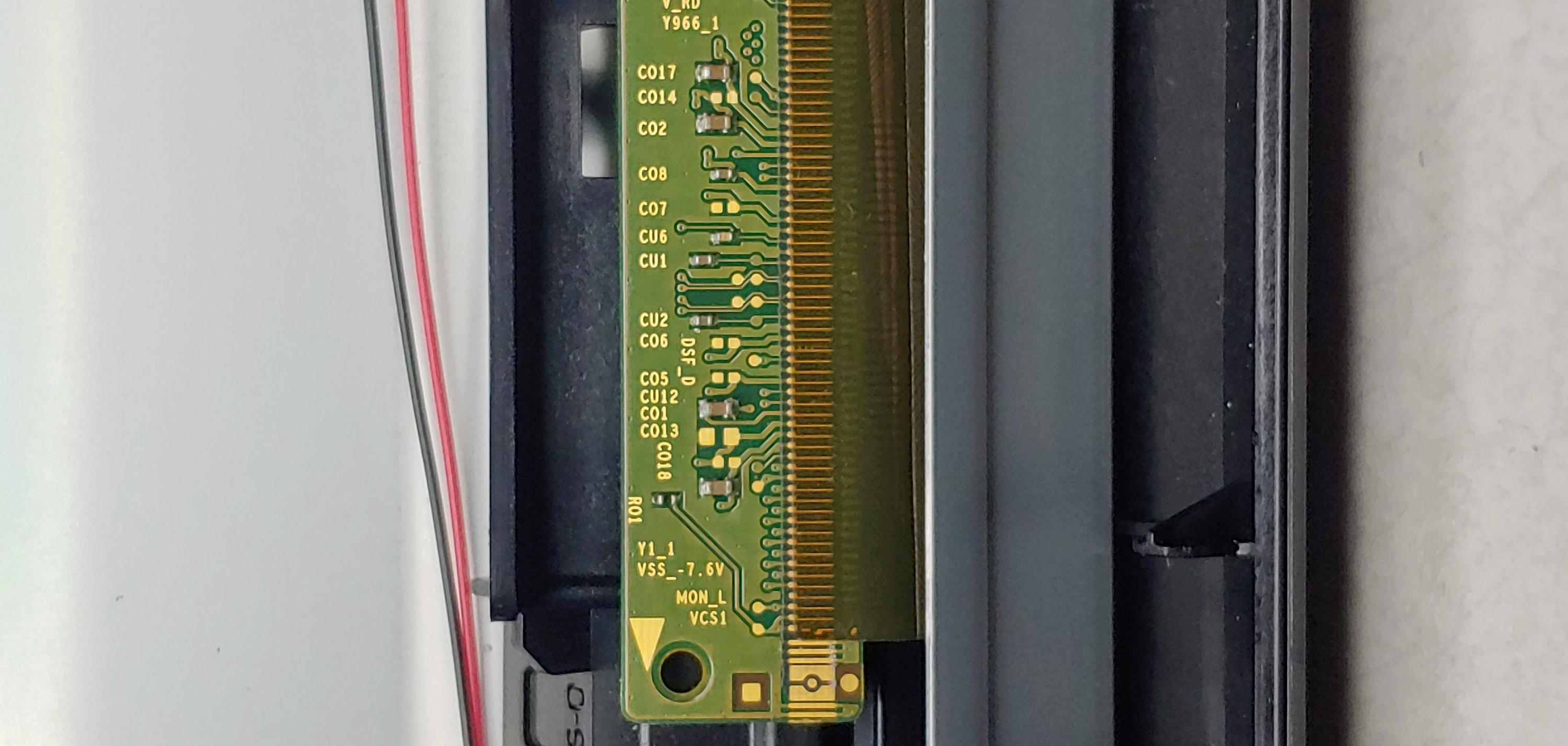

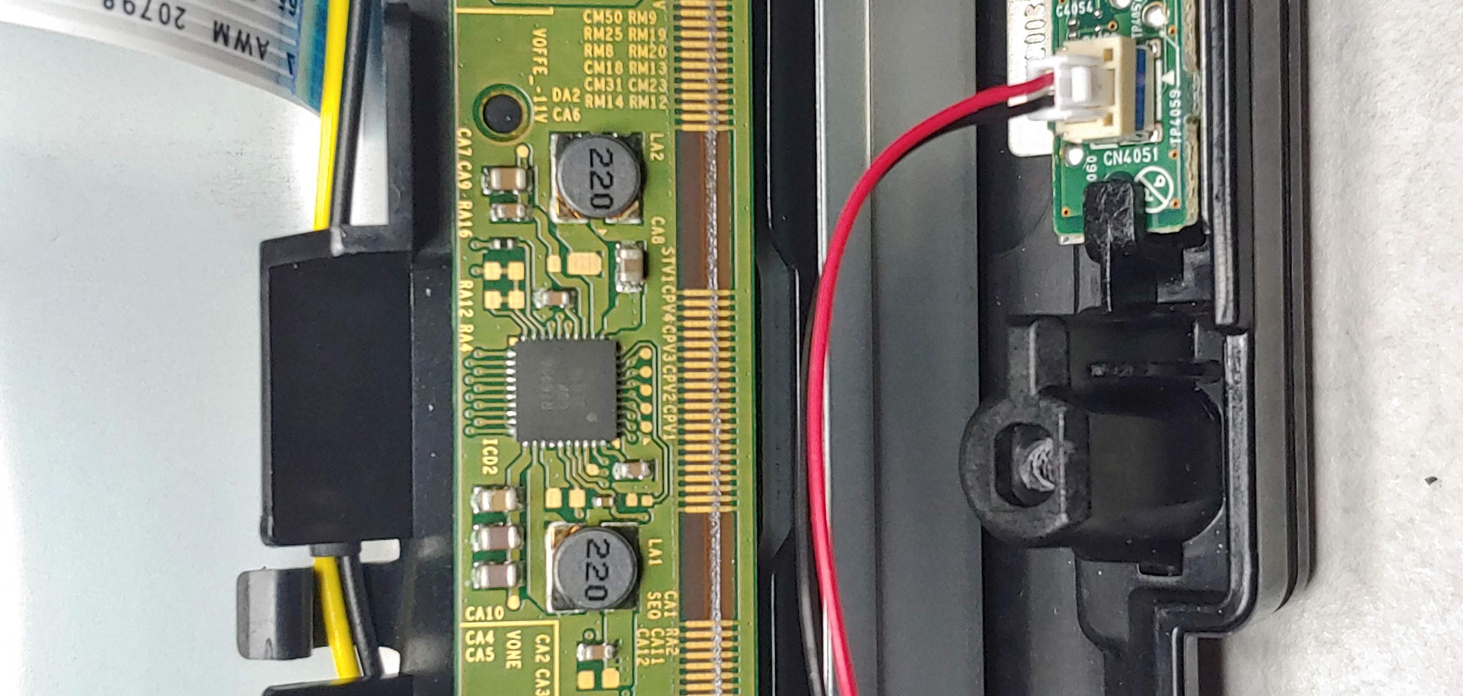

                                Ok, I check the capacitors on the board connected to the screen for short to ground. I found none. I did find 2 capacitors that had no connection to ground at all, they where cu9 and cu12. it was on the long board near the ribbon cable that runs to the screen on one side. the other one was on the other end of the long board near the ribbon cable going to the screen. I also check to see if any of the coils that are on that board to see if any would beep the multimeter. ground lead was on metal frame of them the other was put on all parts contact areas of the coil i could see and only one sounded, that was LA2.
                                • Unspun01
                                  • Jun 2011
                                  • 349
                                  #36
                                  Hmm. Cu9 and cu12 look like they're not connected to ground from the pics. If none of the capacitors read as a short that's a good sign.
                                  In case you are wondering why I asked you to measure across all capacitors for a short it's because these small caps are often noise filters to ground on signal lines and a shorted signal line can be found indirectly by measuring at the caps.
                                  The coil LA2 appears to be connected to ground which is unusual so maybe it's limiting ground current at that large IC. LA2 not an issue.
                                  See if you can identify any of the ICs on the boards to locate datasheets..
                                    all of the chips on the board at the bottom of the screen. That way if anyone else has his issue they will have these images to compare.
                                          Have not had much luck on the datasheets and pinout / schematic for the ic's. I am getting voltage on each side of the fuse on the tcon/the long board connected to the screen.
