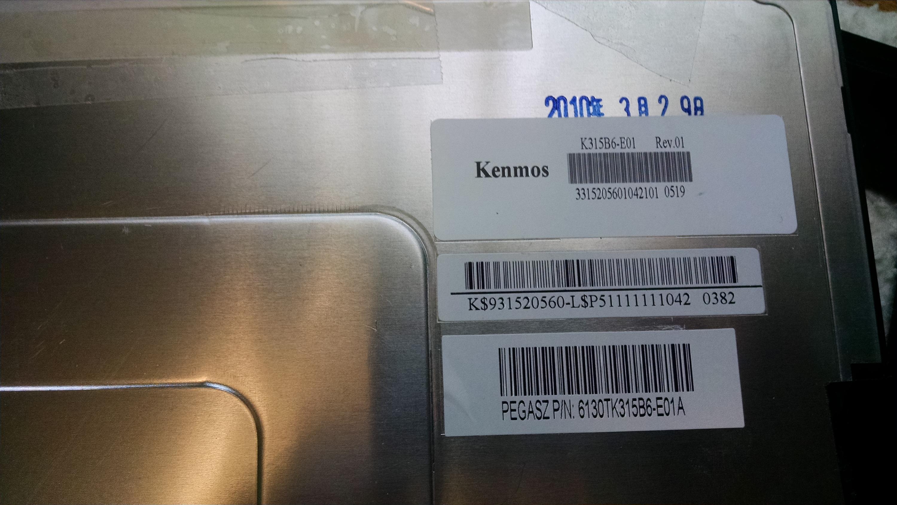

    I need some advice on a main board replacement for a Westinghouse LD3255VX 32" LED tv set. It was totally dead when I got it. No signs of life whatsoever. After googling it, and no luck on the problem even close with the exception of bad caps forum, I feel that this might be the best place to ask this question.
    I bought a replacement board for this TV off of eBay, and did not even notice until I hit the "buy it now" button that there are 3 different boards for this model of TV. duh~
    Anyhow the listing states that I may have purchased the wrong board for this TV since there are multiple versions. It does however list my version number(TW61301-K032A) as a fit for this board in the listing. The board I removed is a 60EB3UM12A and the board I bought is a 60EB3UM12C. Like an idiot I did not even think that there was likely several versions of this main board, and am wondering if I need to return this while I can (30 days) and order the 12A board.

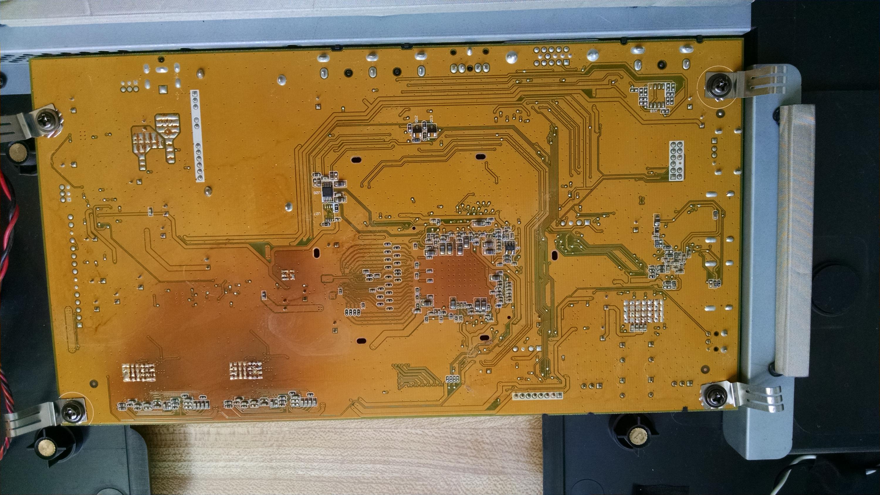

    Oh, BTW, the original board is a dead short with the PS plugged in, and looks totally cooked from the burn marks on the back. Voltage at the PS jack goes to zero volts with the PS 19V DC 4.7A plugged into the board. This is defintely a throw away type board. I have trouble even reading the chip markings, much less soldering on new components.

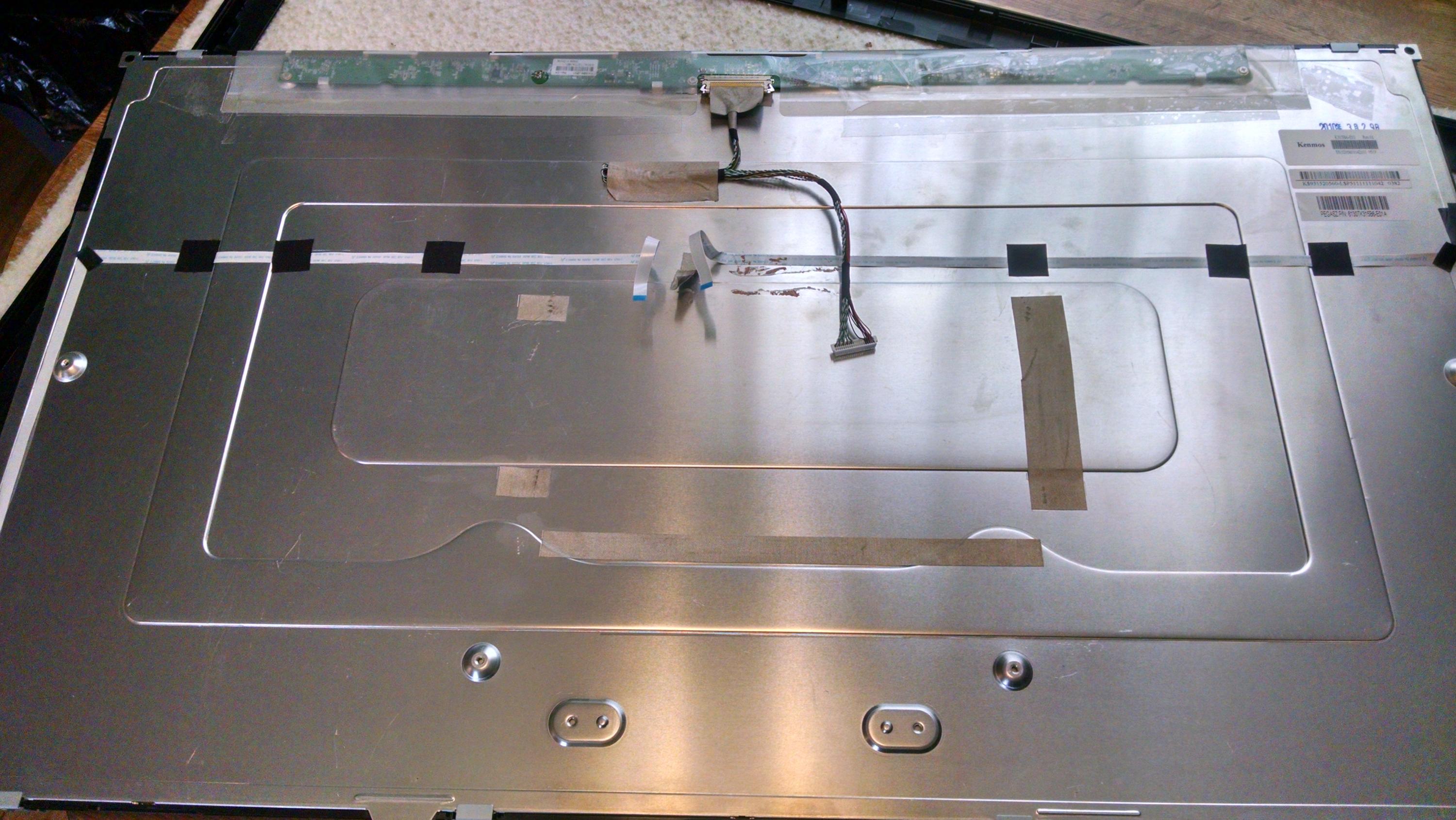

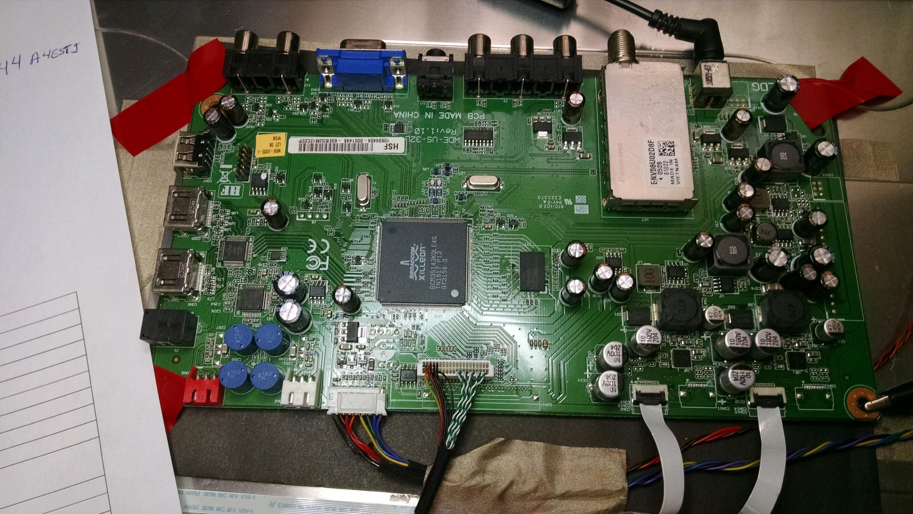

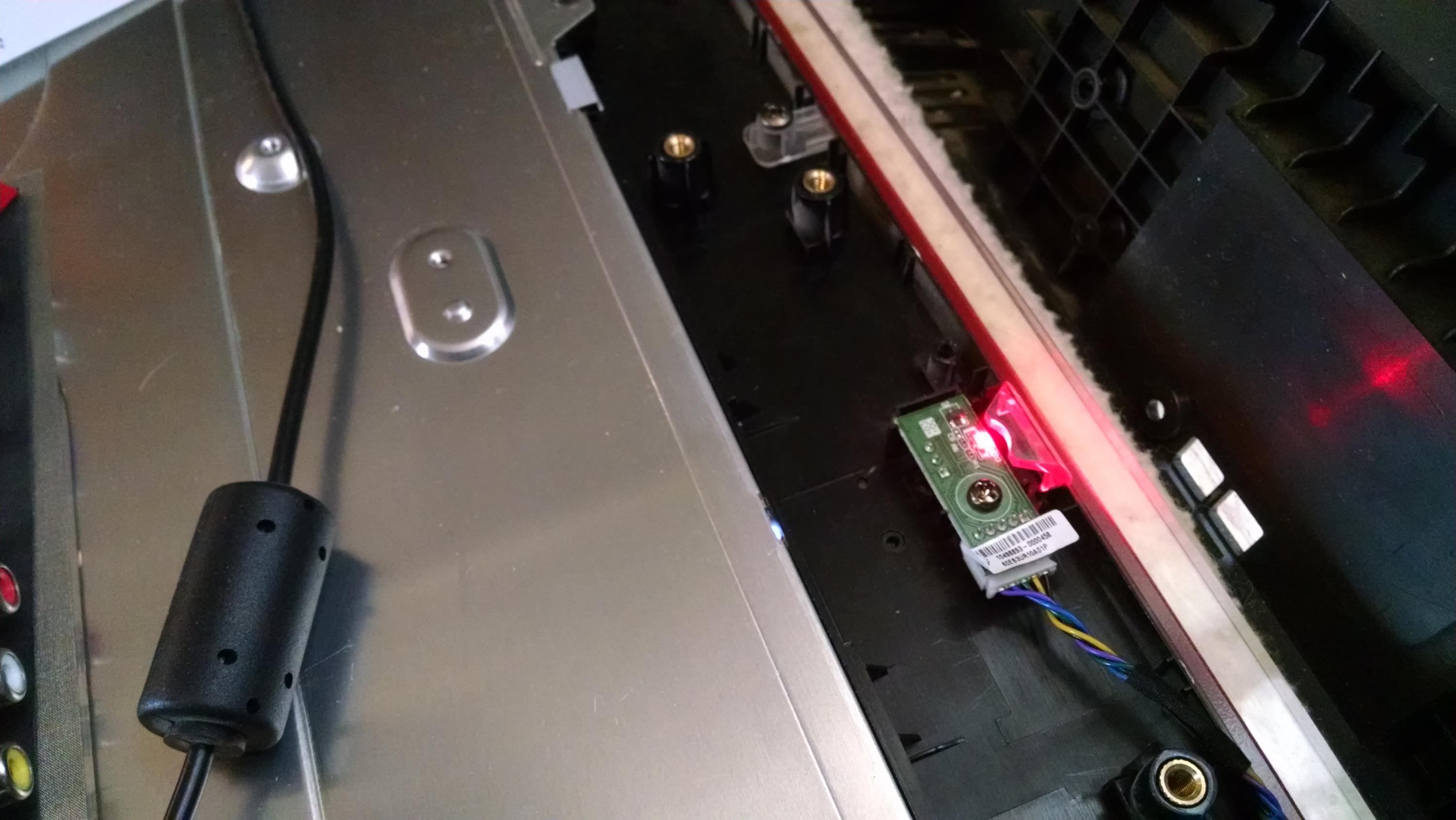

      All of the connectors and ribbon cables seem to plug in properly. The front red indicator comes on as it should with the new board, but no back light LED's or visible picture. I can't seem to find a pic using a flashlight either, but it has marginal batteries, so am unsure there.
      I haven't probed it very much, but at first checks, I am getting 19.2 VDC PS voltages at both sides of D21 and D22.
      I completely disassembled the panel today and used a 5 VDC power supply and some needle probes to test every one of the 80 LED's that run across the bottom of the display panel.. inside the display. All 80 LED's work. I would assume if anything were shorted, it would also not allow the corresponding LED to light when power is applied directly to the LED.

          That LCD panel uses Edge lit LED assemblies, sometime those fragile ribbon cables which go into the panel to the LED assemblies have insulation nicked so it is shorted to the chassis. You should check the resistance of each pin of the cable to see if any of it is shorted to chassis.

              Thanks to everyone for the replies. I did try several times to call Electro parts to ask if the A and C boards will interchange, but not once had anyone answer, nor return my calls. Of course in this day and age of scam after scam phone calls, and google voice telemarketers, if no message is left, any call returned may be shrugged off as another identity theft scammer. 6 freakin calls TODAY! <sigh>
              From my understanding from reading the thread that Kg74 has on the same TV, it's my understanding that the eprom software is the only difference between boards, so I ass-u-me that the TV should boot and run, except it might have a few gltches from the wrong software. at least the back-light? Is this thinking correct?
              I did notice the other day that half of the back-light LED's flicker briefly on one side and the cathode (dimpled edge) voltage on D21 hits~56 volts for a few seconds, drops to 19.1 volts, then dies. It seems the same problems listed in this thread also apply to this TV. I have read through it a few times , but just recently started to troubleshoot this TV. The SMT stuff can be pretty intimidating, since I can hardly read the numbers, but I do have a magnifying lamp and a weller heat gun. :-)
              When I first started looking at this dead set, I ran across all of the info on the ribon cables being shorted, but was unable to locate any shorts to chassis, and also pulled up the glued down ribbon cables and added in a small piece of electrical tape to the sharp edge to prevent them from shorting. No shorts were noted with my harbor freight elcheapo meter. I also have a set of sharp probes that I have had since I was a flight simulator tech made out of thin piano wire stuck into a ~.5" wooden dowel, then sharpened that I could slide into most any aircraft plug to check circuitry that work great on this tiny smt stuff.

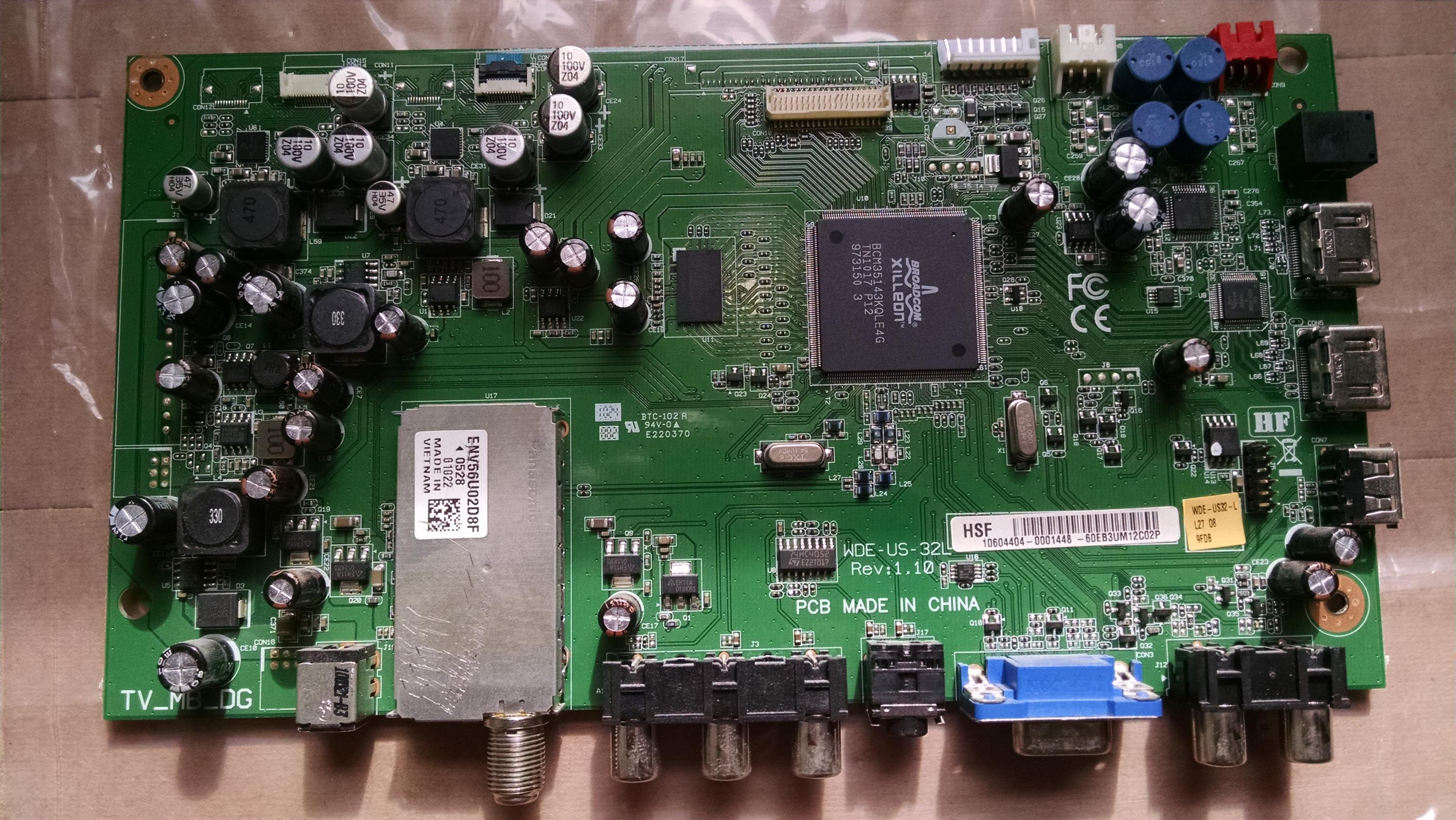

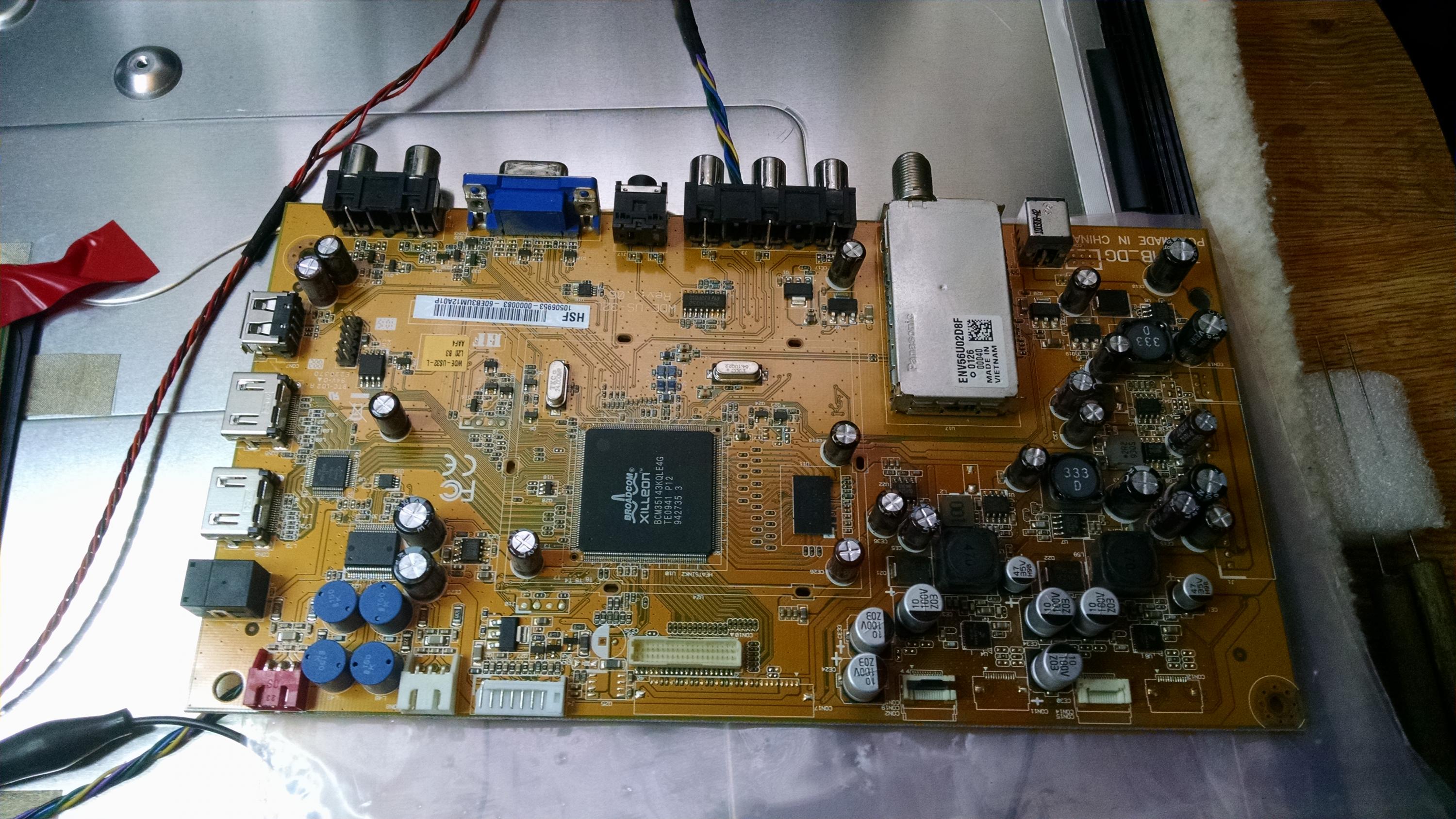

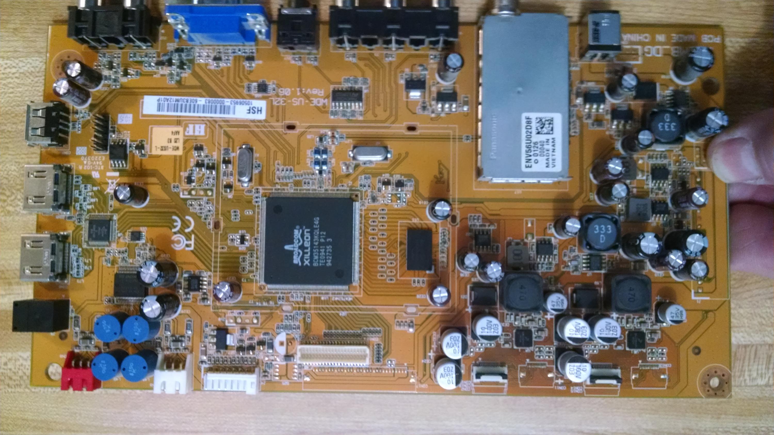

                    The C board is the only one showing ANY signs of life. The old board is a dead short to the PS, and the 19.2 VDC drops to millivolts when I plug in the old board. My original post was made after I had already installed the C board, but had no back-light.
                    I did notice the other day that the back-light is working on the left side of the display briefly (flickers for a few seconds, then dies and the voltage on D21 cathode slowly drops to 19-24 VDC) It appears the TV has to be plugged in for a few minutes before the back-light flickers. I can switch the ribbon cable from the right side to the left and then the right side does the flckering, so it appears that both LED strings are not shorted. (bottom of panel 1st pic by the red indicator led)
                    The C board is green and appears to be exactly the same board as the A board.
                    The original board is tan with burn marks on the back. I had no PS voltage at all with this board installed. Hence the reason I ordered the new board.
                    In general, I have had good luck with buying boards off of eBay. I can not find the right board for this set, and I am not sure what panel should match to the A or C boards, but I ass-u-me,at least the leds should light up.

                        The 34844 pad to ground is a major pain, that is why I used air on top and heat below. Mine was a labor of boredom and a cold winter.
                        You have two approaches here: 1) try to fix the original board "A" which you know at one time worked or 2) work with board "C" which "allegedly" works.
                        For option 1, you need to put the board back to its original state, if you only played with that one connector - leave it for now and focus on getting one channel to work. It sounds like you have no power at all on this board.
                        You are going to have to start trouble shooting here, looking for shorts and failed components. Here the forum heroes can help - they understand this stuff in ways I do not. My main advise is pick your path and follow all their instructions and suggestions in a timely and exact manner - especially if you pick option 1. Their time is valuable and they actually invest themselves in solving your problem. You cannot disappear for a few days - you have to report back timely or they will lose interest and move one - never to return.
                        For option 2, I would swap over the EEPROM. Take the "A" board EEPROM and move it to the "C" board. I don't think this is the issue, but it takes one thing out of the equation.
