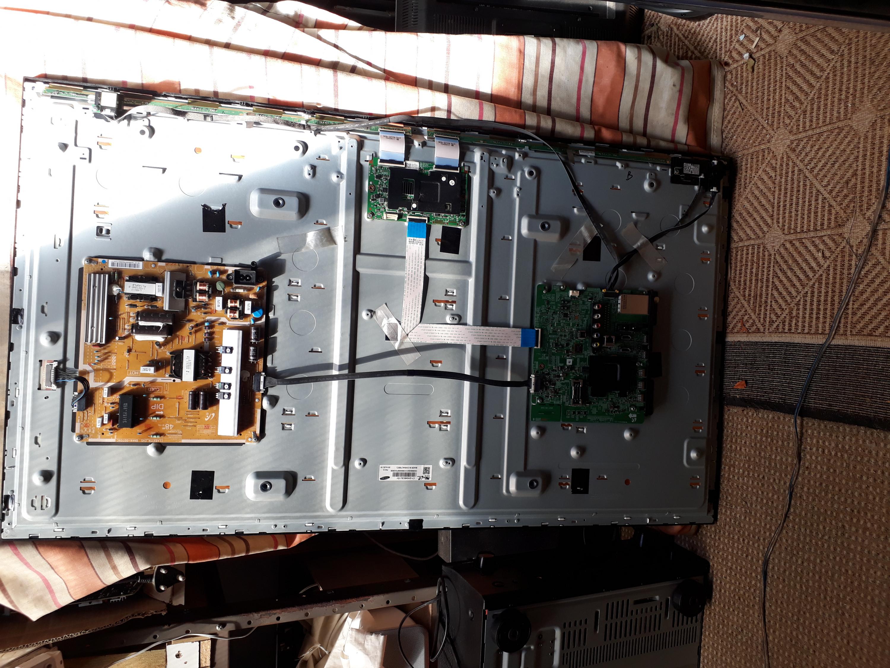

    Hi
    I have a samsung LED TV ua48h6400. With a back light problem. Checked the Leds and found they all light up. When reassembling set I switched it on with the Screen to TCON collectors not plugged in. On checking if both connectors are plugged in. LEDS do not light up but with either one conneccted singly the Leds are on. Is this problem being caused by the screen?
    Jim
    Re: Samsung UA48H6400 Backlight Problem
    post a picture of the resulting display with either of the cables disconnected and also feed in a signal. That may indicate whether there is a different issue that the led backlights.
      Please upload pictures of the whole backside of the TV showing all the boards.
        Thanks for the reply
        there is no display with either of the leads connected, although the back lights are on
          this is a picture of the back of the set
