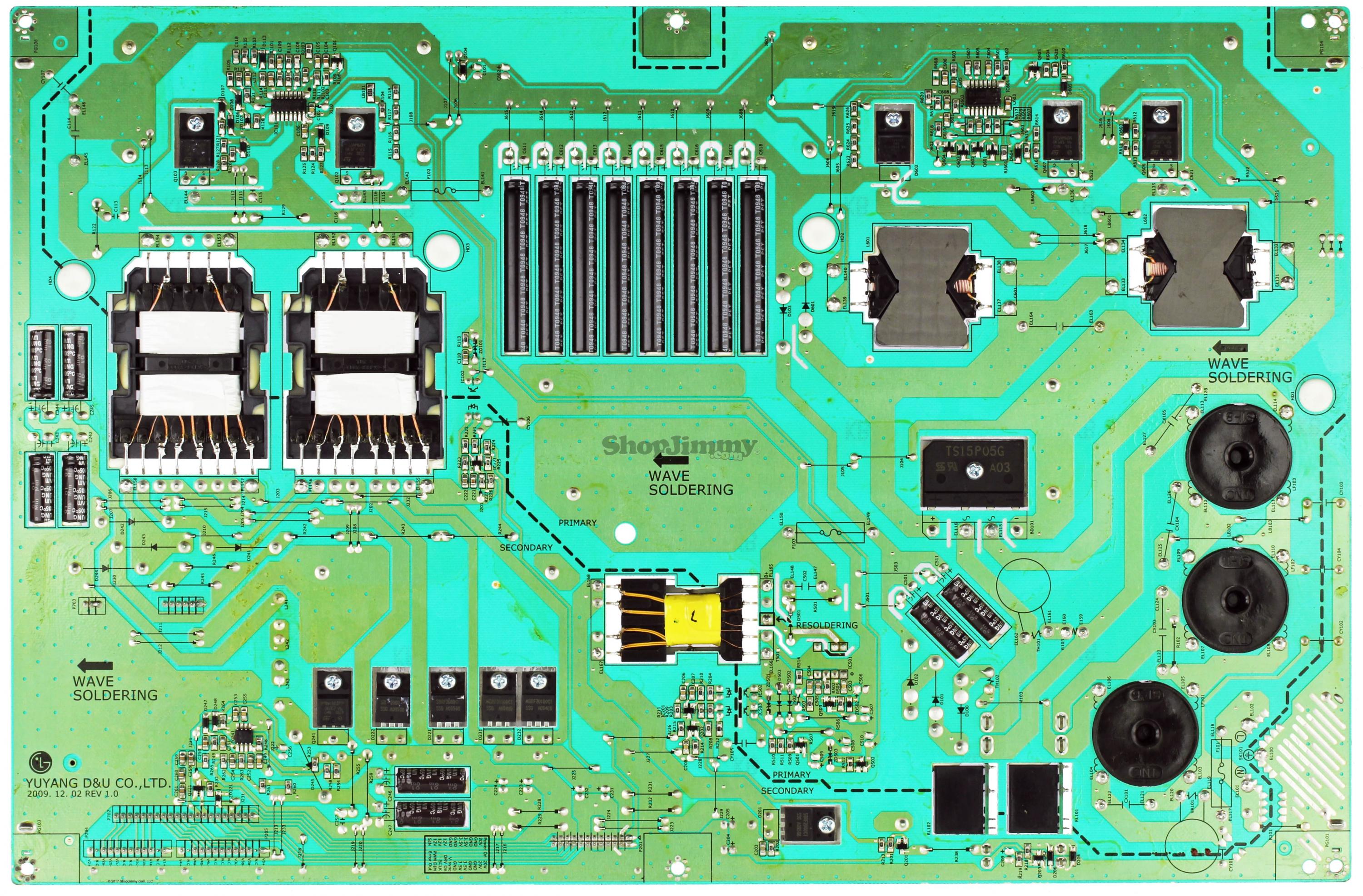

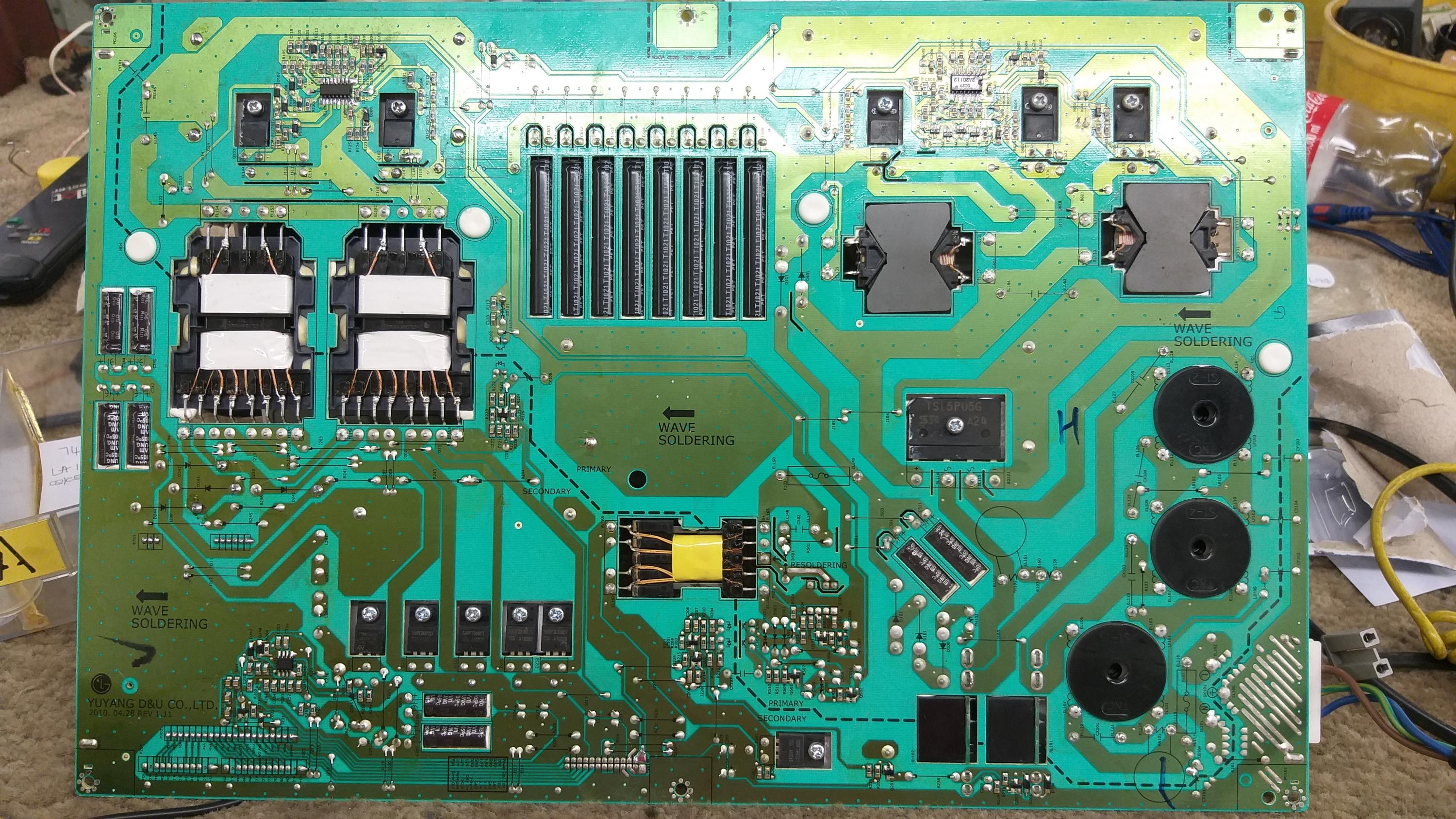

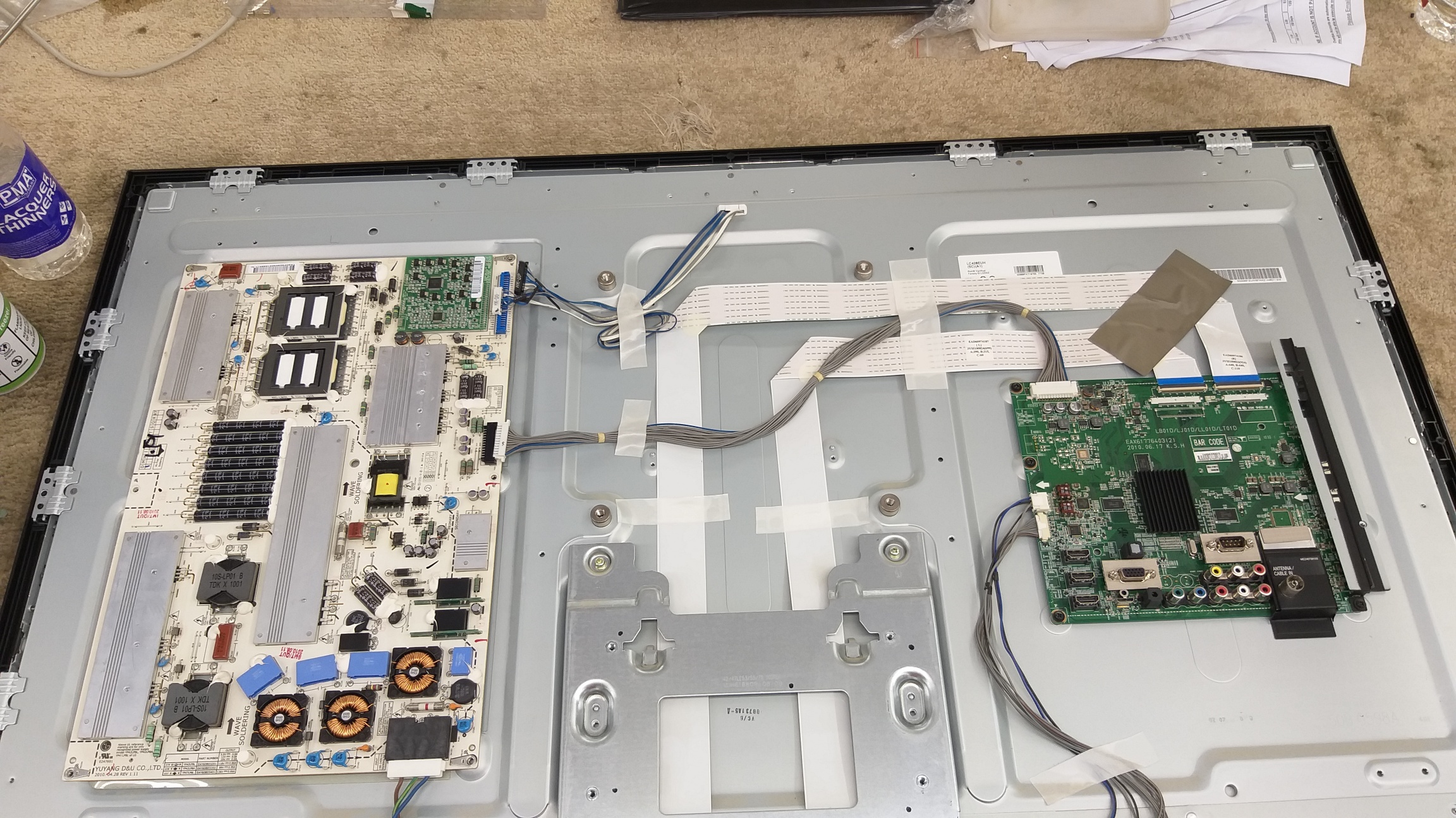

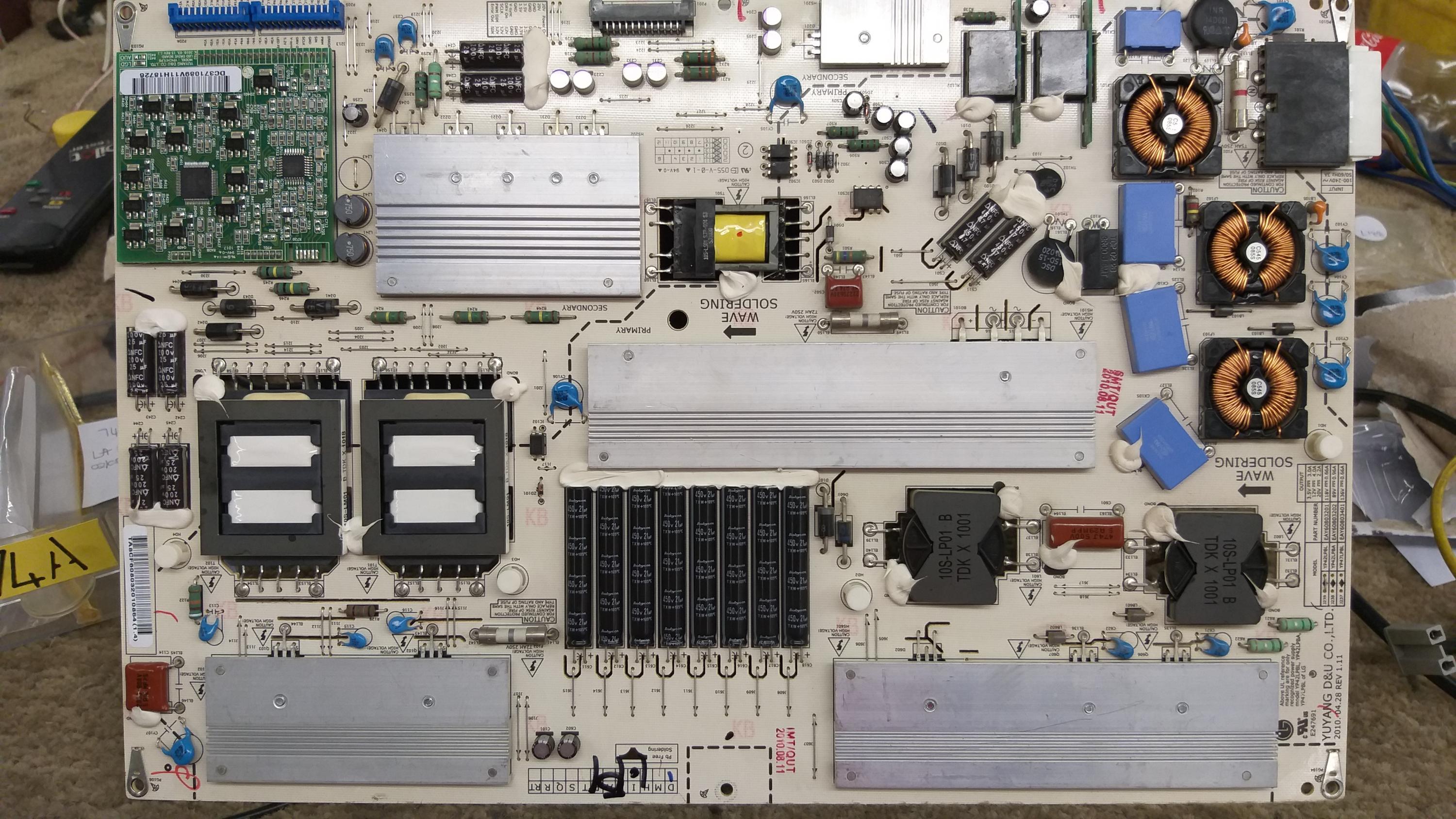

    Hi Guys,
    I have another unit that's beating me up here.
    This set starts up and is in standby mode. Upon pressing the power button the set makes a relay clicking sound and then the on board "piezo speaker" which sounds when pressing any of the on board buttons starts making a long beeping sound. In the mean time the secondary voltages (those that should start up when pressing the power button) do not come up.
    This is my findings so far.
    1. When adding a 680 ohm resistor from +3.5V rail to the "Power ON" pin to force PSU secondary voltages on my PFC circuit does work because my mains smoothing cap voltage goes from 330VDC to 393VDC.
    2. The power supply section responsible to generate the secondary voltages is operated by a L6599D. I scoped the gate drive pulses on switch on and i could briefly see some square waves but it shut down.
    3. I then checked all secondary diodes for short. Only thing i saw was the Schottky diode is leaky in reverse bias but that's normal.
    4. I replaced L6599D with no difference
    5. I checked opto coupler and zener on the feedback circuit and found no fault. There is however a SMD chip with a marking "438" which is 3 pin and might be a SMD type KIA431, not sure could not test.
    I have added pictures as needed to assist you in your diagnosis.
    All tests above were done without the main connected and PSU forced on.

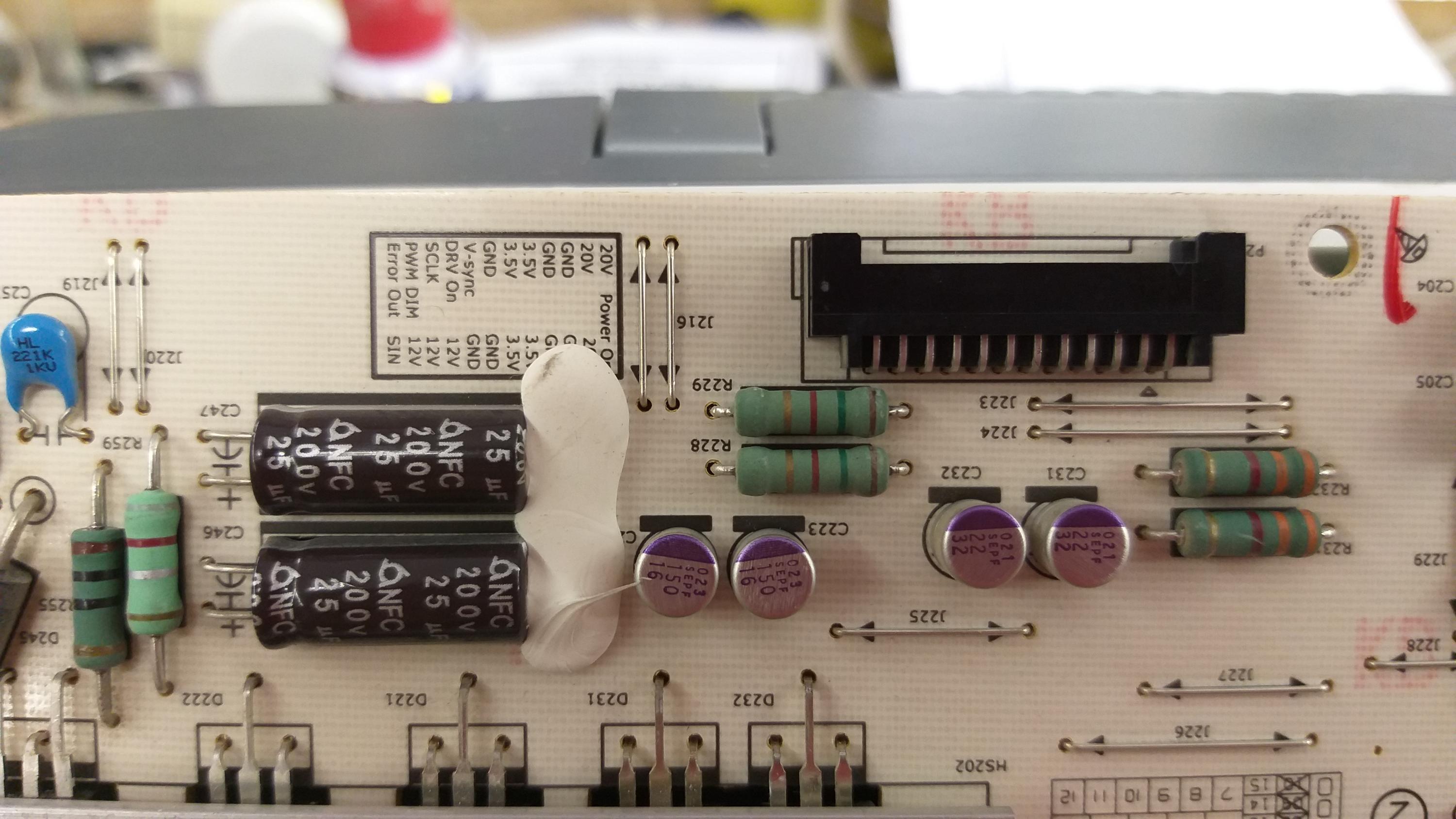

    Re: LG LED TV Model 42LE5300 not switching on
    I have added the PSU to main plug voltages whilst all boards connected and wrote down both standby and power on voltages

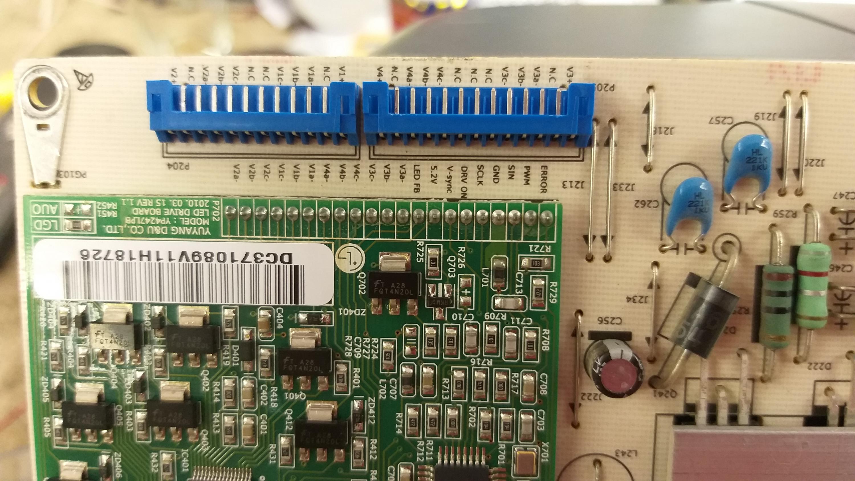

            You also do not have DRV-ON (BL-ON), Dim controls.

              Hi Budm, yes the PS-ON and boosted voltage is correct (PFC = 390V). I dont get the other voltages that are 12V, 20V etc coming from those two transformers that look identical.
              There are 3 fuses all measuring correct.
              I do not get the DRV-ON from the main (perhaps as a result that the 12V does not start up to feed the main???)

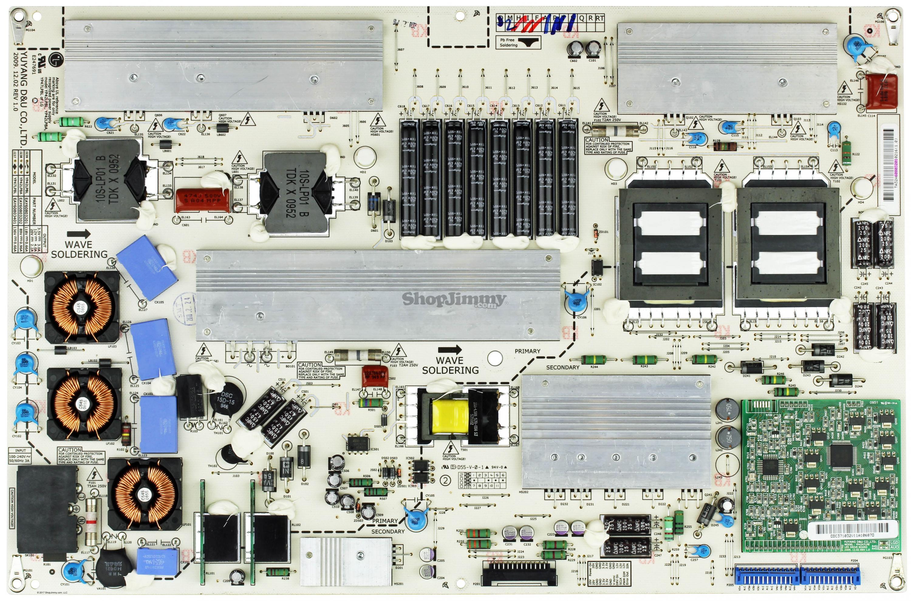

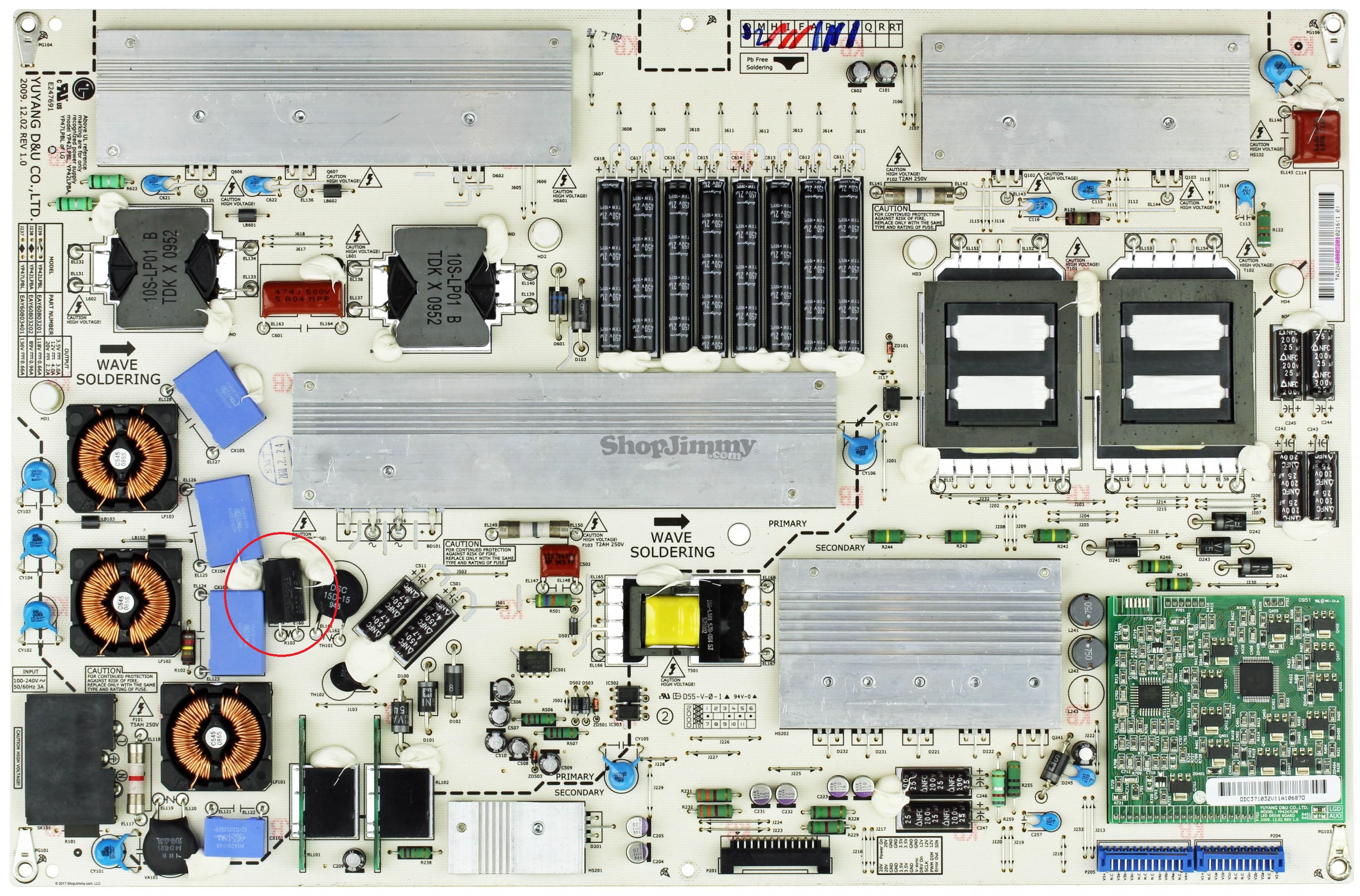

                PS-On signal is response for turning on the PFC, the switched 12V, etc. so we need to find out why those two large power transformers are not being driven.
                Is the L6599D getting the VCC Voltage to run?
                What Voltages do you have on Q102, 103 pins?
                Is R219 OK?
                Is C114 OK?
                Also check the resistance of R115 ~118 which are for Line sense on pin 7 of the IC that monitor the PFC Voltage, it will shutdown the IC if it thinks that PFC Voltage is too low, but isnce your PFC Voltage is OK but the resistors have drifted up in value then that will cause the problem, look at the spec sheet of the IC as to how pin 7 functions and what Voltage it should have on that pin.

                  Looks like C256 and R259 have heat damage?
                        Hi CaptainKKK,
                        Cap C256 is a 47uf 25V cap measuring 48uf and ESR of 0.5 ohms
                        R259 is a 10 ohm and measures 10 ohms. Some of these resistors have a dark background color, even on the shopjimmy photo of the same PSU they are darker.

                          Hello Budm, i checked the following,
                          1. Is the L6599D getting the VCC Voltage to run? Yes 13V on the VCC pin.
                          2. Resistors R115~R118 each measure 1 Mohm as indicated on resistor.
                          3. What Voltages do you have on Q102, 103 pins?
                          Q102 G = 0V, D=390V, S = 0V
                          Q103 G = 0V, D = 0V, S = 0V
                          4. Is R219 OK? Its a 1 Mohm res measures ok.
                          5. Is C114 OK? Bingo...................... Measuring in the picofarads.
                          This is a 203J 800V cap. I assume 20nf @ 800V. I need to find a replacement
                          and i am wondering if this will be the only fault. Anything else i must check for? The mosfets measure fine. If i trigger them the Drain - Source goes short and if i Short all three legs then Drain - Source goes open circuit.
                          Thank you for your guidance thus far.
                          Awaiting your response before i put in this cap.
                            Just an update...
                            I put two 10nf 2kv caps in parallel and wiggled them in so that they fit and voila... The set is working and on test.
                            Thanks Budm, i am so chuffed about this repair. That cap has no signs of failure.
                              Glad to hear, that dc blocking/coupling cap is one of the commonly fail cap in that circuit.
