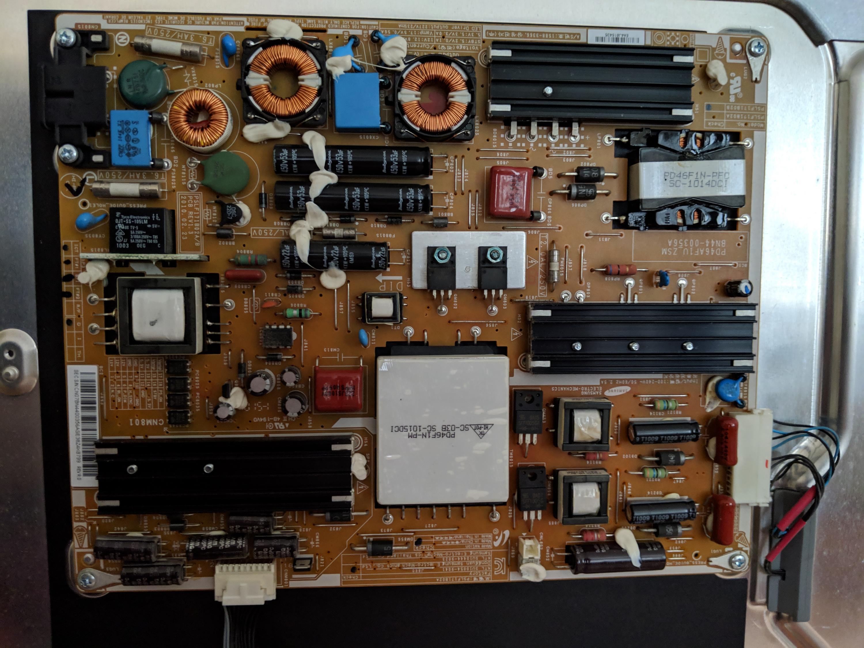

    It turns on, and the welcome chime plays. The LEDs light up, there is a glow on the screen, but no picture is shown.

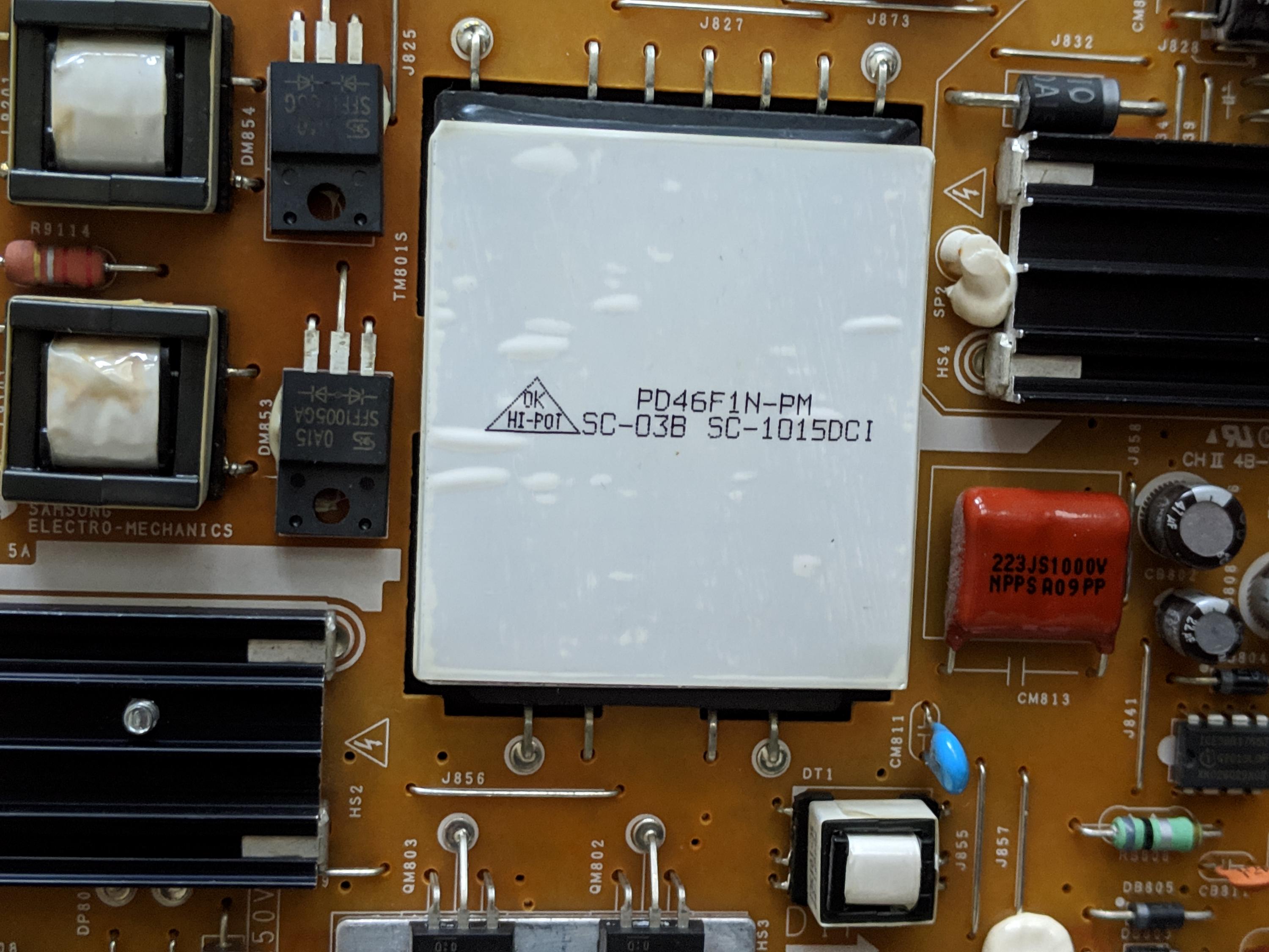

    There is a ticking sound from a large component on the power board that is a coil of some type (easier to see on the back side). It has a white plastic cover with markings -- see pics.
    Power board:
    I inspected all electrolytic caps and none looks obviously burnt.
    I measured the voltages at connector CNL801 (goes to the LEDs, and according to the chart on the PCB they are LED1 +/- and LED2 +/-, with some pins marked N.C). The voltage fluctuates quite a lot between 2v-7v (I could be off, it changes quite fast)
    I measured voltages at connector CNM801 (goes to main board), and based on the chart printed on the PCB, here is what I measured (all voltages wrt ground, i.e., black lead to chassis):
    PIN#-Measured Indicated_on_chart

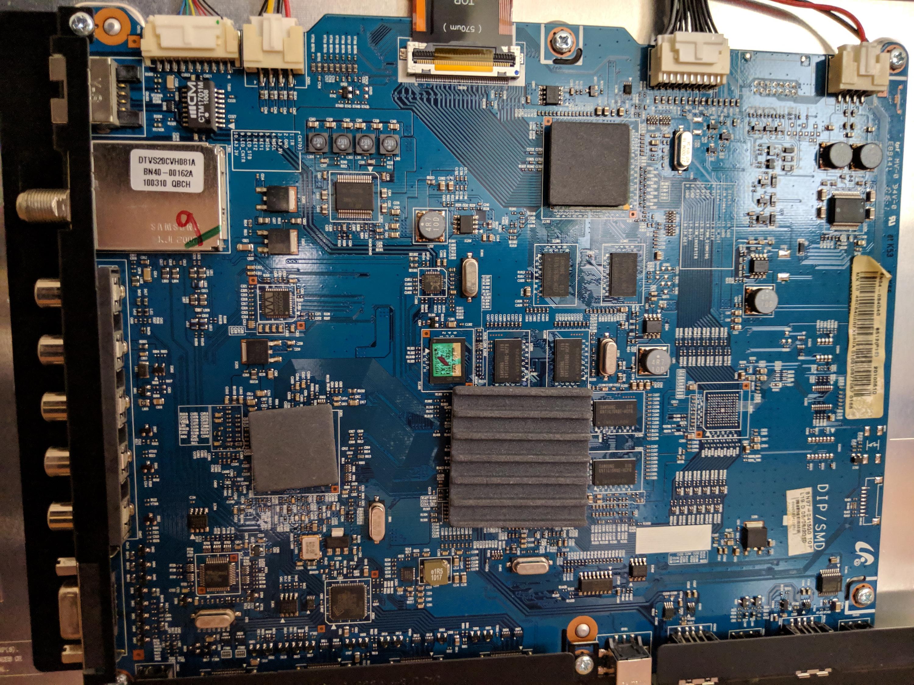

    Main board (HDMI and antenna inputs, ethernet port):
    On the main board, there are a lot of test points on the underside, but I don't know what to test for.

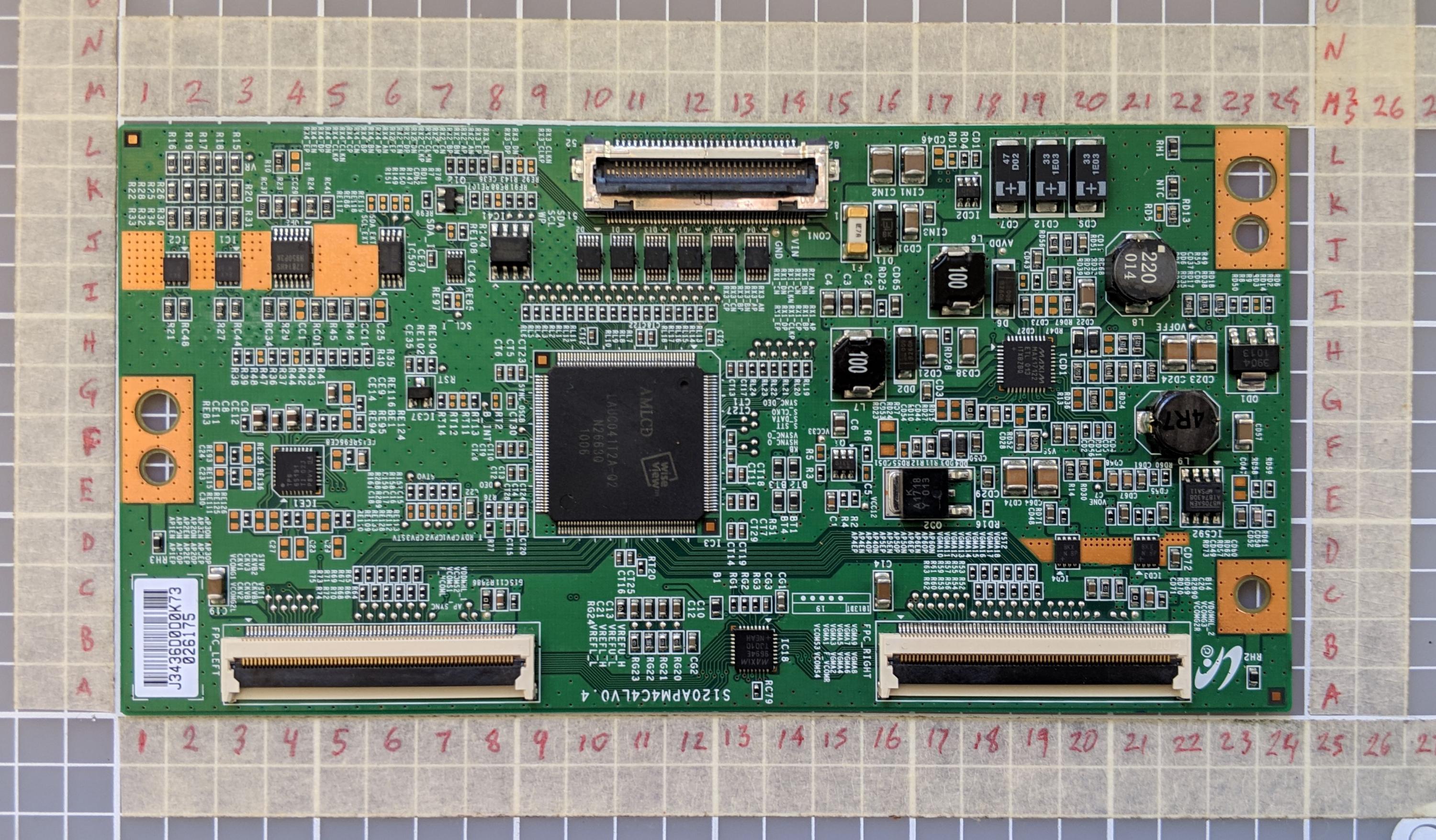

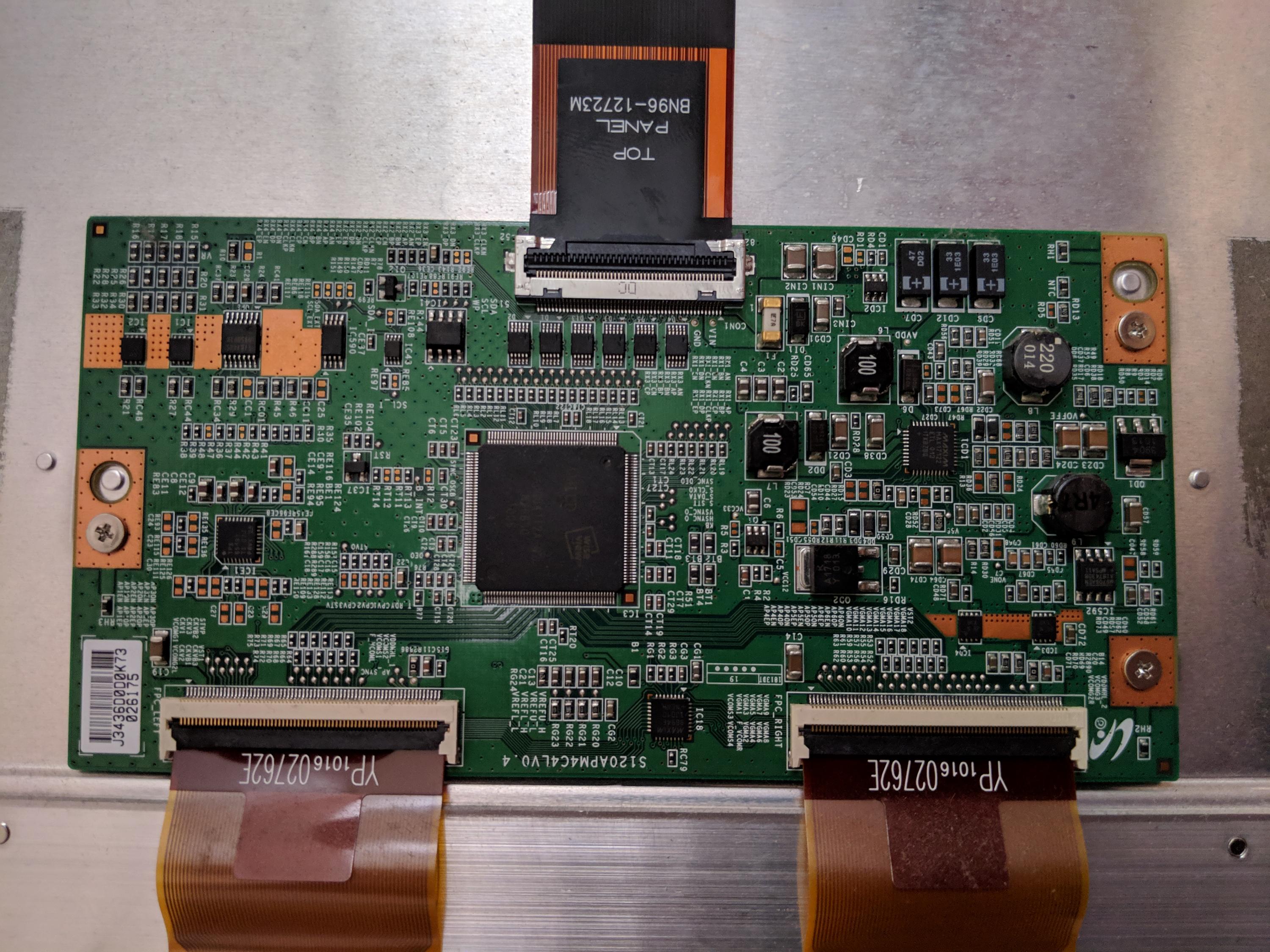

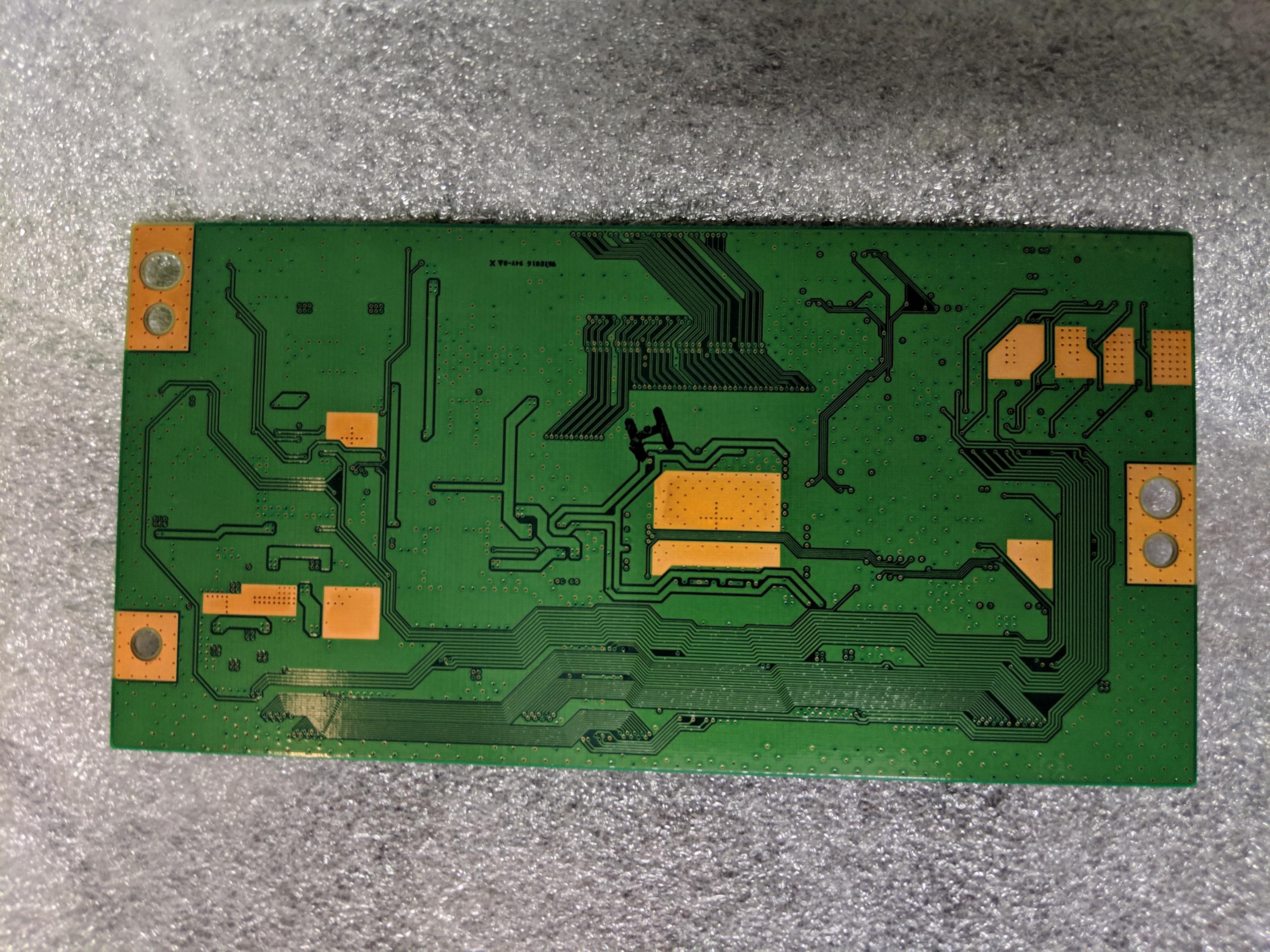

    T-CON board:
    I tested both sides of the T-CON board fuse (white, with gold tips, and it measures 12.46 Volts
    I am hoping the buzzing sound of the component on the power board is an indication that the fault is there.

    Re: Samsung UN46C6400RFXZA audio but no picture (pics incl).
    Please upload good clear pictures here.
      I wasn't able to see the full-featured editor with the "manage attachments" feature when I posted originally.
      - Power supply board
      - Main board
      - TCON
      - component on power supply board that makes ticking noise.
        Samsung BN44-00356A power supply/LED driver board.
        That is power transformer for the LED driver and for 12V, Vamp, and switched 5V.
        Try having the ribbon cable between the T-con and the LCD panel connected one at a time to see what you get on the screen.

          History: we don't use it very much but it stopped working one day.
          What do those ribbon cables from the TCON to the panel map to, horizontal/vertical or left/right? Curious to know what I should expect to see if one or the other gets disconnected.
          also, on that power transformer, is the ticking normal? Any voltage tests I can do?
            " Curious to know what I should expect to see if one or the other gets disconnected": You should see a good picture on half the screen if working correctly.
              I don't get picture on either half when I unplug each of the two T-CON cables on the bottom.
              The backlight/glow will become brighter as I cycle through the input sources (but it is unclear what the current input source is).
              What is next, anything else to try?
                I think that a "picture outcome" is the "optimum"... you are likely looking for a change. Lots of sets display a white screen for the disconnected side. You have checked voltages at the PS but there are also voltage points labeled on the tcon that may help.

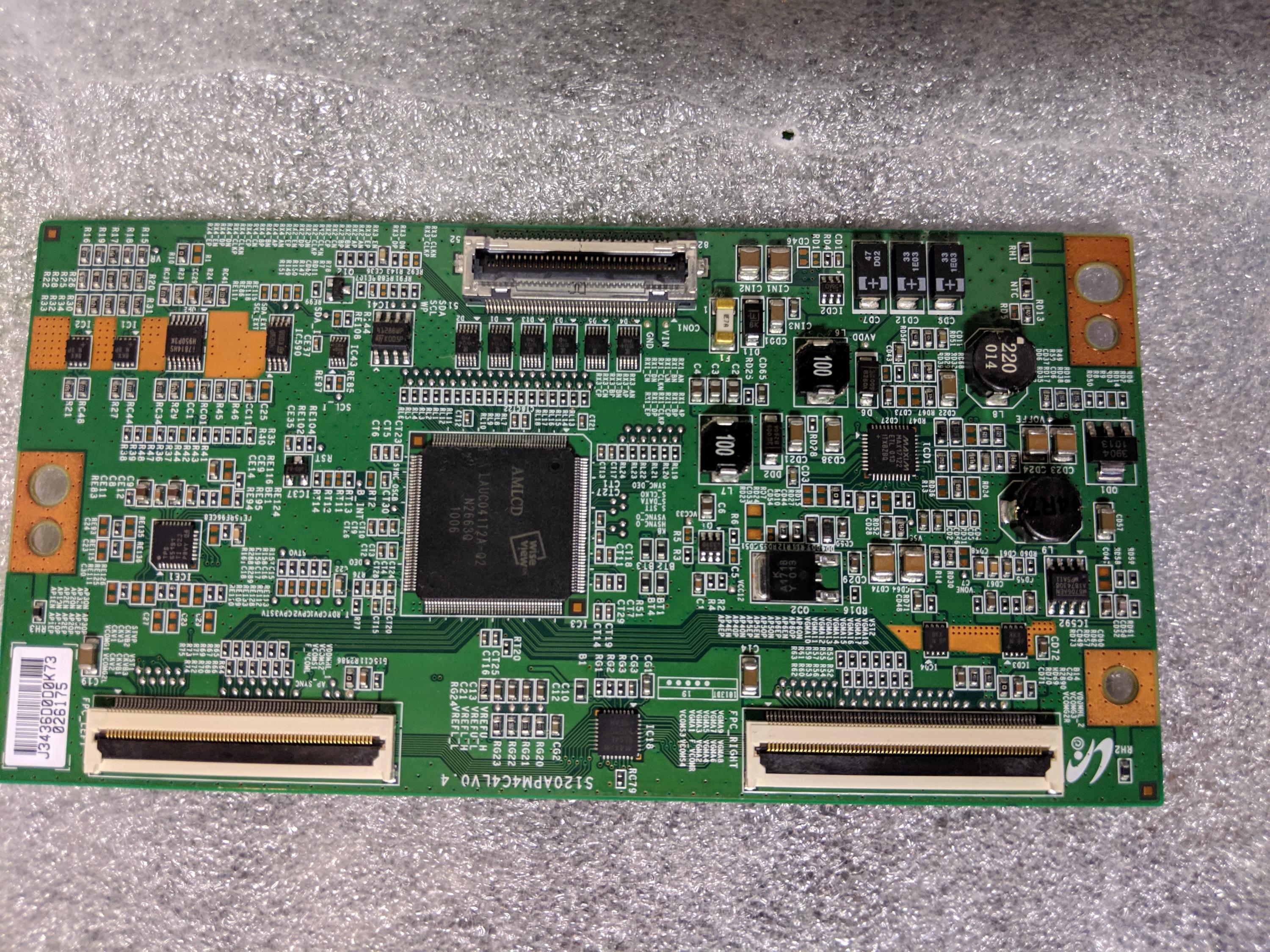

                      The T-CON board, both sides.
                      Any pointers to where to check voltages would be appreciated.

                        Also, I noticed there is a schematic posted by budm. Is this applicable to the T-CON I have?
                        See:
                        https://www.badcaps.net/forum/showpo...&postcount=401
                          Start checking Voltage at the test points, I can see:
                          VCC12
                          VCC33
                          AVDD
                          VCOMxxx
                          VOFFE
                            I am attaching an updated image of the T-CON board with a grid for easy reference.
                            Here are the values I have measured with TV on, and no input sources.
                            Please let me know what other values I will need to check.
                            A big thank you for all this help. I'd lie to save this from becoming e-waste.
                              It looks like ICD1 is not running. P/N of that IC? I can see MX17?????
                              Try not having both ribbon cables between the T-CON and the LCD panel disconnected and see if the AVDD will be present or not, if not then check the resistance between AVDD test point and GND to see what kind of resistance you have.

                                Here is the image without the grid lines.
                                ICD1 is
                                MAXIM
                                MAX17122
                                ETL 013
                                ITXBZB0
                                I will follow up with the measurements and tests shortly.

                                  Just to be clear, all of the measurements I posted above were taken with everything connected, so both of the ribbon cables from the LCD were in circuit.
                                    So try disconnecting the two cables between T-CON and the panel to see what you will get on AVDD.
                                    • GLInick
                                      • Feb 2019
                                      • 31
                                      I get the following results regardless of whether any or both ribbon cables are connected:
                                      • voltage fluctuates between 0.5 - 1.02 V
                                      • resistance between AVDD and ground is about 7.9x KOhm
                                        AVDD should be around 15 ~ 20VDC so there is malfunction in that section of the ICD1.
                                        See the application circuit of the IC.
                                        MAX17122: https://www.maximintegrated.com/en/p.../MAX17122.html
