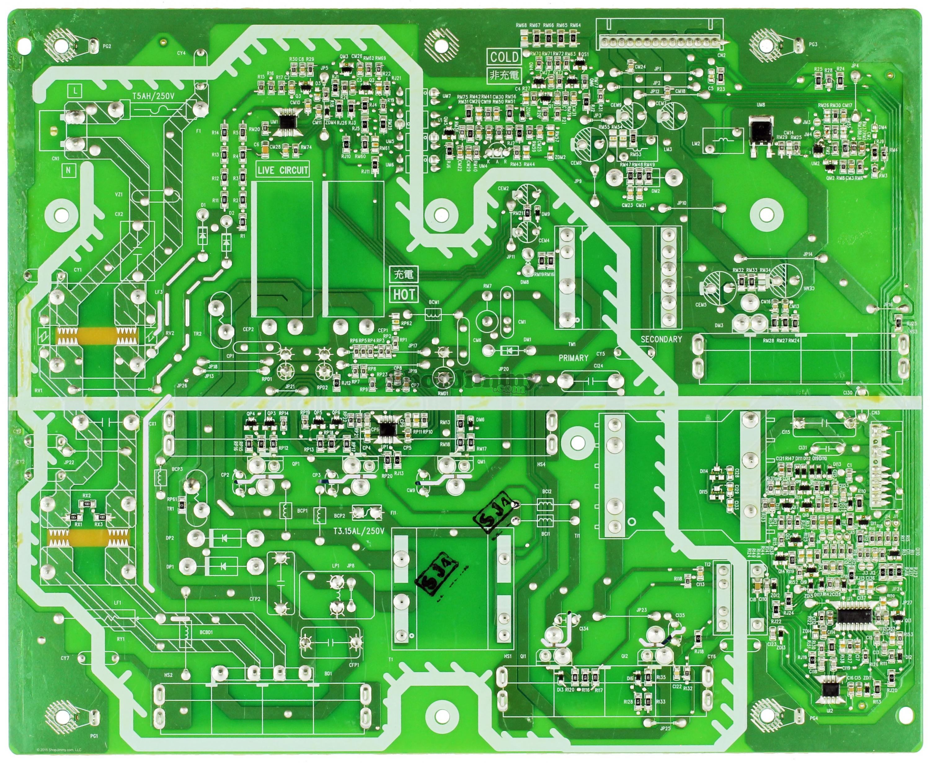

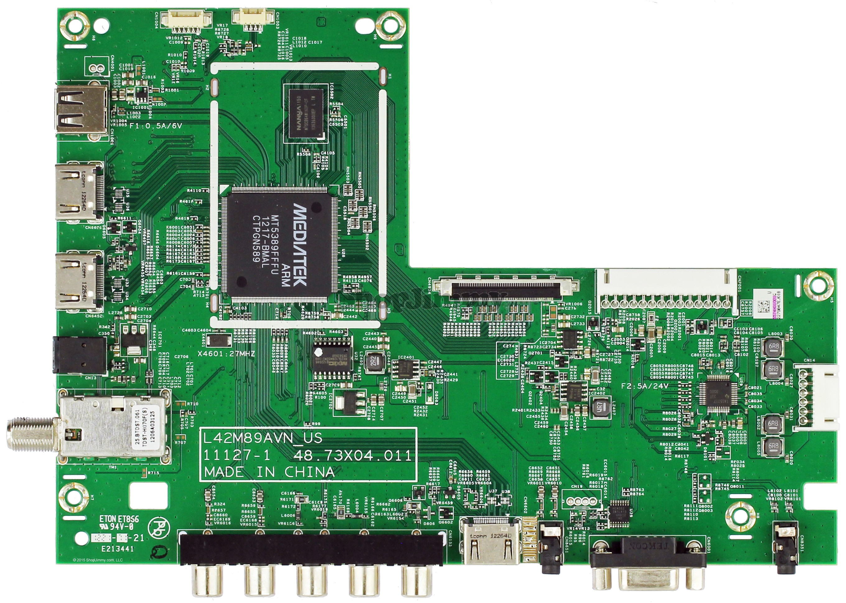

    I ordered this kit:
    https://www.ebay.com/itm/VIZIO-E500A...72.m2749.l2649
    Replaced both the mainboard + PS board and the respective cabling but to no avail.

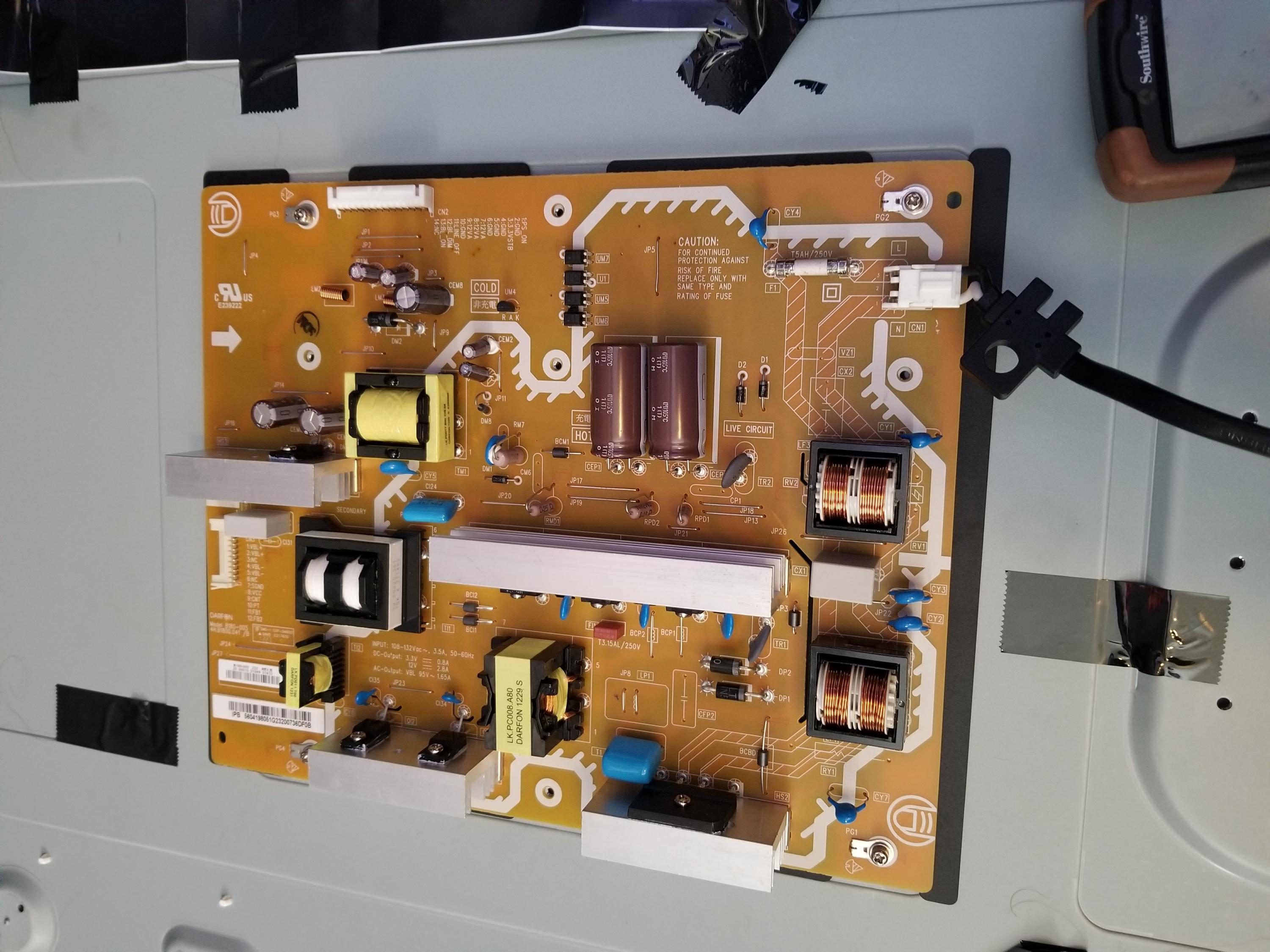

    At this point I decided to tear the TV down all the way and visually inspect everything. The backlight inverter is pictured here. Each of the lamps has a darkened spot on the end (with the dark spot alternating sides each lamp).
    My uneducated guess is that either I received a bad PS board (I doubt), or something besides the MB and PS are causing the issue. I could use a professional's advice/assistance on this one.

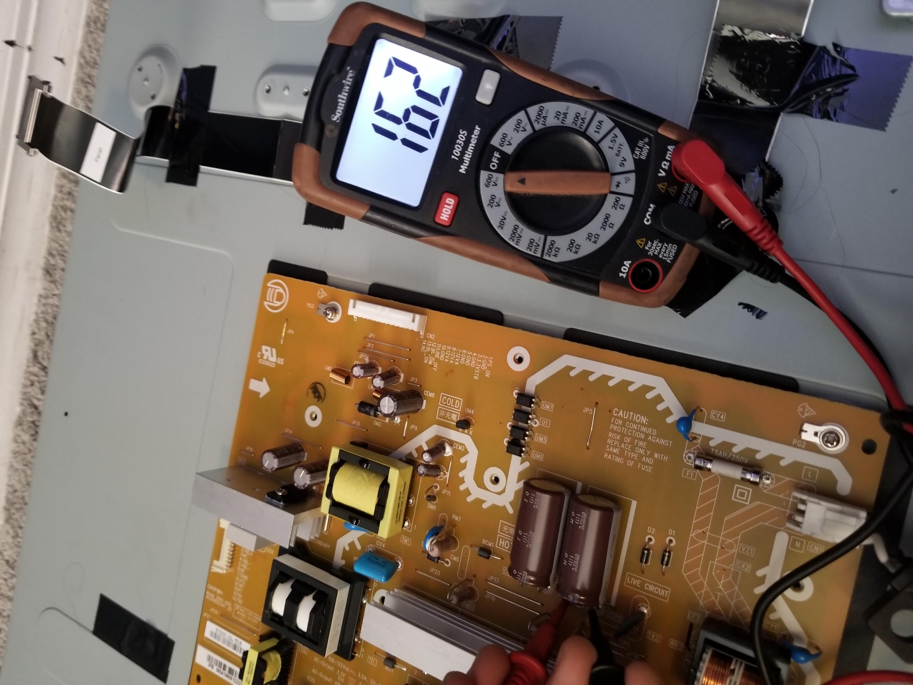

                        Re: Vizio E500AR No Power

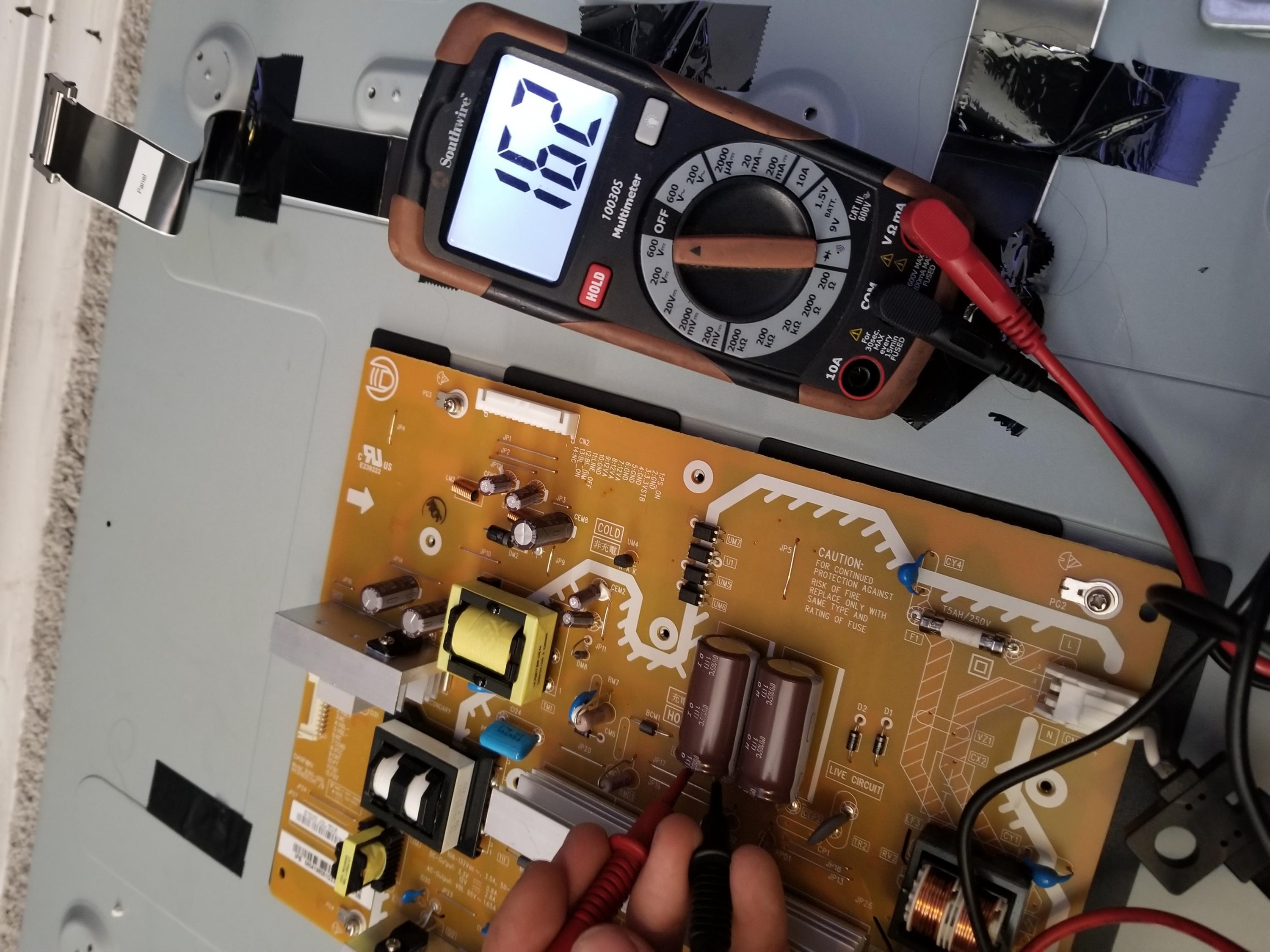

                        Test the voltage at the two large brown capacitors near the middle of the board, with the meter in DC mode, range needs to be set to 1000V. Each needs to be tested individually. Positive probe on the plus, negative probe on the minus. What voltage reading do you get?
                        DO NOT touch anything on the board with your hands, high voltage that can kill you is present. Be very deliberate about the placement of the probes and do not short any of the pins together. The board is marked + and - at the base of the caps. The side of the caps with the gray stripe is negative.
                        Send a picture of the meter with the range you are using clearly visible
                        They call me......."threadkiller"
                        • Kildar
                          • Jan 2019
                          • 21
                          My meter peaks @ 600V, will that suffice?
                          They both read 162V
                            Post a pic of your meter please
                            • DXseekerMO
                              • Feb 2018
                              • 1119
                              • US
                              They both read 162V
                              When testing the voltages at the connector are you sure you were using the right setting and ranging on the meter?
                                      So you do have 162VDC on the hot side to run the always on 3.3V Standby power supply.
                                      What do Voltage do you get now between the 3.3VSTBY pin and GND pin? If you get nothing then that supposedly 'New' power supply board is bad.
                                        Voltage at the main caps proves the fuse is good and the rectifier diode is working, therefore power should be present to run the stand-by circuit. If you have no stand-by voltage then you will have a TV that appears dead.
                                        Stand-by runs the minimum functions of the TV so commands from the user can be recognized and processed. No stand-by volts = no happy
